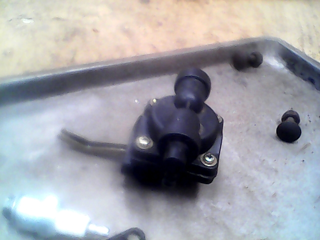

ParticipantI have owned my Wheelhorse for 15 years and use it for the purpose it was designed for rather than taking it to shows. It has been serviced by the same outfit for all this time but the mechanic at the company has recently changed and my tractor has come back not working with the suggestion that it is only good for breaking. I disagree with this and want to keep it going. They have tried to fit a new petrol pump which is different to the original one previously fitted and apart from plumbing it in the wrong way round I don’t think they fitted it correctly to be driven by the “blade” on the underside of the big end. It may not even be the correct pump. I have attached a photo of the pump and wondered if anybody can identify if it is correct. My engine is a Kohler 12hp 301 AS.
Hope somebody cann advise me please.
KeithMarch 19, 2024 at 9:21 pm #41924urbanalfa
ParticipantThis looks like one of the plastic Chinese fuel pumps available on a well known auction site. I can’t advise which fuel pump is correct for your engine, but it should be possible to test if the pump is working by manually using the lever while it’s not fitted to your machine.
If possible, I’d recommend getting the original fuel pump back from the mechanic and taking it apart swapping the new diaphragm into the old fuel pump body. It’s usually the diaphragm that fails and the diaphragm in the new pump should fit into the old pump.
March 19, 2024 at 9:56 pm #41925keith-durston
ParticipantThanks urbanalfa. I know the new pump works out of the engine which is how I identified that it was plumbed in the wrong way round but I am not sure if the blade on the underside of the big end cap is reaching the drive arm and unless I take the engine out and take the sump off I can’t see. That is why I hope someone who knows the engine might be able to identify if my new pump is the right one. I have asked the company if I can have my old pump back but I fear it might have been junked already.

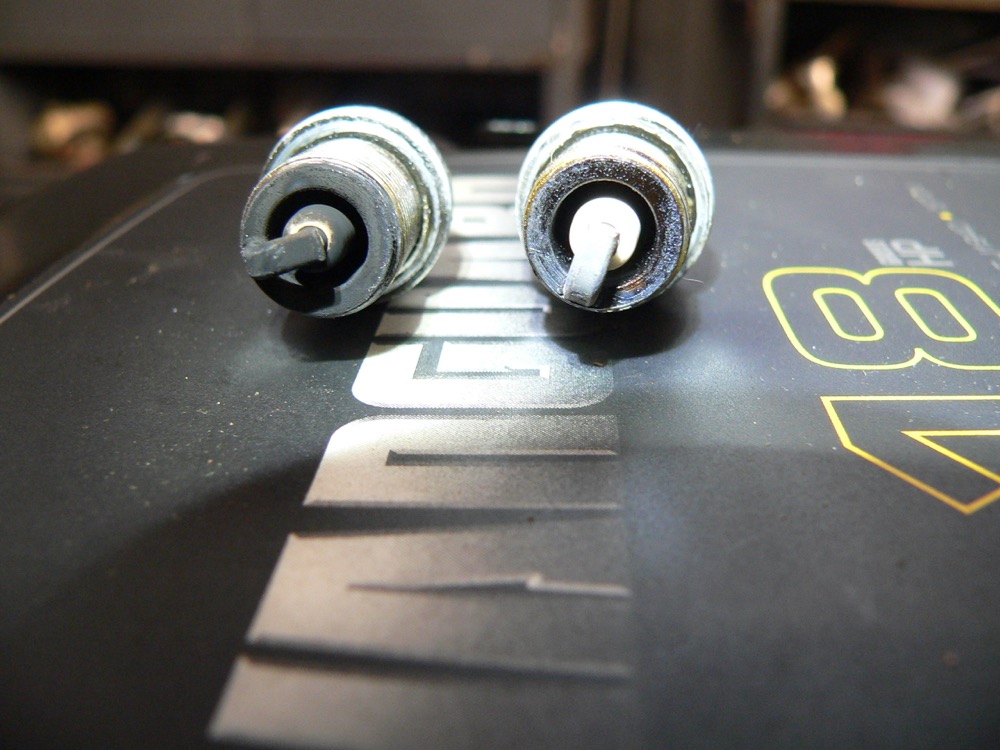

alanParticipantI would assume it means to place the pump horizontally onto the engine rather than in at an angle and then trying to straighten it up. I’ve rebuilt many Kohler engines for our tractors and made sure the pump is square-on when replacing.
I’ve taken two photos of a pump that I replaced. The first photo is a side view showing the lever angle, the second photo shows a shiny spot where the lever has been in contact with the cam.
March 20, 2024 at 12:59 pm #41941keith-durston
ParticipantThank you Alan. That is really helpful. The cam must be above, not below, the aperture and I now understand the fitting instruction. My new plastic pump has a bent steel U channel type arm and I thought that what I could see through the hole was the blade below the big end cap which would fit into the U of the arm. Your wear witness mark has explained all. I’ll look upwards to find the cam and make sure that I tilt the pump upwards when I re-fit it.
