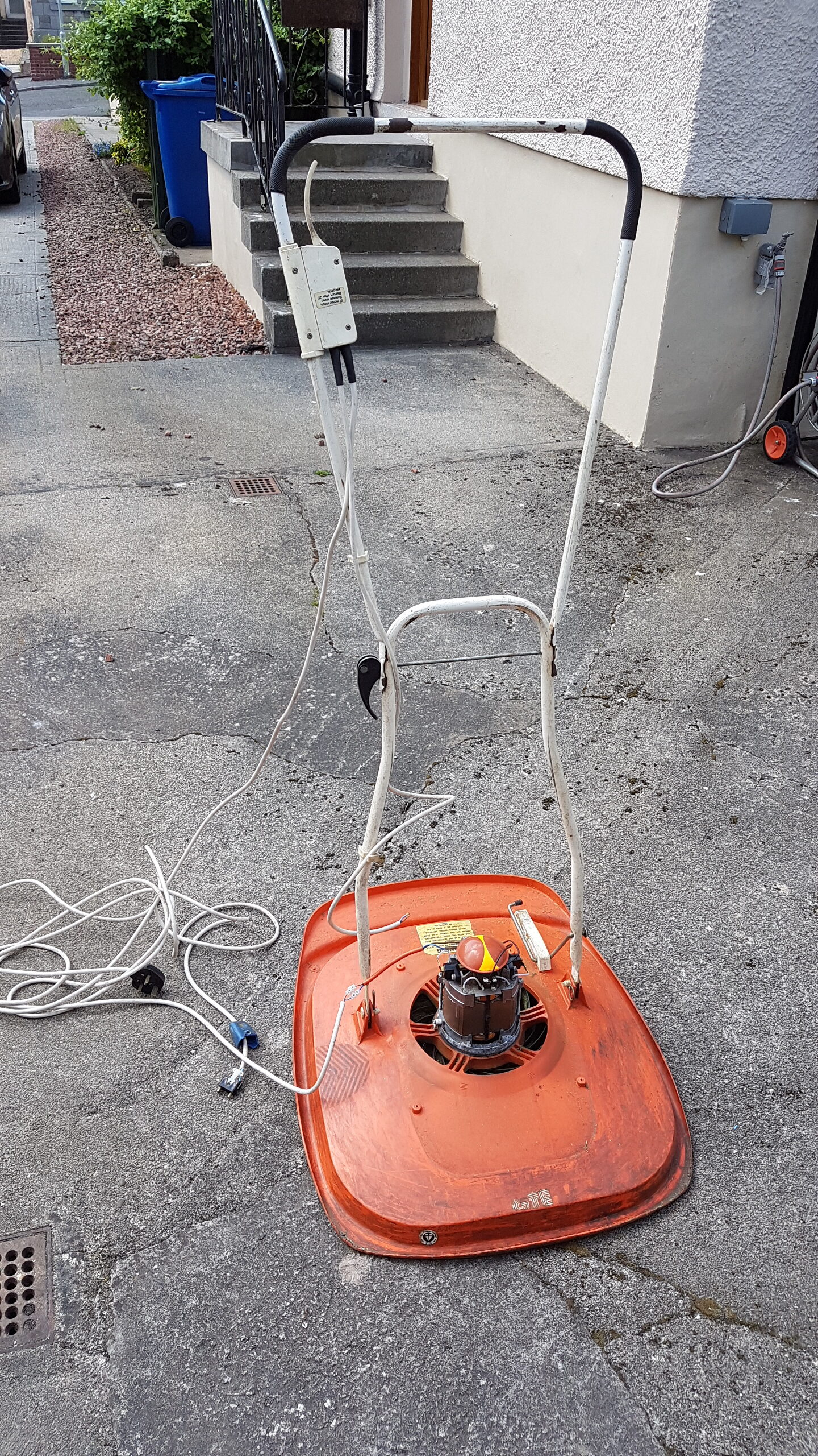

    Hi there I’m just a newbie to this forum so go gently. I have an old Flymo hover mower and it has just stopped working and I’d like to know if I can get any advice on troubleshooting the problem? It’s been a stalwart of a machine,I can’t fault it and it owes me nothing, I’ve tried replacing the cabling to no avail. I have a picture of myself and son next to the machine when he was about 6..he’s 36 now!! I’ve tried troubleshooting this however I don’t know how to test the capacitor or carbon brushes or for that point the actual motor. This would appear to be the 3 areas that has the problem. I can bypass the microswitch. When I perform continuity testing everything seems fine, however I’m no expert. When I press the on/off switch it trips the CB in my electrical box. All other appliances work fine from the same circuit. IT’s a great machine and I’d rather replace the parts than buy another machine if possible. Any advice and assistance would be appreciated before I send my old friend to the scrapyard.. Pictures can be supplied. thanks in advance JD

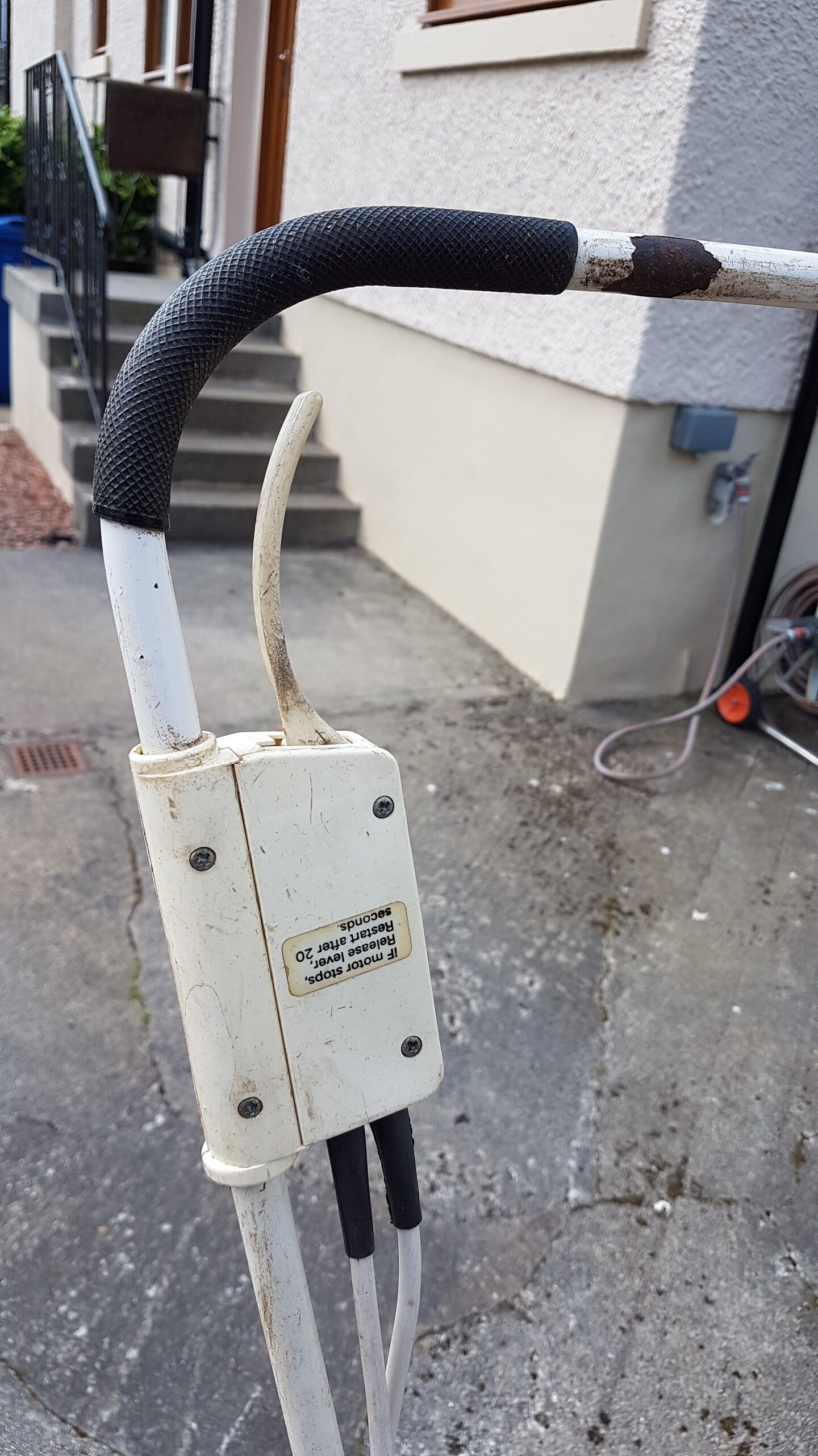

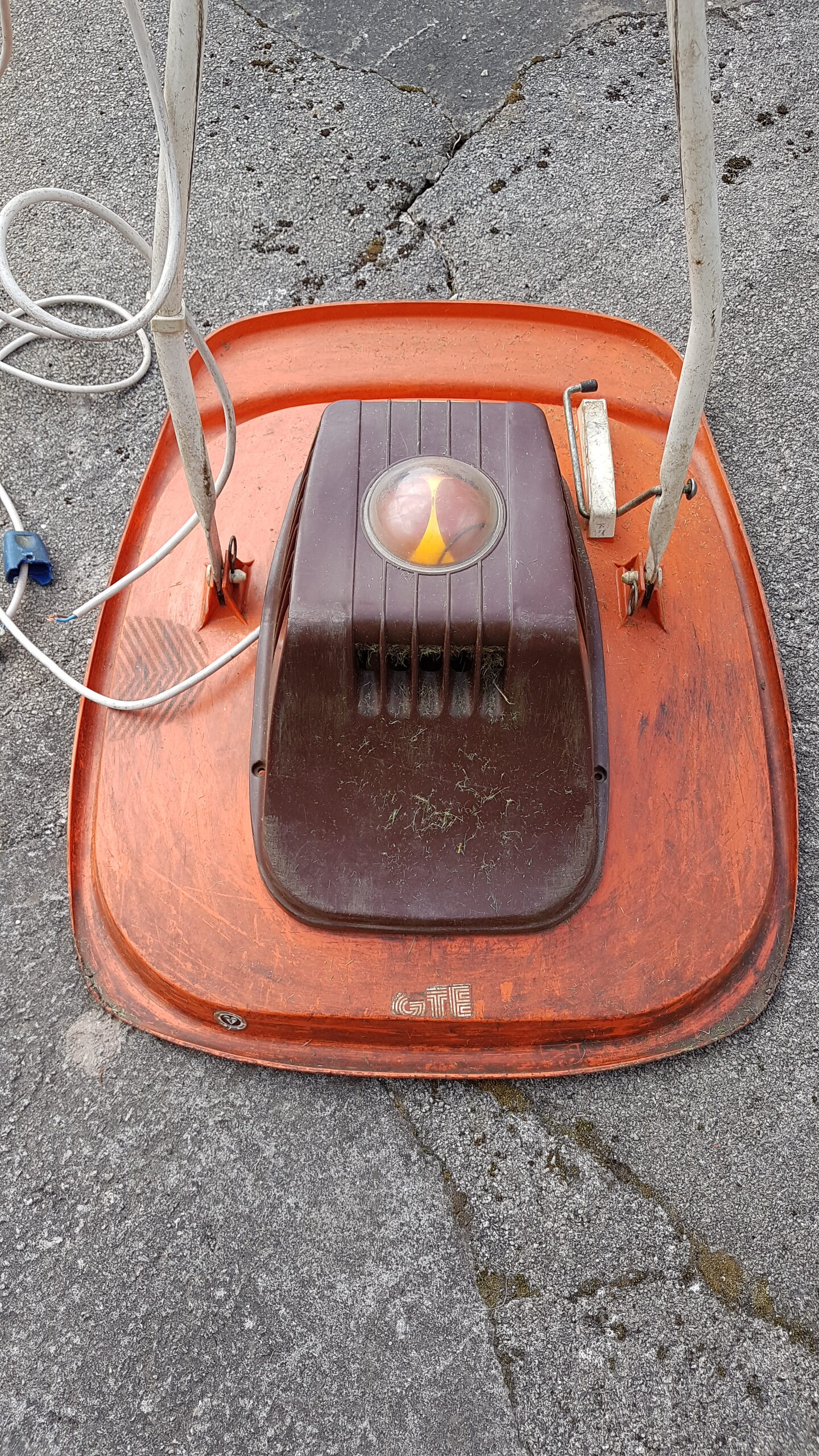

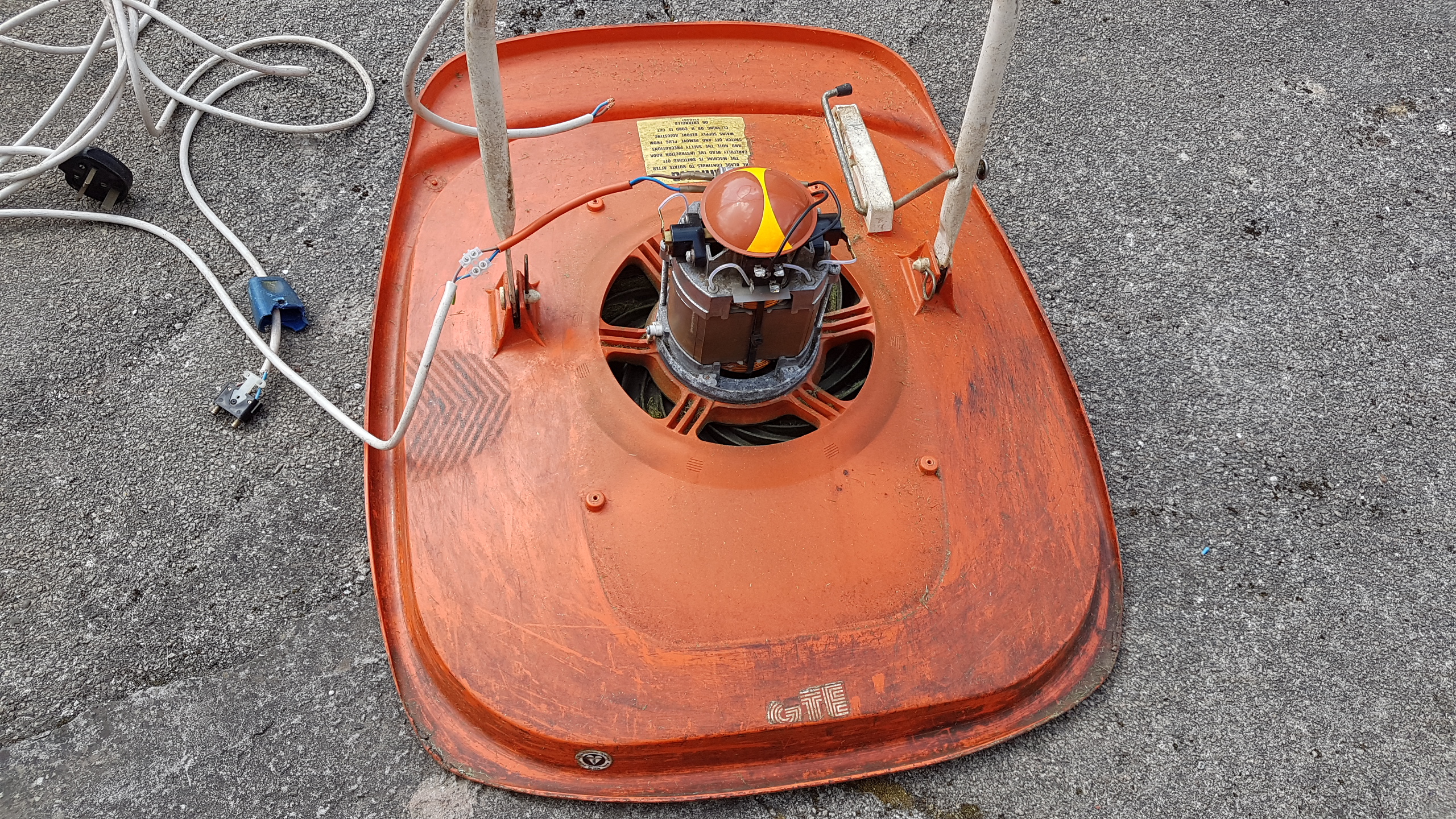

    Hi Wristpin here are the images I discussed… thanks JD
    #28609
    another 2 images

    Just remember that you are playing with mains electricity so I suggest that anything that you do should be via a residual current device RCD. Don’t just rely on your household box to protect you – its actually there to protect the house !
    If you are determined to fiddle around with it I suggest connecting a short fly lead to the choc bar connecter where you have the white and orange wires connected and plug it straight into your RCD and wall socket.
    If it runs ok you have isolated the issue to the mains cable and switch – if not I’d bin it.
