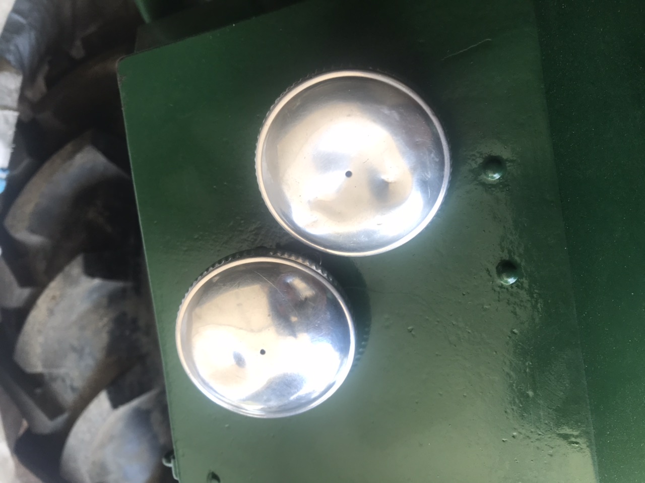

ParticipantAfter a little break during the cold weather I started sourcing a few parts I needed to help finish her off mechanically and looks wise. The old carb float had a crack around the central stem so that would explain the over fuelling. A suitable donor carb was found and the float was perfect. As for the other running issues I decided to get the magneto professionally tested and overhauled, not cheap but worth every penny. She now starts on the first pull on the strap. Cosmetically all that was needed was some chrome caps for the oil and fuel tanks. A rotten Howard gem donated them and they look great with their aged look. I just need to post a cheque off to Geoff for some water slide transfers.
April 18, 2021 at 11:25 am #36985
trusty220KeymasterI’m glad to see that you’ve located some filler caps. I’ll have to remember that they are the same as Howard, that will make them easier to find if anyone wants any in the future. Luckily mine came with them so I didn’t have to go searching.
One thing that people ask me from time to time is,”Where can I get my Wico A magneto refurbished?”. Not being a standard motorcycle type magneto the usual restorers tend to turn their noses up at the humble Wico; could I ask you where you got yours refurbished?
April 26, 2021 at 6:16 pm #37047halfa
ParticipantYes the gem tank caps are identical and the carburettor float was from an gem JAP engine too. The magneto refurbishment story you described was exactly what I came up against. Not because he didn’t like them but because he is so busy with motorbike ones. But with some persistence and the fact he only lives 5 mins from me, he agreed to help me out as a bit of a one off. I’m glad he did because he really knew his stuff. I will suggest to him there could be a market for him working on the wico A’s.
