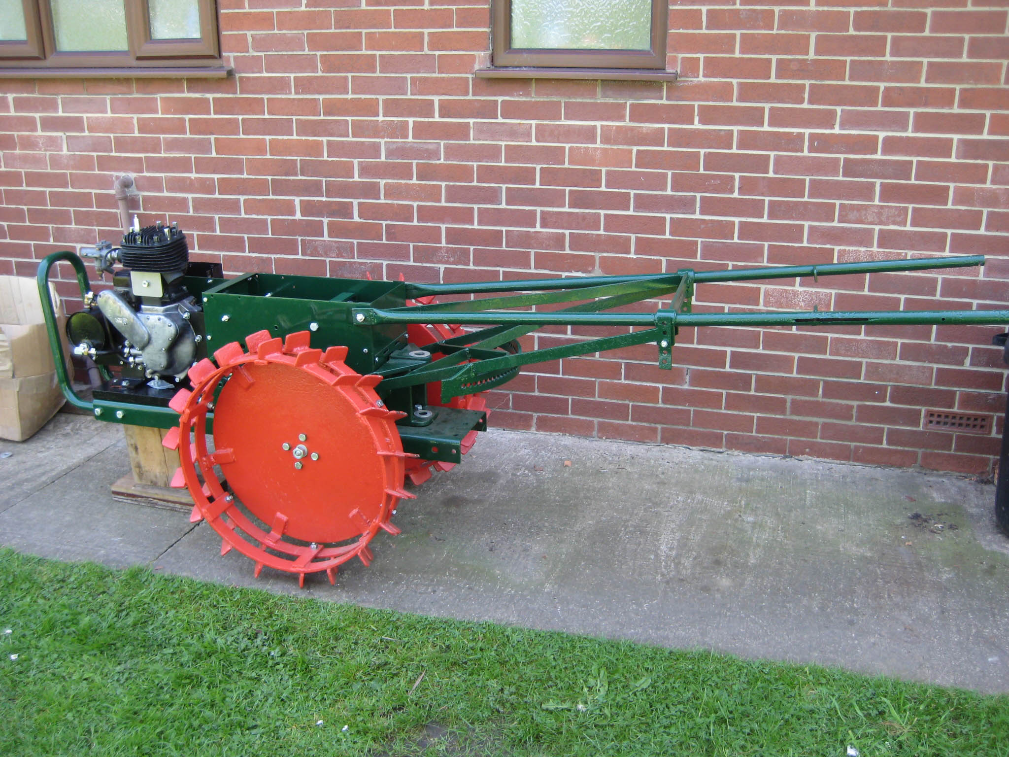

vhgmcbuddyMemberFollowing on from my project thread on the old forum, (see https://www.tractorbox.co.uk/forum/forum_posts.asp?TID=6279), I have now got the handlebars and stay assembly fitted (see photo 0001).

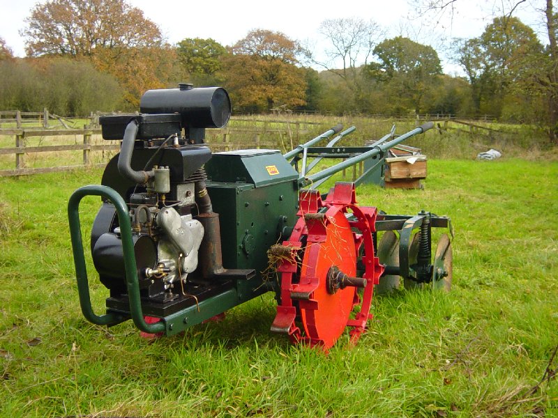

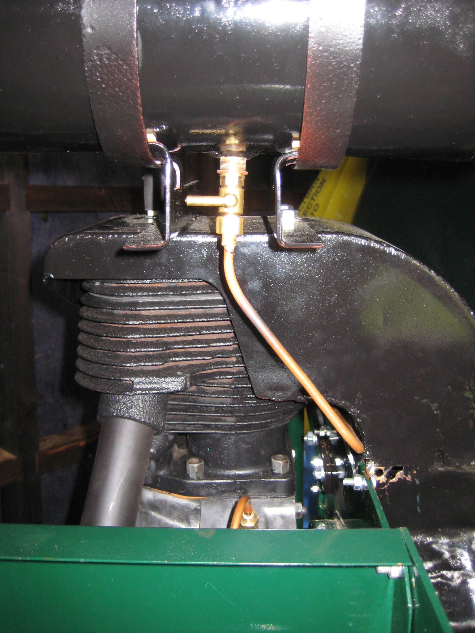

The engine cowling is now in place, along with new support brackets that I had fabricated for the fuel tank (see photo 0002). Fuel tank was then strapped to the new brackets (see photo 0003).

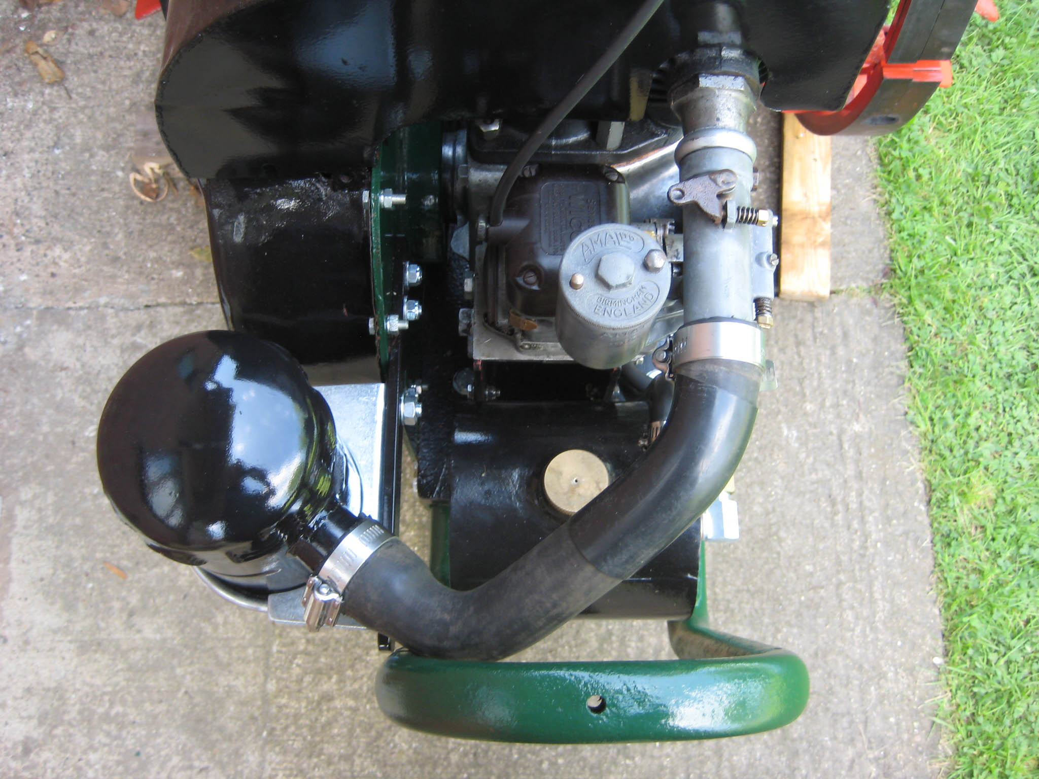

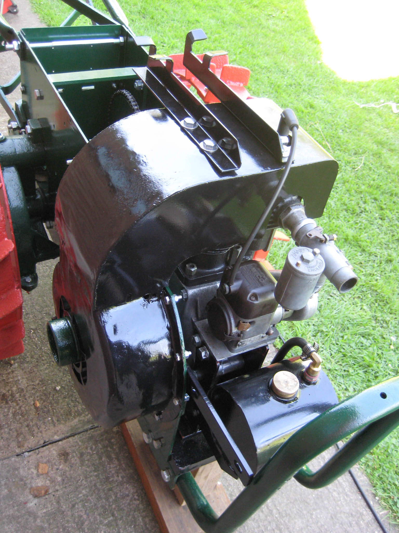

At some point in the past, the tractor had lost it’s air cleaner, so I purchased a Burgess oil bath cleaner from that well know auction website. This is mounted to a piece of flat bar bolted to the drive chain guard. The air cleaner is connected to the carb using what I think is an intercooler hose from a Peugeot 306 (I never throw owt away that might come in handy one day!!). This hose is a perfect fit, as it is 1 1/4″ bore at the carb and then flares out to 1 1/2″ bore to fit on the air cleaner (see pic 0004). Only downside is that the cleaner slightly gets in the way of the starting strap, so may alter it at some point in the future, but for now, I can live with it.

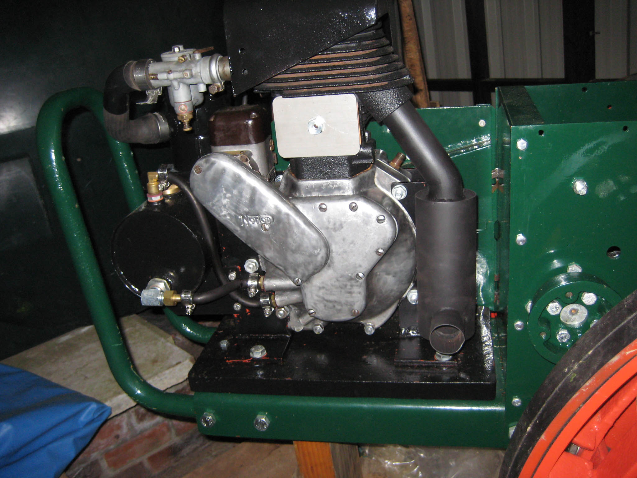

vhgmcbuddyMemberHad a new exhaust fabricated recently, which is now fitted (photo 0006).

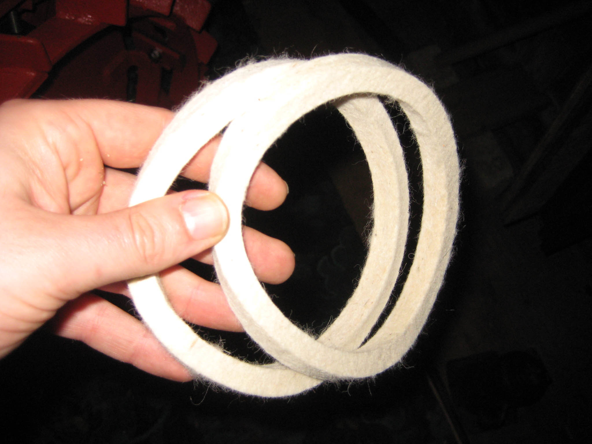

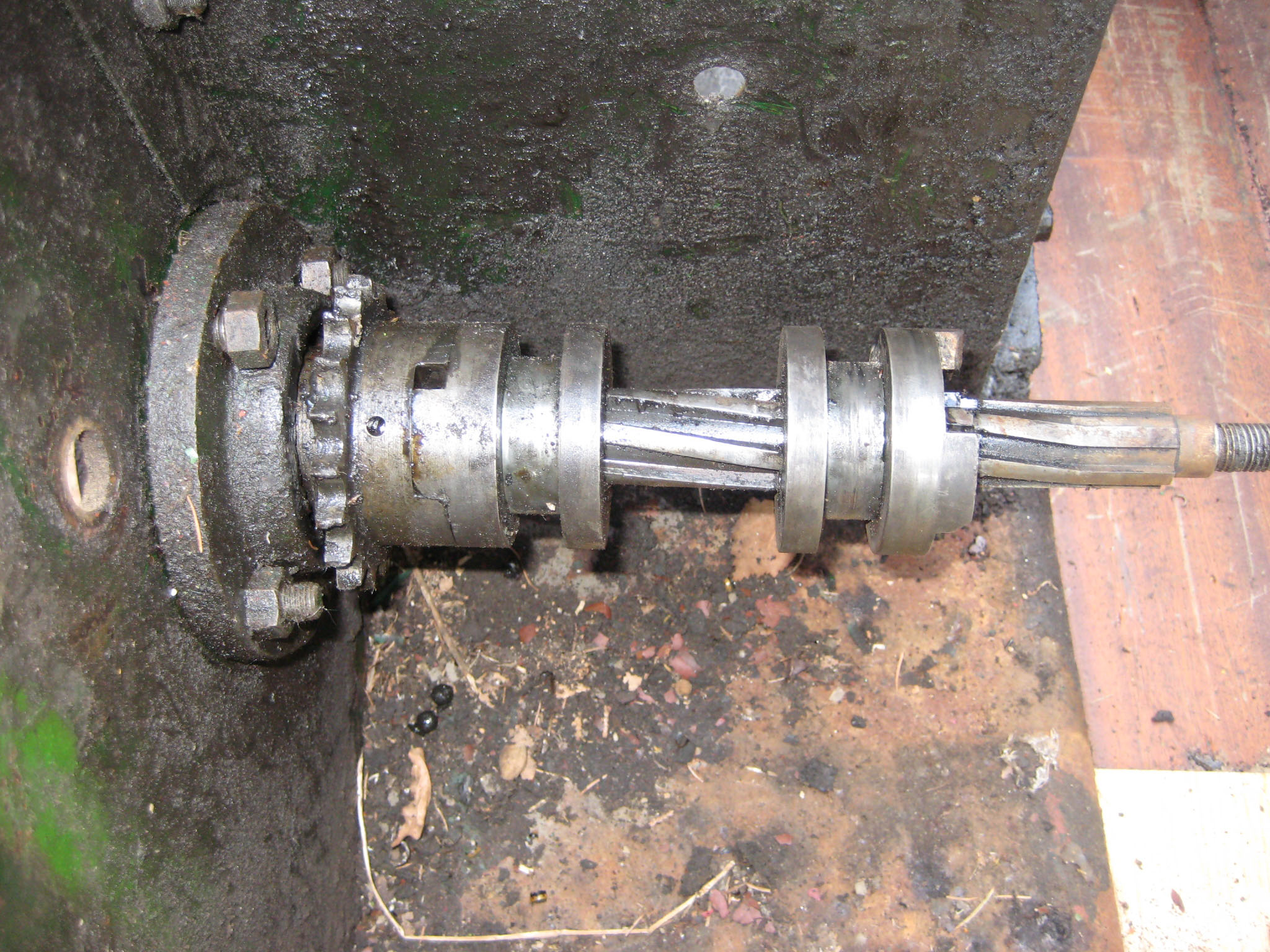

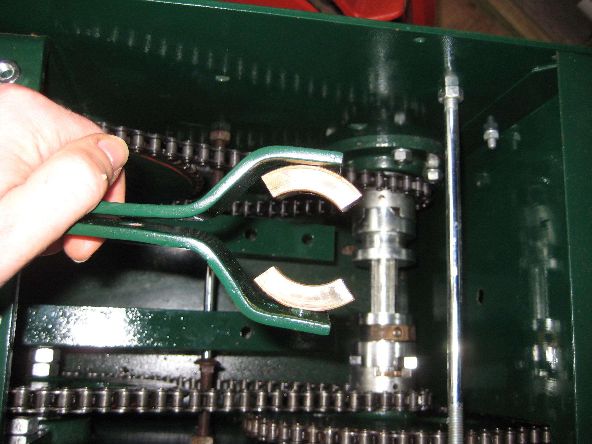

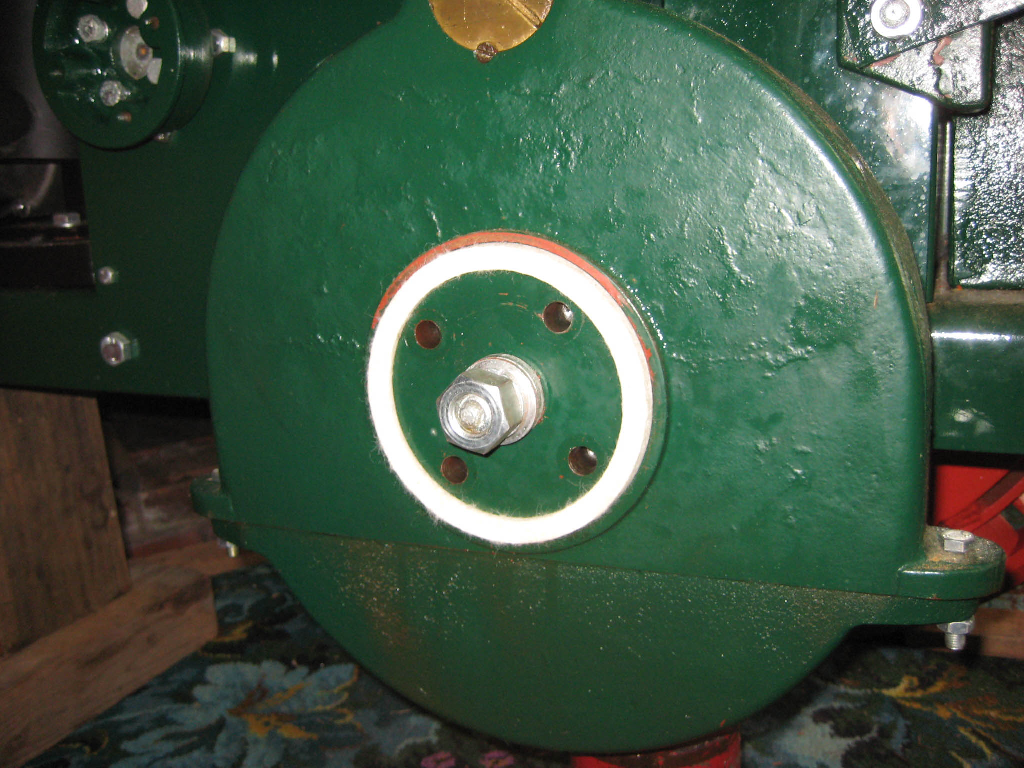

Also had some felt washers made for the reduction gear housings (photo’s 0007 & 0008). I can’t emphasise enough how important these are to the healthy running of a Trusty. The reason my Dad abandoned the tractor in the first place was down to the left hand side reduction gears jamming solid. This happened while ploughing, with the engine pulling hard. The weak link in the transmission turned out to be the countershaft, which ended up twisted like a corkscrew (see photo 0009). The drive chains and sprockets were undamaged. I was fortunate enough to have another Trusty which has been canabalised for spares, donating it’s countershaft for the restoration project. When I originally stripped the reduction housings down, both were missing the felt washers which had resulted in them being full of dirt. There was so much muck in the left hand side housing that it had packed solid around the small drive gear.

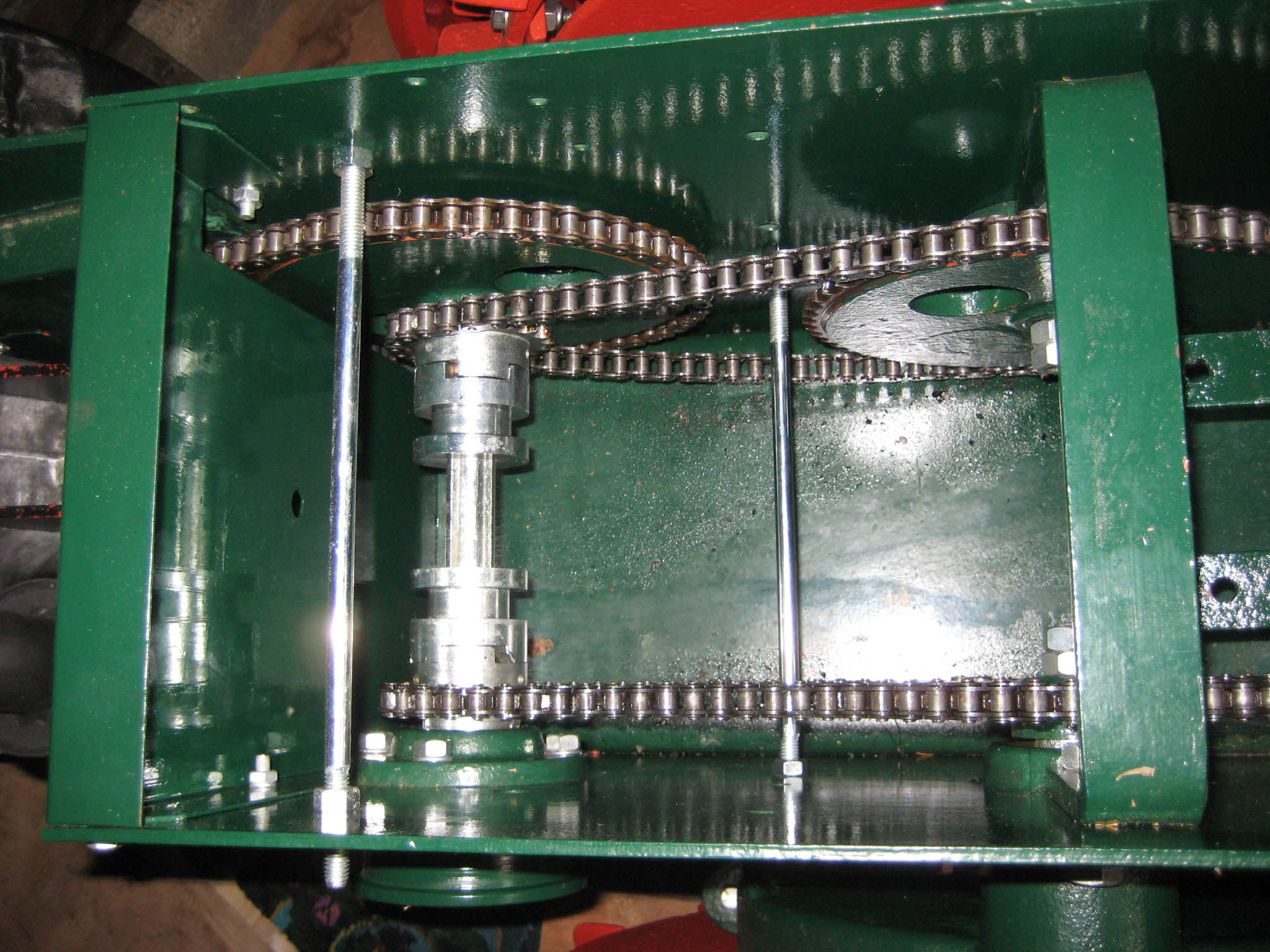

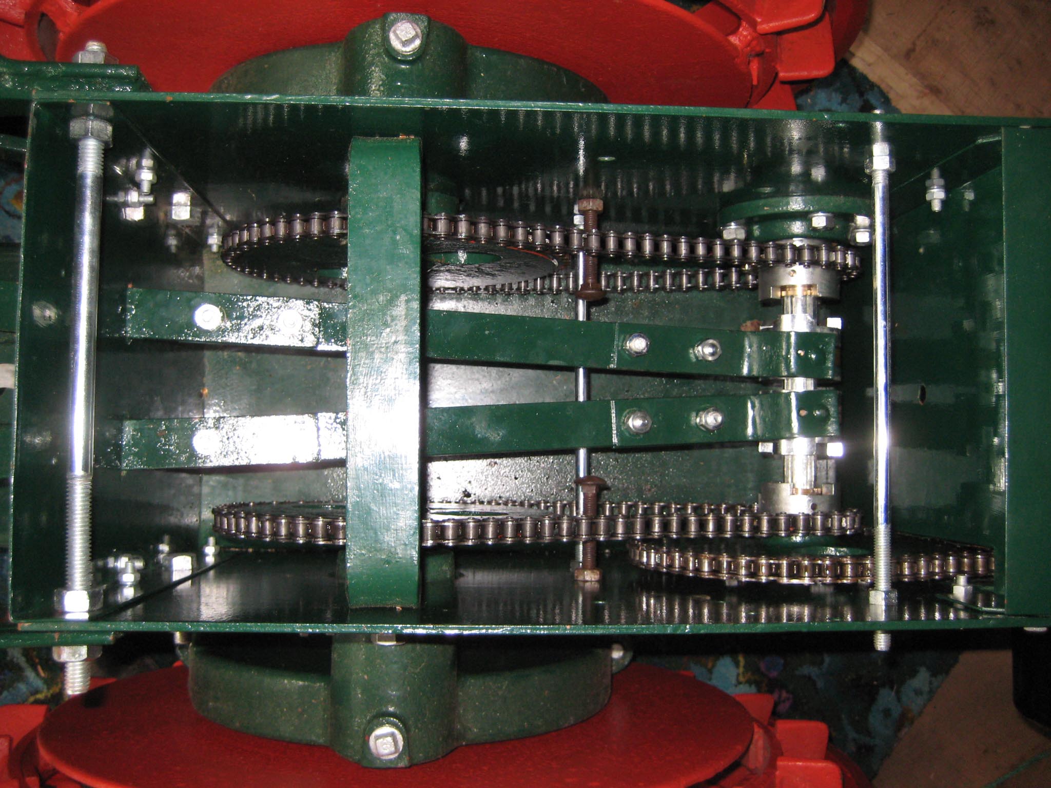

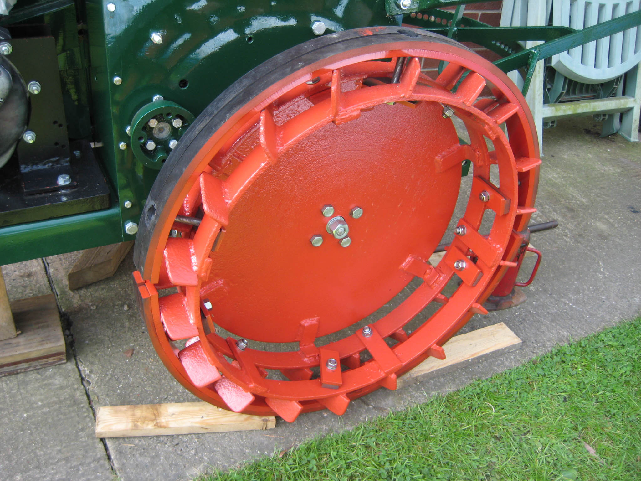

While the wheels were removed to fit the felt washers, I took the opportunity to fit the tie rods which hold the side plates of the transmission housing square (photo 0010). The lower one near the large drive sprockets can only be fitted with the wheels off.

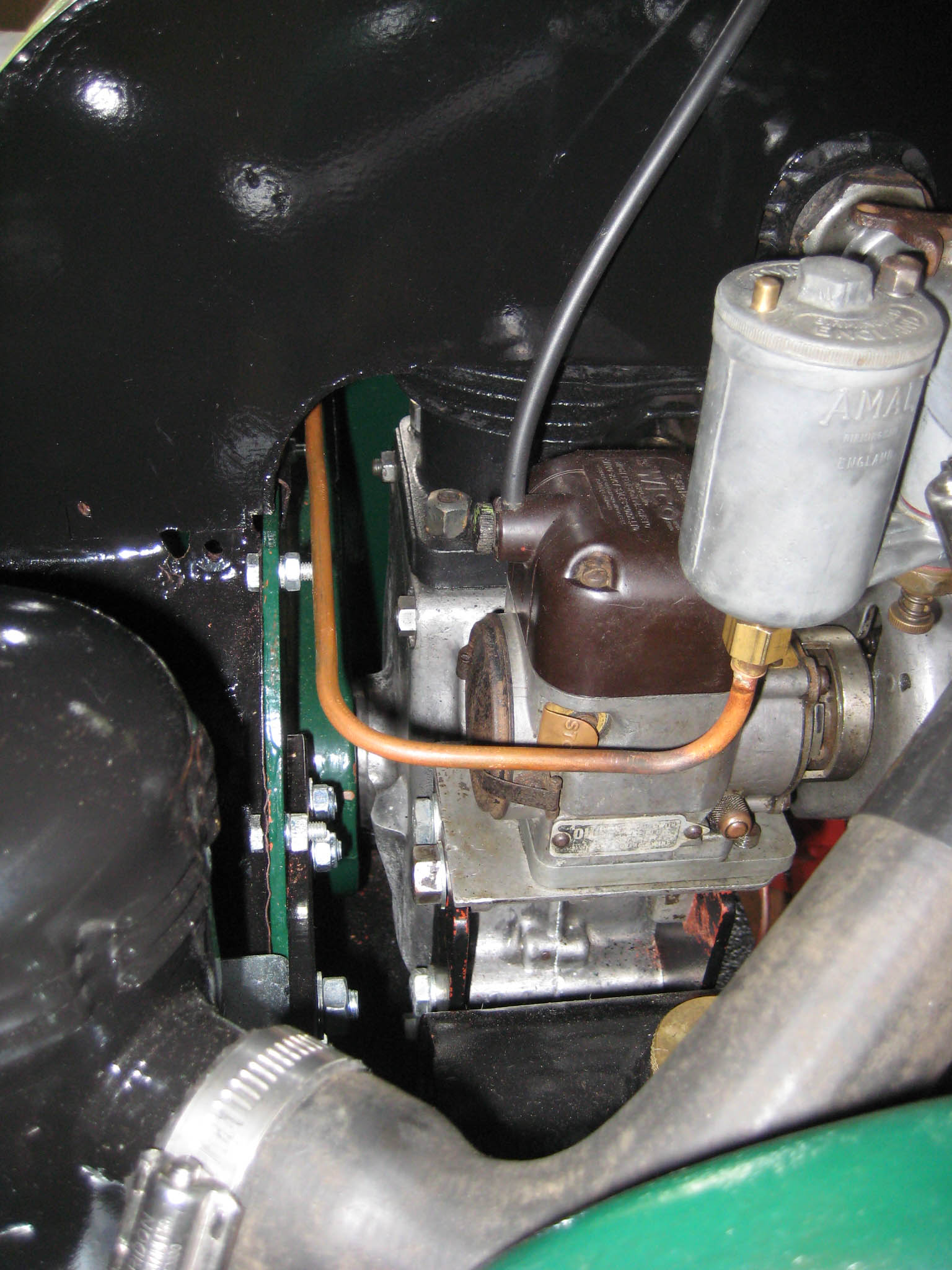

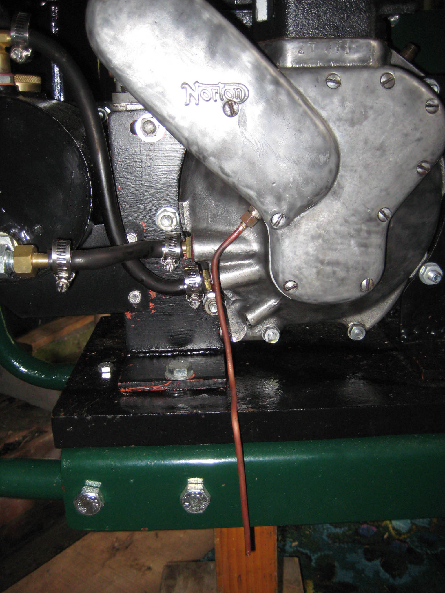

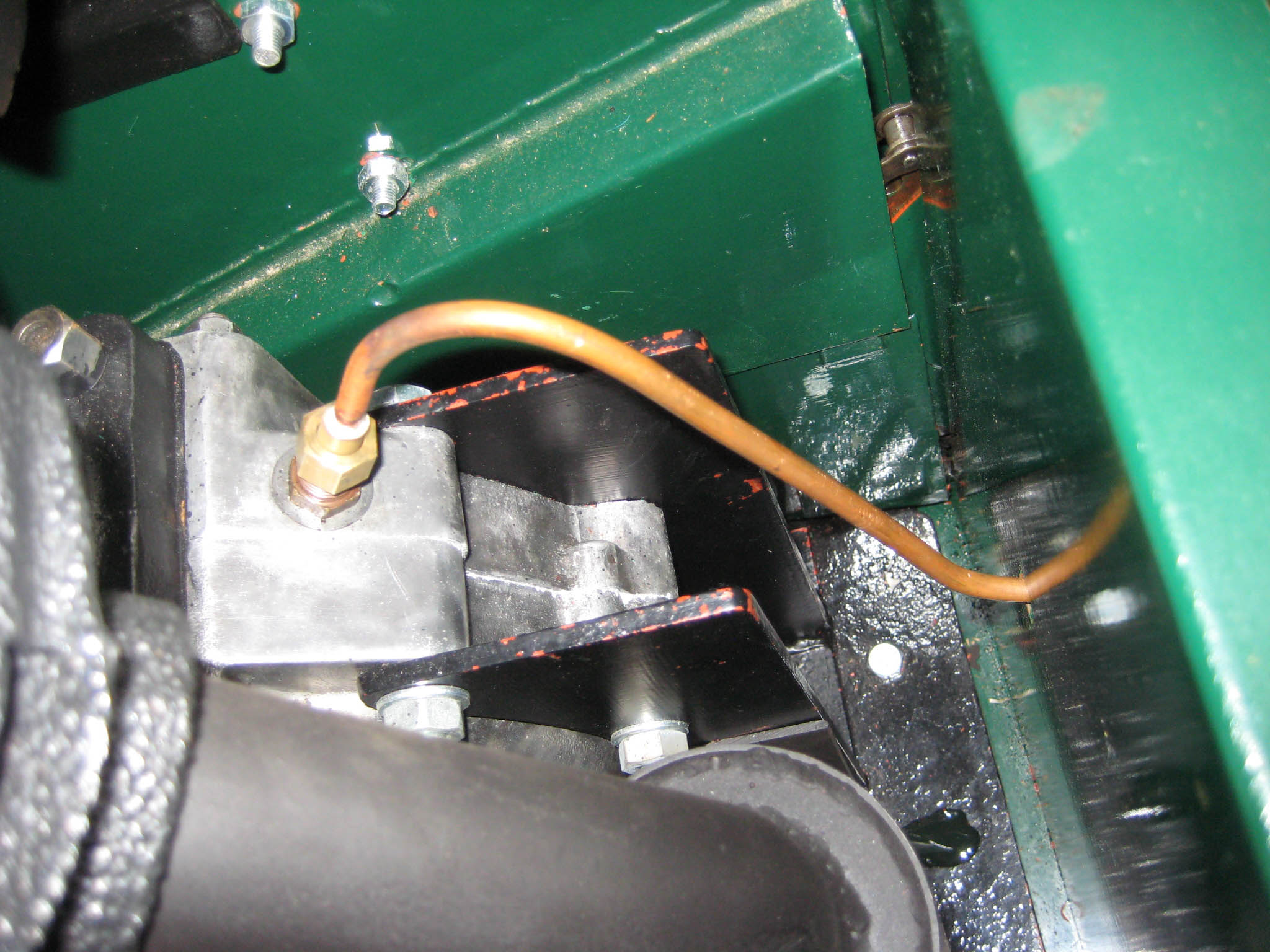

vhgmcbuddyMemberMade up a new copper fuel pipe and also the oil pipes for the magneto chain case drain and crankcase breather.
Decided to have a crack at Silver soldering nipples onto the pipe ends, rather than using a swaging tool. Turned out to be much easier than I thought. Apply a generous amount of flux to the pipe end, pop on the nipple and then heat it up with a hand held gas torch. Don’t hold the torch too close to the brass nipple or it will melt (guess how I found this out!!!). Once the flux turns clear, feed in the Silver solder and it is drawn by capillary action into the gap between the nipple and pipe. The solder used was 55% Silver, along with Easy Flo flux powder.June 29, 2014 at 5:34 pm #8847
