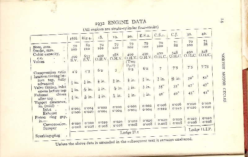

    In the motorcycle repair manual for the Big 4, it states that the correct spark plug is a KLG KS5, which is 18mm diameter and has a reach of 1/2″. I have an NGK AB-8 plug which also has a reach of 1/2″, but the actual threaded hole in the cylinder head is 3/4″ deep, which means the end of the spark plug is recessed in the hole, rather than being level with the inside face of the head. I know that the cylinder heads on the motorcycle and industrial versions of the Big 4 are different, in that the cooling fins are aligned differently, but I am also now wondering if the industrial version cylinder head is actually thicker, requiring a spark plug with a 3/4″ reach.

    The timing is set with the points opening at 3/8″ before TDC. The points gap is 15 thou.

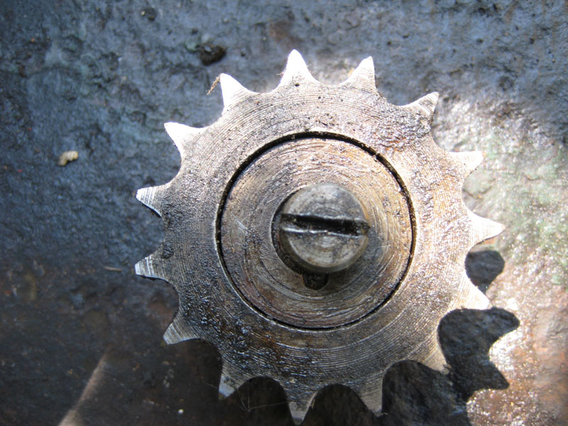

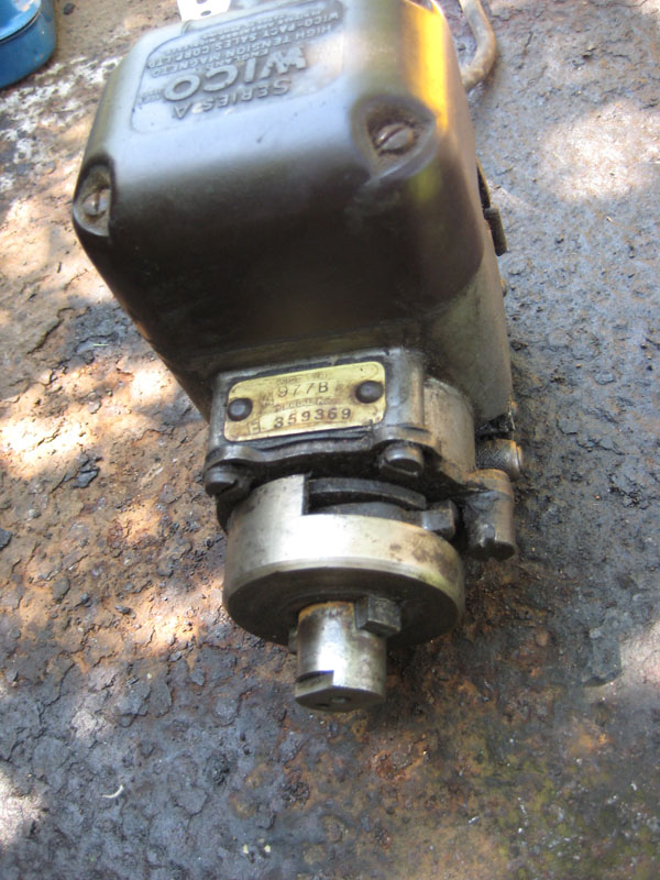

    Unfortunately Geoff, the mag on my Norton is quite different to what you describe. The pictures hopefully show what mine is like.
    Basically, the sprocket has two notches in the back which locate over the lugs on the impulse coupling. There is then a metal disk with an off centre locating pin on it (you can just see the back of the pin below the screw head in the photo of the sprocket) which fits in the centre of the sprocket. The pin on this disk fits into a hole in the end of the magneto shaft so that it cannot spin. A left hand thread screw then attaches the lot to the magneto shaft.
    All of the above means that the sprocket will only fit one way on the magneto shaft. So, as far as I can work out, I need to rotate the whole impulse mechansim without rotating the magneto shaft, but I am not sure that this is even possible.
