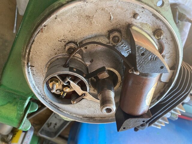

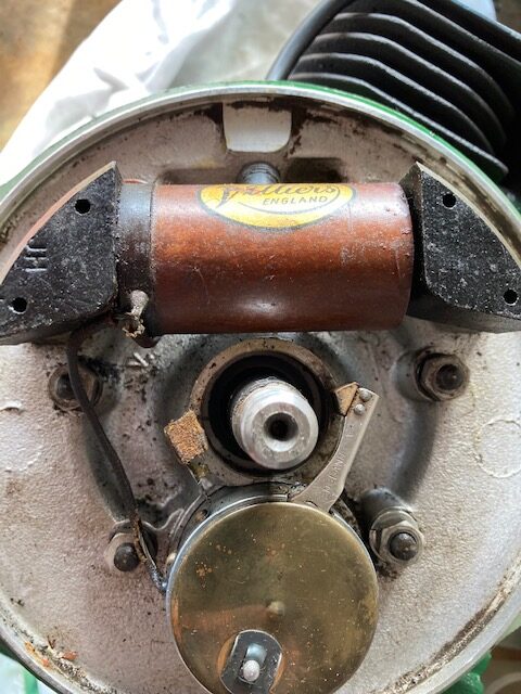

ParticipantHi I am renovating a Monro tiller with a Villiers mk12 engine fitted. I am going to have to fit a new coil but I’m having problems removing the back plate. I removed the four nuts that seem to be holding the plate on and tried tapping the plate off but it seems stuck fast. Is there anything else I should be doing? Please see photos.
September 24, 2021 at 6:42 pm #37924davet
ParticipantHi, The manual shows one other attachment. A countersunk screw at 11 o’clock looking rewards. I thought it would be visable in your photo , it should be hiding behind the LH end of the coil. Might require a right angle screwdriver.

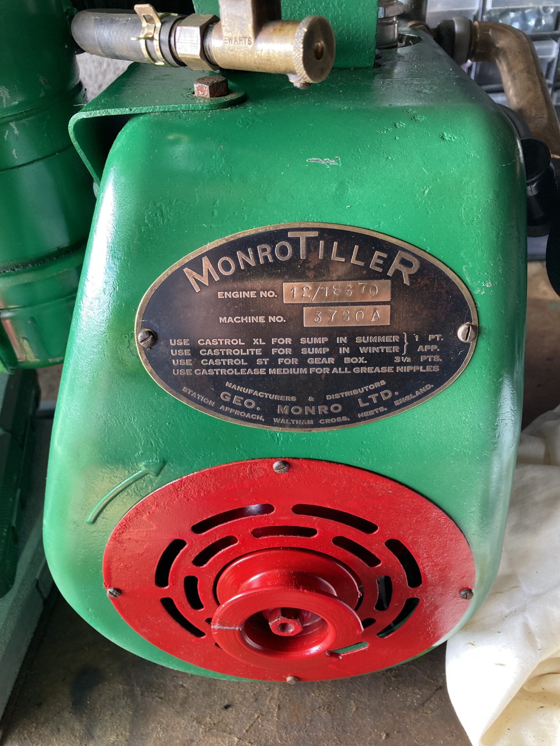

ParticipantThanks DaveT, found the screw and removed the backplate. Brilliant.I wonder if you can help me with one other question. I took the chain cover off the drive between the engine and tiller section. It was packed with 70 year old grease which I removed. Any idea what type of grease I should re-pack it with. Thanks again for your help
September 28, 2021 at 7:42 am #37940
charlieKeymasterThe recommended grease for chain lubrication is Castrolease Medium.The chain should have 1/2″ of movement on top run when correctly adjusted.
It is worth noting that the main gearbox should use a straight gear oil not EP90. Castrol D or equivalent SAE140 gear oil is recommended. I use Morris oils AG140 Classic Gear Oil. Castrol XL SAE 30 for the engine, Morris Oils Golden Film SAE30 Classic motor oil is what I use.
