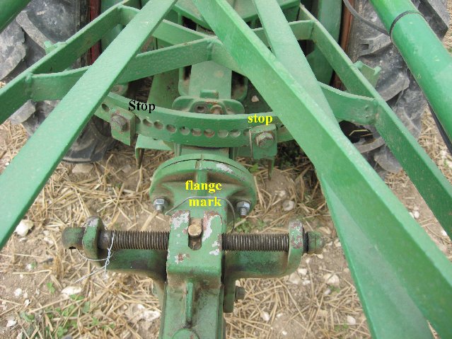

    I am puzzled at the function of the device in the 1st picture below and will be most grateful for any advice. It is easy to see that when it is moved into its “back” position the pin or dowel locates in a hole in the “rack” and prevents the plough from moving sideways. But, only a small upward movement of the handles and the thing swing forward and disengage. Once disengaged it locks disengaged and needs two hands to reengage it. Should one plough with it engaged or not?

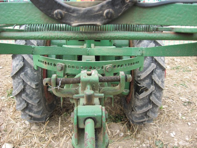

    2nd picture is of by ploughing attempts. It aint pretty but its all mine.

    nice machine. you plough with the draw bar lock disengaged. as far as i am aware it is there to make transporting the machine between jobs easier by locking the plough in place. you use the two small bolt on stops to limit the swing of the draw bar during ploughing but i cant really describe how to set them as it depends on what sort of ground you are working on and i don’t know if you set it differently when using a digger plough as apposed to a greyhound.

    Great. Your reply is seriously appreciated. I had worked out that it was better to leave it alone. There is a ploughing event on the Isle of Wight on 12 April. I shall be there with a piece of straw and seeking out the experts, deeply humble and anxious to learn.

    no dont try to plough with that locked it makes it impossible to steer most people have two stops in the holes on the curved bar this allows some movement see picture, also note in the picture how the plough is set slightly leaning to the left to keep the plough upright while ploughing notice the notches in the piviot flange.

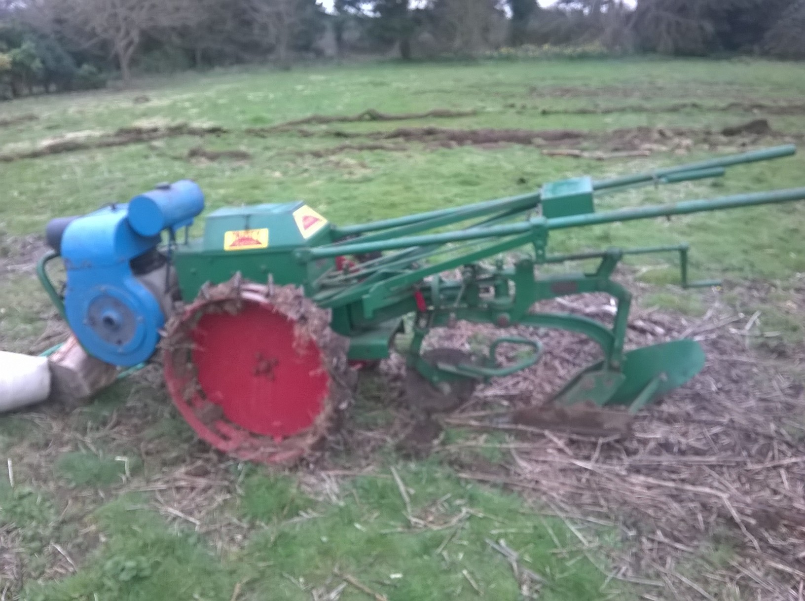

    I have lost the bolt on share/tip/point off the plough. Does anyone have any ideas as to the make and where I might get a replacement?

    The point for the Greyhound plough, which yours appears to be looking at the photo, is identical to that of the Ferguson plough, (not MF). You may be able to obtain one from Westlake Plough Spares at Peterborough or Old Twenty Parts, Derbys..
