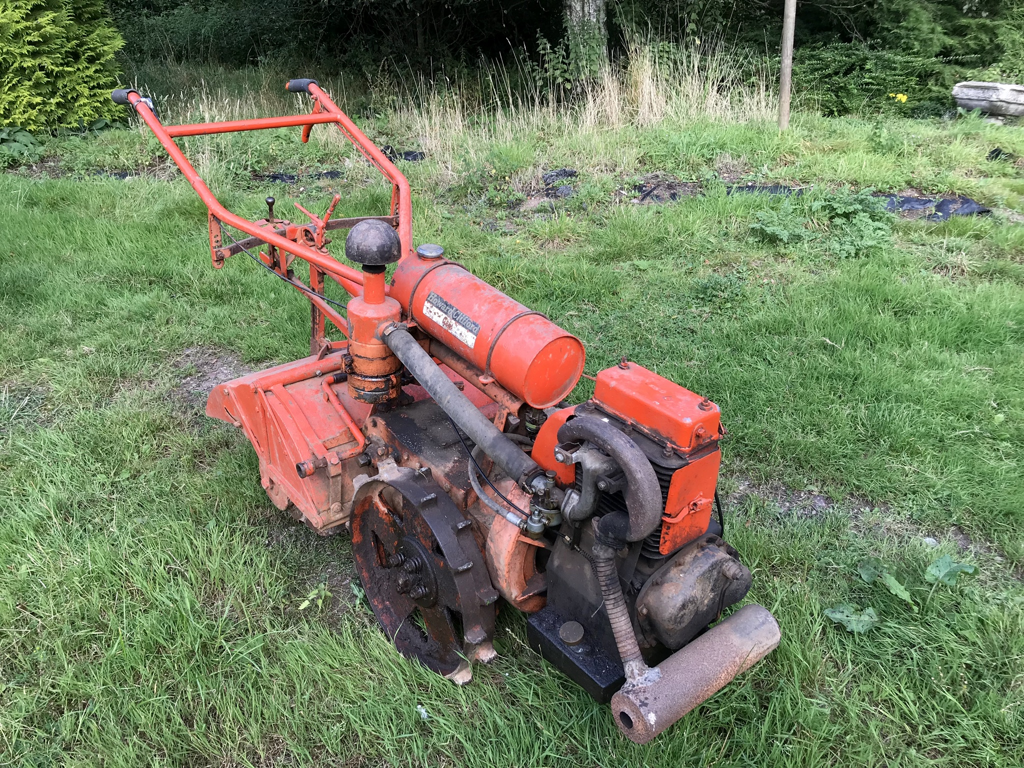

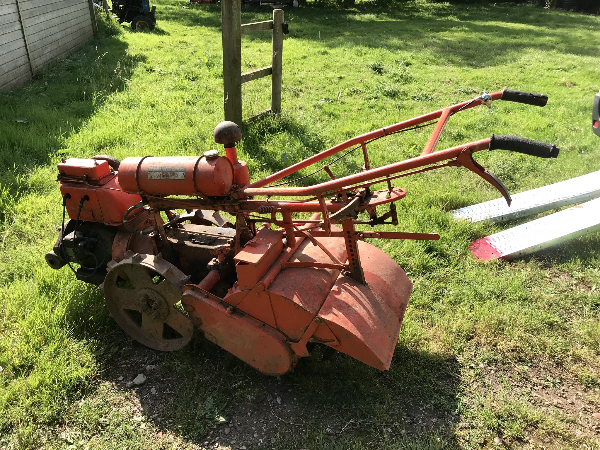

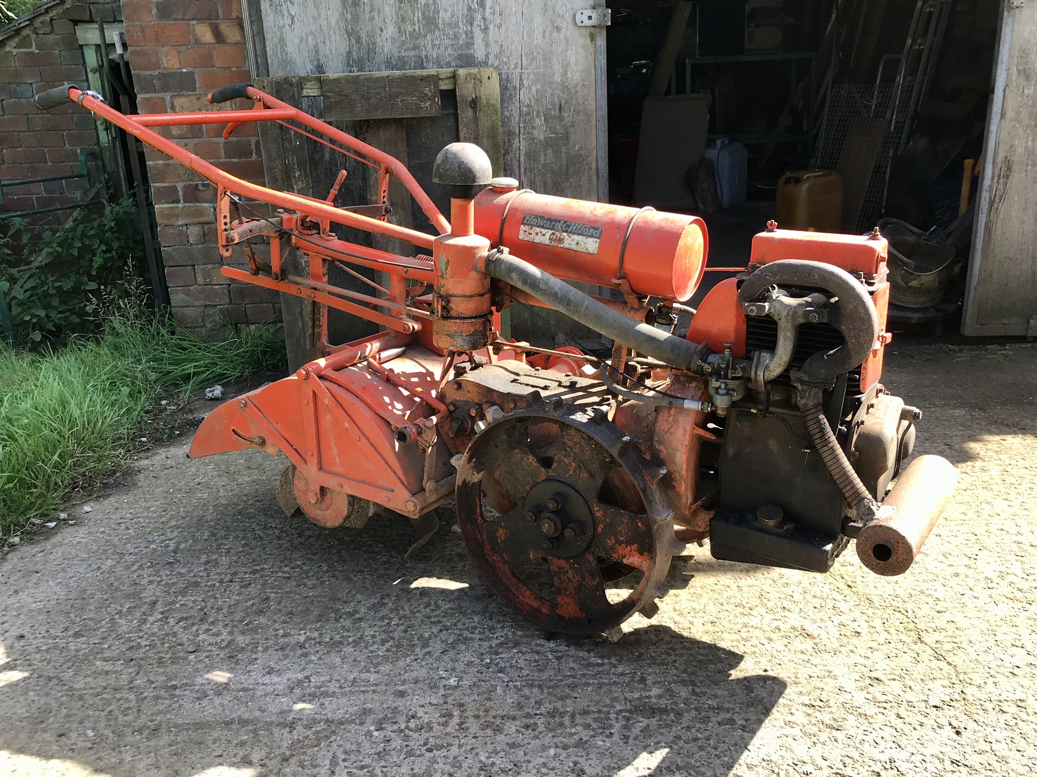

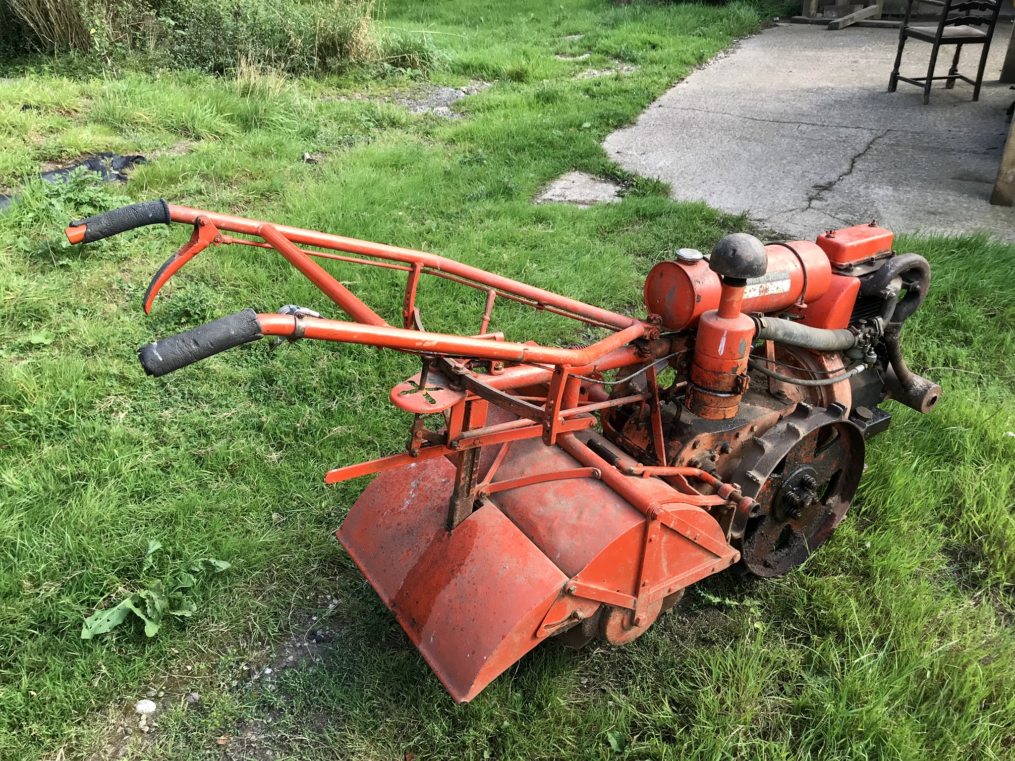

trusty220KeymasterWelcome to the forum- it’s always good to see new faces (and machines!).
There a quite a few of our club members who have Howard experience and so I’m sure that they will give you plenty of help and advice when the time comes. By the way- that looks like a well looked-after Gem that looks like it’s been cleaned down after every use. I wish they were all like that!
Best of luck with it.

charlieKeymasterThe machine serial number should be stamped into top of tube that runs forward from gear levers to fuel tank.
Lack of forward or reverse, have you checked to see if wheels are loose on axle? There is a slip clutch mechanism the pressure of which is controlled by a large spring and the big nut in centre of wheels.September 4, 2019 at 6:30 pm #31885

trusty220, Yes I thought it looked quite clean apart from a bit of oil and muck.

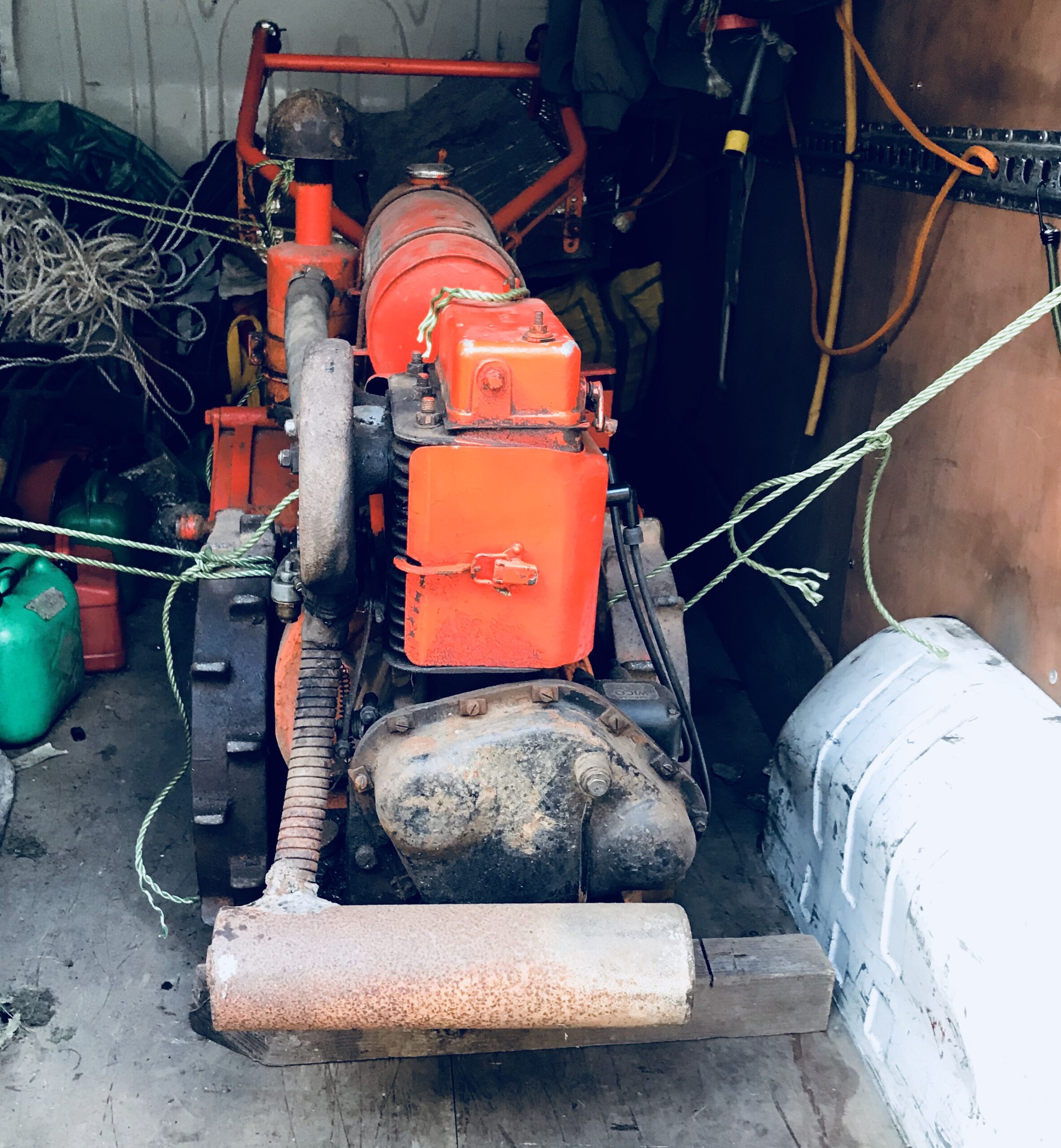

Not sure if Im aloud a blog link on here so… you tell me..One of it tied up in one side of the van.
Exhaust looks a bit sad, so if anyone is selling one message me or what ever you do on this site..
