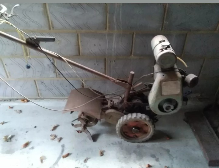

ParticipantJust got home from picking up another project from the bay auction house 😉 I can’t find a makers mark there are 2 casings that have MRH 1 and MRH10. there is also a supplied by Haynes Brothers Maidstone brass stamp on there. It has a Villiers 12hs engine came with a mower attachment and a farrow. due to it being dark and it’s still in the back of my car I am attaching an edited photo from the advert. Any ideas who made it and a model so I can get researching.
Take care and stay safe, Mike
November 30, 2020 at 11:00 pm #36038rollomk6
ParticipantHi Mike what you have is a Farmers boy Minor Rotary Hoe With a Villiers mk12 four stroke engine I have one but it has the earlier Villiers two stroke engine model 3g
Made by Raven Engineering in kingston on Thames these were built about 1958 hope this helpsDecember 1, 2020 at 11:24 am #36039coxey1979
ParticipantThanks Rollo, It’s even more vintage than I thought.Now my garage roof is finally fixed making room, once I have done so I will take some more photos I can see that it’s missing the depth bar so will have to fabricate one. there is a lot of surface rust thankfully no holes and only a little in the tank last time it was fired was about 40 years ago I was told it always had a weak spark so looks like I will be sending the magneto off for a rebuild.
looking on this site and the rest of the net I can’t find any reference to the mower / flayer and haven’t worked out where the belt goes. She is a heavy beast so struggling to get it out of my car on my own hopefully mife wife mobility scooter ramp will over come.
