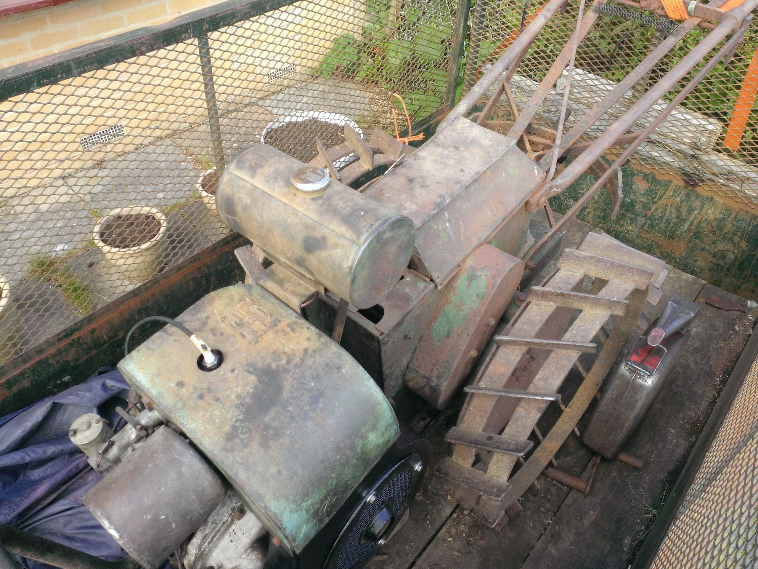

I’ve recently become the owner of a Trusty 2 wheeled tractor. It was given to me by my grandad who has had the machine for many years.
The tractor is in a rough but working condition and I intend to make it and all it’s accessories fully functioning but without doing any cosmetic restoration. It’s lived under an apple tree on grandad’s allotment for as long as anyone can remember, and has always been the “rusty trusty” and so it will remain.
To this end I have just fitted a new set of piston rings to the Douglas SV54 engine because of it’s excessive oil consumption. On disassembly it was found to have 3/8″ gap on the oil control ring! The new rings were bought from Cox and Turner Engineering – highly recommended.

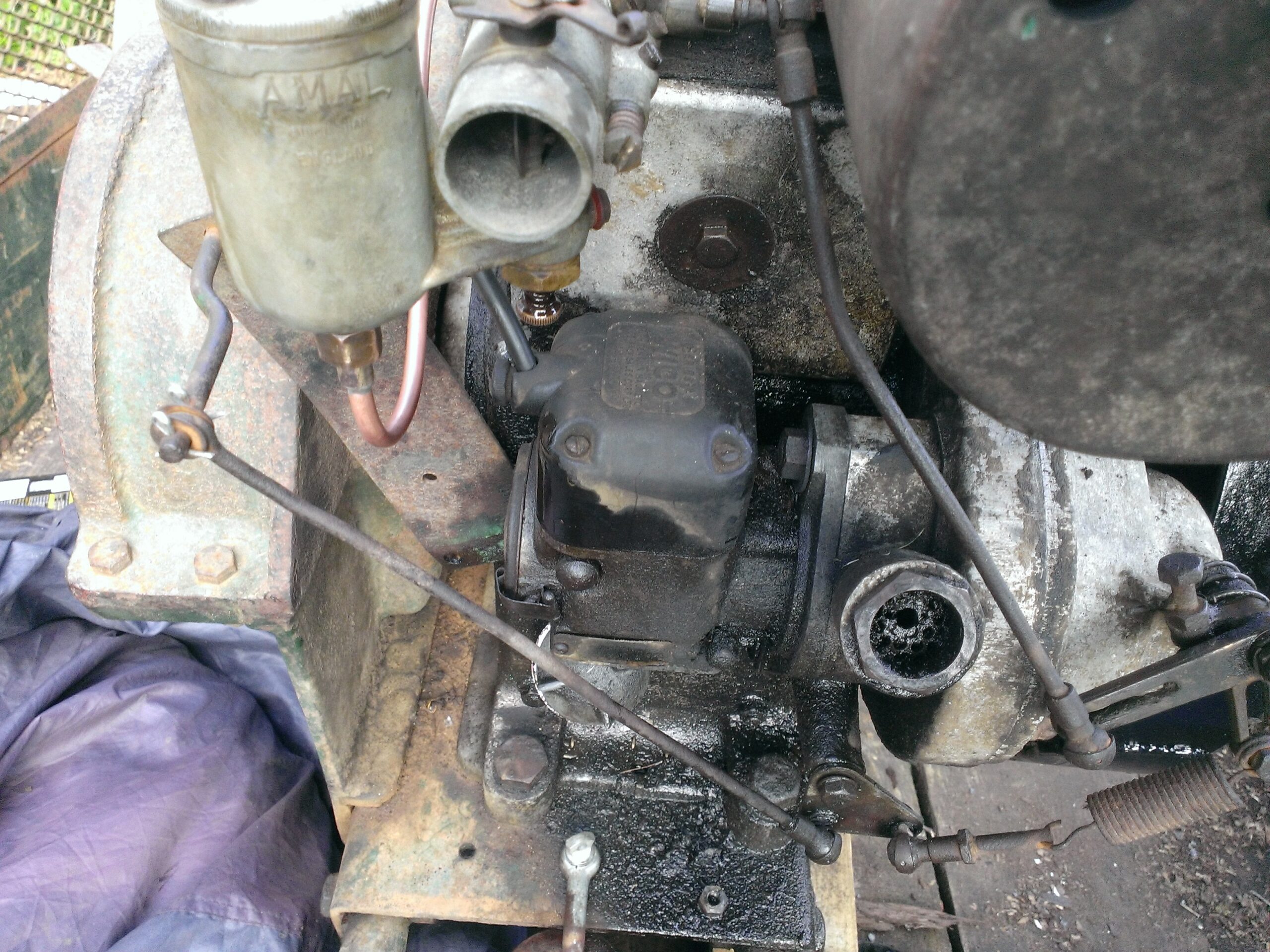

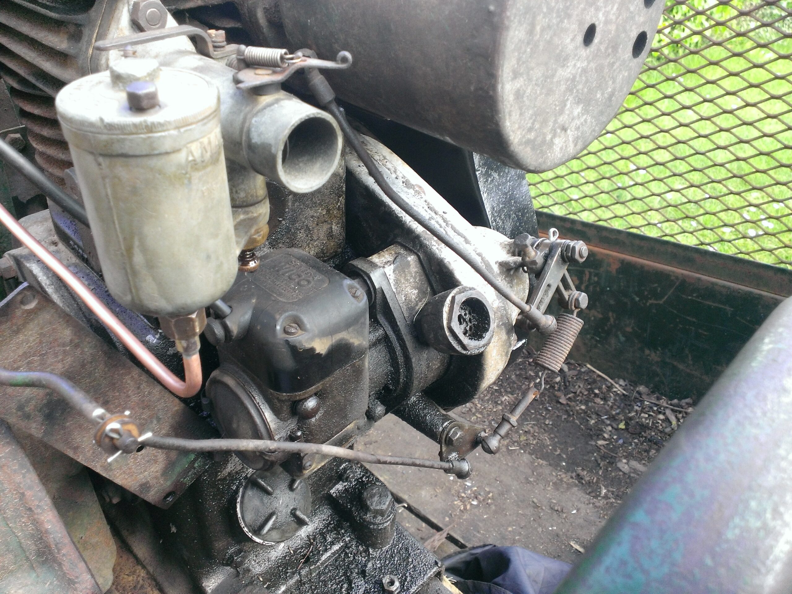

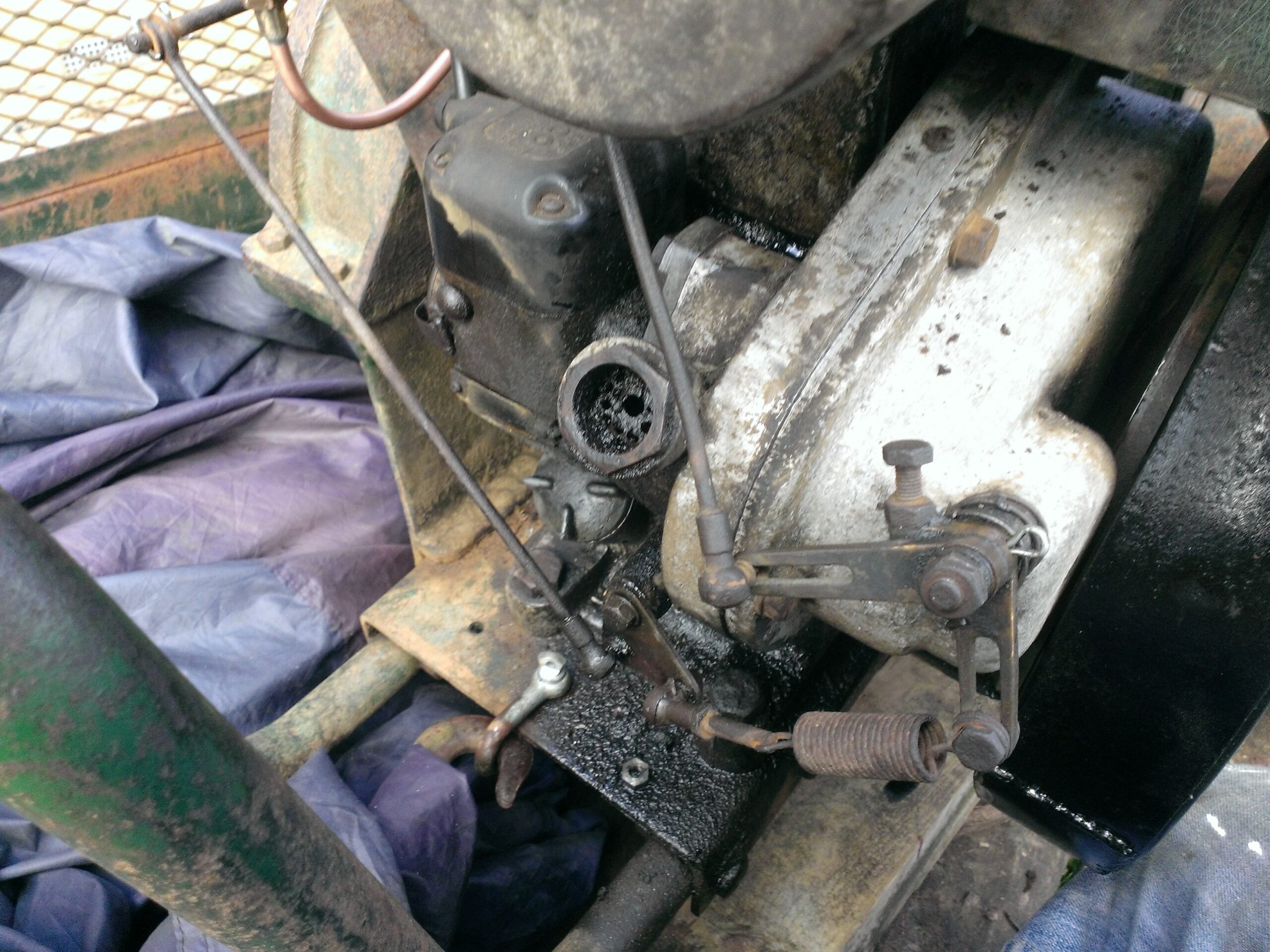

vhgmcbuddyMemberI am restoring a trusty with a douglas engine at the moment any chance you could post a close up picture of the linkage between the long trottle control rod that comes down through the handlebars and the carb ? I just used a modern B5HS NGK plug and its got a great spark/runs well.
May 5, 2017 at 12:36 pm #25109
vhgmcbuddyMemberI can take and post a pic of my throttle linkage over the weekend, but I’m not sure it’ll help you as mine has been altered at some time in its life. The air filter has been removed, and the filter bracket repositioned to one of the crank case bolts to hold the end of the throttle linkage by passing it through one of the filter mounting holes – something I need to sort out when I can find an air filter!
