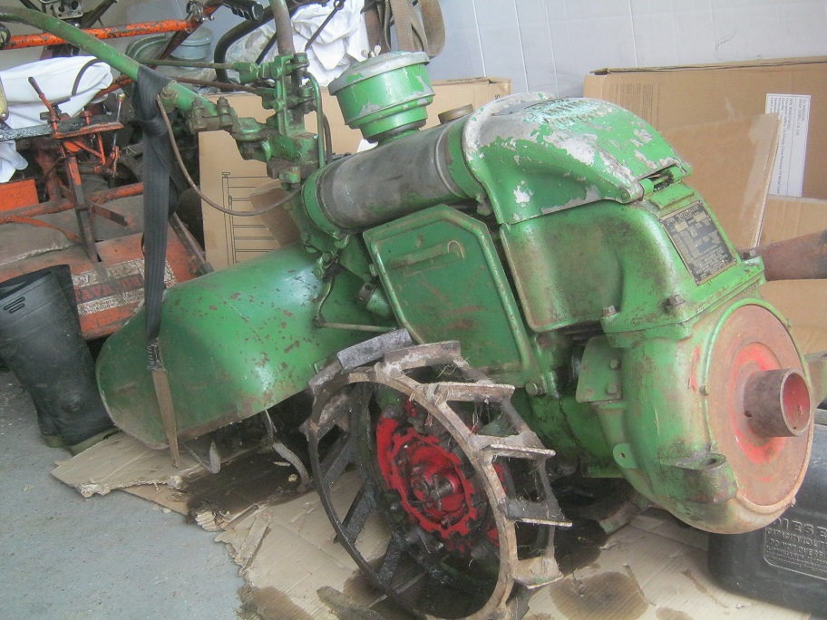

roatavatorParticipantHi all
Following on from my recent purchase of the Commer PB for transport, I couldn’t resist the opportunity to add to the collction of machines to go on her!
SIMAR 35, local to Norfolk/Suffolk all its life, all original paint and patina, currently has fixed tines but also came with spare spring tines and their rotor, and the rare petrol/oil mixer can.
Currently leaks oil like a sieve, but it has had SAE90 in the gearbox/miller and not 140, so with a bit of use and correct oil might be a bit better (hope so, don’t fancy having to replace seals after my last attempt on the 30B!)Good runner, so looking forward to putting it through its paces at working events.

stuartParticipantHas your old Commer got one of there 2 stroke diesel engines in her ??.Do love the sound of a multi cylinder 2 stroke diesel :):):).The old American made Detroit 71 series engines sound even better :):):).Very nice Simar rotavator you have there and it looks like it retains its original paintwork too.

charlieKeymasterGood original machine, hope the sae 90 has not caused any damage. Serial number?

vhgmcbuddyMemberNice one Peter. It’s even got side shields!!

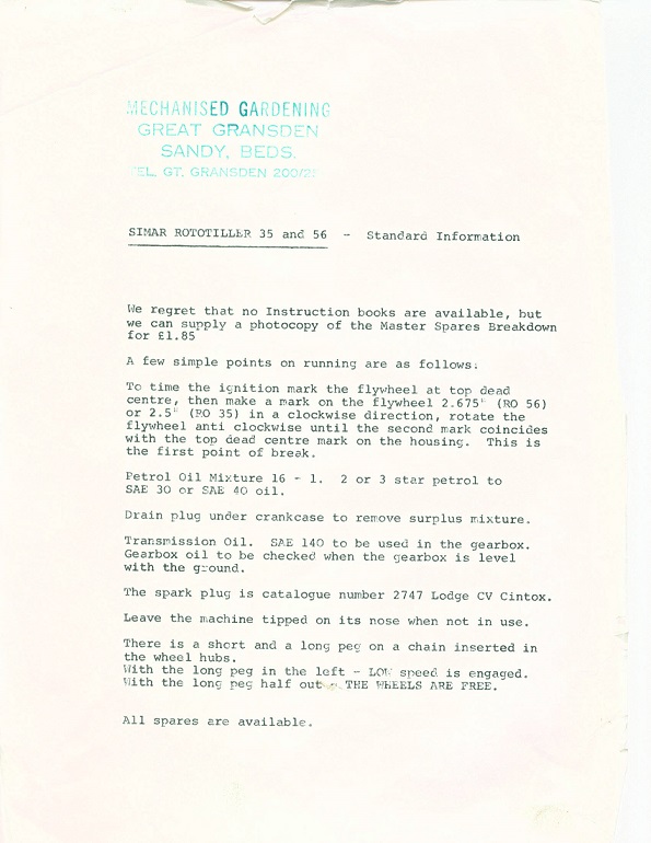

Busman,so far as I’ve always known its SAE140 in the gearbox.

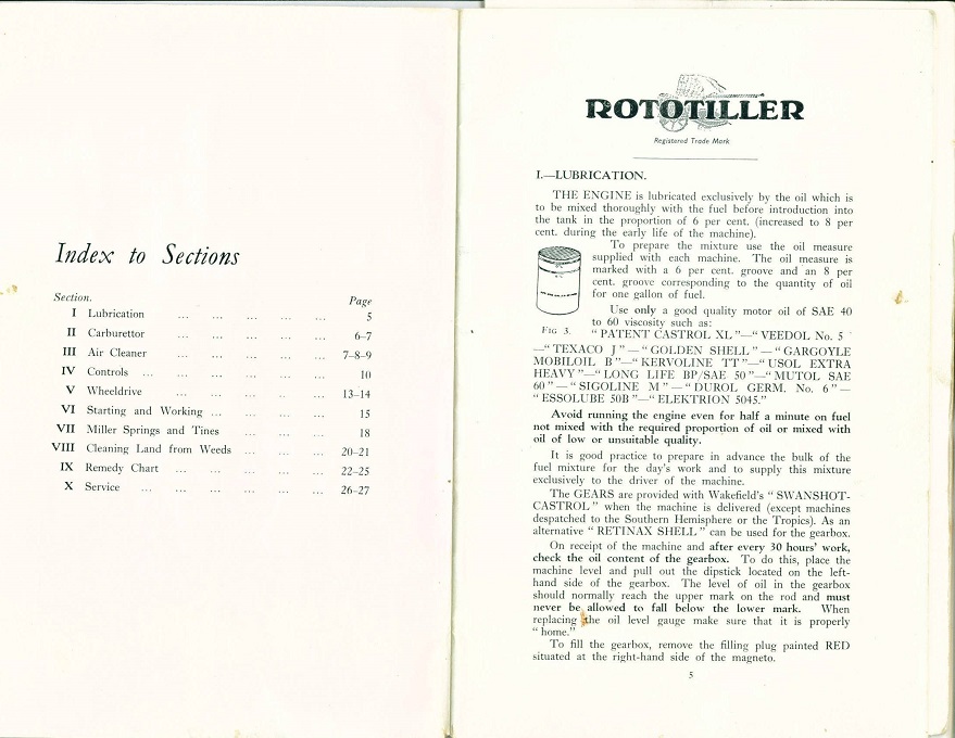

I’ve attached copy of the first page of my SIMAR 56 manual and an info leaflet from Mechanised Gardening who dealt with SIMARS after Monros packed up. Don’t know about old names for gear oil but MG say 140. Obviously, avoid EP at all costs.Peter

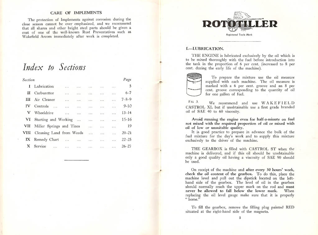

vhgmcbuddyMemberInteresting Peter!! Your manual is the same layout as the one supplied to me by Charlie, but lists different oils. Have attached the page from Charlie’s manual for comparison.
Charlie, do you know what year your operators manual is from?
Looking on the Simar website, the US version of the manual, dated 1950, states SAE140, with SAE90 being an option for cold weather use. The French manual does not give an SAE value, but does give Castrol Swanshot (as stated in your manual) and Shell Dentax as possible gearbox oils. Confusingly, Shell Dentax is still available in both SAE90 and SAE140 grade!!!
Looks like I am going to have to spend even more money on the Simar and buy some new oil!!

roatavatorParticipantFacinating on the oils, my manual is from when machine supplied in 1949, but MG leaflet I’m guessing is from 1970’s. You takes your pick…… thicker oil may stand less chance of leaking out of seals!

charlieKeymasterI have had a look through various operator manuals I have for different Rototiller models, see below:
50 & 30 Castrol D or Swanshot ST
50, 51 & 30 Castrol Swanshot or Shell Retinax, one copy has an erratum slip stuck in which also lists Mobiloil C
35 & 56 Castrol ST or SAE 90
Unfortunately none of the publications have any dates. The manual that came with my 1948 model 56 has the lubrication page missing.
One of the important points is to use an ST rather than EP oil. I use Morris Oils AG140.September 30, 2015 at 4:54 pm #14695
vhgmcbuddyMemberAs I have replaced all the oil seals on my 56, I think I will give the SAE90 a try, particularly as I have 20 litres of the stuff and don’t have any other machinery that uses this grade oil. If it does leak, at least I have plenty to keep topping it up!!
