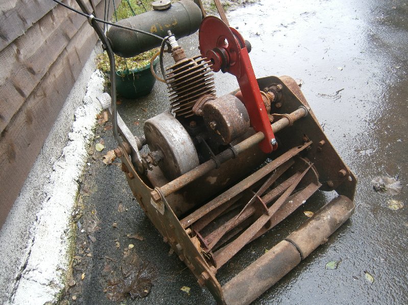

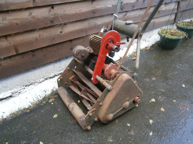

    Trial fit of Cooper Stewart drive on the ATCO this morning, dodging the rain showers !!

    That set up looks familiar or very similar to the one my father had, the photo dates from circa 1959.

    Thanks Charlie, it was the photo you put on the old forum that convinced me to bid for this ATCO, it certainly looks the part on it…

    paul an interesting accessory,do you need a v pulley to fit onto drive shaft to give it motion ??
    #4387
    Not sure yet John, need to get the mower going and try it out first and see what is what…
    #4403
    If I remember correctly it is a segmented drive belt.
    #4488
    That figures Charlie, then you don’t have to disturb the drive shaft to fit and remove the belt… need to get one somewhere then, a job for the new year !!

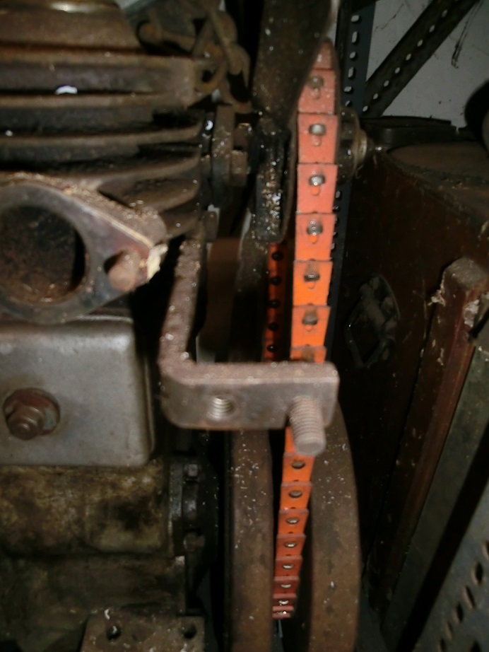

    Ray, your post on link belts solves a mystery and brings back memories. The mystery was the tool shown on your link – I was looking at one in my tool box t’other day and wondering what it was for!
    The memories go back to 1960 when I was working for a farmer who was into the latest thing – washed and pre-packed potatoes. The spuds were stored in one building and washed through flumes in the floor and under a farm access road to the washing and packaging plant using large volumes of recirculated water. This water came from a holding and settling reservoir and was moved by a large pump down in a pit driven by an ex-government 6-cylinder diesel above, Chrysler I think, connected together by a quadruple link belt drive.
    One of my jobs was to wake the diesel up in the morning – copious quantities of “magic breath” and another was regular belt shortening sessions, aided not by the tool in the illustration but by one similar to a pair of pliers with flat right angle ends. Happy days!
    Anyway, attached is a pic of the link belt installed to drive the fan on my spare Dennis engine.

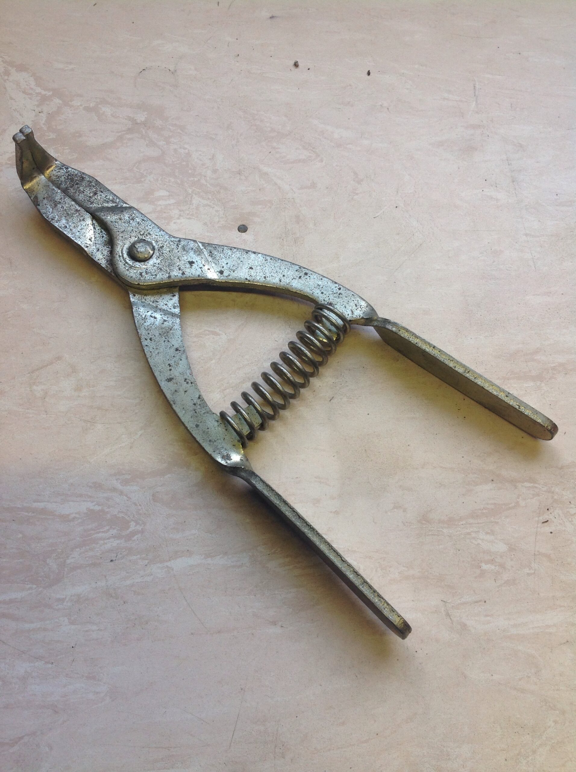

    Think this may be the tool you describe, it is used to spread the links of the older style rubber and canvas link belt. Otherwise known as Brammer belt if I remember correctly.
