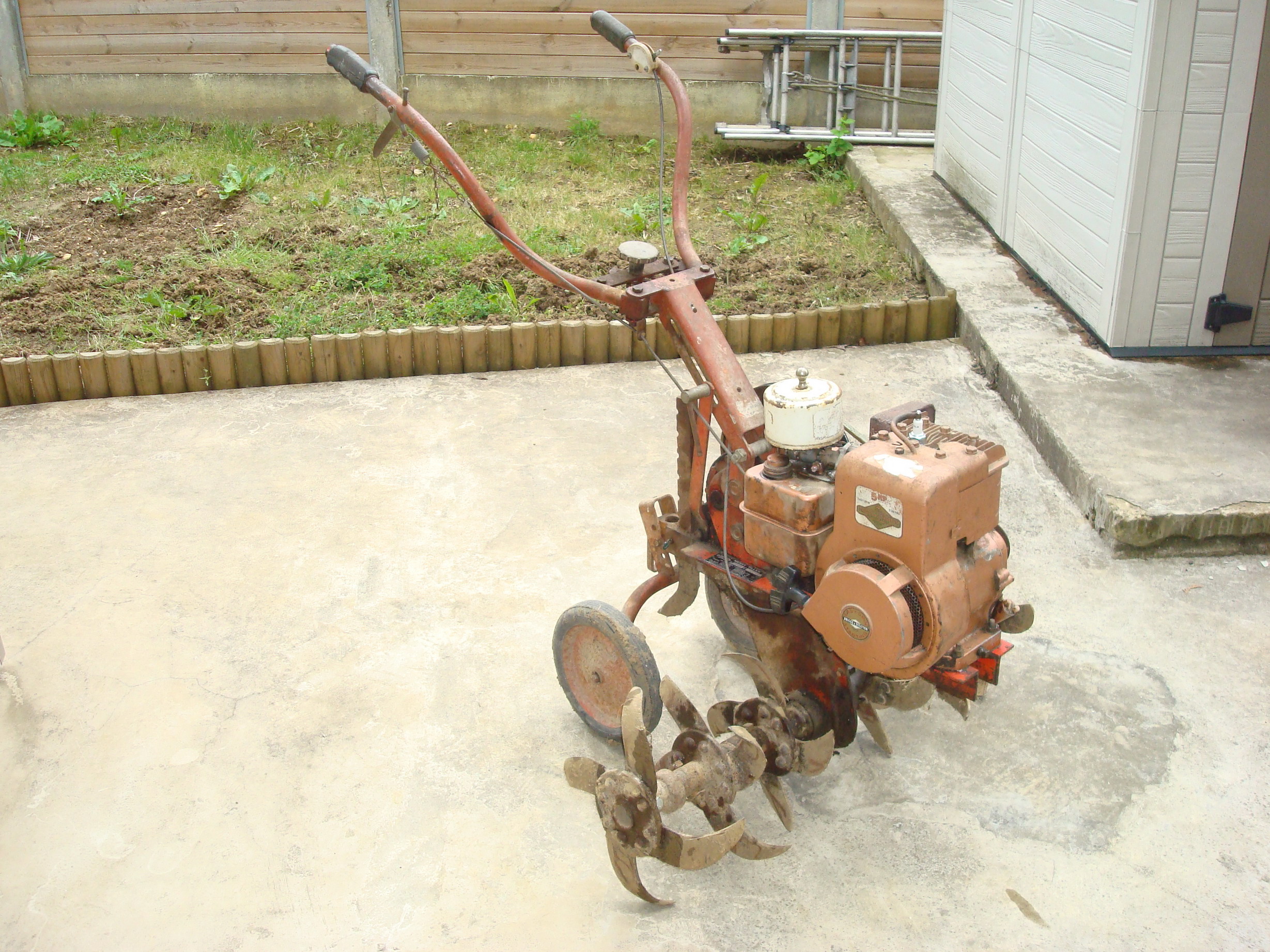

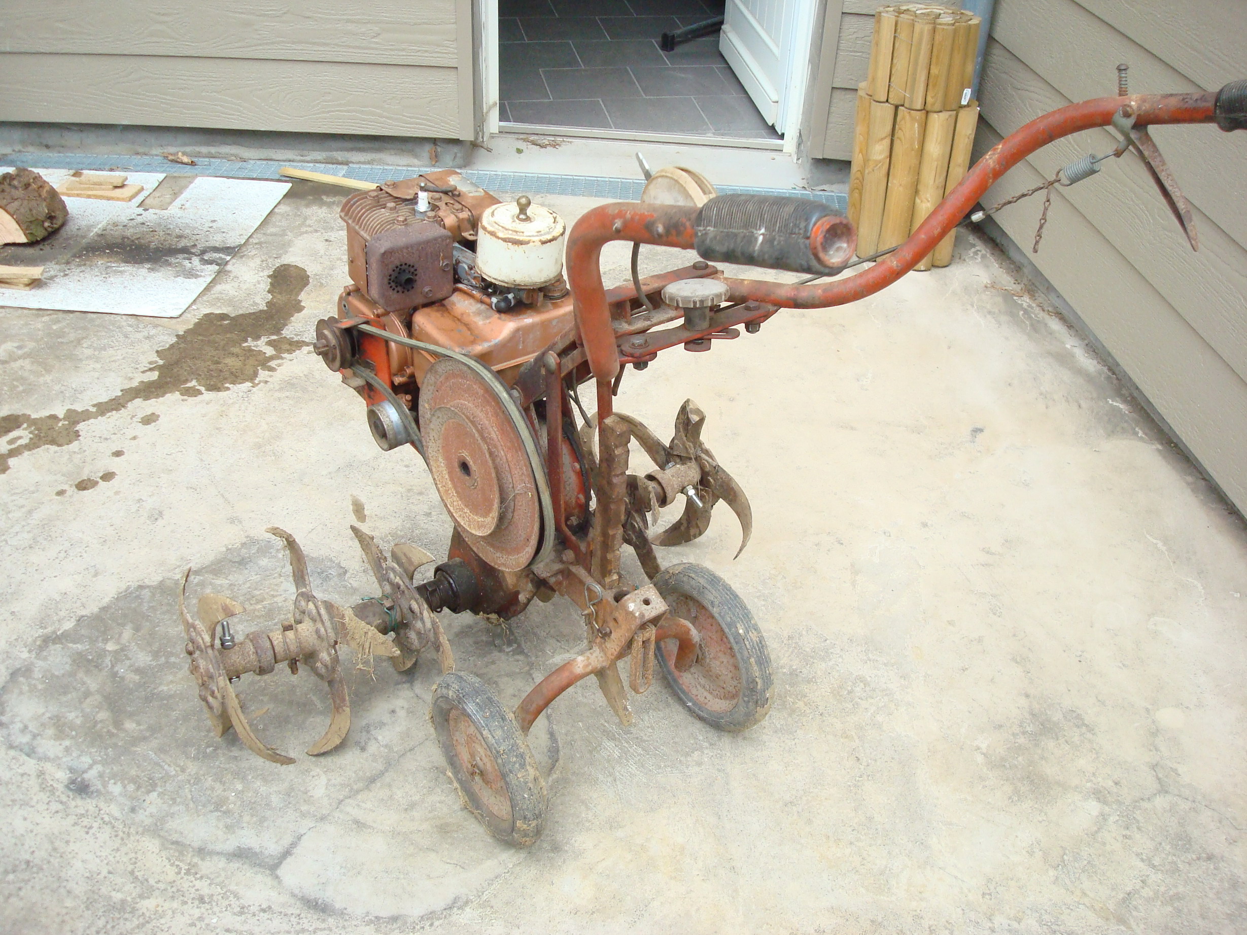

I was given a Merry Tiller rotovator and don’t know the model (all labels are worn). I need parts for it and need the model, all information I have are :
PAT NO 714394
SER NO TMT101173
Engine is a Briggs & Stratton 5HP 130232 code 75051210 (12th of May 1975).
I think it’s a TITAN, but not sure, it’s very difficult to find model on the web only with picture…. Can someone of you help me please? ThanksMay 28, 2014 at 7:08 pm #8353

stuartParticipantA 5hp Wolseley Merry Tiller from 1975 will either be the standard Titan model or the Titan GT (Gear Transmission) model.Both models have a double V-pulley on the engine and on the transmission / chain case.This gives 2 forward speeds (High and Low ratio) on the standard Titan model and 4 speeds plus a reverse on the GT model as this one also has 2 speeds in the transmission.
I have a folder full of MT owners manuals and parts lists but many genuine parts are NLA / Obsolete.
The Titan GT was also available with a 7hp Briggs and Stratton engine.May 28, 2014 at 10:34 pm #8363

vhgmcbuddyMemberHi Stuart, from your indication, I have a standard Titan model. It has only 2 forward speeds without reverse. Can you share your folder with me?
