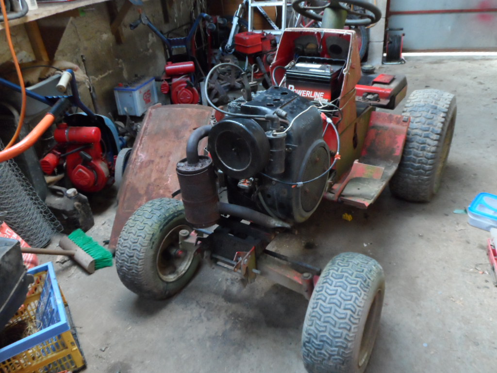

vhgmcbuddyMemberThis is keeping me out of mischief at the moment bought as spares or repair, so far new fuel pipe, robbed a battery from my W H 512 D, cleaned the carb, the key was rusted in the starter switch, WD and a lot of gental persuasion the key came out. Cleaned it up put it back in gave it a turn nothing. I was thinking new switch, checked the wire from the switch to the solenoid to find bad connection cleaned that up few turns and it fired up. Engine sounds OK bit of backfire then shutting back from about 3/4 throttle, all gears appears Ok but I will have to drive it around a bit. I got it on that site but it was local so I went to view it first to see what was involved. On seeing it my first thoughts was to break it but yesterday when it barked away I’m not so sure, you can see the bonnet is rusty but only seems on the surface. There’s no identification tractor or engine but I think the engine is 14 hp K321 that would make the tractor a C145. Is there any external differences between a Kohler 14hp and 16hp. Thanks.

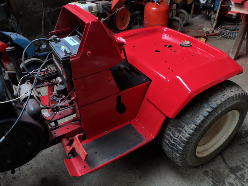

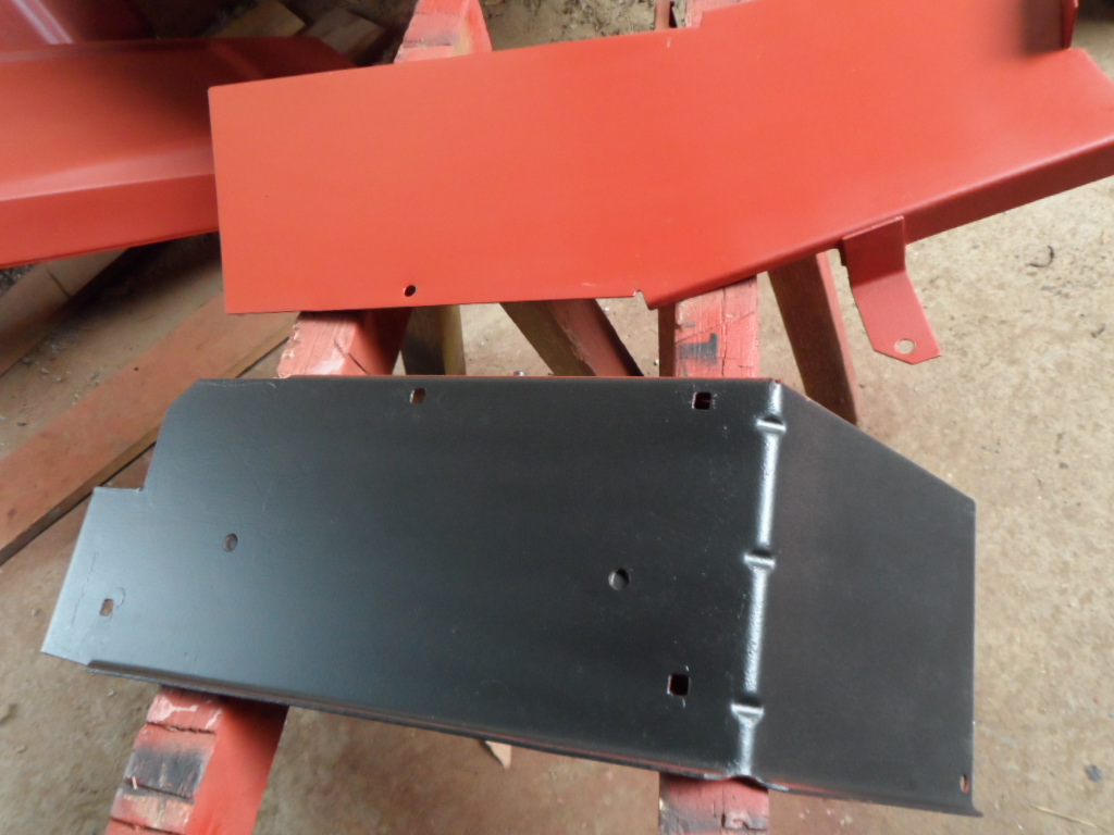

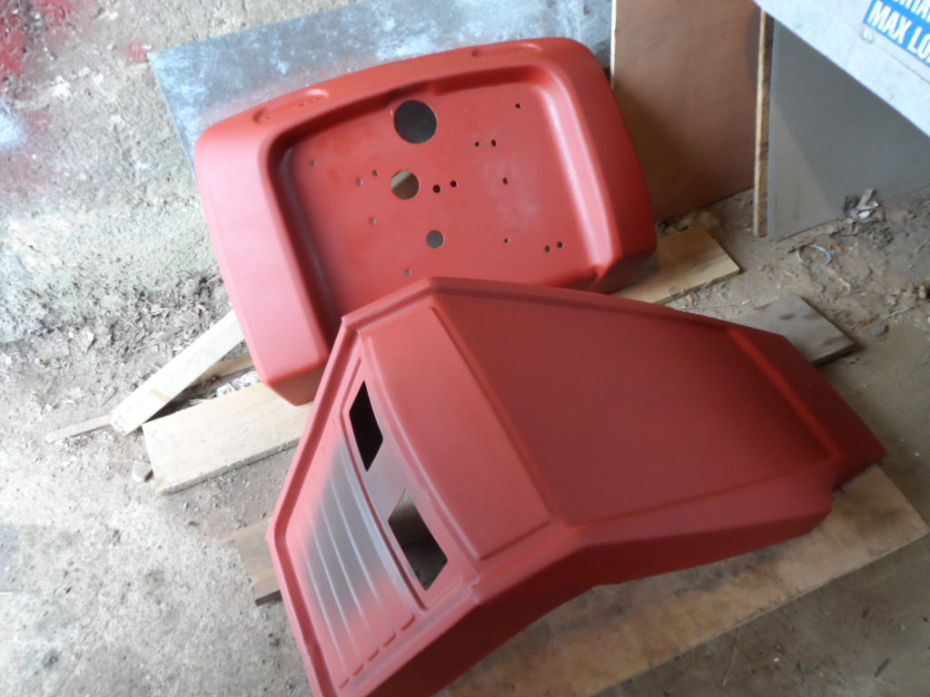

vhgmcbuddyMemberHello sidevalve. I’m afraid my spraying facility’s are basic so I see the red mist, I try opening the garage doors and spray outside then the weathers suitable. But it’s getting past going outside now, I’ve only got the bonnet to final coat, so it’s getting their. I am waiting for an exhaust I ordered from USA. I will put a photo on hear when it arrives,

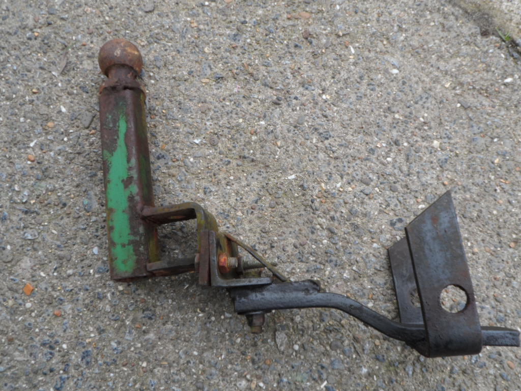

vhgmcbuddyMemberJohn. Not a bad looking tug but bit square and uninteresting, I think a WH has a lot more caricature. I don’t think Frankie will be pulling planes again. I will try to find out more as to where Frankie was working it would be a few years ago. I have received the exhaust from USA more to follow on that. Bellow the hitch Frankie came with, easy to obtain a wheelie I would think.

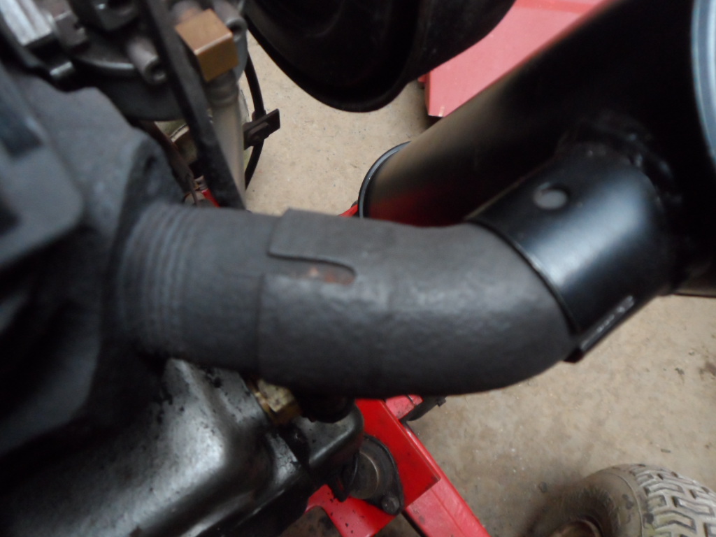

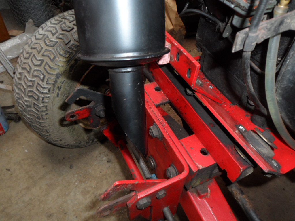

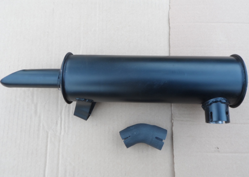

vhgmcbuddyMemberI received the new exhaust 13 days form USA.Then another 13 days to fit it, only joking it wasn’t that bad I had to cut a piece of pipe off the old exhaust to make it fit also the bottom fixing bracket was off angel and needed a extra strip of metal made up to secure it. So needed a bit of playing around with but now it’s tempery in place looks OK. Short piece of flexi pipe would have made fitting quicker and I recon it could be fitted along the side. Cost including carriage and import duty was £42.03. Frankie’s beginning to look a bit smarter.

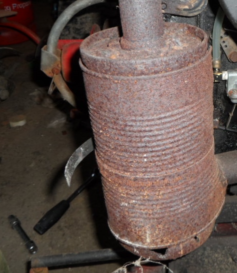

vhgmcbuddyMemberyour getting on better than I thought. the replacement from the states was a steal,you would nearly have to pay twice that here. just noticed on the photo of the old exhaust, that stacked on top of each other there is two catering sized cans as a repair. possibly Heinz ? one of there 57 variations
