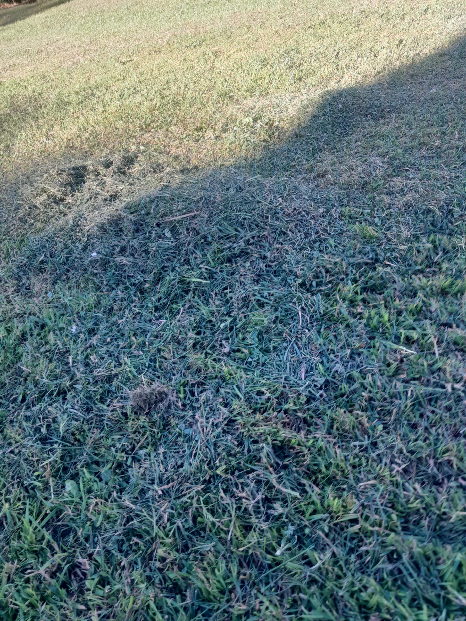

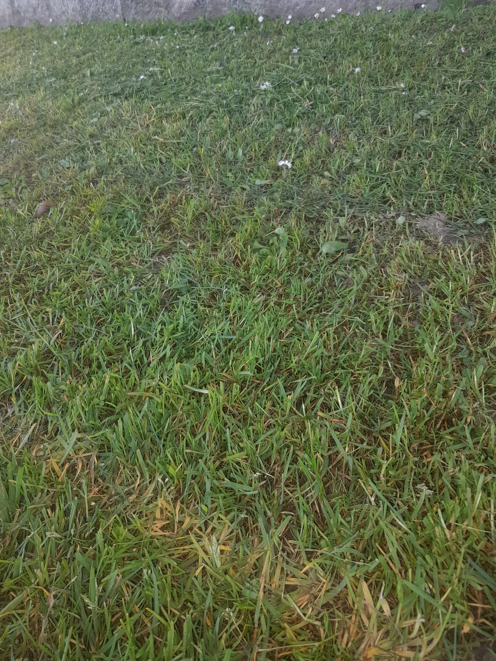

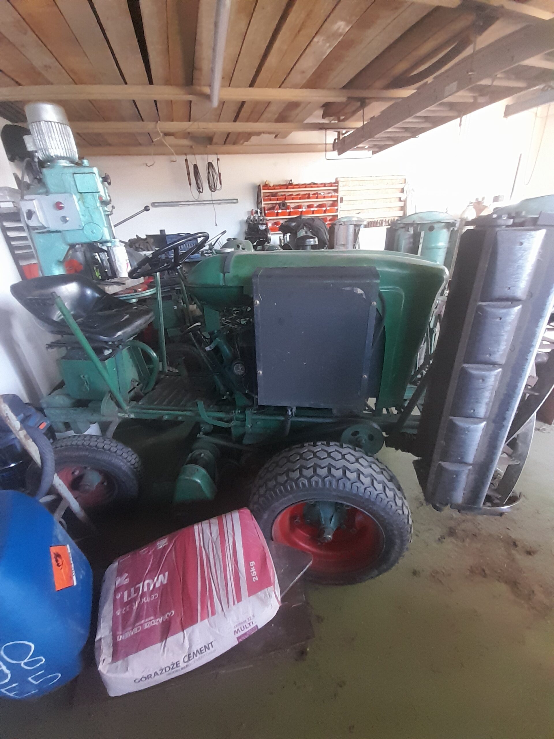

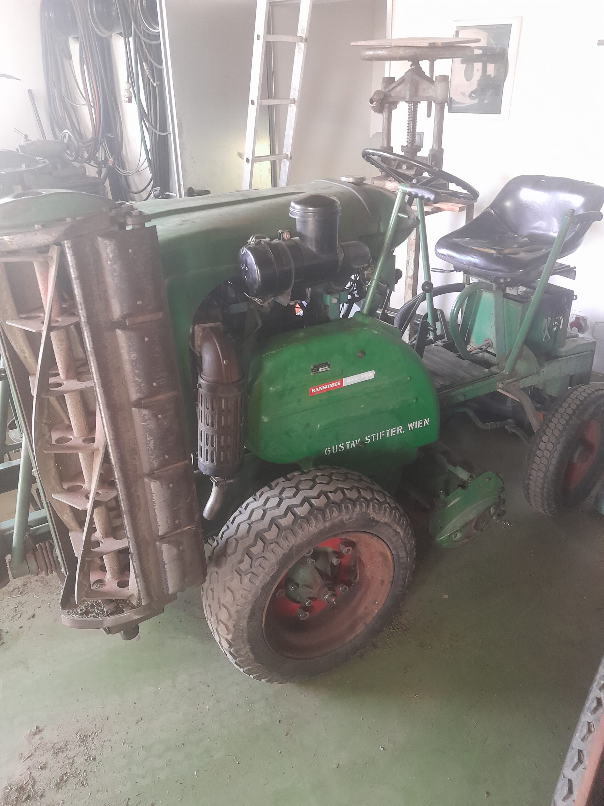

ParticipantHi when I mow the lawn the grass is very striped and not cut into small pieces. could someone tell me why and how can i fix it?
May 13, 2024 at 5:49 pm #42240
hdtrustParticipantHi send me some photos of your machine and the lawn
May 14, 2024 at 7:36 am #42243
charlieKeymasterYou need to compress the photo files to less than 4MB.
May 14, 2024 at 7:44 am #42244hanysmiglanc
ParticipantMay 14, 2024 at 11:38 am #42255
charlieKeymasterAre the stripes across whole width of area covered by machine or only one of the cutting heads?
May 14, 2024 at 12:18 pm #42256chris

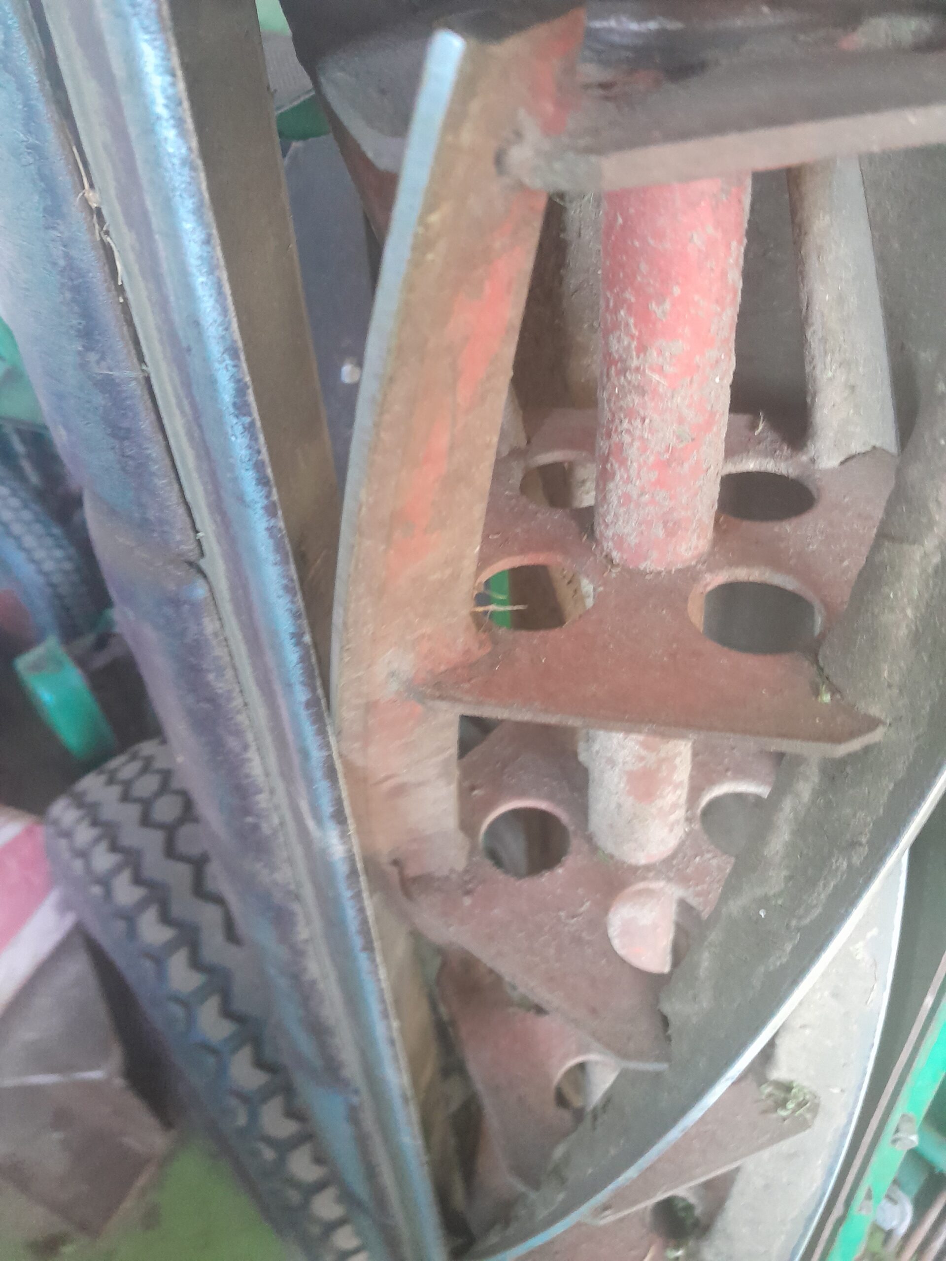

ParticipantI would suggest that you reset the cylinders to the bottom blade, they should cut paper(not newspaper) you should get a clean cut along the whole of the blade . You might need to lap the cylinders if you cannot achieve this.
Reduce your forward speed and increase your cylinder speed if you can.Chris
May 14, 2024 at 5:23 pm #42257hanysmiglanc
ParticipantI can’t increase the cutting speed but i can’t cut any paper with that even after adjusting. This happens on all cylinders. And can you do backlapping without paste?
May 14, 2024 at 11:23 pm #42260chris
ParticipantWe would use grinding paste and diesel or parrafin or light oil . If they are really bad they ought to be re ground.but lapping should improve it.
Is your location a remote one or could you aquire some paste on the internet or a local supplier or mower repair place?May 15, 2024 at 2:16 pm #42264hanysmiglanc
ParticipantI can aquire some paste from internet but it’s pretty expensive and that’s why I asked can you do lapping without paste.
May 15, 2024 at 6:31 pm #42265
wristpinParticipantTo back lap properly use a water based paste , not oil based as in valve grinding paste. Water based so that when done you can hose it off and get rid of every trace before rotating the cylinders in the cutting direction. Leaving a trace of paste “ undoes” some of the sharpening effect gained by the back lap. In an ideal world neglected cylinders should be relief ground to create some space to retain the paste during back lapping. Applying paste to well worn cylinders results in much of the paste being thrown off before it can get to work.
A Motor Triple with four bladed units will deal with quite heavy cutting but to get a good finish reduce the forward speed to increase the clip rate aka cuts per yard. There is an art to obtain a good finish with commercial powered cylinder equipment and even more skill required in using wheel driven gang mowers.May 15, 2024 at 8:21 pm #42266hanysmiglanc
ParticipantCould you tell me how to reduce the forward speed? Is it just riding slower or will this require to adjust the belts?
May 20, 2024 at 7:25 pm #42280hanysmiglanc
Participanthi i’m ordering the paste and could someone tell me how much paste i’m going to need to sharpen all 3 cylinders?
May 21, 2024 at 8:11 am #42281
charlieKeymasterThe amount of paste required will depend on how blunt the blades are, so impossible to say how much you will need.
May 22, 2024 at 10:08 pm #42306
wristpinParticipantNot sure where this is going but it should be accepted that back lapping is to keep the edge on cylinders that have been properly ground. Not the process to use to recover really blunt blades.
