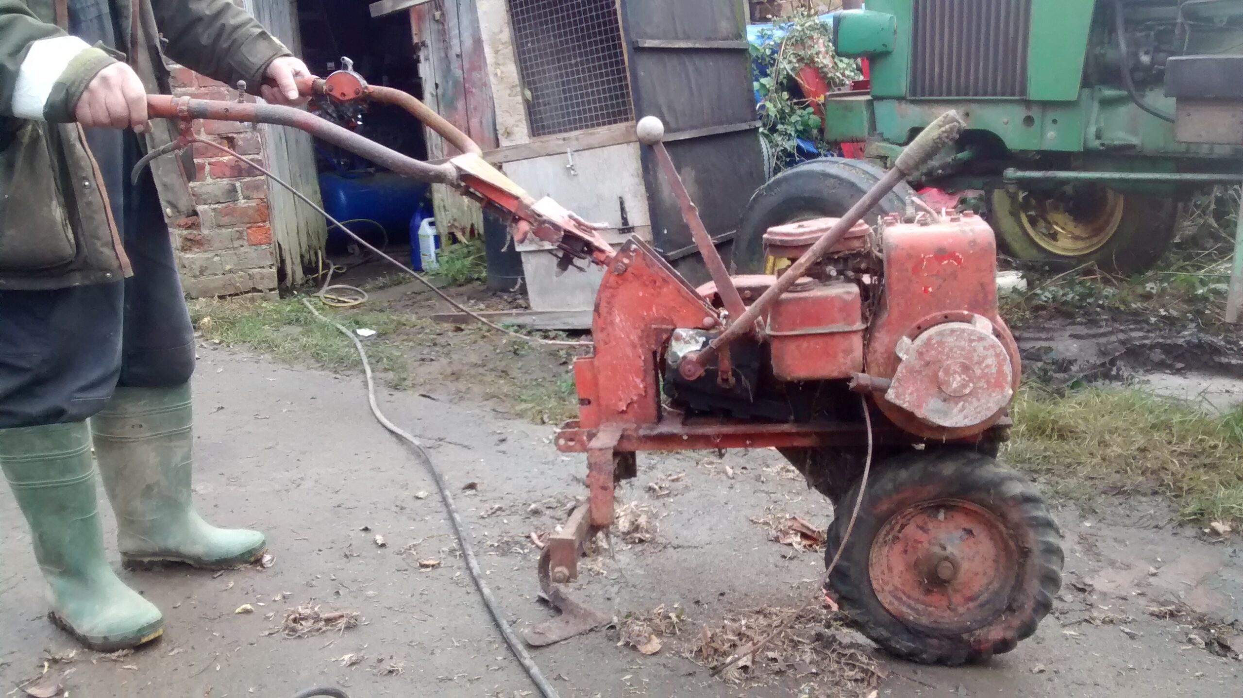

    Hello,
    I’ve been helping a guy moving his machinery and we’ve come across this single wheel motor hoe. No makers name or id plate on it, just a mark where a sticker has been. Anyone know what make it is,
    Thanks Ian.
    #23417
    Handle bars look like Merry Tiller, so does the chassis. Could this be a modified Merry Tiller that someone has added an Albion gear box to? A photo of the other side would help.

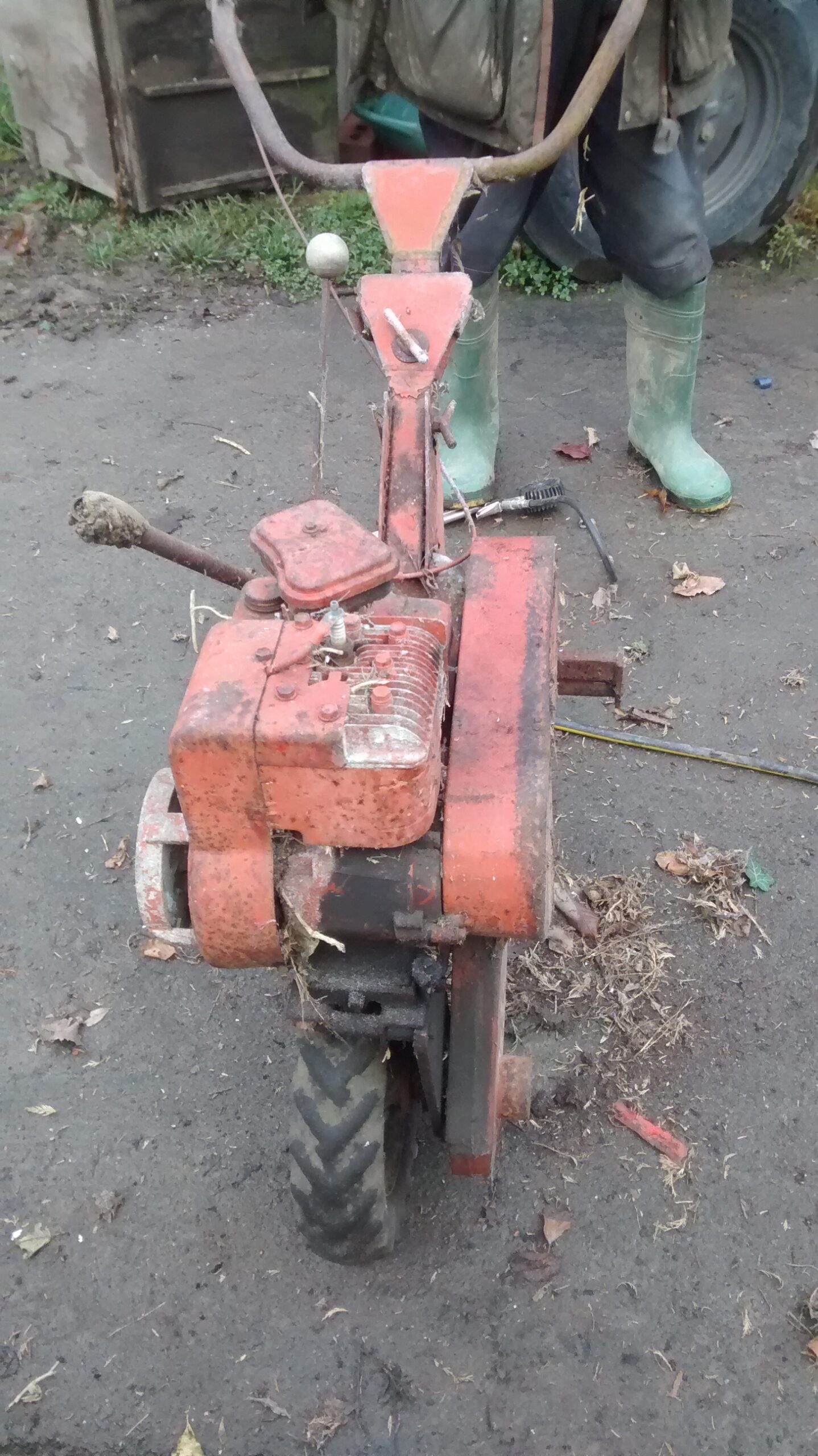

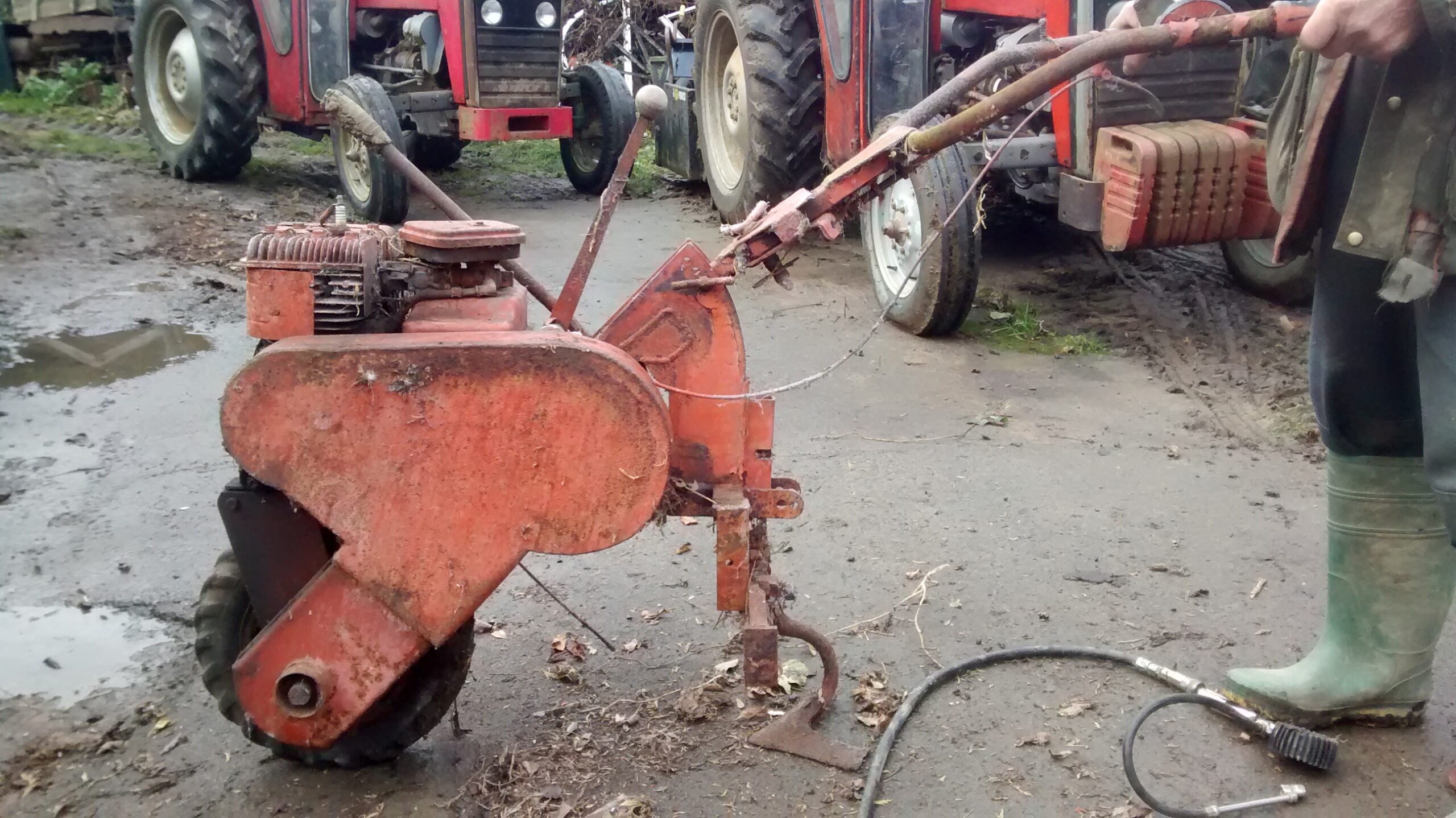

    #23420
    L/H side
    #23422
    Front
    #23425
    I’m with Charlie on this one , it certainly shows signs of being a homemade conversion , although I’d say the handles are Westwood.
    #23427
    The welded chain case looks Westwood also.

    joegrgraham
    The gearbox / chassis reminds me of a Colwood, what is the engine? Clinton?
    #23429
    I haven’t a clue what engine is on it, it looks as though it’s had a sticker on it though.

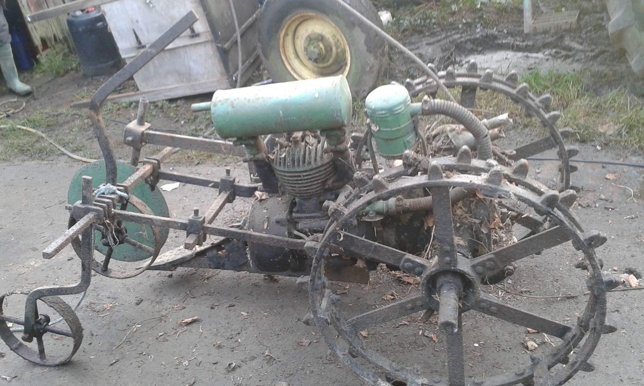

    #23430
    We also uncovered this Coleby with a push plough.
    #23432
    stuart
    The chaincase and handles are Westwood as Wristpin has already said.The engine is a Briggs and Stratton.
    #23435
    The Coleby looks as if it has been modified too.

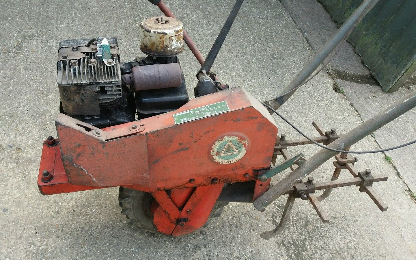

    #23442
    The orange one looks very similar to this Mayfield one currently being offered on a certain selling site.
    #23444
    Just realised that it had Allen Mayfield on the belt guard so guess that it’s a real ” bitza”
    #23497
    I can’t recall the proper name or model for it , but that is a genuine Mayfield product.
    #23499
    Prompted by Andyfrost’s comment I take back my “bitsa” comment – how about a Mayfield Hoe and Mow?
