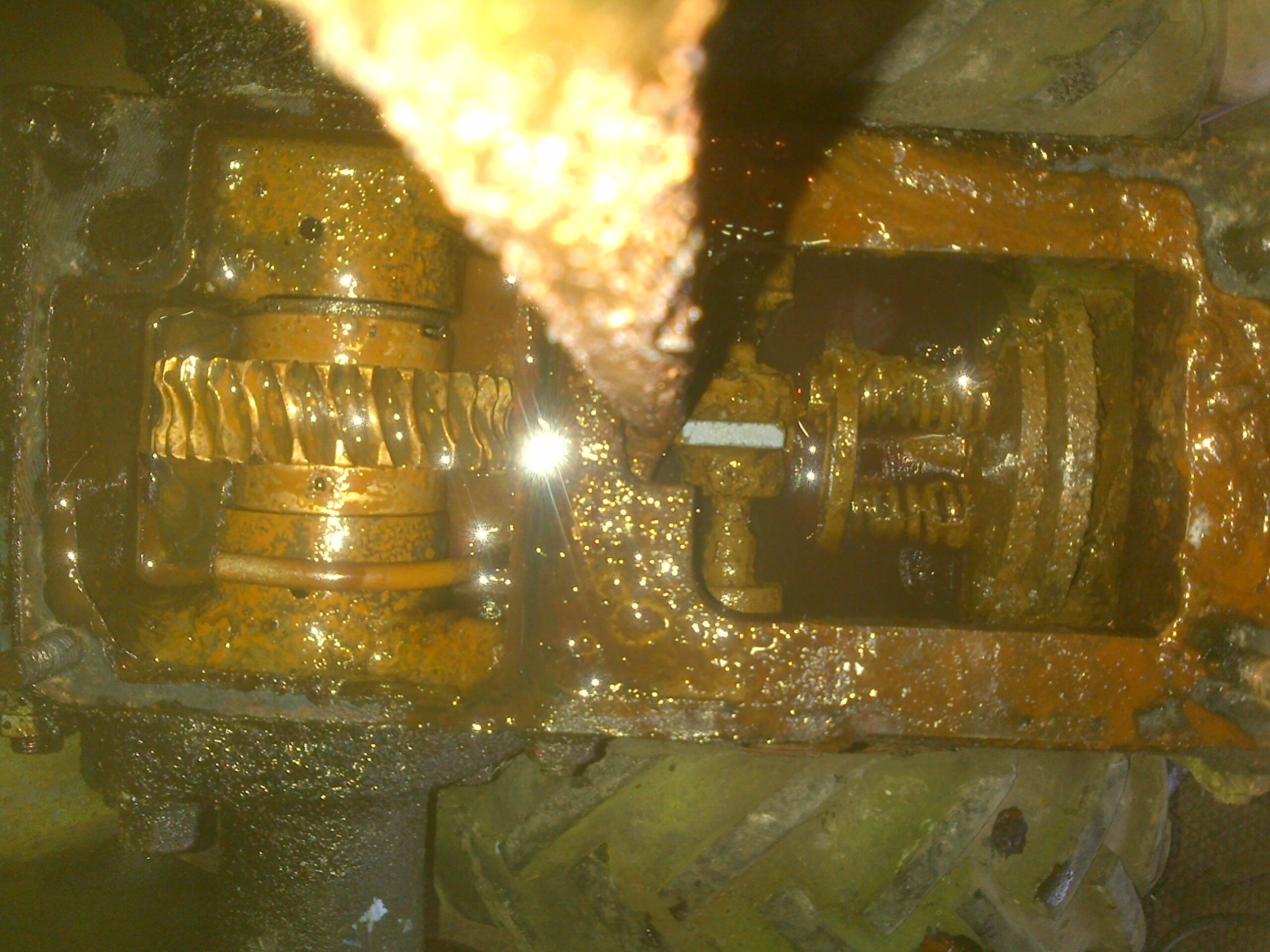

Took the spanners to it tonight, the engine refused to budge, so I decided to remove the gearbox top………take a look at the picture to see what I found.
Aside from a vile, rusty, gungy, water-filled mess, the bracket that hold the clutch cable is broken off.Oh bu**er!.

joegrgrahamParticipantI presume the gear visible in the picture isnt supposed to have teeth that shape?

the bronze gear is that shape so it meshes with the work on the main shaft. It does not look too bad, I have seen them with sharp edges to the teeth caused by excessive wear. It might be worth giving the gearbox a good wash out with degreaser and a power washer. The engine is held on by 4 bolts/studs. I think I need to have a dig around in the shed and find some Monro bits to photograph to give you an idea of what it should look like and how it should come apart.May 6, 2015 at 2:54 pm #12943
joegrgrahamParticipantThanks Charlie,
Its encouraging to know the gear is supposed to be that shape.I’ve got the four nuts off the engine, its just the ‘sticktion’ holding it in at the moment.
