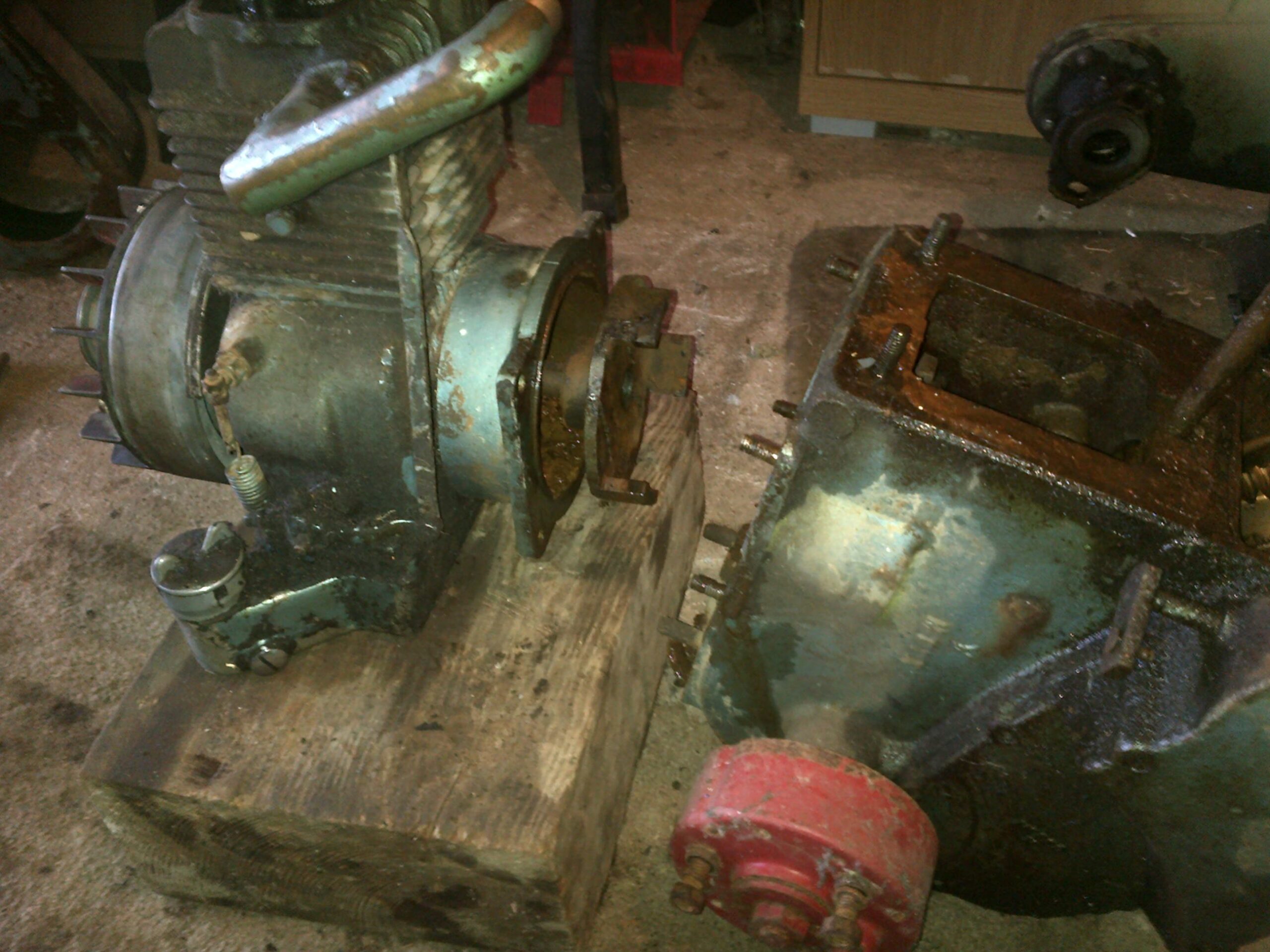

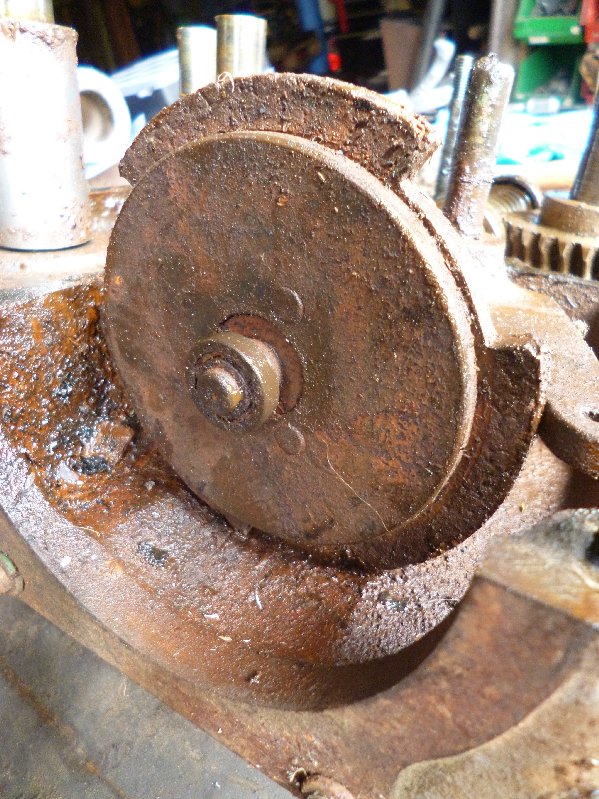

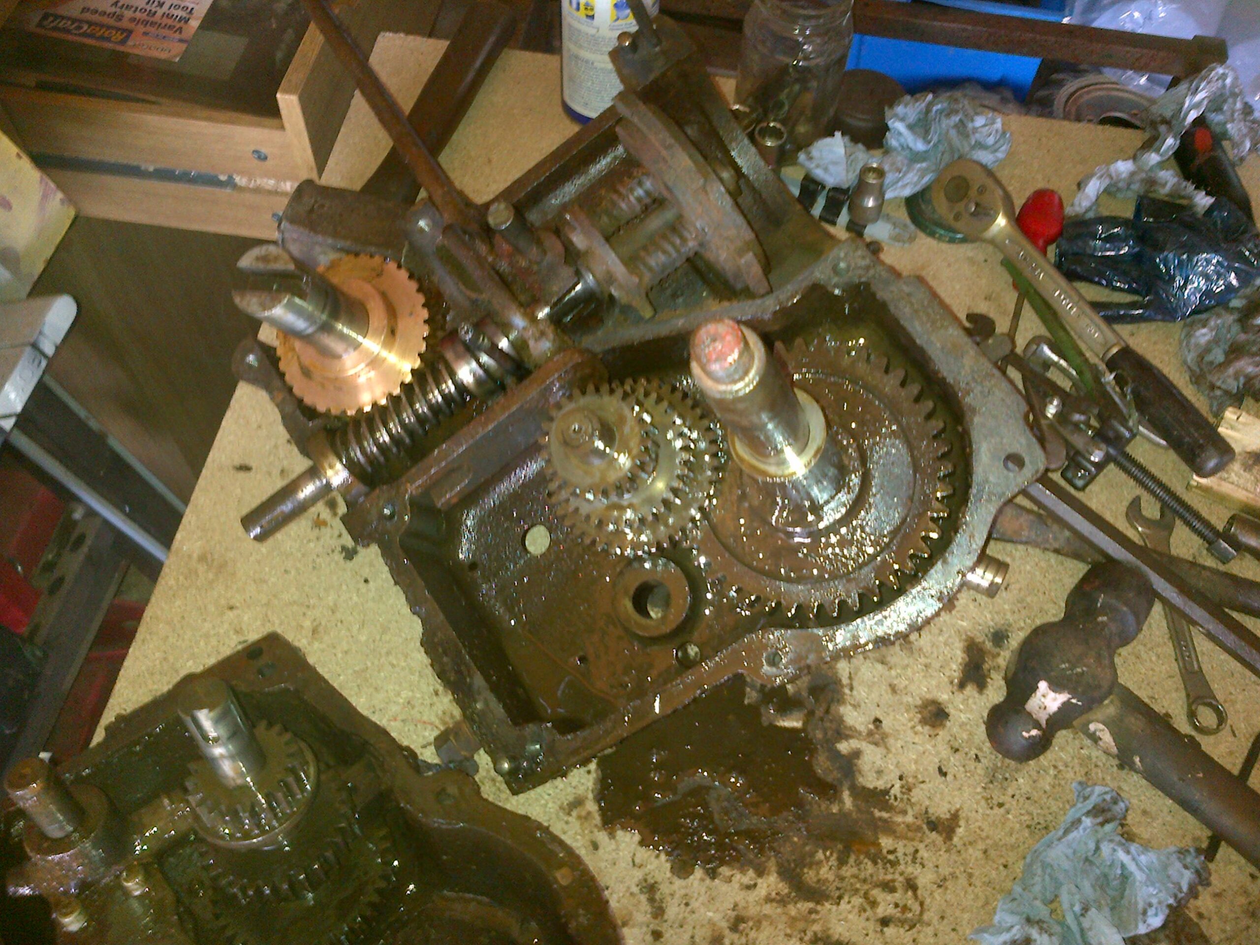

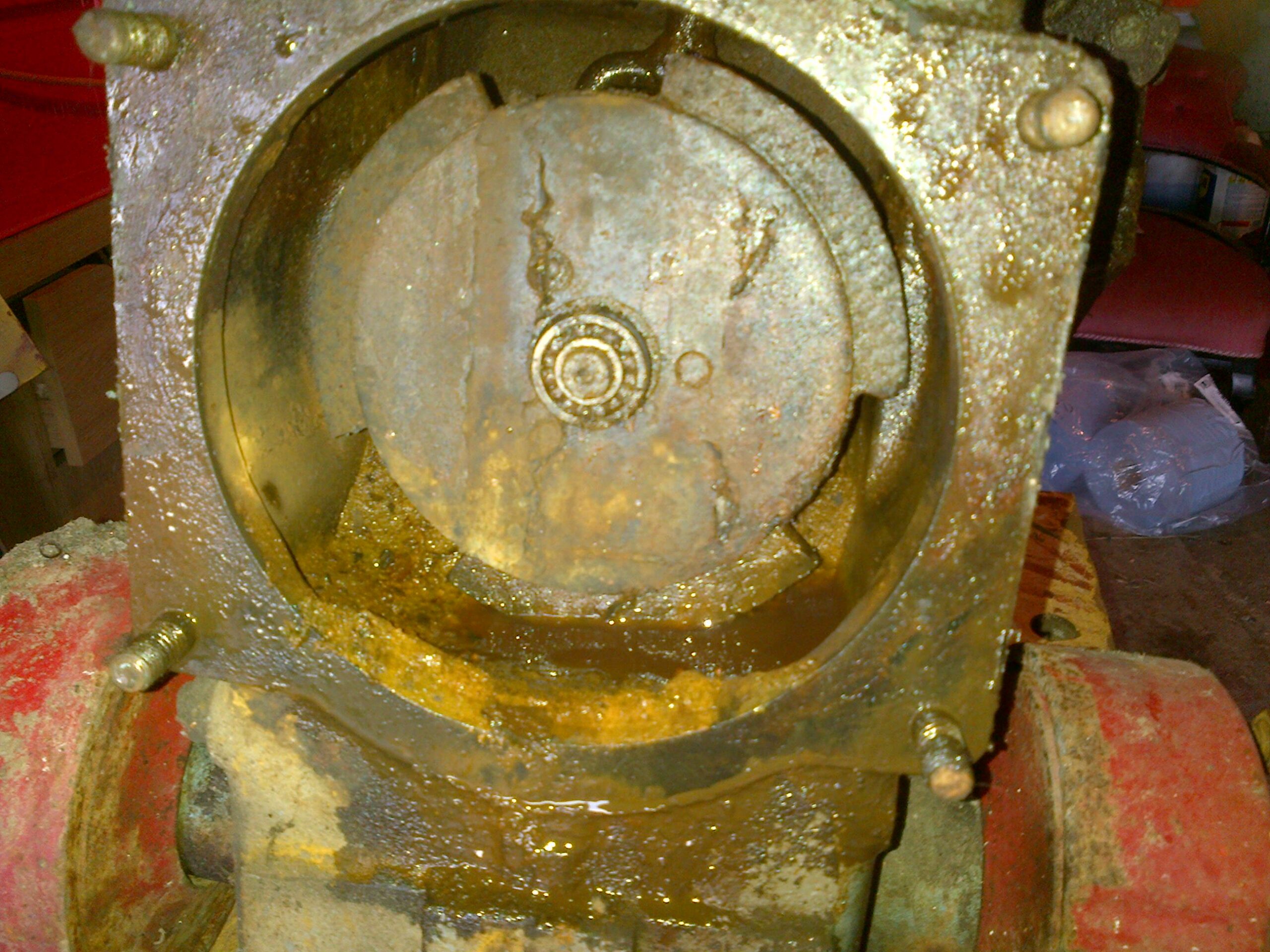

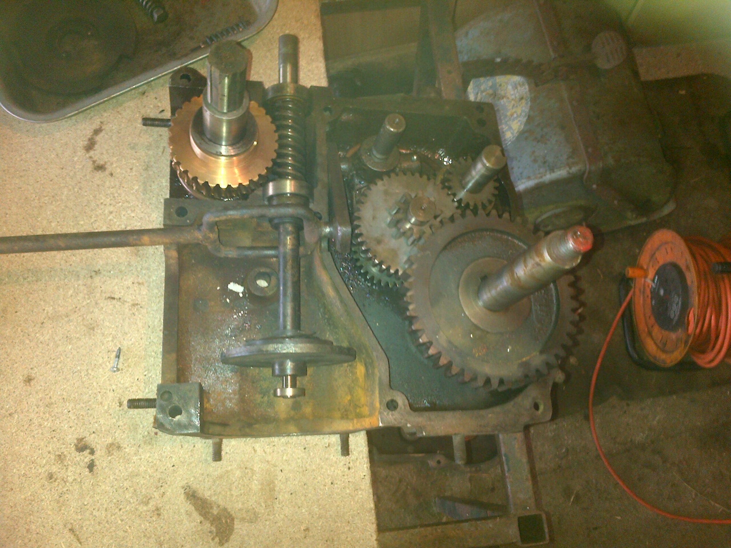

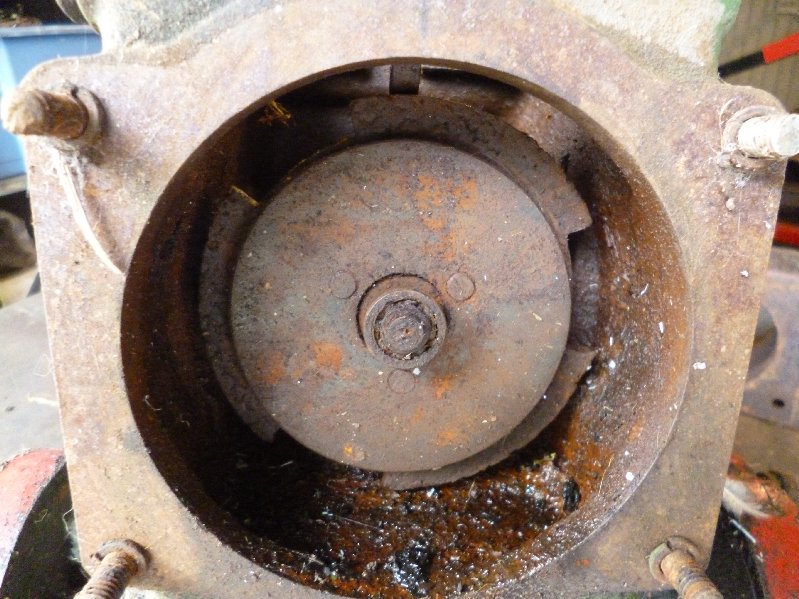

charlieKeymasterI think I can see what the problem is. The bearing MT90 on the end of the input shaft MT18 is probably stuck (rusted) in the clutch drive plate which is attached to the gearbox.Photo shows the bearing I refer to. The only way I can see to separate the engine from the gearbox will be to gently lever the engine off the gearbox, this should either extract bearing from drive plate or pull bearing of end of shaft. Wooden wedges driven between engine and gearbox on both sides to ensure engine comes off square to gearbox. Before starting it will be well worth supporting engine and gearbox on wooden blocks so neither can tip when engine comes off.
I have taken a series of photos showing how to split the gearbox, let me know if you want them.
Below left to right, general view of gearbox internals, clutch and bearing which is probable cause of engine sticking.May 9, 2015 at 9:28 am #12975
charlieKeymasterNote, the photos show a series 2 gearbox, basically the same as a series 3 but with one less gear ratio, only two speed not three. The reverse gear is mounted on the outside of the gearbox on l/h side on a series 3.

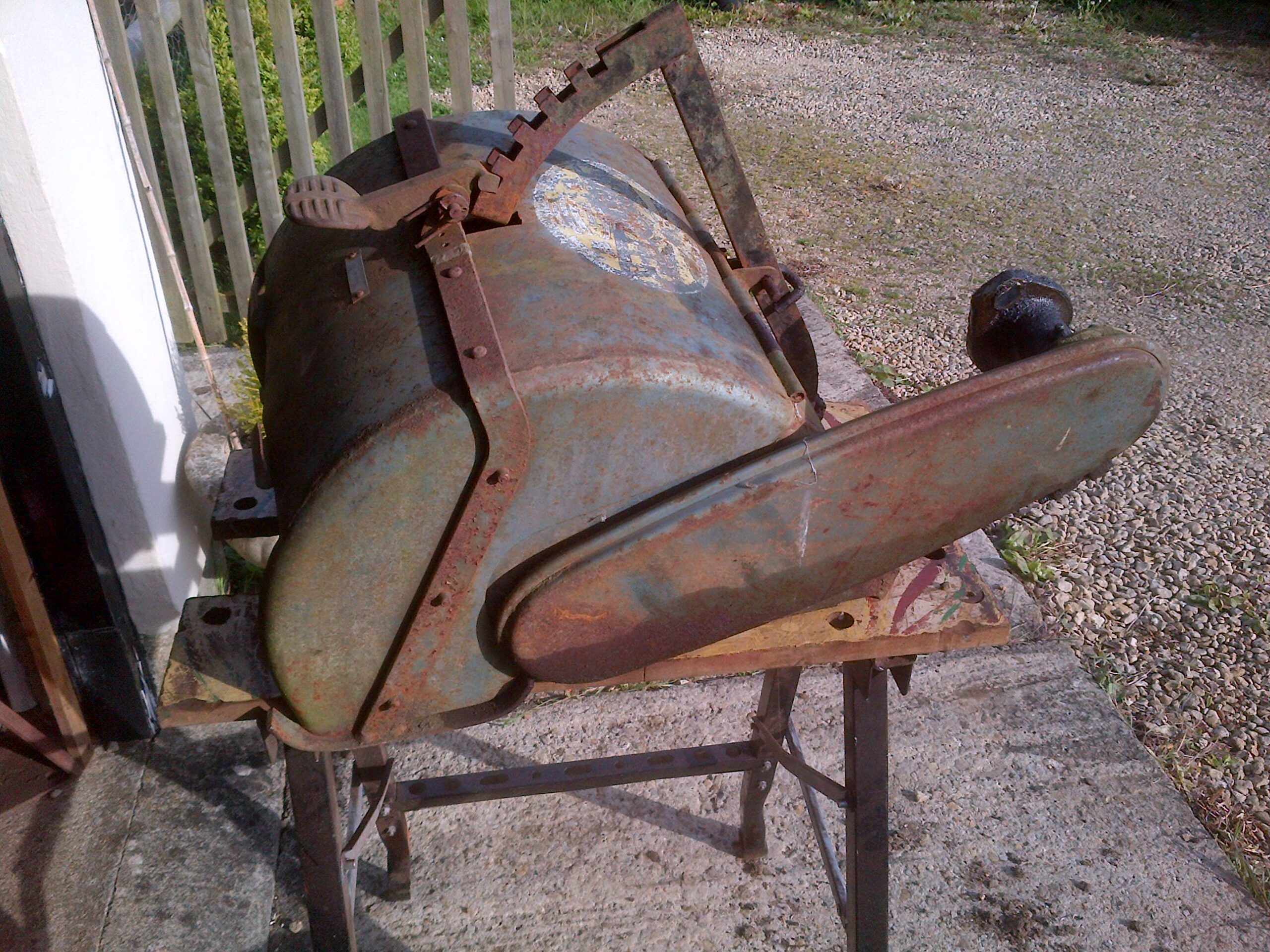

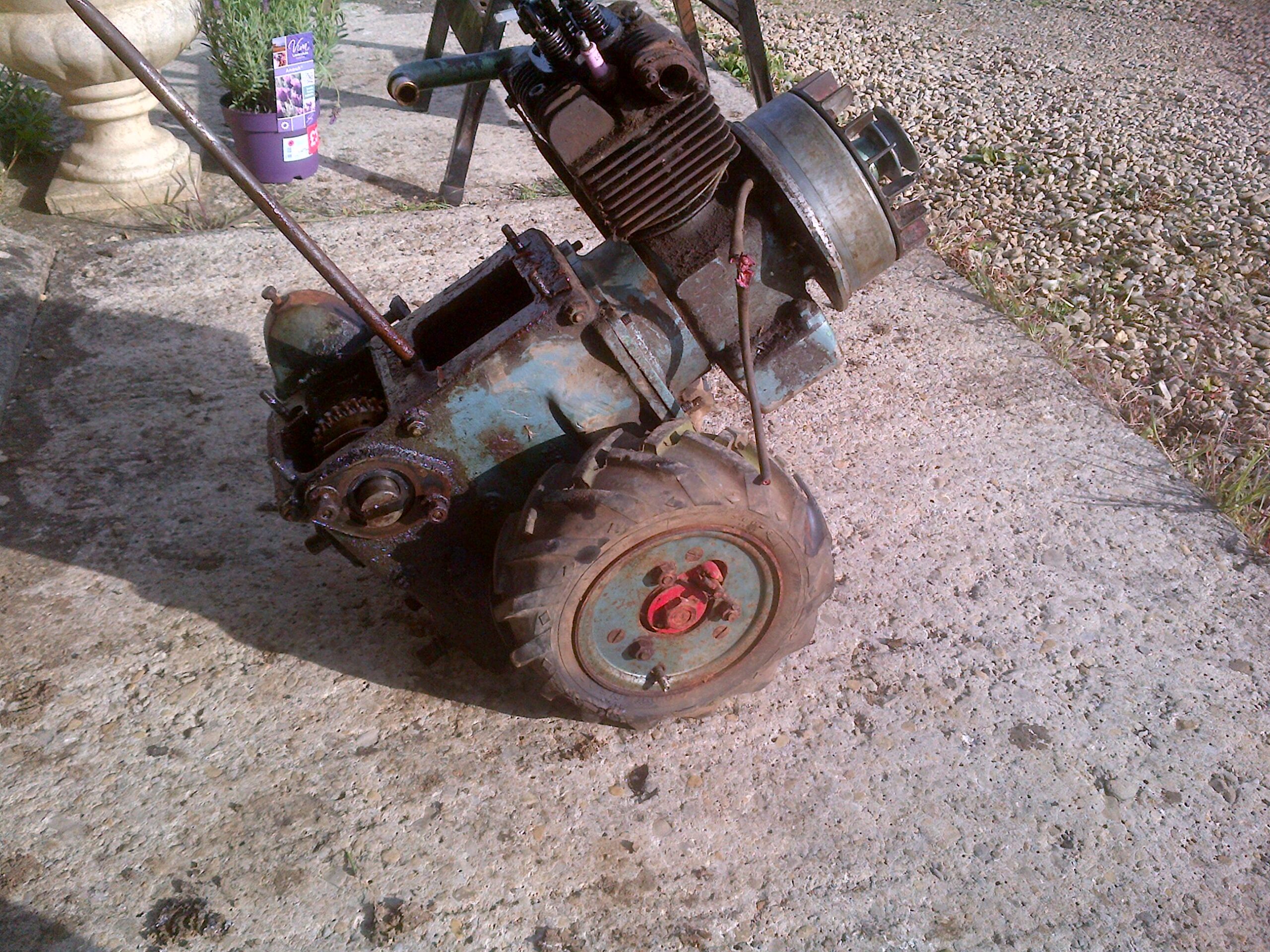

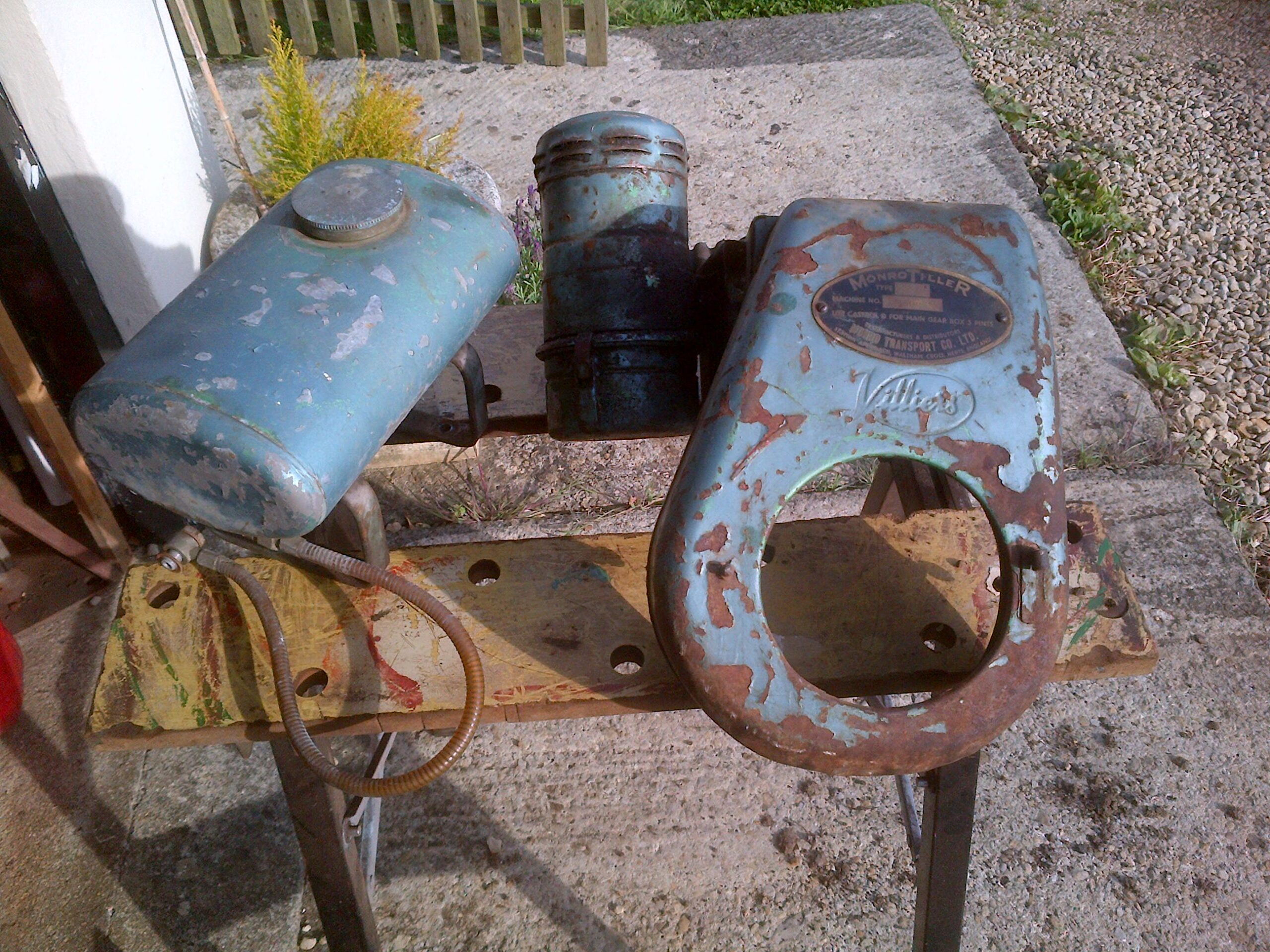

joegrgrahamParticipantJust a couple of pictures of the machine so far, hopefully putting some context to my ramblings.
As always, I didn’t take any pics of the machine as acquired (too distressing!!).
The pictures show the fuel tank and cowl/air cleaner, both in nice condition, just needing a good clean and an oiling.
The rotor box: again in nice condition, no rot, just one missing tine and a coating of rust on the remaining tines. Again, just a clean/degrease, oiling and it should be good to go.
The last pic is the main hulk of the machine, you can see the shot tyres and you’ve seen the picture of inside the gearbox on the pedestrian thread.Joe.

Had a very productive hour in the shed tonight, wheels are off, hubs are off and…………..drum roll please……….the dratted engine is finally seperated from the gearbox!!!. Thanks Charlie, chisel and wedges, and off she came.

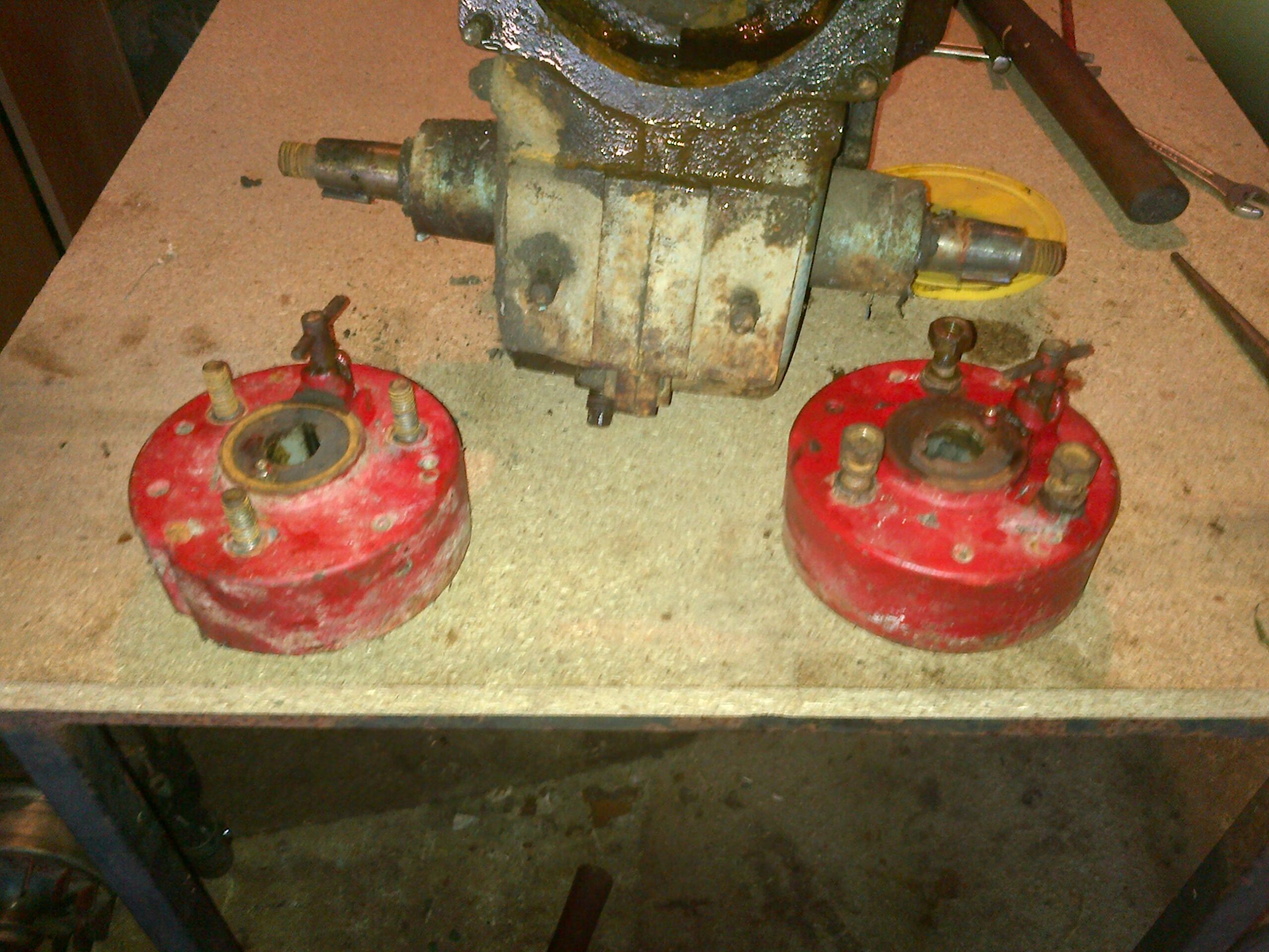

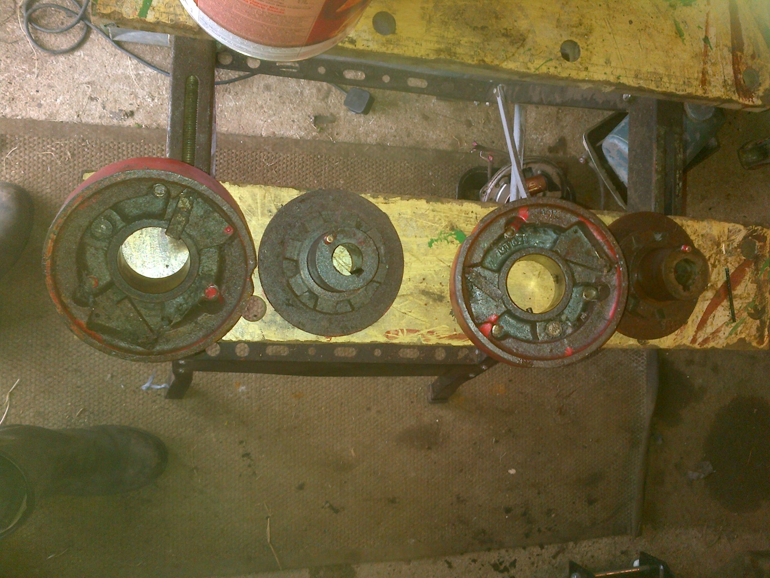

One of the hubs meekly succumbed to a few taps, the other caused a bit of a ‘brown trouser’ moment, it wouldn’t tap off so wound a puller onto it, no movement, so gave the back of the hub a tap and BANG, off it went across the shed like one of Barnes-Wallis’ finest!.
Am I right to presume that with the pin pulled out, the hub should freewheel? do they dismantle or would it be best to dunk them in a bucket of diesel for a while?.
Joe.

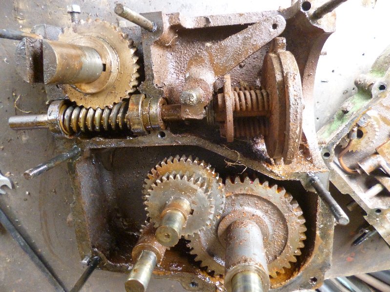

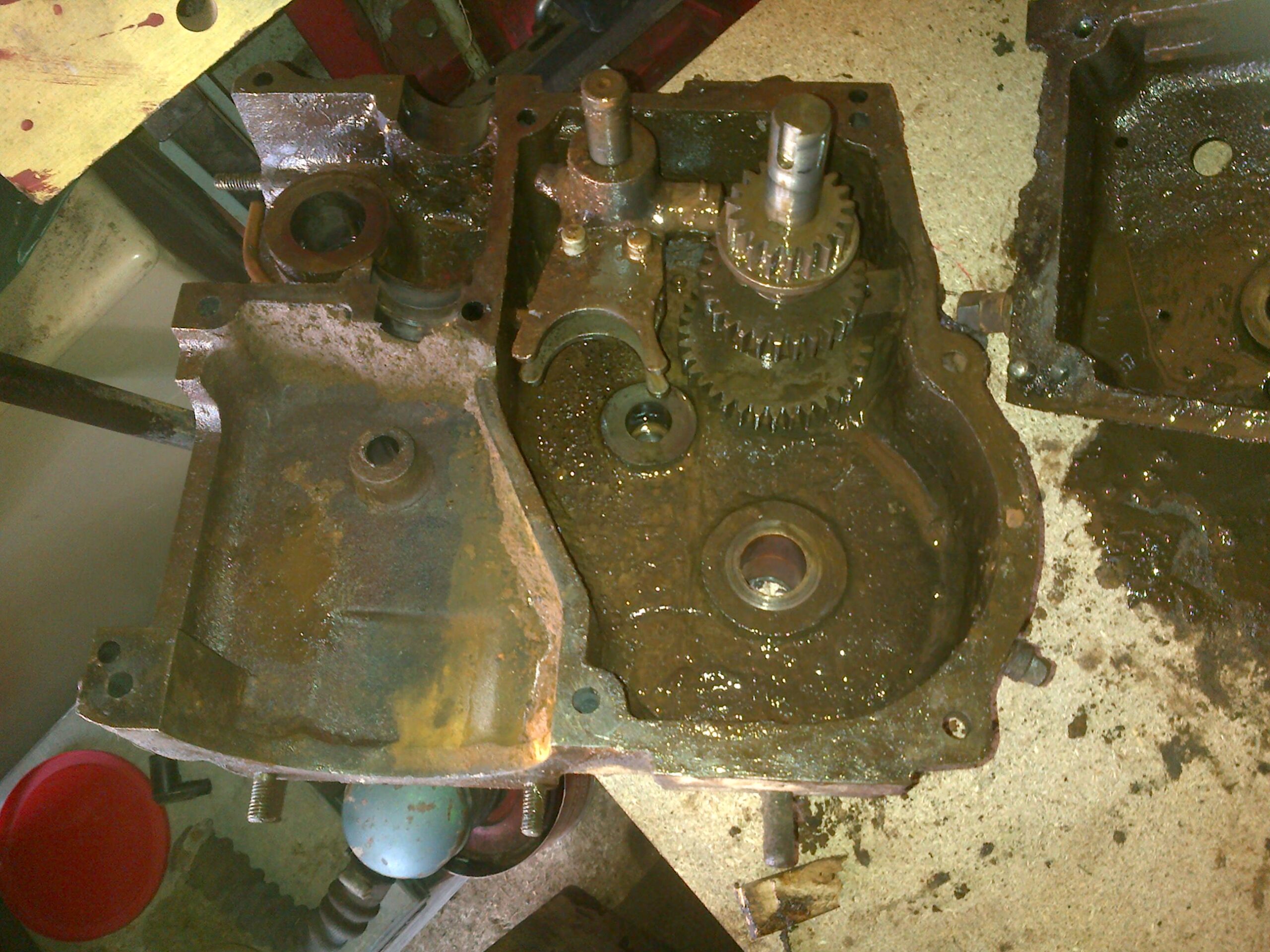

I did sneak into the shed for a bit, managed to get the gearbox split, and it doesn’t actually look too bad.
The clutch is looking pretty manky and we have the broken clutch lever to deal with, but the actual gears are in really good nick. No dicernable wear or chipped teeth, just a good layer of gunk.

charlieKeymasterGood news by the look of it, a good clean will confirm this. Whilst you have it apart it will be worth checking the plunger on the oil pump works. The gearbox I stripped recently the plunger was sticking and would not have pumped oil. This is critical as it pumps oil to the worm gear.
Ratchets are unlocked with pin out, see page 11 of manual. A good clean should and oil should free everything off without dismantling completely. Check pawl spring MT215 is not broken.

The gearbox internals have all had a trip through the parrafin bath and have been loosely reassembled, looking in really good condition.
Just need to sort out the repair to the clutch release lever and source a new friction plate and the gearbox can go back together.The hubs have been stripped, freed off, greased and reassembled (with the aid of a couple of paperclips to keep the ratchet fingers out of the way!!).

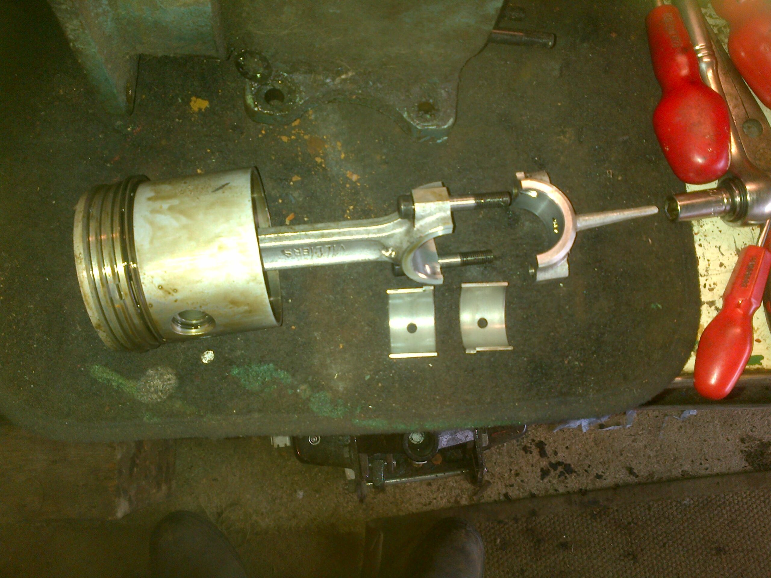

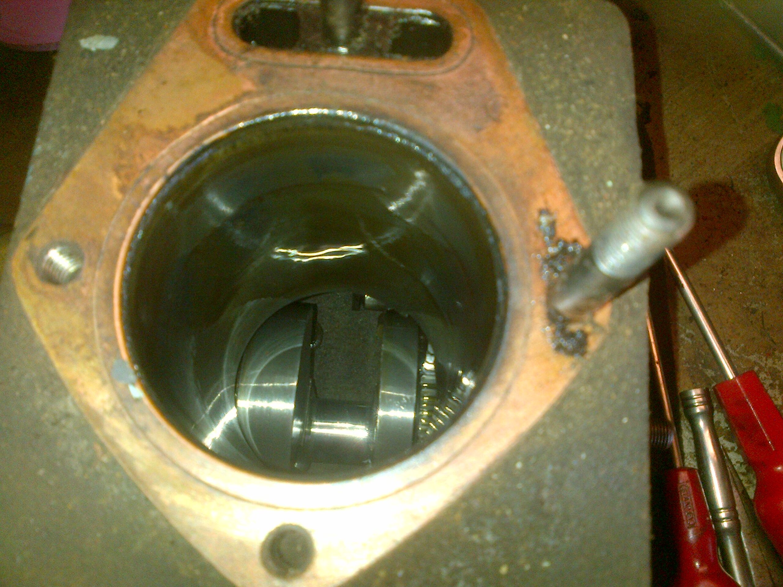

I made a start on the engine today, the head and valves are well choked up with carbon, so that will require attention.
Pulled the piston and it all looks in really good condition, the bore needs a little polish to remove slight rusting, but everything else just needs a trip to the parrafin bath.
