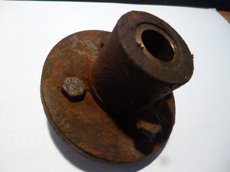

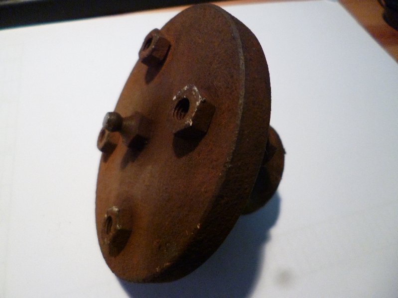

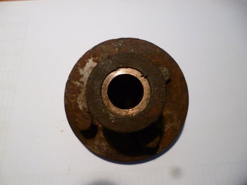

charlieKeymasterJames, having a look through the parts list, the miller shaft spigot housing MT38 (as shown my photos above) houses the bearing MT361, and is held in place by four 1/4″ x 1″ Whit coutnersunk screws MT362, spring washer RC40 and nuts RC212.
Can you post a photo of your miller shaft and damaged bearing etc?March 5, 2016 at 8:37 pm #20153

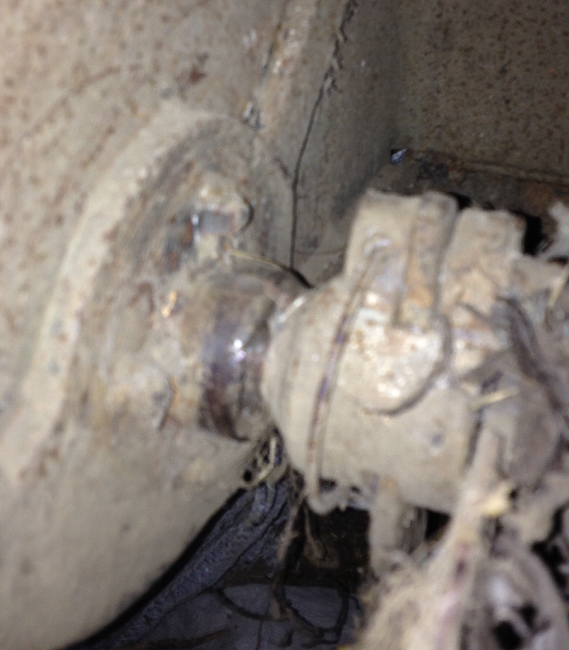

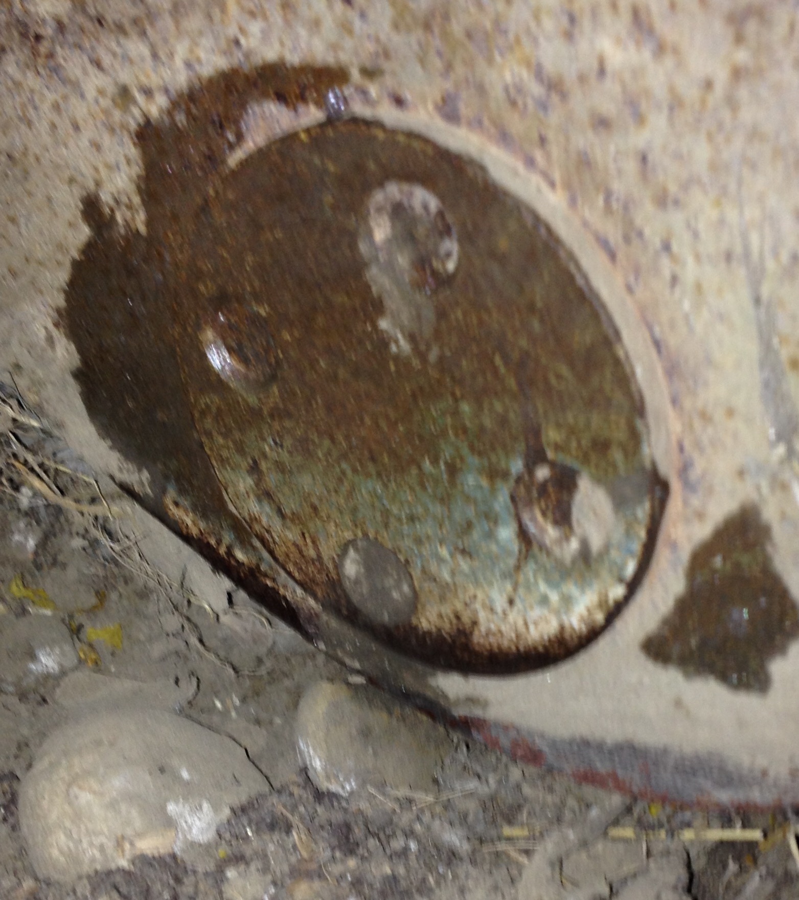

vhgmcbuddyMemberHi Charlie. Poor quality photos attached. The damage was caused by (I guess) a big stone getting dragged around, distorting the side of the casing and dislocating the shaft out of the bearing, breaking the tin cap and tearing the large felt washer. I’ve cleaned up the bearing and popped the start back in. But, having now looked at the manual you supplied a while ago I worry that the spring washer is gone as perhaps the is the ‘compo’ bearing (compressions? composite construction?). There’s no doubt my bearing cap is riveted in – look like v large pop rivits and that I don’t have a greese nipple (nor the hole where a snapped of one went).
The upshot is I guess I could use what I’ve got, but I’m worried I’ll just damage the end of the shaft with the remains of the bearing. If I could I’d like to get a replacement assembly that hopefully is more complete.
Is the one you photoed available at the right price?
Thanks for you help

charlieKeymasterJames, are you sure it is riveted? It should have countersunk screws with nuts on inside, mine has had normal nuts and bolts fitted and appear to be slightly different design as no counter sunk hole. If the shaft is still a reasonable fit in the bearing you should be OK so long as bearing is well lubricated. Long term it will need a felt washer and cap.

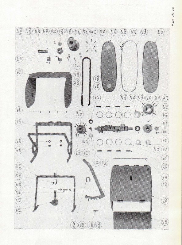

charlieKeymasterSpring washer RC40 is for the fixing bolts, not a thrust washer. Below is an extract from an earlier parts list for the series 3 which shows the parts laid out in the correct order.
