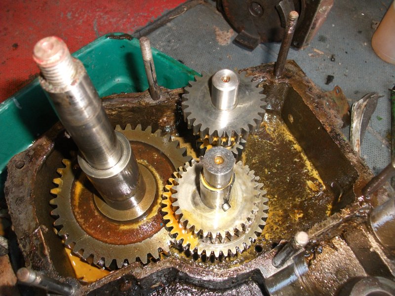

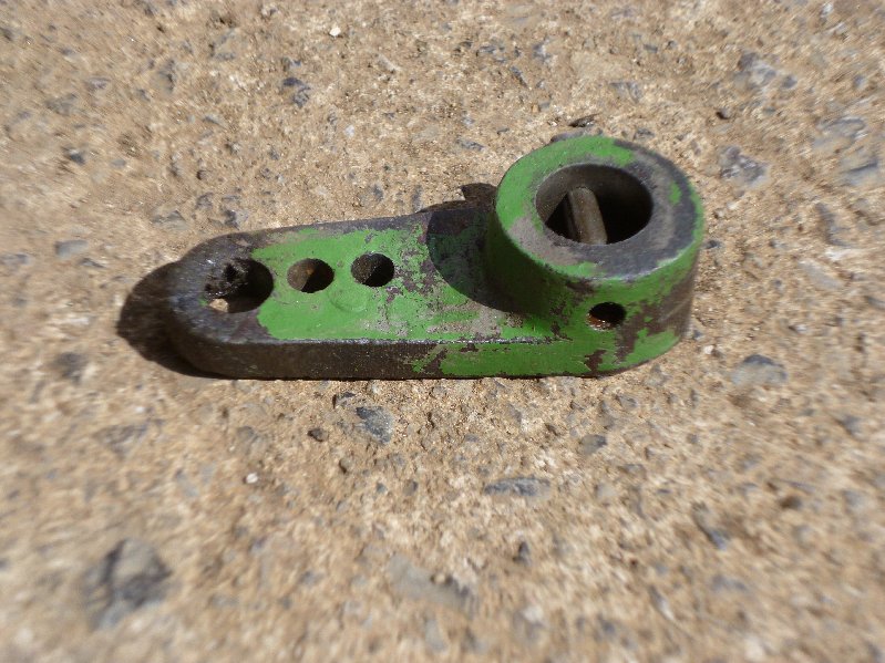

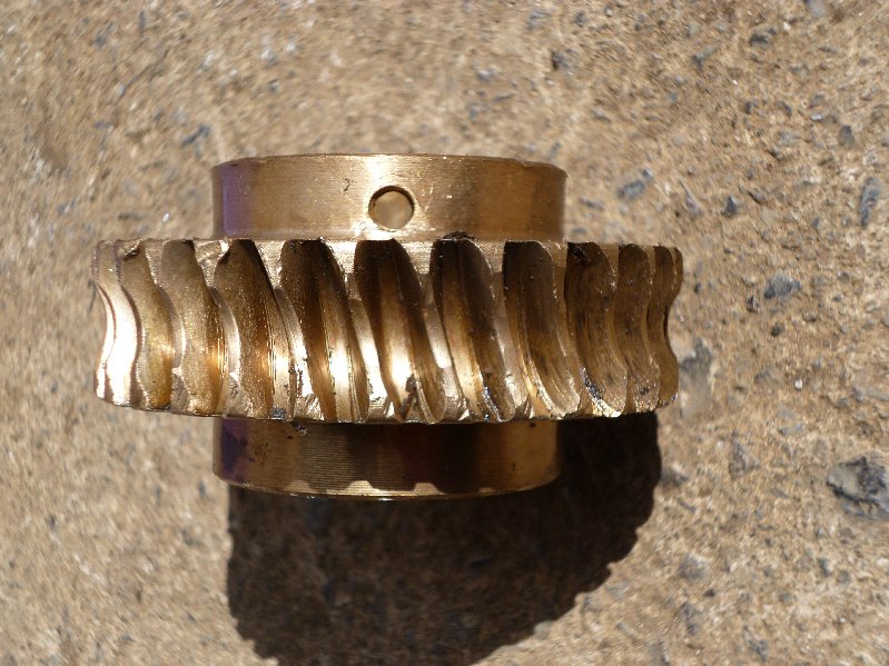

charlieKeymasterHave looked in spares pile and I do have the parts you need, all I need to do is strip the gearbox to get the gear out.
March 27, 2014 at 6:35 pm #6942
vhgmcbuddyMemberThat’s brill Charlie as long as it’s not to much trouble , let us know what I owe you .

vhgmcbuddyMemberI can not put any more pics on , have I gone bust ? is it 3072 KB per topic ?
March 28, 2014 at 12:29 pm #6957
charlieKeymasterlimit is 3072KB per file. e mail the files to me at vhgmc@btinternet.com and I will see if I can upload them.

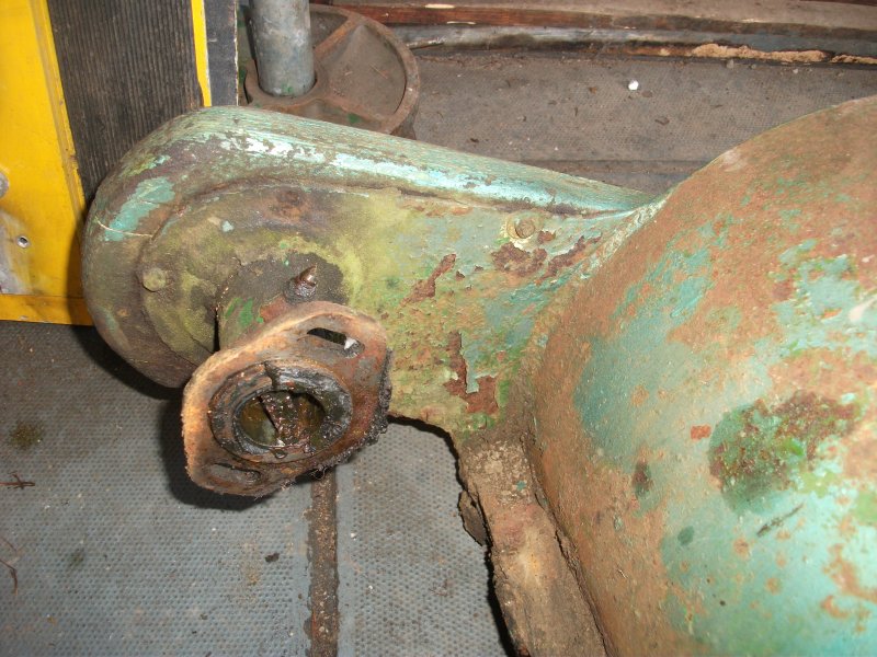

vhgmcbuddyMemberIt is a bit difficult to make out the wooden chaincase but it is a nice job .
Thanks Charlie for sorting out pictures .Swampy .
March 30, 2014 at 7:40 am #7020
charlieKeymasterOne of the problems with the Monro Tiller and other machines with a similar chain drive to the rotors is the bottom wears out, this might explain the wooden case.
March 31, 2014 at 8:42 am #7074
vhgmcbuddyMemberI never would have thought of that , it’s such a nice job I think I will keep it in place .

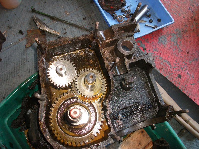

vhgmcbuddyMemberHi Charlie,
I’ve been waying up the rebuild and on looking at the parts list can not find a gasket between the gear cases and I must admit when I took it apart did not find a lot of material . Did they just use sealer ? I have made a new gasket but are scratching my head now.Any thoughts
April 13, 2014 at 5:26 pm #7467
charlieKeymasterAs far as I know there was no gasket, I have never found one on any that I have split. A very light smear of Blue Hylomar might be a good idea.

vhgmcbuddyMemberHi Charlie, I was wondering how the oil reaches the bottom gear case when you fill the upper one ,I can not see a path for the oil.
