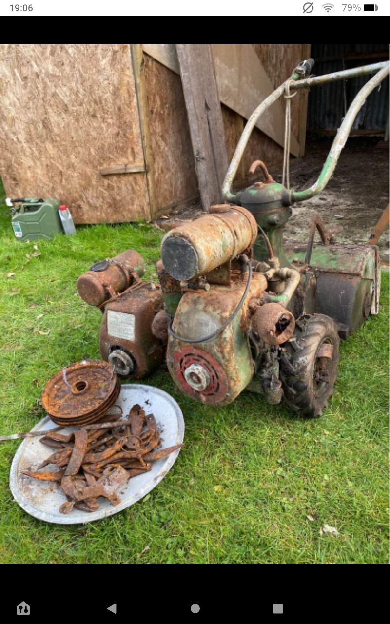

June 27, 2022 at 2:13 pm #39333mitzygolf
ParticipantJust tried to start it. No fuel mixture getting to the cylinder. Float chamber is filling up and when a little fuel is added straight in to the cylinder it runs. I put a replacement main jet in during the rebuild ,does the taper needle and jet need to be paired? Any ideas would be very helpful. Thanks

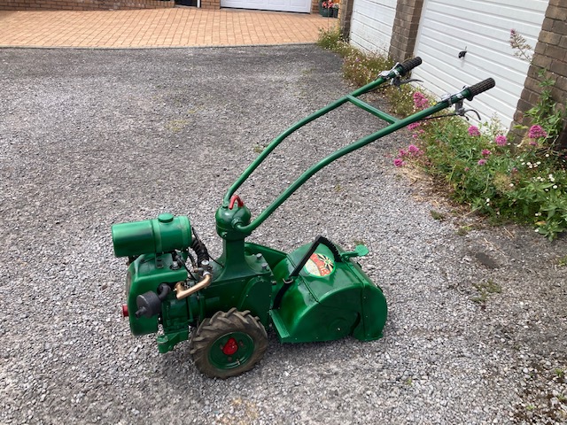

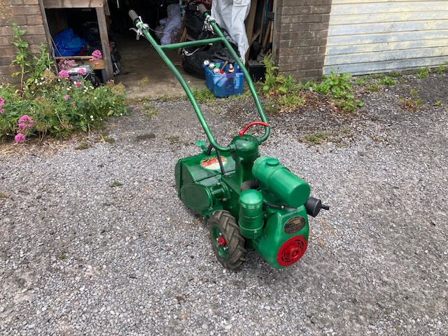

June 30, 2022 at 2:19 pm #39388
wristpinParticipantVery smart, but I have to ask, are the tyre treads supposed to be facing in different directions left and right?
July 1, 2022 at 8:11 am #39395
charlieKeymasterThe wheels can be reversed to give a different off set. If one is at narrow setting and the other is at wide setting then it would have one tread facing the opposite way. If both wheels are on the same setting then yes it would appear one tyre is on the wrong way round.
