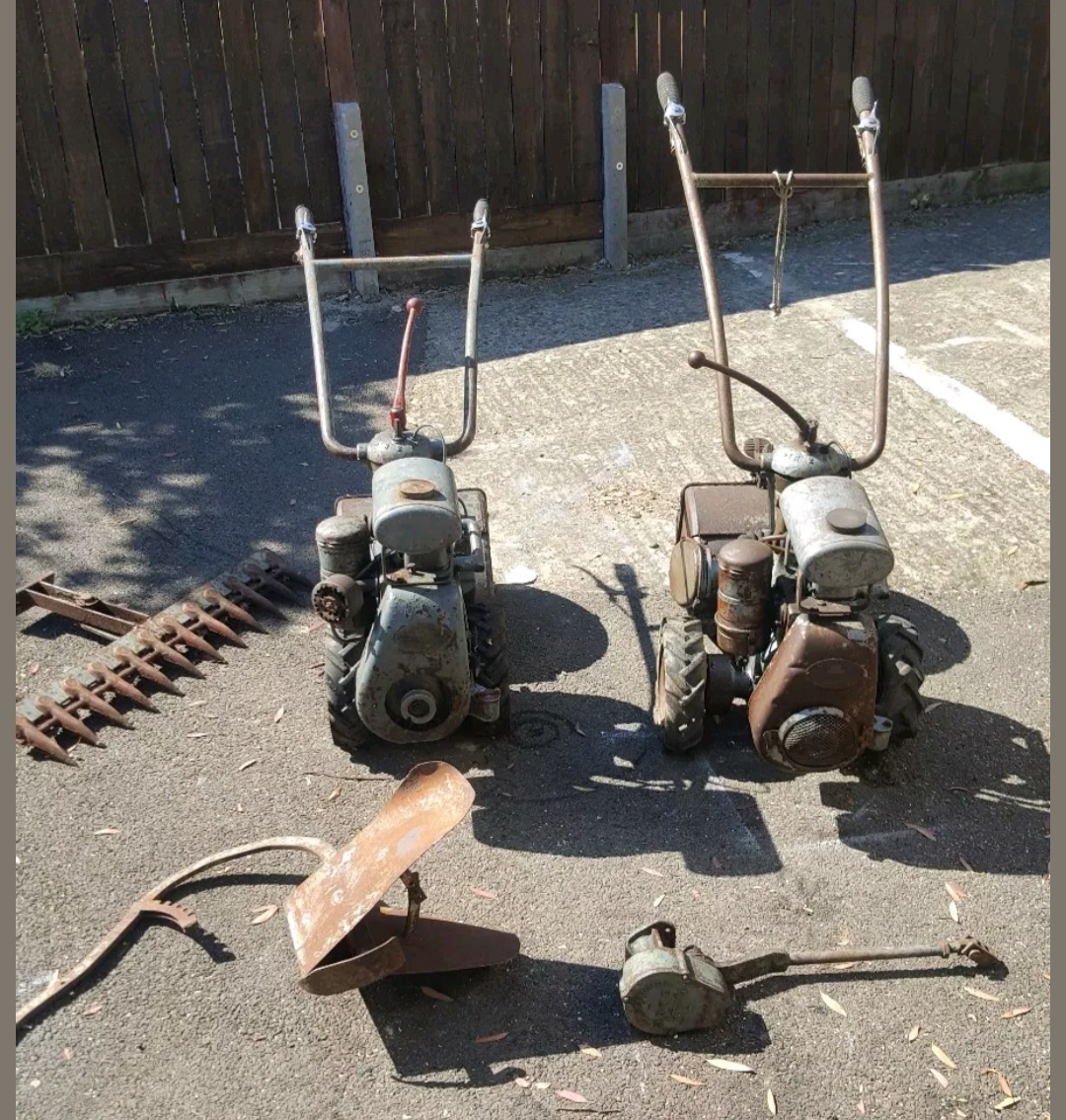

    Good evening folks,
    I have recently bought a pair of Monro Mk3 Tillers, both looking a little sorry for themselves, and with Villiers Mk15 engines with Junior carburetors.
    I am looking for good sources for spares (cables, seal kits etc), together with the workshop and user manuals for both the tiller and the engines – i’d ideally rebuild one of the engines and get them up and running one at a time.
    Both engines are free and turning, one gearbox seems okay from afar, and I need to look for a new pair of tyres (3.00-6).
    Any advice would be very gratefully received to get these lovely pieces up and running in their prime again and seeing work on the allotment.
    Many thanks,
    Ian
