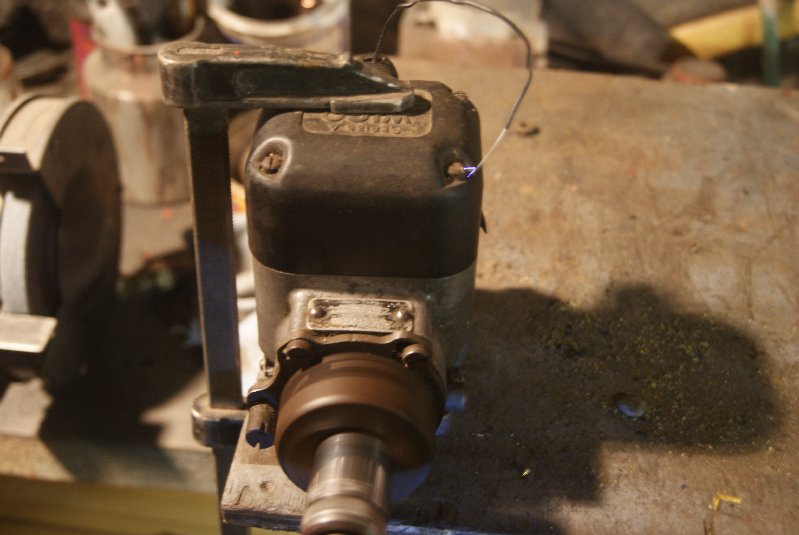

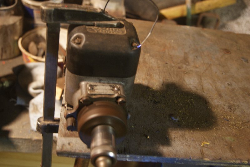

trusty220KeymasterI was checking my magneto this afternoon and thought that I’d take some pictures just to show you the set-up. You don’t need anything special. I clamped the mag to the bench (I normally use a piece of wood under the clamp to save damaging the cap, but you wouldn’t see the spark if I’d used it), then screwed a piece of rigid wire to the HT lead connector- I’ve straightened out a paper clip before now. Point the loose end of the wire at one of the screws that hold the cap down to the body, put a rubber band around the finger on the impulse starter to keep it retracted, then spin the mag using a variable speed drill fitted with a 3/4″ AF socket. You can buy socket adapters for less than a fiver from Screwfix which work really well.
You should see quite a spark from the end of the wire if everything is working properly, and this one reached nearly to 1/2″ long this afternoon.

ParticipantWell, I have completed a strip and rebuild of the Magnito. I have a good spark, 10mm as per Trusty220’s method.
