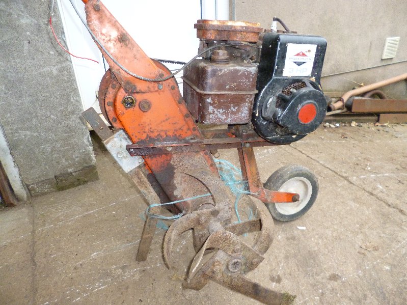

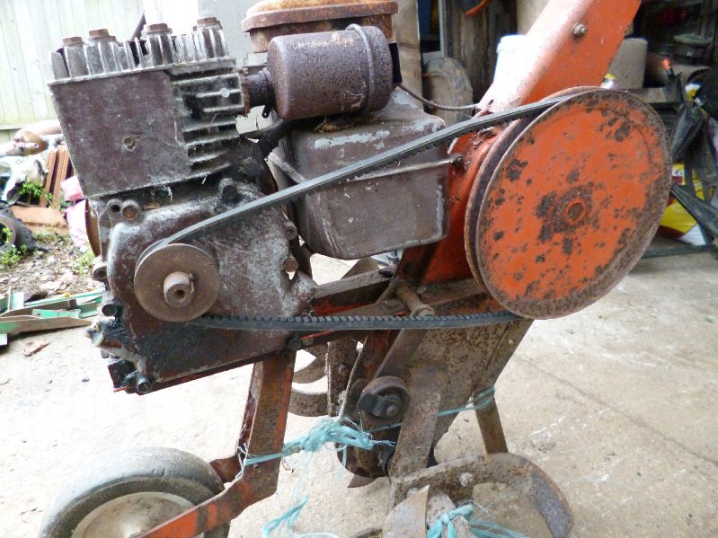

    Photos of Merry Tiller as promised.

    I now know the single wheel on the front is original and raises another question. How is it supposed to lock in up and down positions? I am sure the length of baler twine currently locking the wheel in place is not original.

    The belt number is E.C 0093A
    Cable is E.C. 0088A
    But there is no reference to machine s/n’s.
    #3676
    moggyjim
    That auction site item 130565929342 i think is what your after if you have a 2inch pully on the engine

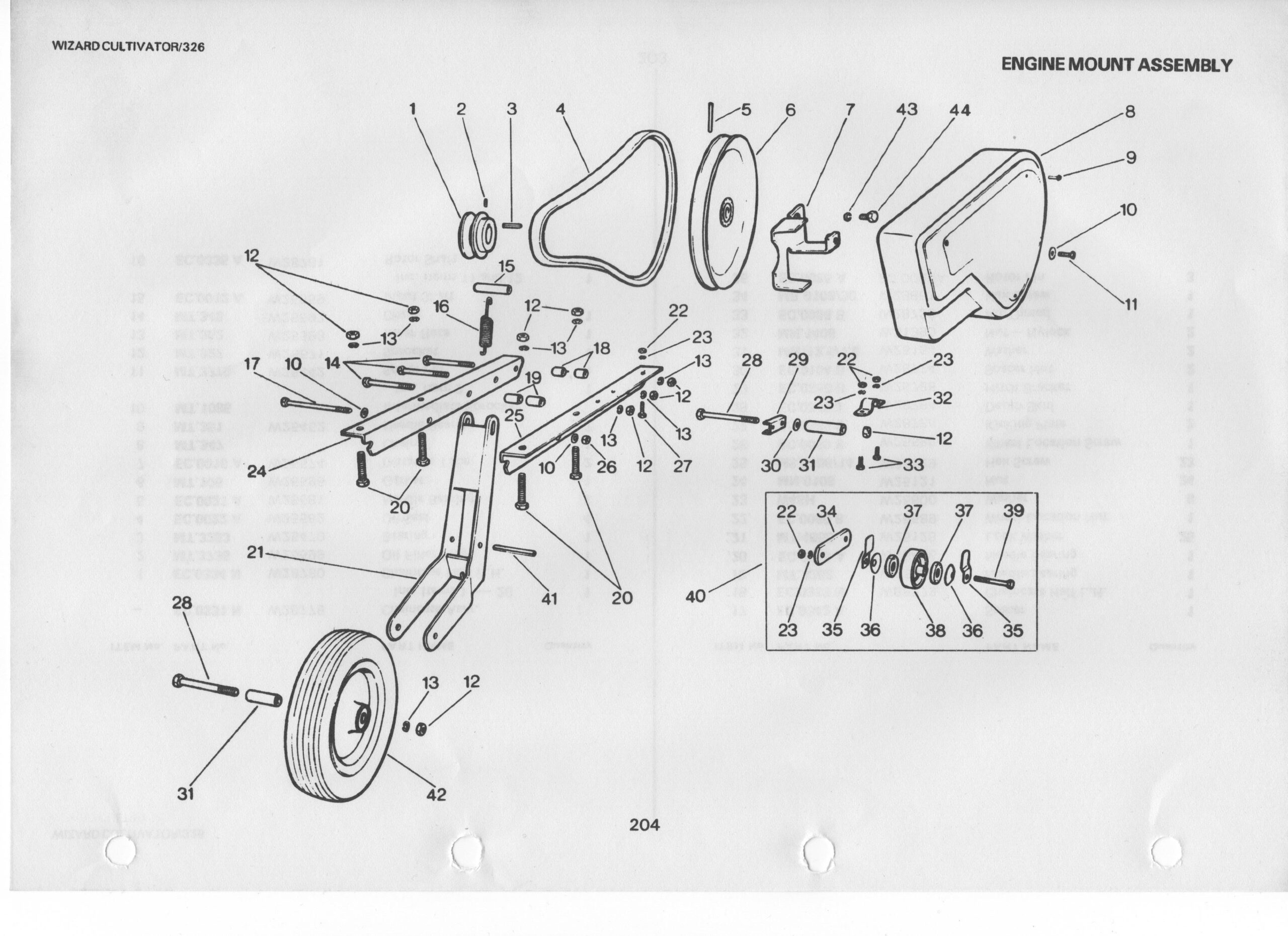

    Here is a picture of the parts list with jockey wheel but it is not clear how it works.
    #3757

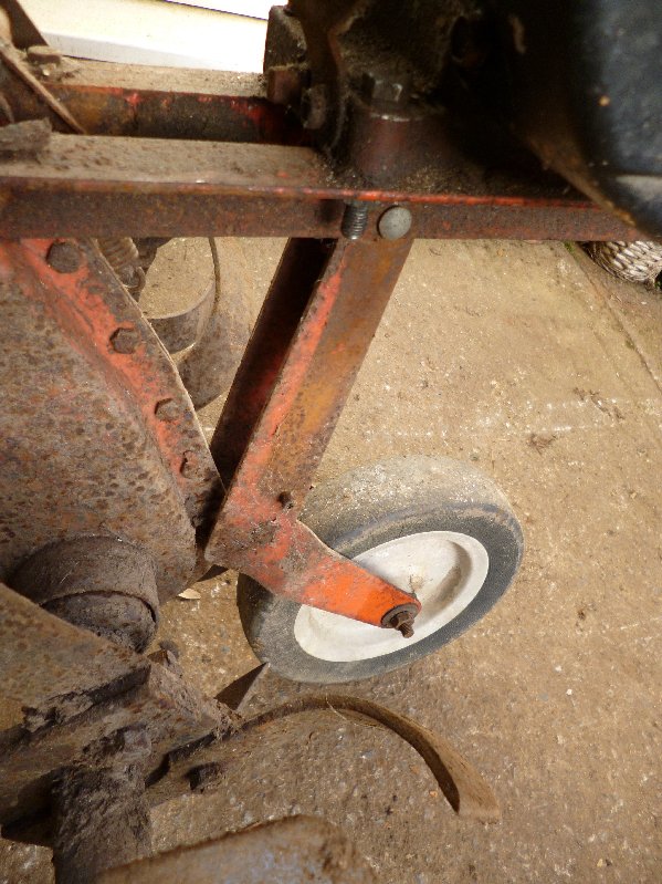

    A little experimenting, with the baler twine removed, and it is now clear how the wheel locks in up or down positions. To lock it up pin 41 in diagram above locks in the two cutouts in front of the chassis legs. To lock it down, the slot (just visible in diagram) at back of wheel bracket 21 locks over join of the two halves of chain case. Simple and it seems to work.

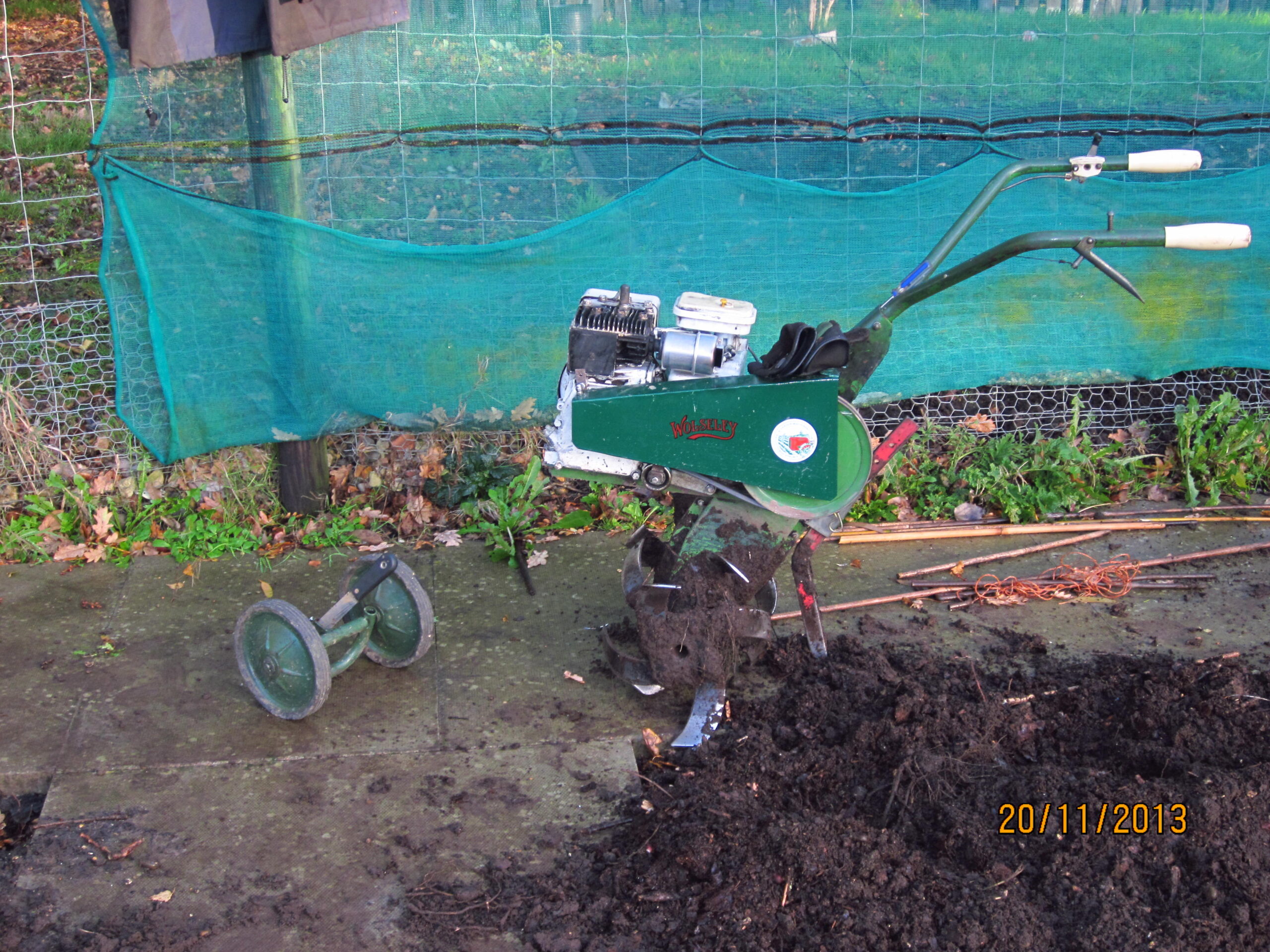

    sidevalve44
    Interesting. I’ll have to look out for one of those. Mine has some homemade contraption (see picture) that slides over the depth gauge. It works well but, makes it a little front heavy when moving it around !

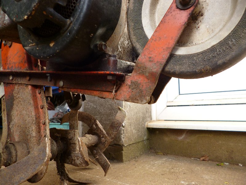

    #3817
    A couple of photos of wheel in up and down positions.
