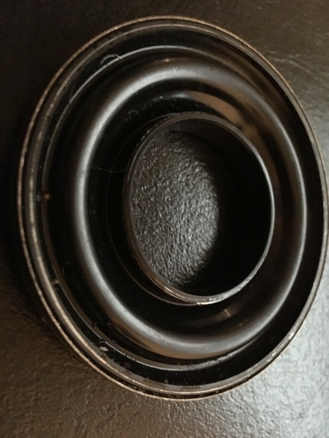

vhgmcbuddyMemberthanks for thinking along: looked at that, but No, it’s not like any ordinairy oil seal: Both axle and outerpart are actually rotating with the same speed, but the outer part is tilted and ‘wiggles’around too. A lot like a CV-joint (homokinetic joint) or a Rzeppa joint. the seal acts like a bellow.
Honda patented … special part, NOK AZ7882E … and google isn’t my friend this time (tried that of course).January 24, 2019 at 7:56 am #30160

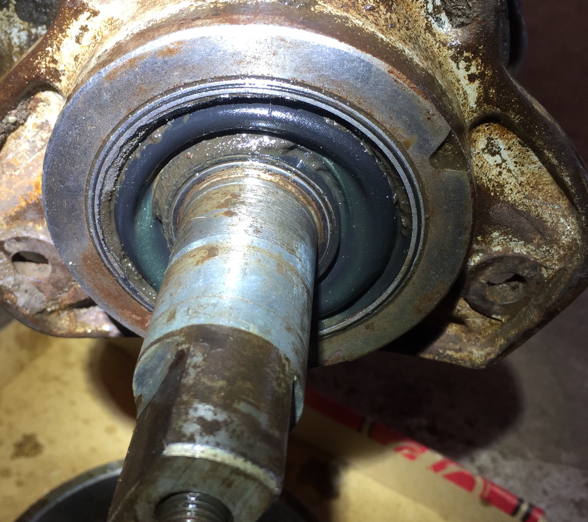

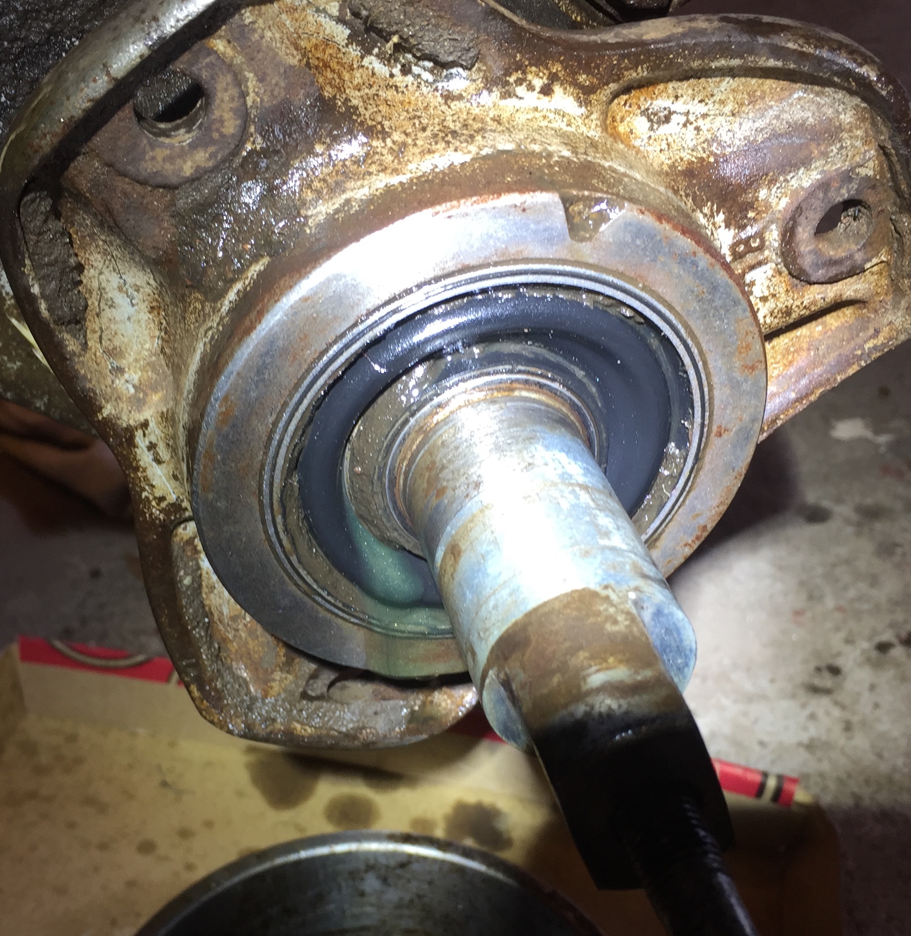

I am sure the seal is leaking. On the left side, the right is OK. There is a big hole in it where the oil comes out as soon as I fill it with oil. I am thinking of remanufacturing aswell but I have not removed it yet.
How did you get yours out?
March 3, 2019 at 4:31 pm #30579

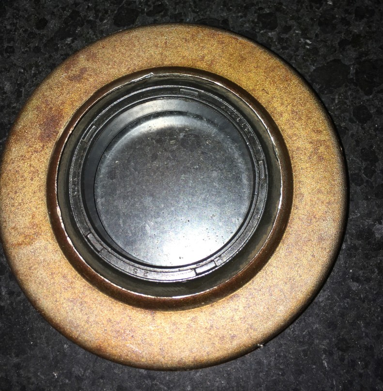

vhgmcbuddyMemberreally looks like the seal is mounted the wrong side outwards. I am missing the outside metal protection ring (mud-guard)
I pulled it out on that metal cap.
but first you should be able to slide off the complete assembly over the axle (outwards). Make sure to lube the inside first.March 13, 2019 at 4:16 pm #30658
