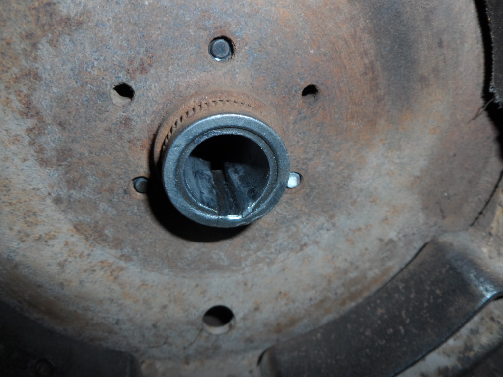

vhgmcbuddyMemberHad a better look at the Honda F400 the other day, found a lose flywheel. It has damaged the key way particularly the flywheel see photo, the crank key was not so bad, I lap the fly wheel to the tapper with fine grinding paste. I got a new key and it fitted it in the crank OK. Placed a small amount of J-B Weld in the wide part of the flywheel key way, fitted it on and tightened it to the correct torque. Yesterday after leaving it for a few days I gave it a try, started fine ran it for 10 minutes checked drive and gears all working fine. Stopped it and flywheel was still tight but time will tell. I would be a lot happier with a replacement flywheel so in the mean time I will be looking out for one. The rotors fit the F28 tiller so I’ve started work on the G28 engine I bought the frame and the engine separate, the frame is in good order. The engine runs OK but the exhaust needs sorting, at present its piece of copper pipe with one side of the flange welded to the stud. I’ve had a F28 before that’s the one in on my avatar. Short video of F400 running with strobe light connected, no exhaust so bit noisy. Honda used 22mm drive shaft for the F28 & the F400, Does anyone know of any other models that used that 22mm drive size. https://youtu.be/04Hl8kdsFZM

wristpinParticipantWill be a good test of JB Weld. In theory if everything remains tight and JB Weld does not break down to dust it should all stay solid.
As long as your taper is a nice snug fit you should be OK as it’s the torqued up taper that does the work. The key and keyways are there mainly to position the flywheel for correct timing.

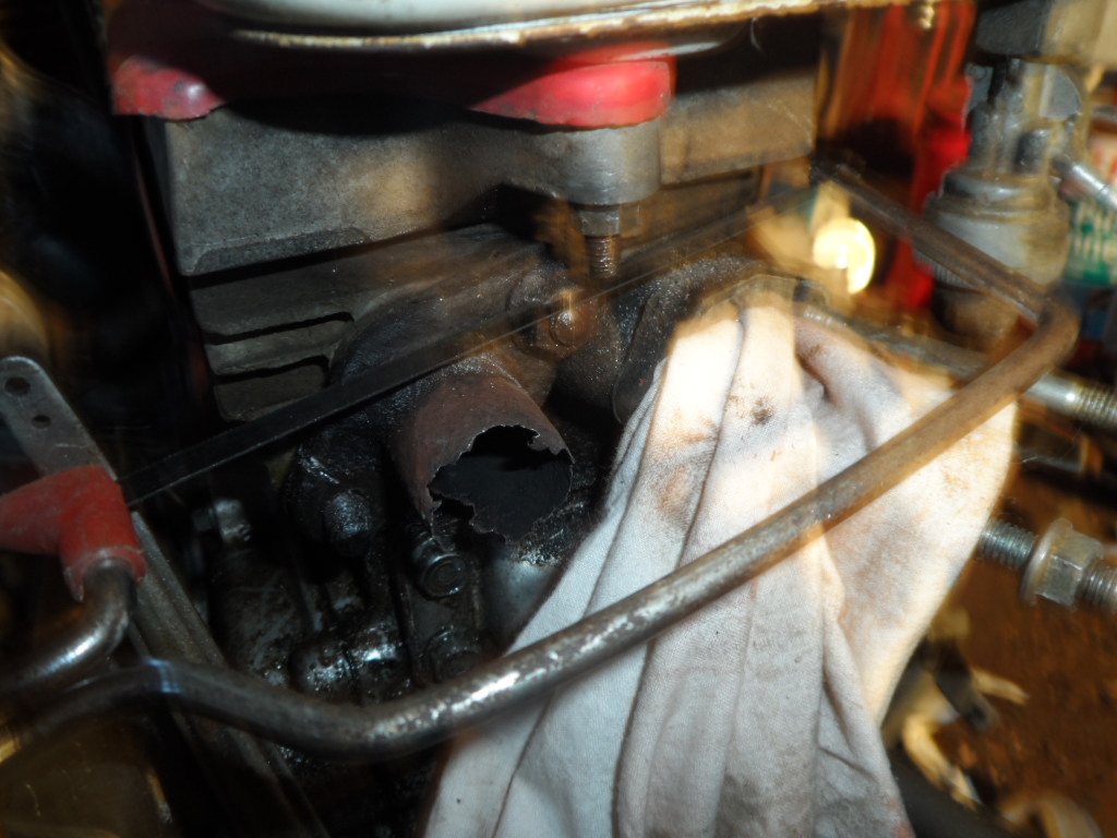

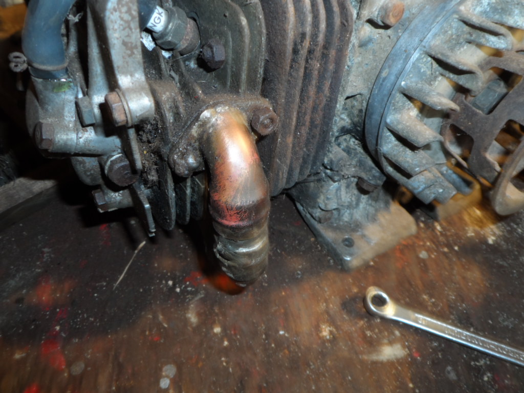

vhgmcbuddyMemberMade up alliterative exhaust for G28 engine, This is a versatile little engine because the pulley is centrifugal. Can be used for other applications, remembering health and safety of course.

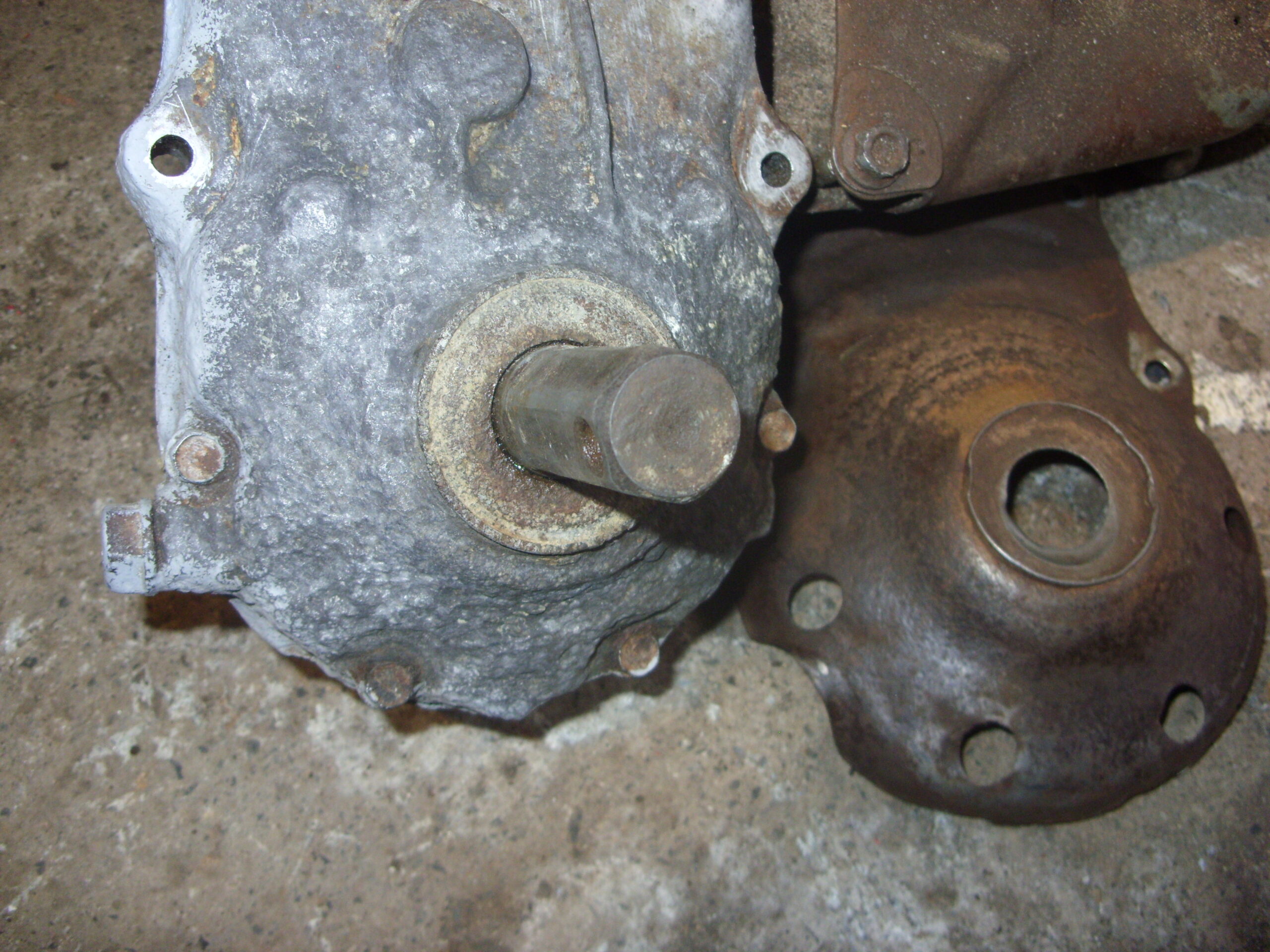

vhgmcbuddyMemberFound some more aluminium rust today, under the tin plates protecting the bottom of the rotor casing on the F 400. The F 28 as you can see by the photo is fine, the F 400 has a different design plate with holes in and was jam packed with earth. I recon this contributed to the corrosion trouble so the holes will be blocked off before the plates go back.
