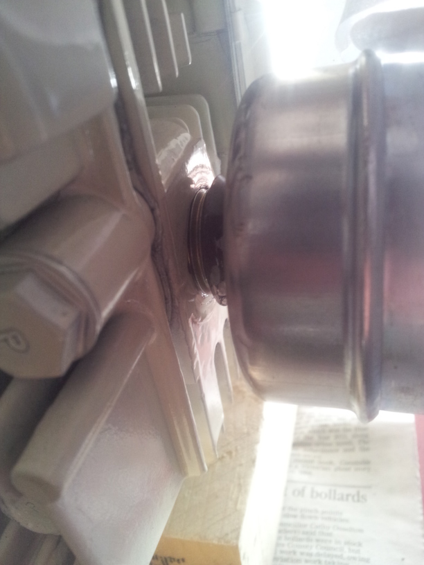

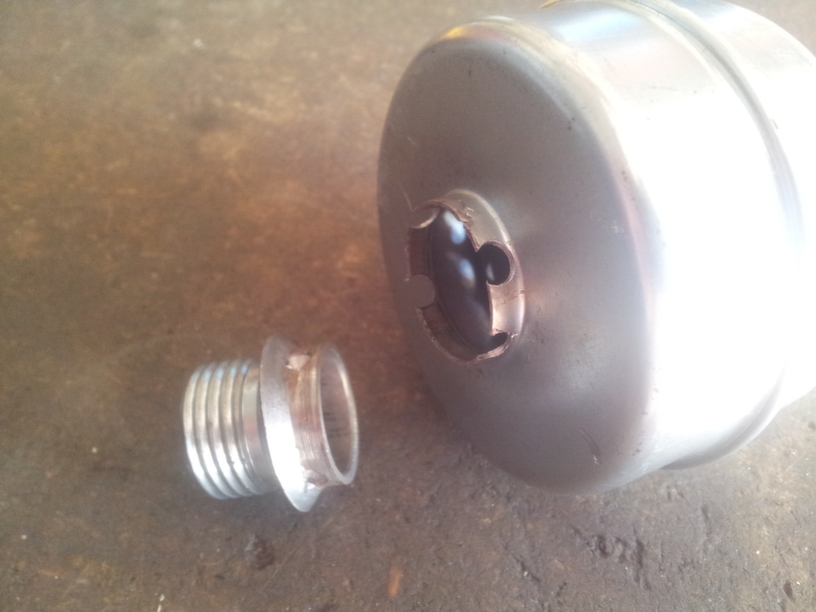

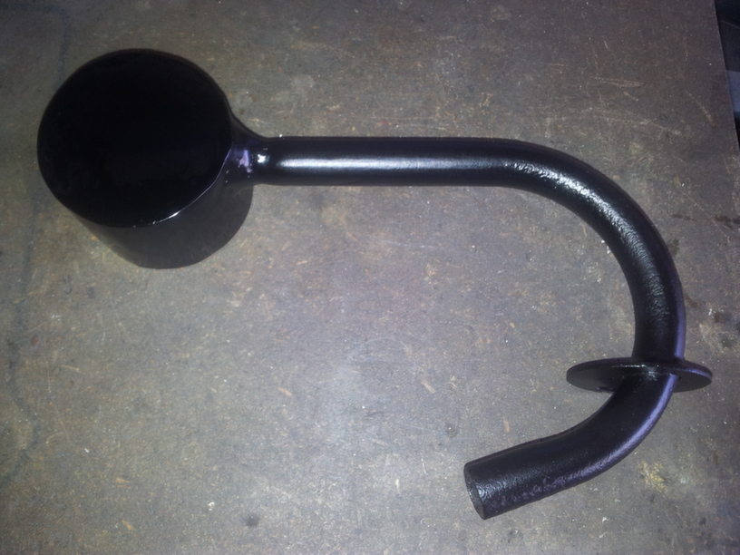

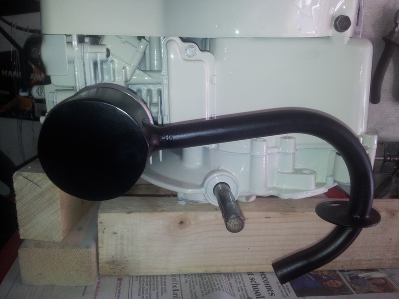

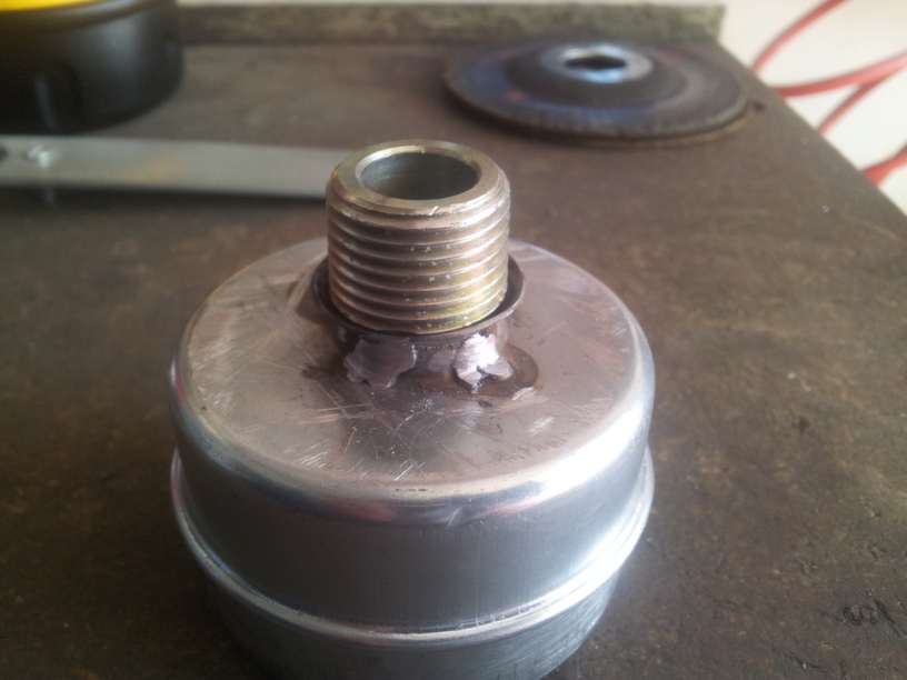

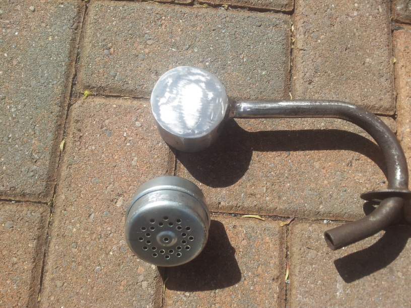

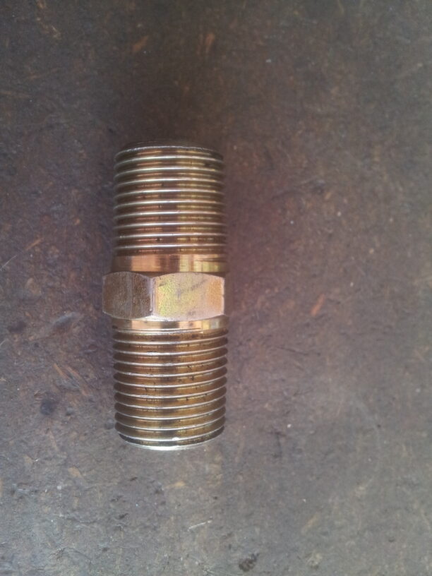

    I had one problem with the power driven Landmaster, Its exhaust system! The Muffler is quite a small diameter. Unfortunately the replacement ordered was too big. After a lot of searching I managed to find the correct size Muffler, but it had a different screw thread on it. After consulting with my local Unimaster, a solution was found. It was to drill out the 4 spot welds and remove the incorrect threaded collar. Take a 1/2″ pipe fitting and cut to length, machine the end to fit the muffler and puddle weld the correct threaded collar to the muffler. Also had to remake the “Can” which enables the exhaust to vent beneath the deck.

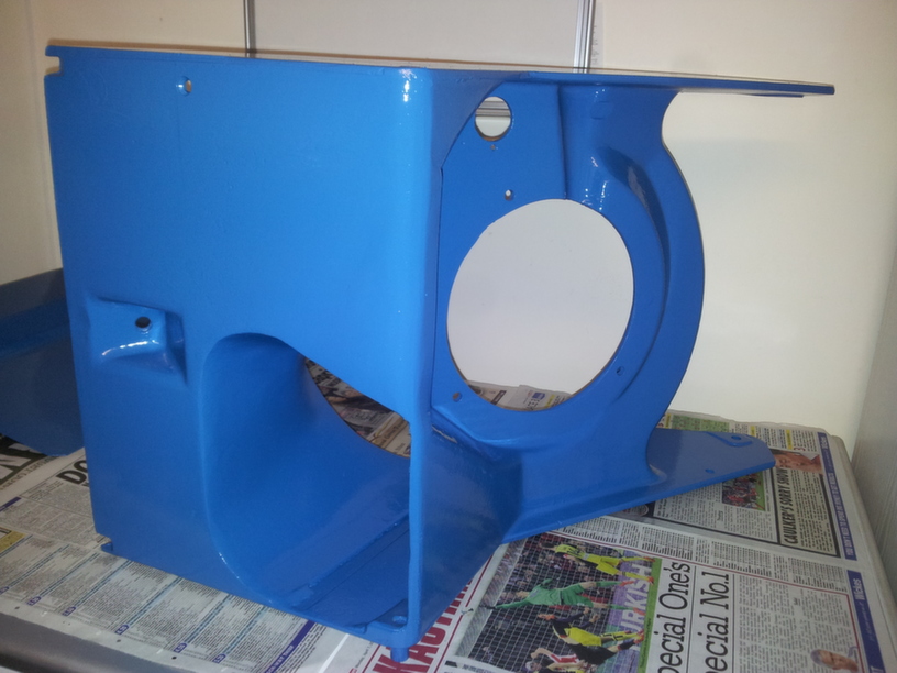

    Got the grass box for Saturn 2 back from the welder at last. Then set to and painted all the metal work for this the power driven model.

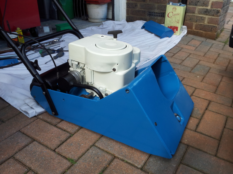

    darmic1

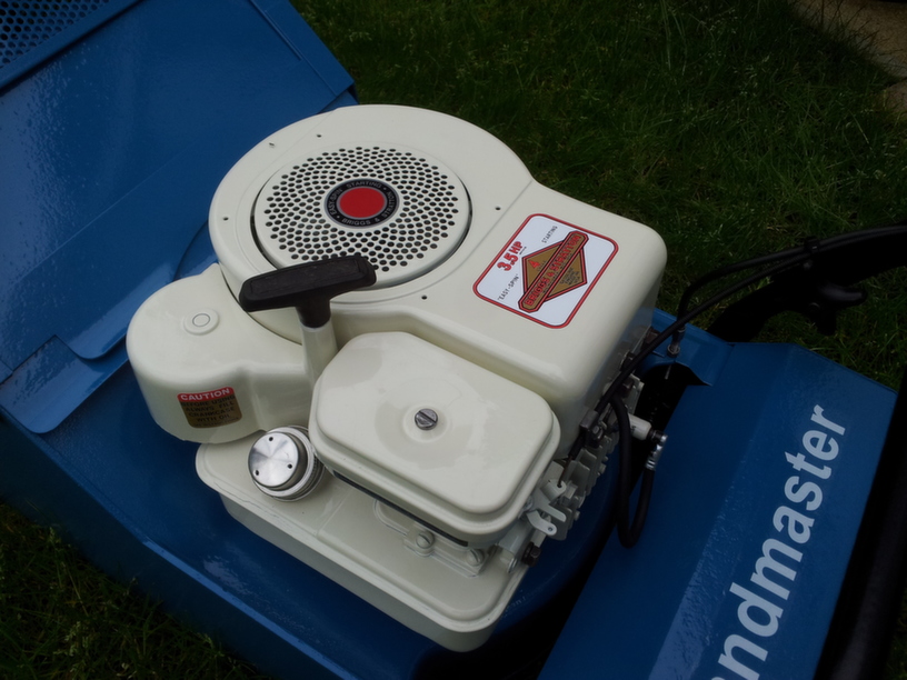

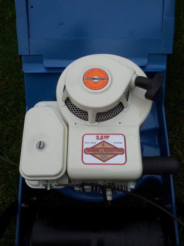

    Had a busy day today. Visited a local event, The Berkshire Country Fayre, it advertised vintage agricultural and horticultural amongst others, but unfortunately the horticultural was AWOL, so no photo’s I’m afraid. However, I made good use of my afternoon and put the 2nd Saturn back together and got it running for the 1st time. Here are a few pictures….
    #8295

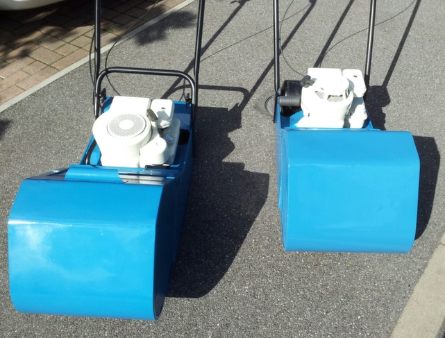

    darmic1
    After 2 1/2 hours it was all done and running sweetly. Here are the 2 Saturn’s together, just waiting for some of Titch’s fine decals to finish them off…….
