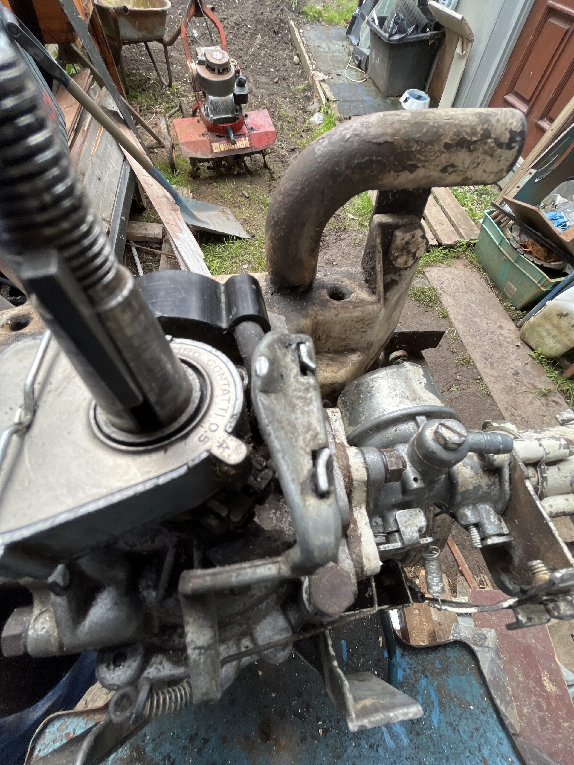

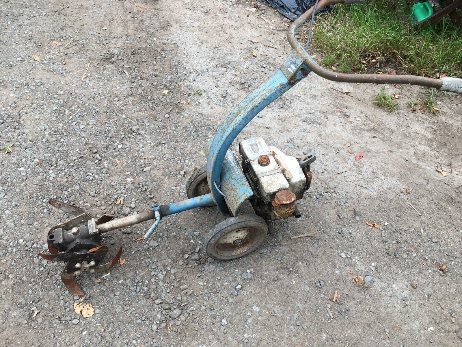

ParticipantHi, I won this old machine on ebay for a tenner. The plan is to clean it up and use it as I am sorting the garden. Once I have finished with it in the garden I plan on stripping it all back and painting etc.
In my rush today to get it running, I took the pull cord and housing off, removed the flywheel etc. cleaned and reset the points as there was no spark.
whilst I had better access I removed the carb and cave it a clean and a blow through with the airline.
Reassembled the carb and put it back on the engine, this is where my two brain fade moments start. …When putting the flywheel back on there is a white plastic thing and a large spring. I cannot remember where these were located so I have put them under / inside the flywheel. Not too sure if this is right though!
Built it all back up and then realised i cannot remember which holes that the the throttle and the governor etc went into!Any help will be greatly appreciated indeed.
I have had it running by manually using the throttle on the carb.
Thanks in advance.

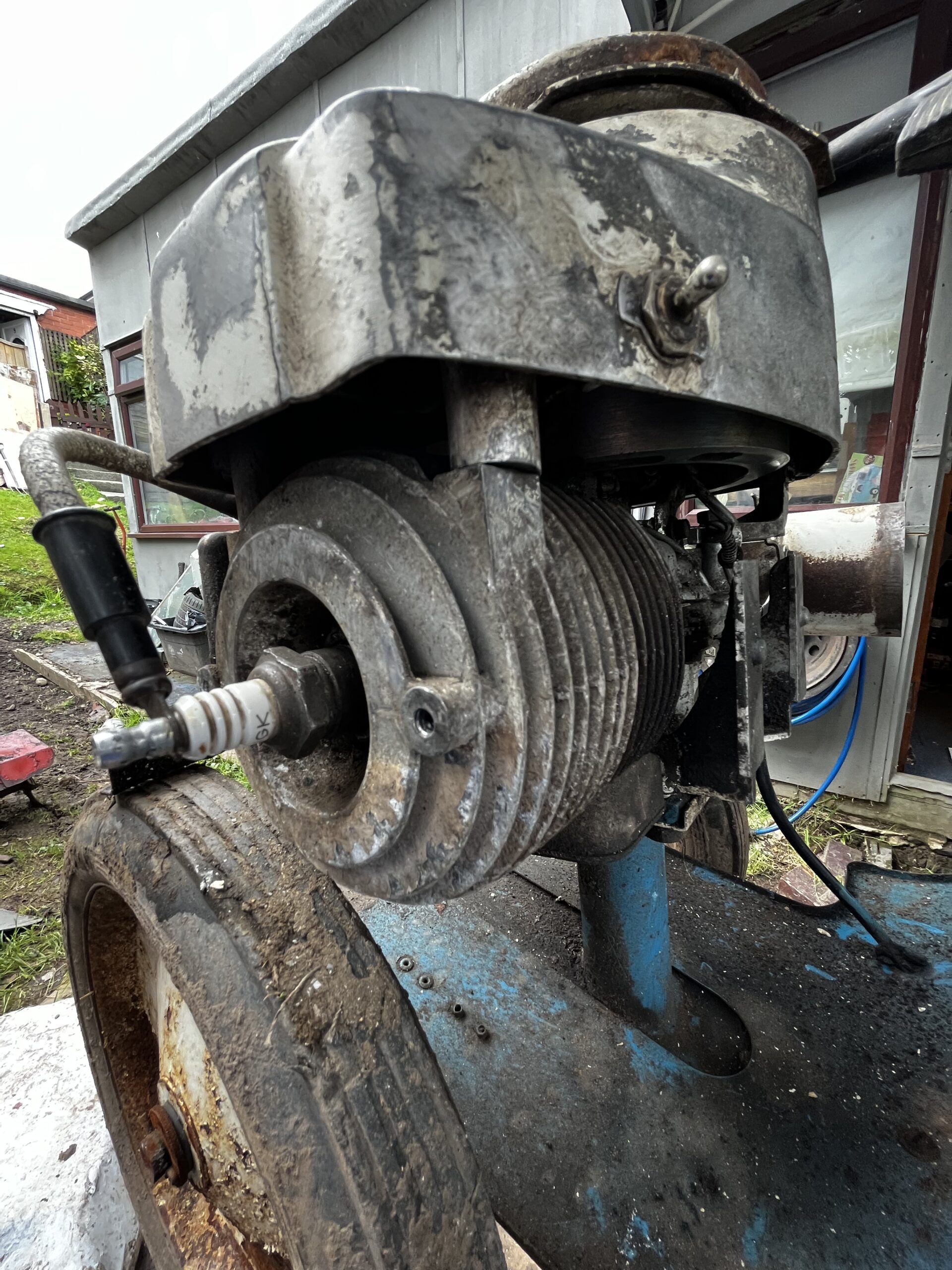

wristpinParticipantSome images more specific to the areas of concern will help. At the moment I’m not immediately recognising the engine from the angle of your shot, may be an Aspera but the cowling doesn’t look right, so maybe a JAP?

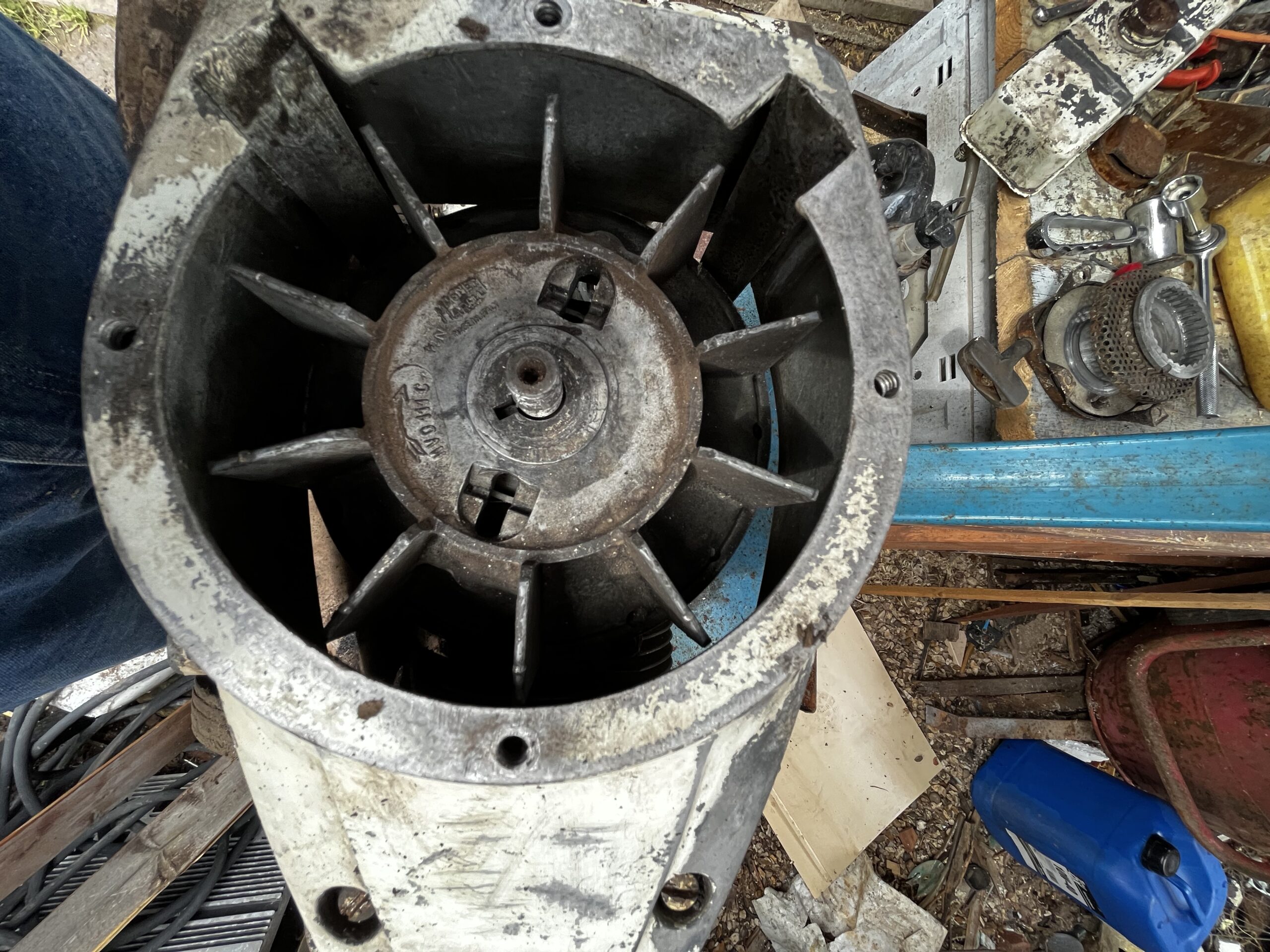

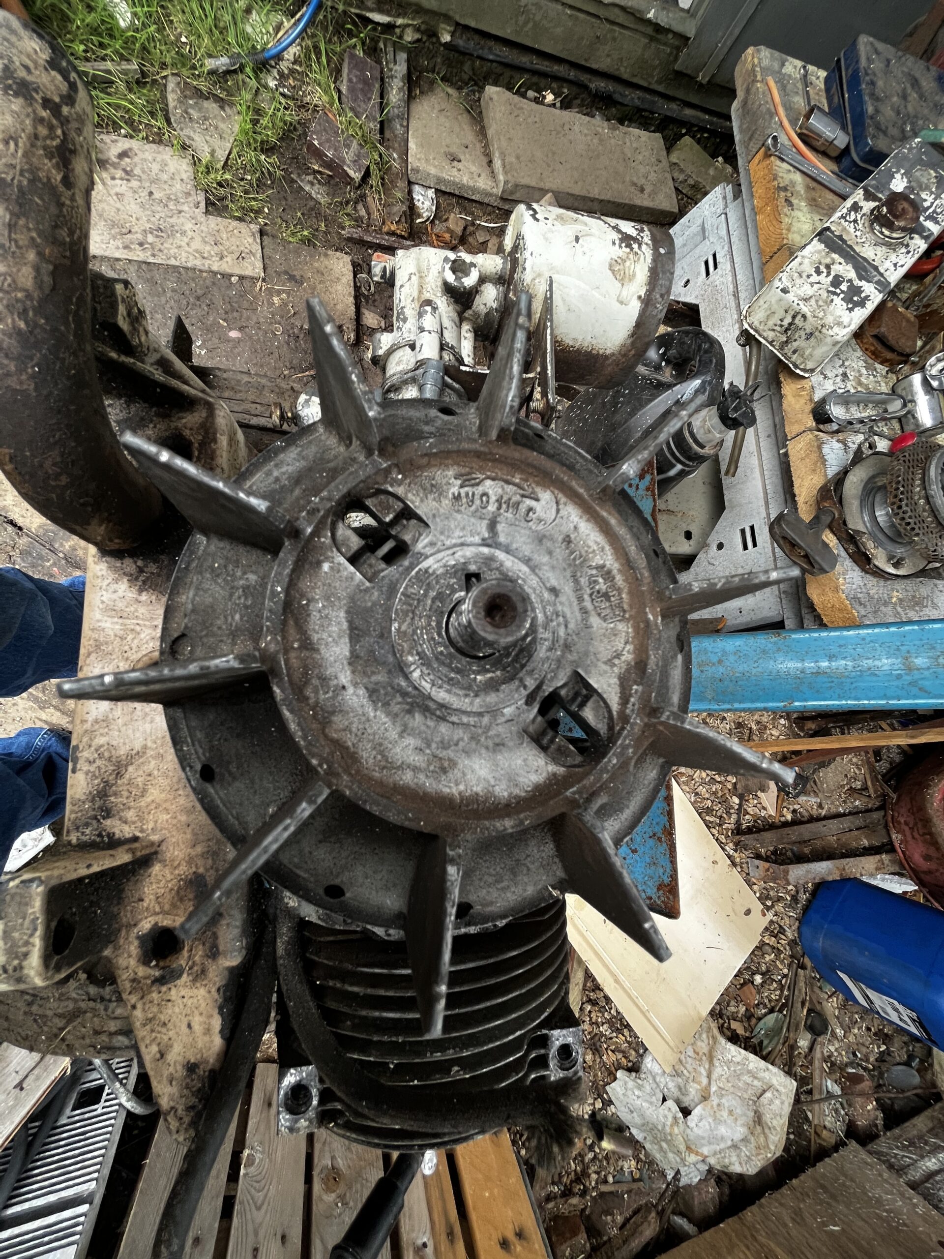

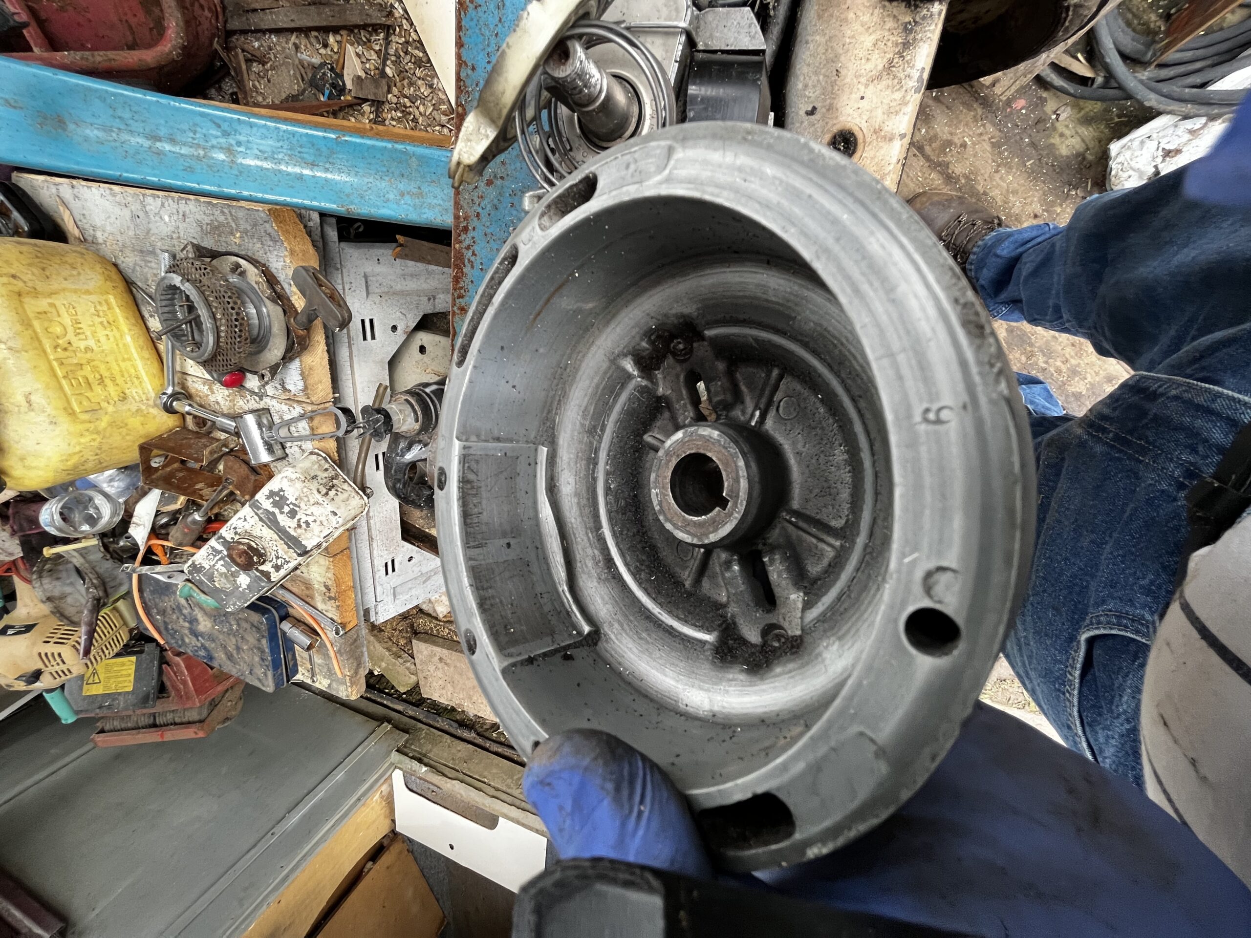

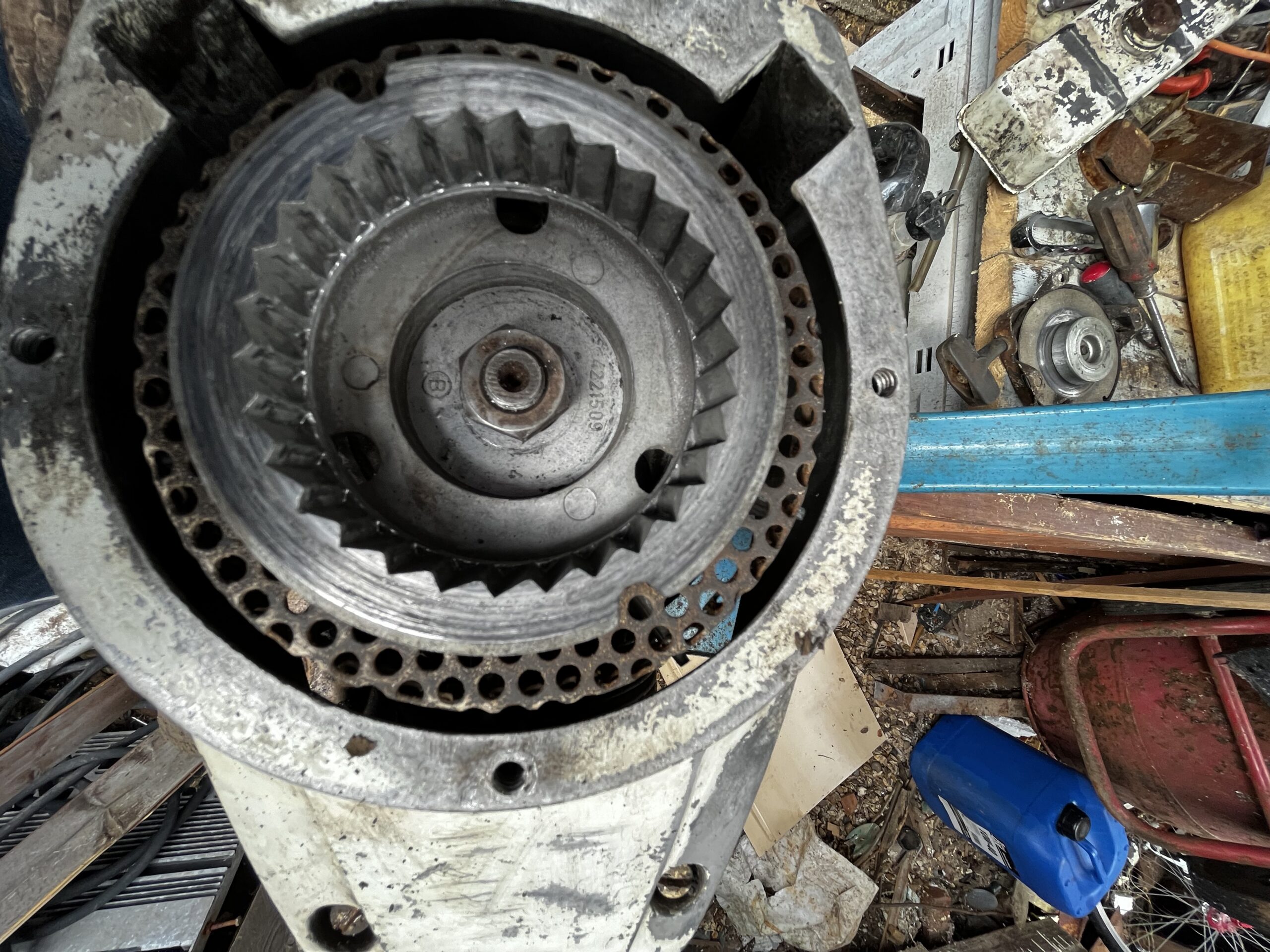

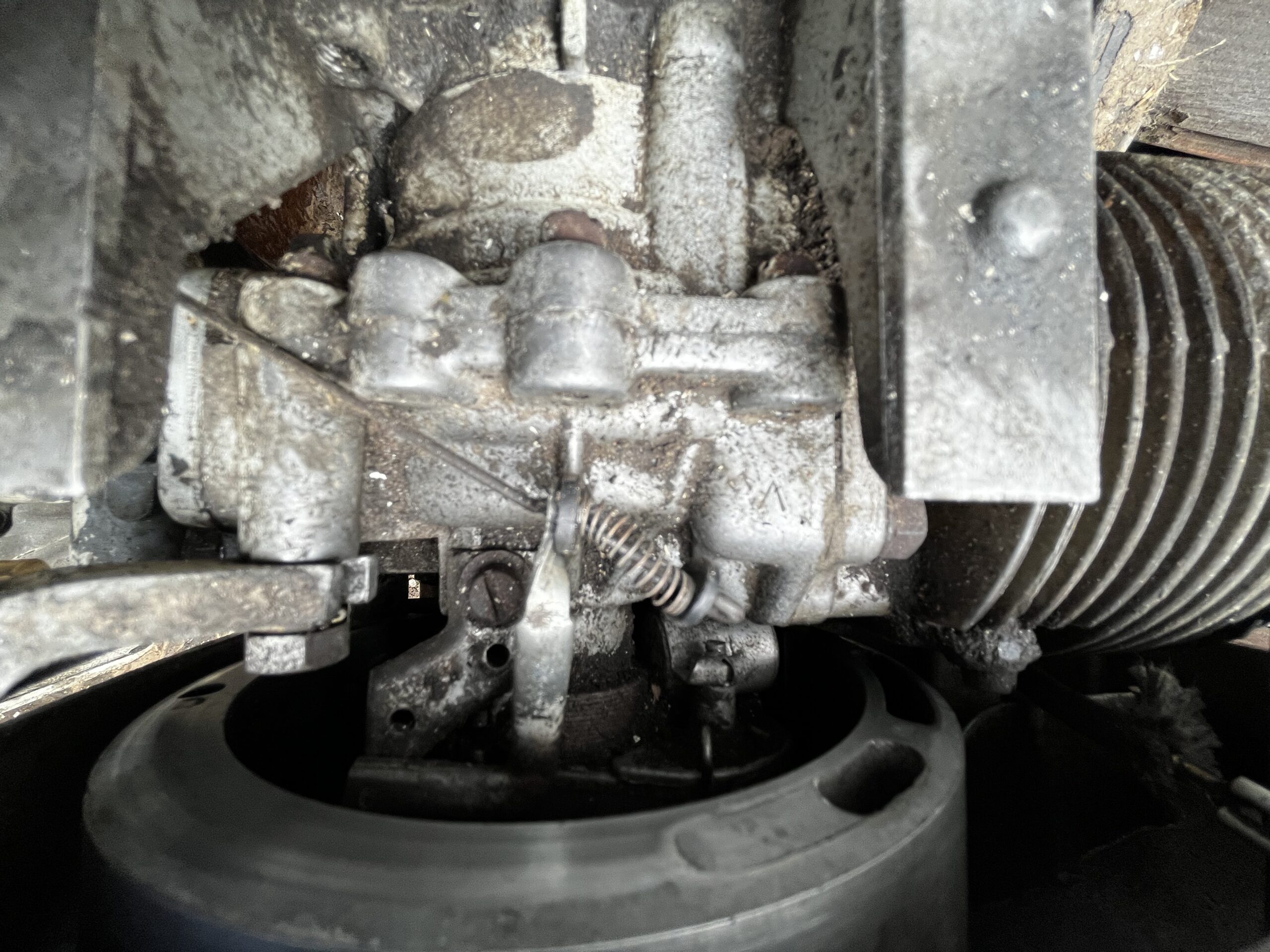

August 25, 2022 at 11:39 am #39825thelasershark

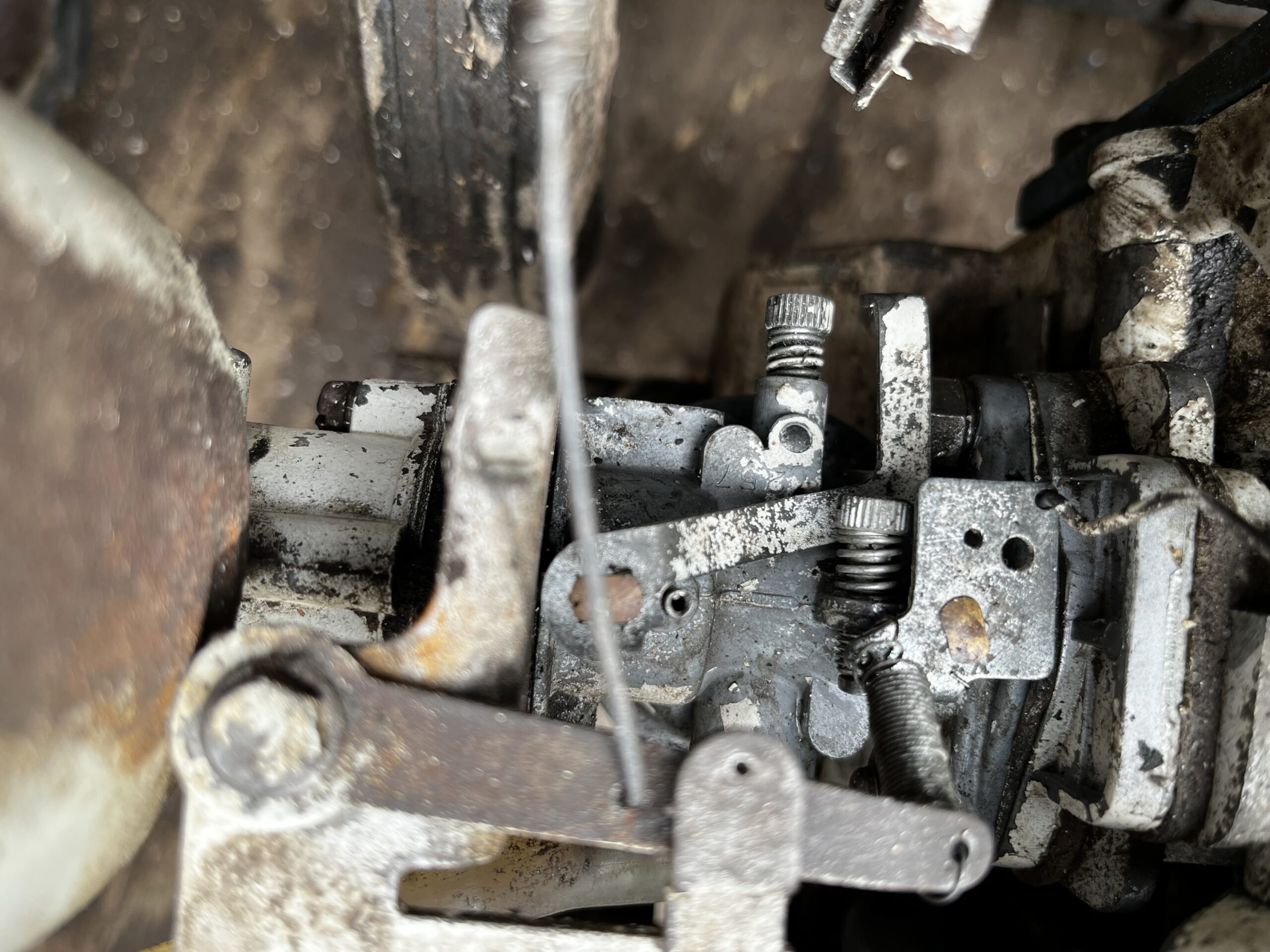

ParticipantHi wristpin, thanks for replying. Took it apart again this morning to take some pics as requested. I think it is an aspera engine. It’s the spring etc that goes on the magneto that is confusing me the most. The spring is on the last photos. In my head it seems to make sense for it to be located in the underside of the magneto with the white nylon bush thing pushing against the throttle rod spring thing in the last photo. I’m fact you can see where something has been rubbing
August 25, 2022 at 3:45 pm #39837
wristpinParticipantDefinitely an early Aspera with the early pattern recoil starter. I’ll try to dig out and post the appropriate shop manual pages . Your question re the throttle / Governor linkage is a bit more tricky. I can’t remember anything resembling your image and am fairly sure that it pre dates any manual that I have but I’ll have a look.
August 25, 2022 at 5:10 pm #39838thelasershark
ParticipantWell, I put it back together and it runs. Difficult to start but I think that’s something to do with the linkage issues, but could also be something to do with that big spring and nylon bush not being in the correct place? I have the bush against the vane arm in the last pic with the spring around the spigot inside the magneto. It ran for about 5 mins, and actually dug a little hole. Then stalled and was a bugger to restart. Do you know what carb kit / gasket set I need by any chance? It’s a lovely little machine and I think will come in quite handy when up and running properly.
August 26, 2022 at 8:22 am #39840

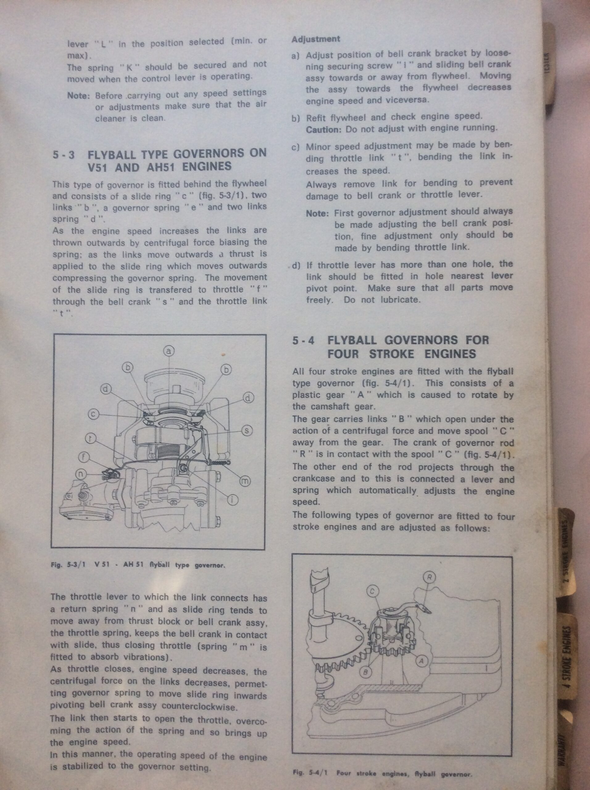

wristpinParticipantProgress! You appear to have sorted the starter and the outstanding issue is the governor. It appears to be of the “ flyball” type and I’ve never seen one , let alone worked on one, but it would seem to be as shown in the manual as the” Flyball type governor on V51 and AH51 and I hope that you can relate the attached image to what is in front of you. As I see it, The principle would appear to be that the throttle is held permanently open via a spring ( the governor spring) attached to an adjustable/bendable anchor. A link connected to the flyball mechanism under the flywheel exerts a closing force as the speed increases.
Hope that this helps.-
This reply was modified 4 years ago by
wristpin.
August 26, 2022 at 9:19 am #39844thelasershark
ParticipantPerfect thank you! Figure 5.3 shows my first issue perfectly. It would seem that I am missing “B” and “D” the links and springs that keep the slide ring “C” in place inside the flywheel.
The million dollar question is are these still available and if so, from where?
It would explain the difficult starting etc as without the links and and springs to keep it in place, the throttle is stuck wide open most of the time.
It also explains how I was able to start it easily once I’d built it back up, but not so after I dug the hole as the slide ring must have spun around and now be in the wrong position.

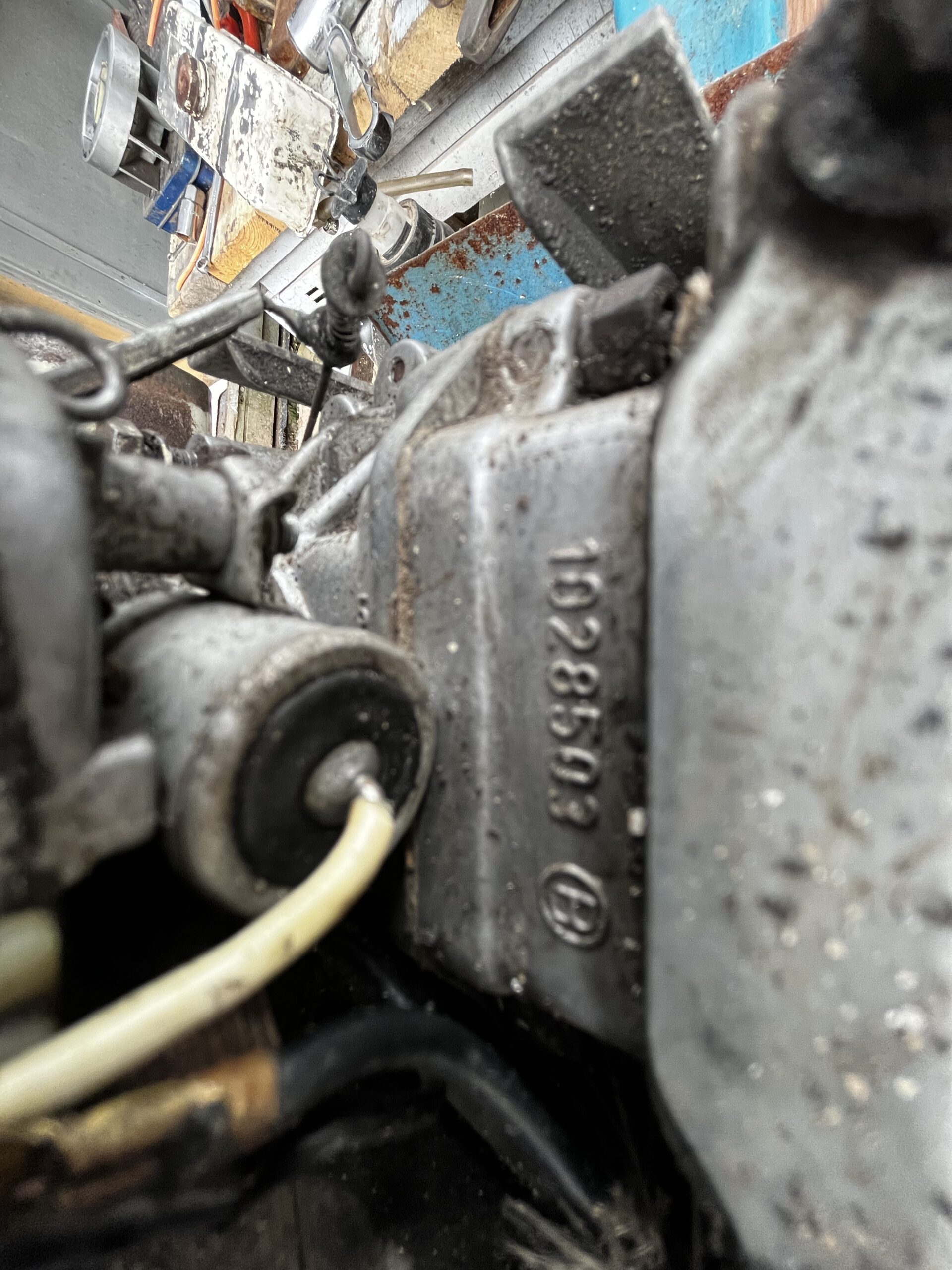

1028503 is the engine number 1 being the first number indicates the year on newer engines, could this thing actually be from 1951?August 26, 2022 at 2:17 pm #39855
