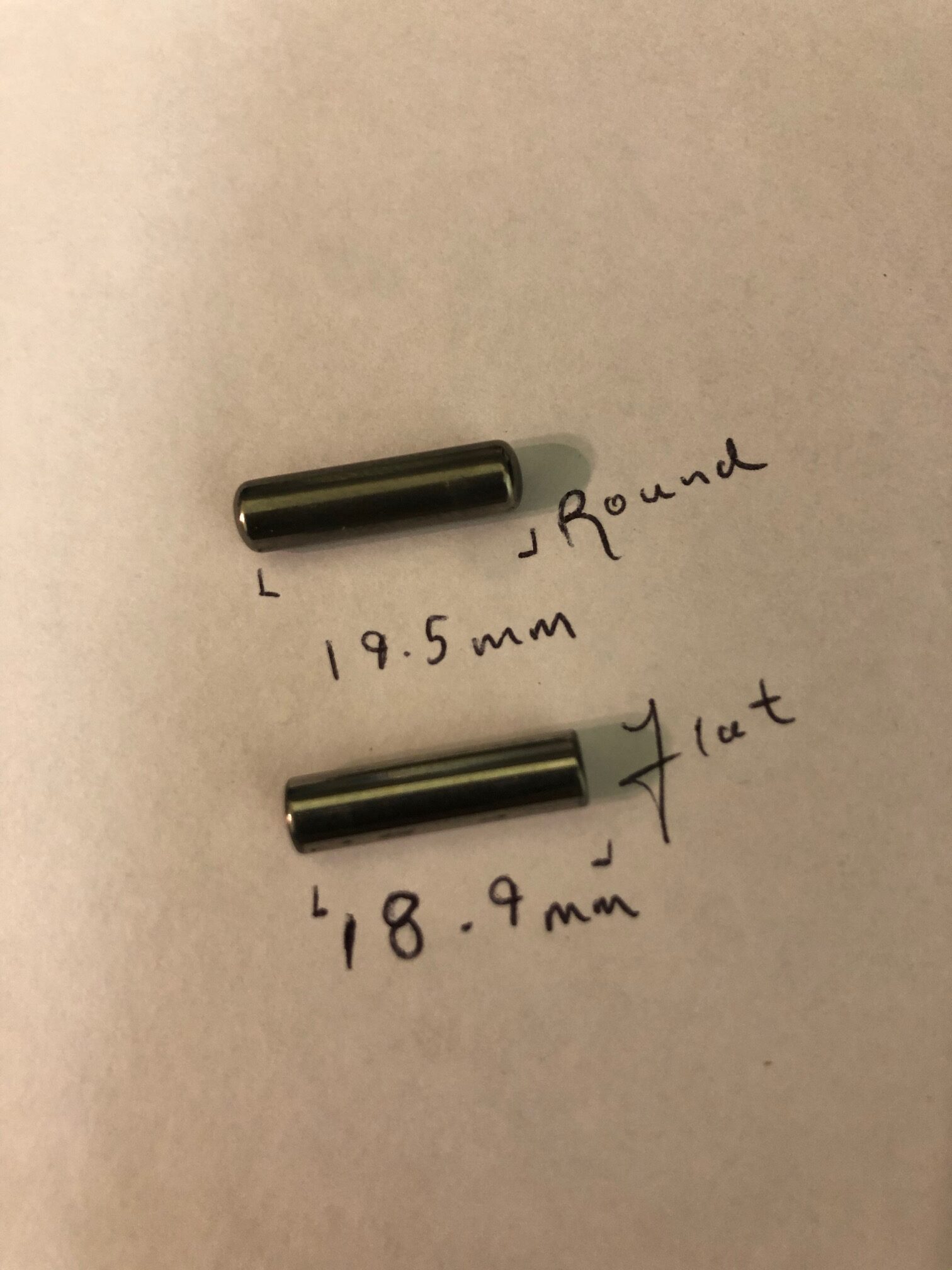

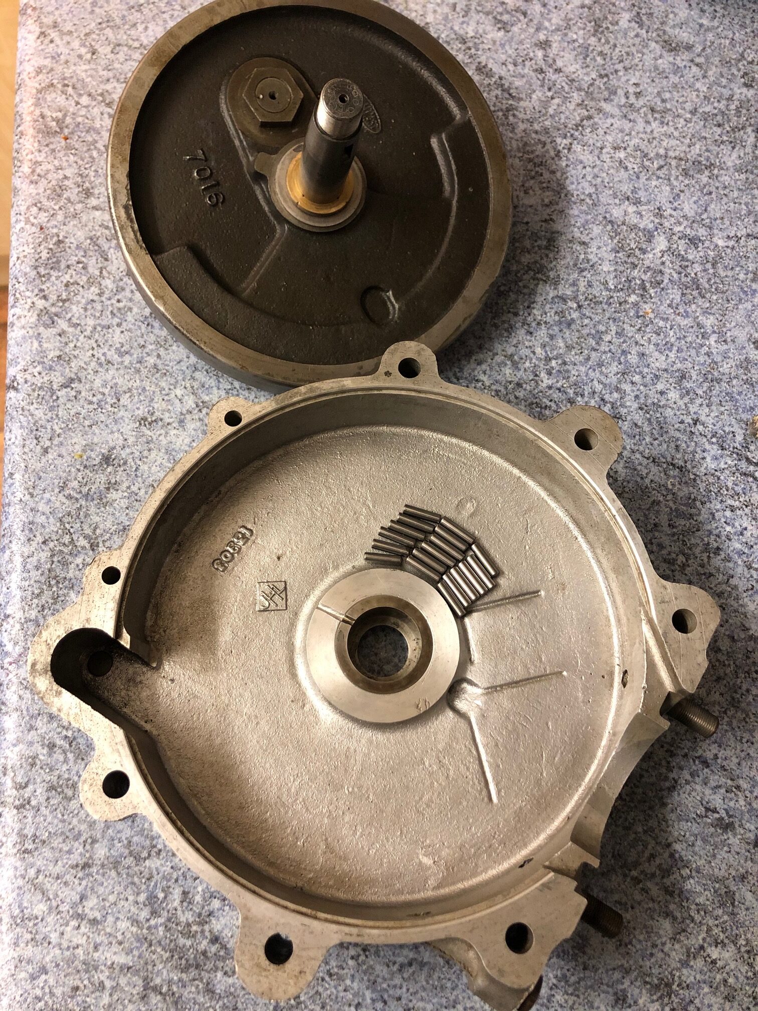

    I bought an unfinished project last year and am puzzled by the drive side main bearing.
    It’s a crowded roller type (no cage) with 5.00 mm diameter rollers.
    Most have flat ends but 4 are round (see pic).
    Interestingly the round end rollers are slightly longer.
    Is there a reason for this? Or has there been a mix-up?

    I’ve got a parts book for the JAP 600cc side valve Mark111 type 5 and the only place I can find a bearing with loose rollers is “timing side roller 15 “. You say drive side and your image shows 18 rollers! The driving side shows a normal ball bearing.
    So I guess that either I’m looking in the wrong place or even the wrong version of the engine ?
    #34557
    Hi, I think this is an earlier version to the type 5. Looks like it was later revised to a ball bearing – not a good sign for my engine 🙂
