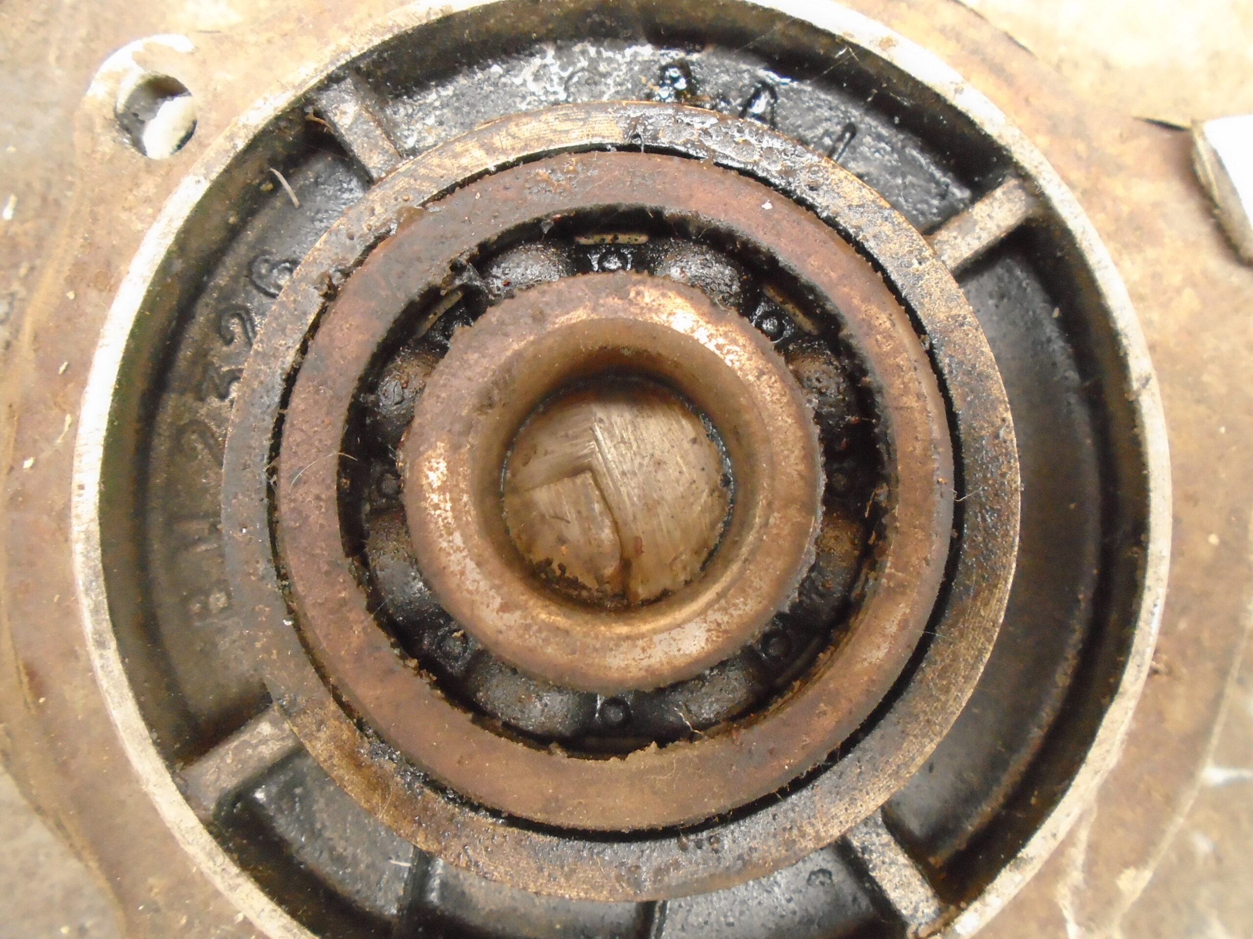

sidevalve5ParticipantHere are the photos of the sheared Villiers pump crank after a stone came through the suction hose and locked the impeller. Also the 2a grooved key and a cropped image of the bolt threads showing the original paint on them.
The clean cut on the crank vividly demonstrates what can happen when an engine suddenly stops stone (pun intended) dead and the energy created by momentum of the reciprocating parts has nowhere else to go.
