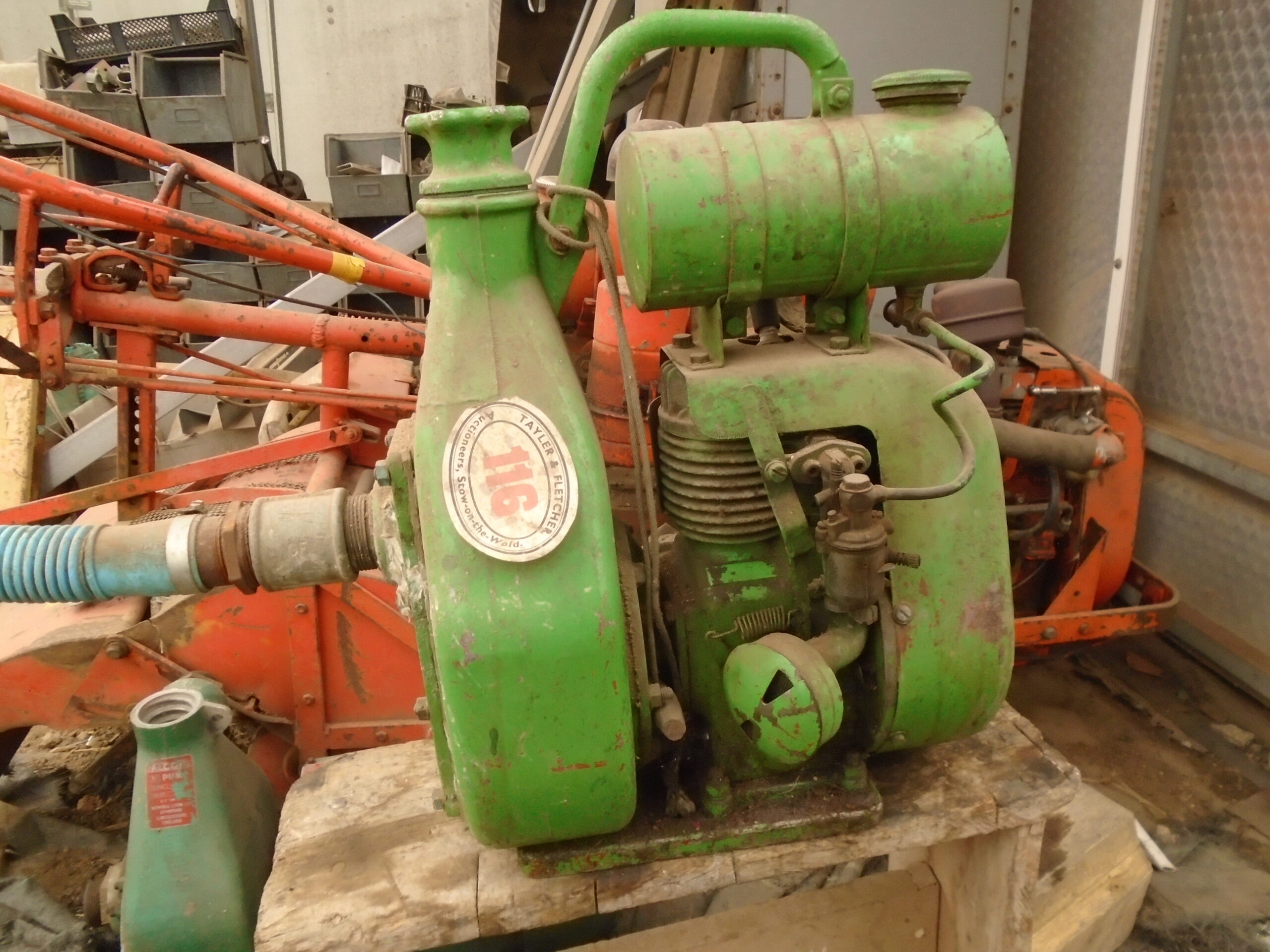

It looks like the engine was supplied to Alcon painted in red oxide and Alcon then covered everything in lime green. The inside of the cowling still has the red oxide paint on it. It does not look like it’s done much work and been kept in the dry, so will be a little surprised if the coil is duff. But until I get the flywheel off and test at the pickup, I will not know. Am actually not bothered if it is as I have been waiting to put an external single wire energy transfer coil onto such an engine. Know the theory, but have not put it into practice and this little JAP is an ideal candidate. Mocked up the coil I have yesterday and it will fit at the end of the fuel tank. Will keep you posted how I get on, but I will not be doing the full overhaul in one hit. Summer is the growing season when I use my machines, winter is tinkering time.

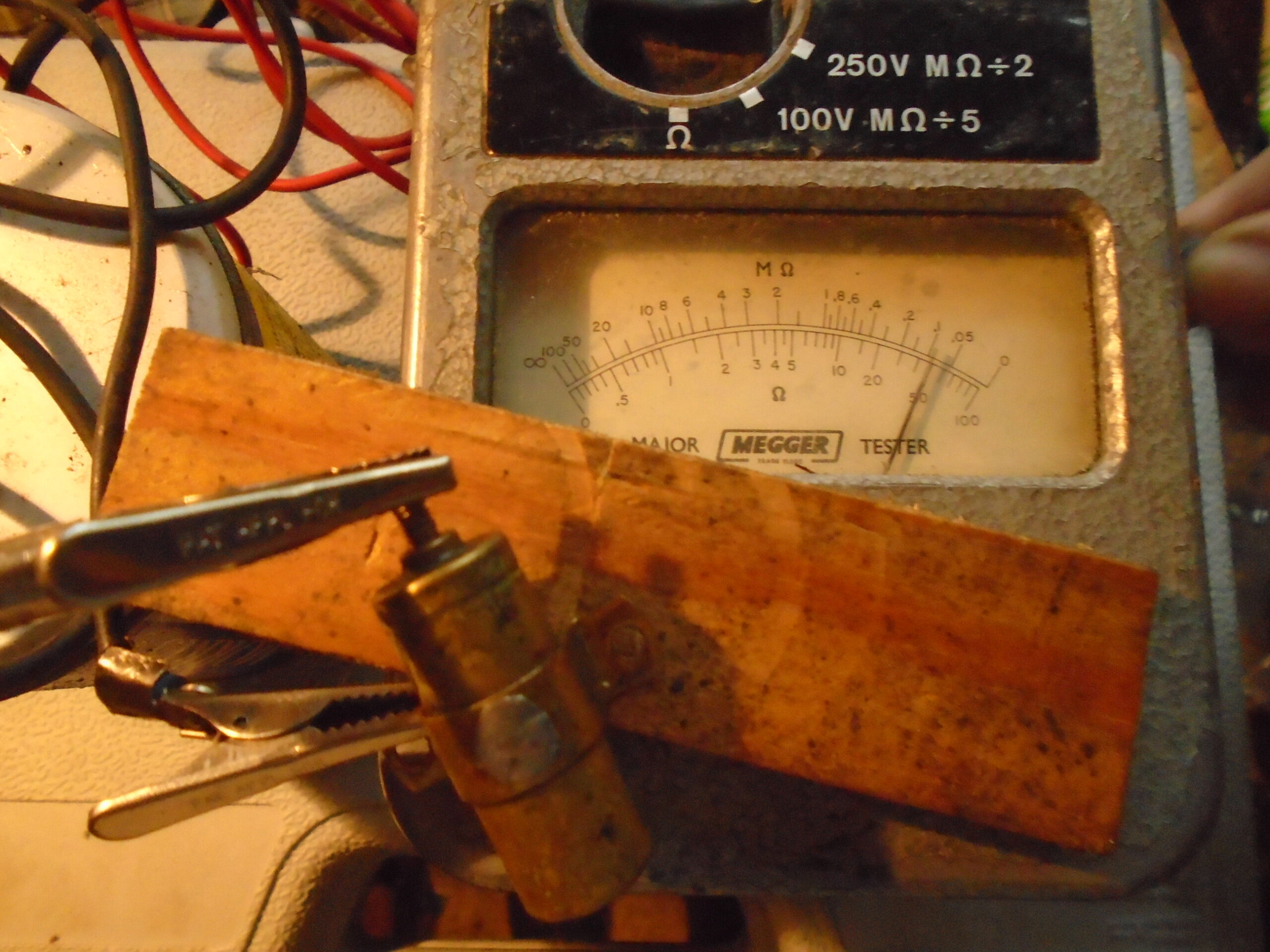

Initial continuity HT test showed a variable reading, think the black probe was not on a good ground. Have tested again yesterday, both HT and LT resistance is OK. Tested the condenser with a Megger, it failed. I do not use tradition condensers anymore, use a modern polyester film 630v 220nF/0.22uF capacitor. Was actually hoping the coil was duff so I could try again making up a single wire energy transfer coil system. Am still going to do it, but will take off the existing coil, make a former for a new coil, put the old one back on and complete the engine overhaul. Will test the spark from the existing system, then fit the internal coil I will have made and the external one. Then test that system to see if there is an improvement. Have attached the external coil I am going to use. All good fun.

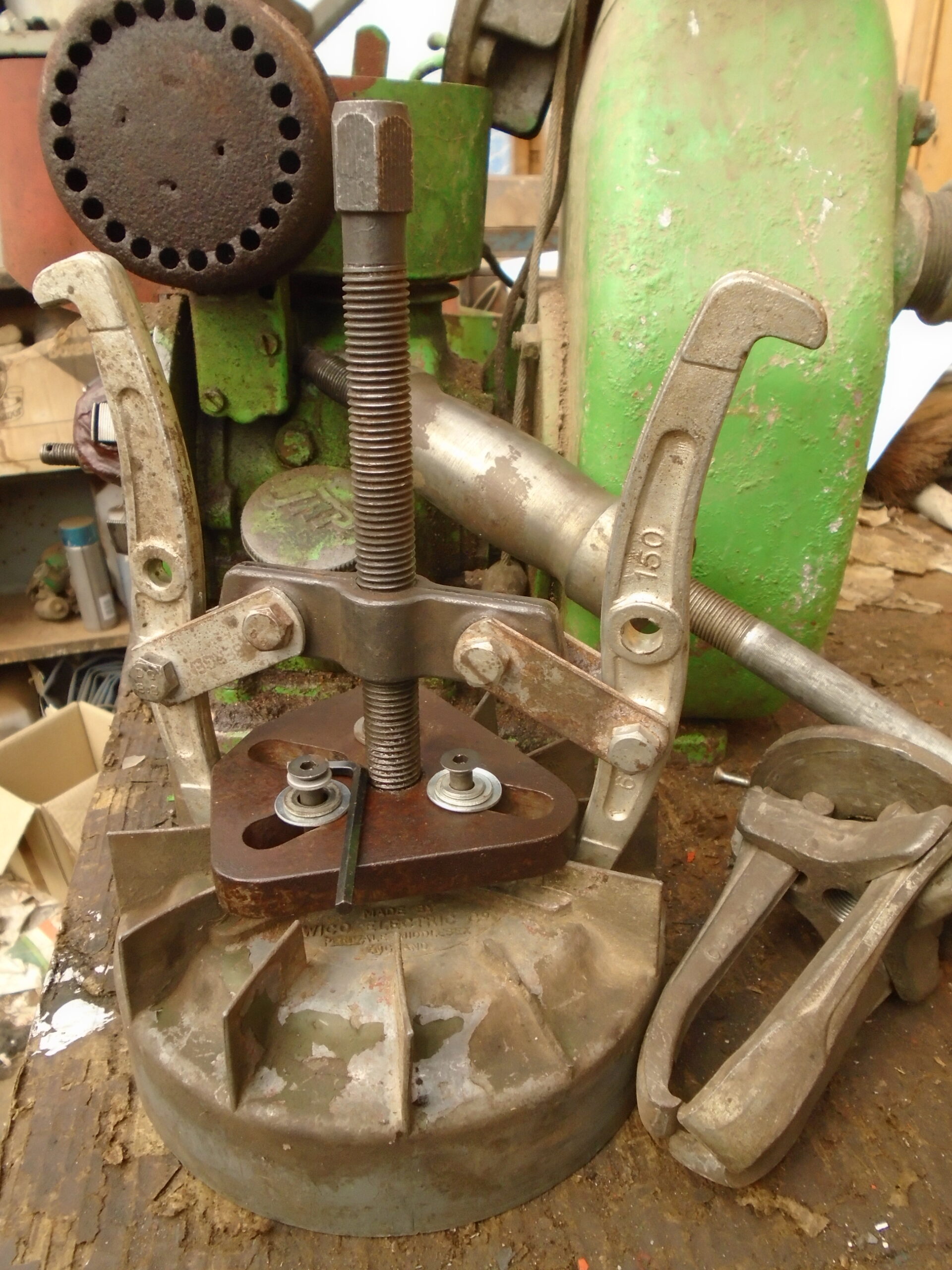

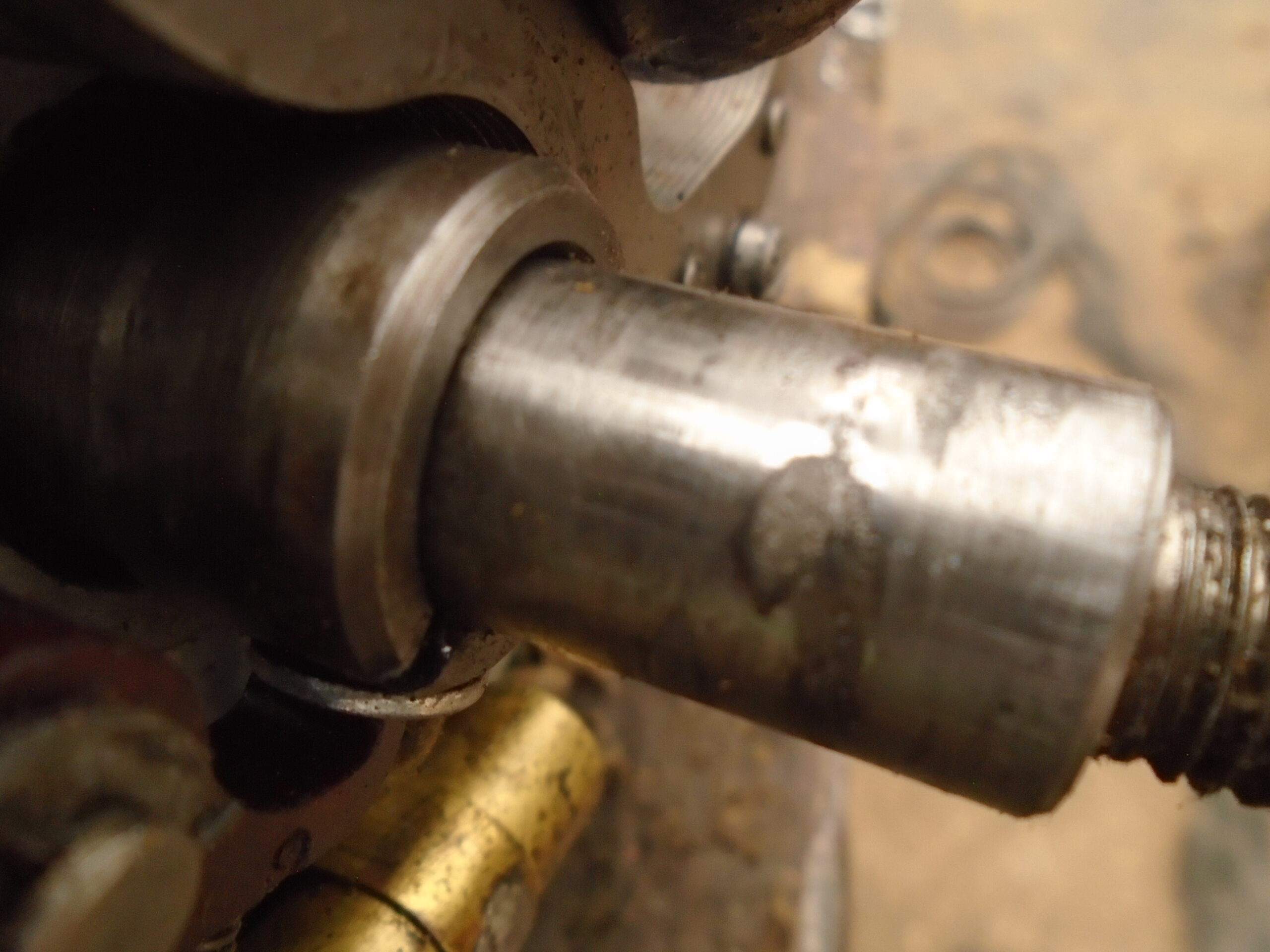

I would agree that a 2A is a very simple engine to work on. Where we will diverge hugely is that because the flywheel was all but welded onto the crankshaft, it was a devil of a job to get it off. Your method would have failed in the first instance. Persisting in it would have damaged or broken associated parts.
Attached are more images of the state of the shaft and the puller method I used, complicated you may say, but a necessity if the seized flywheel was to be pulled off the shaft. It consists of two pullers, one with the 4 hole attachment that I could fit the 3 whitworth bolts into. The bolts ideally needed to be longer, but this is all I could get hold off on a Saturday morning. Because the side hammer element would not fit as the crankshaft was too close to the centre hole. I got another puller to go on the attachment and placed 2 nuts in the middle hole to act as a centring spacer. It involved a 1/8 turn of the puller hex end, followed by several sharp blows on that end, for another 1/8 turn to be done and more blows. Repeating the process many times until it was free. You may describe it as complicated, I believe that I used care, skill, experience and a range of tools, applying them all in unison to do a difficult job.
Again you may say my ignition testing technique that I have shown in the imagery is complicated. I would contend that it is a simple and quick diagnostic method of establishing where a magneto ignition trouble lay. In this case it was a 74 year old condenser with a wax paper dielectric, the primary and secondary coil windings are fine. Sending the ignition parts away to be tested, or just using the substitution method would have resulted in additional time and unnecessary expense in fixing the problem. FYI, testing took 4 minutes, the cost of the polyester film capacitor and board to mount it on is 45p, estimated time, 15 minutes.

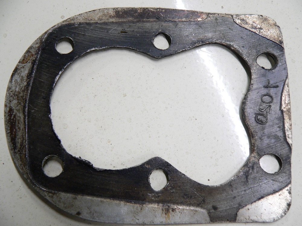

Had another look at the engine yesterday and indeed it does have a head gasket. When I took the head off on Saturday I only took a quick look at it, noting it had numbers stamped on the contact face. It was covered in thick green paint. The numbers were an imprint of those stamped on the cylinder and into the soft head gasket. A closer inspection revealed the head gasket.

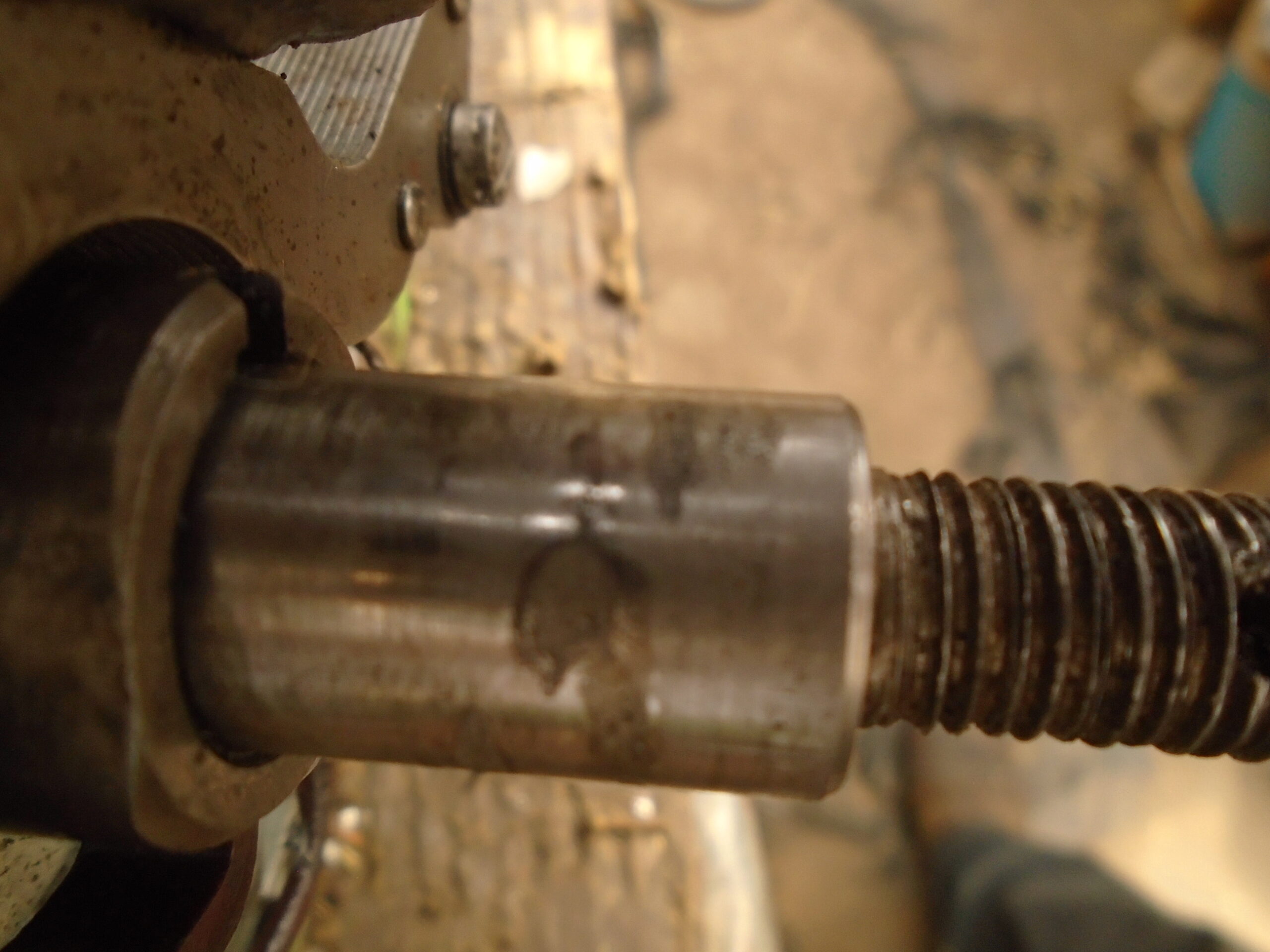

I also had a more detailed look at the crankshaft and hole in the flywheel. Both had roughness and have started to flatten it off the shaft. It appears to me corrosion, but not from water. Still think something was on the shaft or in the hole during assembly, maybe an acid type material. The good news is that I can flatten it off so the correct interference is restored. Am going to re-fit and take off until I am satisfied the flywheel will come off as it should.

ParticipantAndy In Grahame’s photo just visible I recon can see hole in the thread towards its end, I have seen all these sort of things bodges get up to, like a nut coming loose so they found one with a tighter thread being a different thread rate. Going back many years the one of the engines I had was a bit flat for some time but always started and checked the timing think 30 degrees BTDC if I remember right that didn’t improve things, then changed out the complete unit, only difference was the points, seems a bit odd as complete arm made of Tufnell used a flexi wire from coil and the stationary point was earth, whereas all the others have been opposite so stationary was insulated and fed from coil and point arm had just a fibre heal rest all steel earthed through the spring so less likely to fail, well it worked.

ParticipantDavid , I’m not at all savvy with PCs , and haven’t yet fathomed how to blow-up photos , but the rollpin in his pics appears to me to be on the opposite end to the threaded part , but of course I could well be mistaken on that. Grahame states that he knocked the rollpin out , which to me would suggest that it went through the crankshaft , something I’ve never seen on the countless 2As that I’ve worked on.

The roll pin is actually 3off, 2 larger ones and a centre spacer that is in the middle of the crank. Was going to not use them, but now am having second thoughts. After reading what David wrote, they could prevent the pulley pressing tightly on the flywheel because of a machining error on one of the associated parts. Rather than throw the batch away, fitting a roll pin was a more economic (bodge) solution. The ‘corrosion’ could be a type of loctite to prevent the flywheel moving in and out on the shaft. Am not sure about this. Going to grind the valves as I think this is the cause of the lack of compression, the seats look terrible because of years of storage with the valves open. When I re-assemble, will try to work out why the roll pins were fitted.

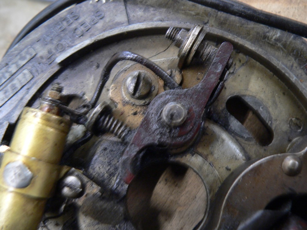

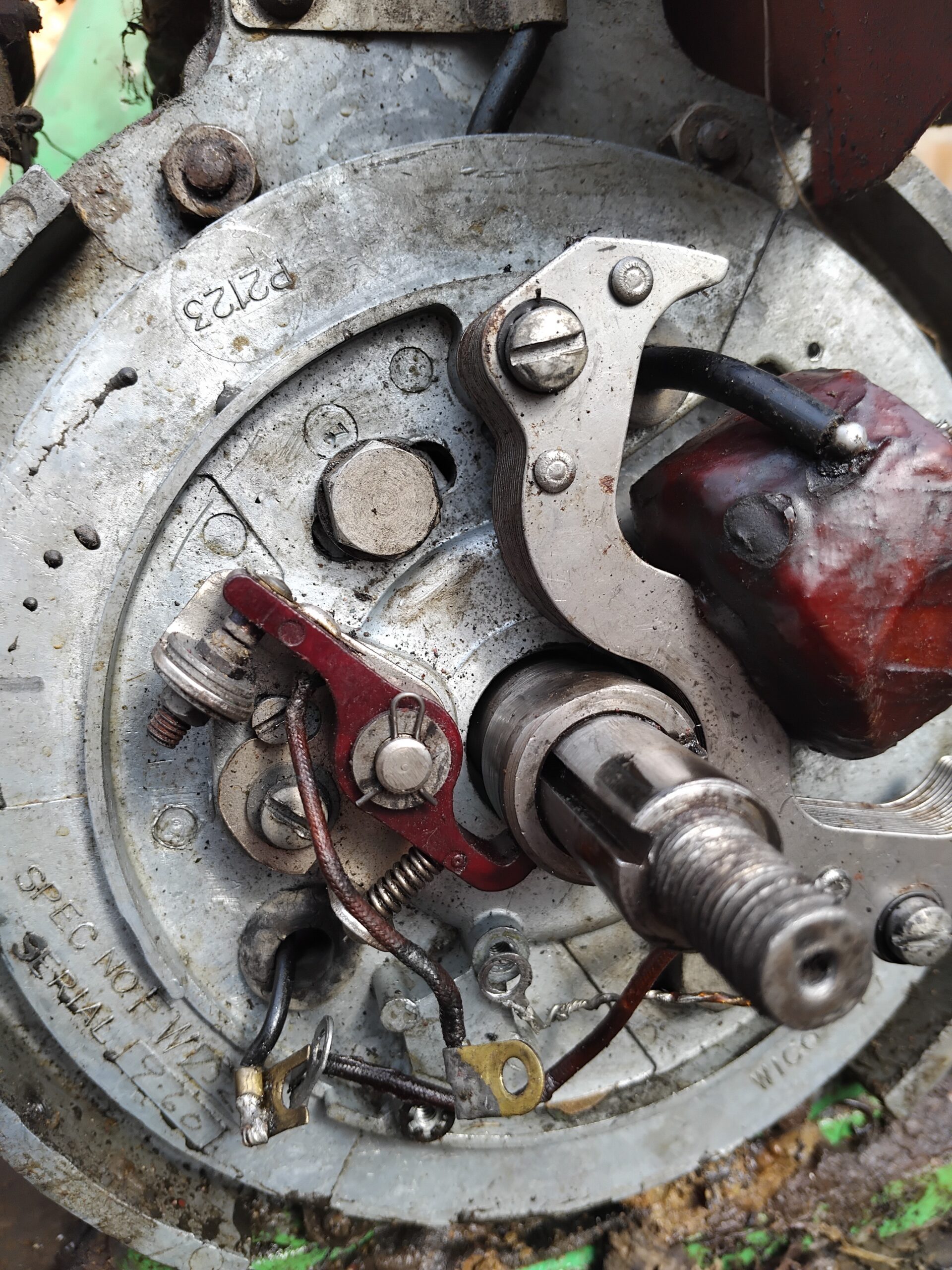

Have a 2a on a Colwood that I have had and used for 30+ years. The info I got all that time ago was the points gap is 0.018 – 0.020”, timing 30o BTDC. Have taken a picture of my points set-up and it looks the same as David’s. Believe mine has not had the cowl off since the day it left the factory, so it’s original. Can alter the timing by moving the armature backplate on the slots as shown in the photo. As the cam for the points is separate from the flywheel, can set the timing with the flywheel off. But expect it to be spot on as there is so little wear on the engine. Do not think it has done more than a few 10’s of hours since 1951.

The points gap is usually stamped into the points inspection cover , I would hazard a guess that your engine has been “got at” at some point in its life.

Be sure to re-align the key with the cam , looks like yours has moved.Andy.
