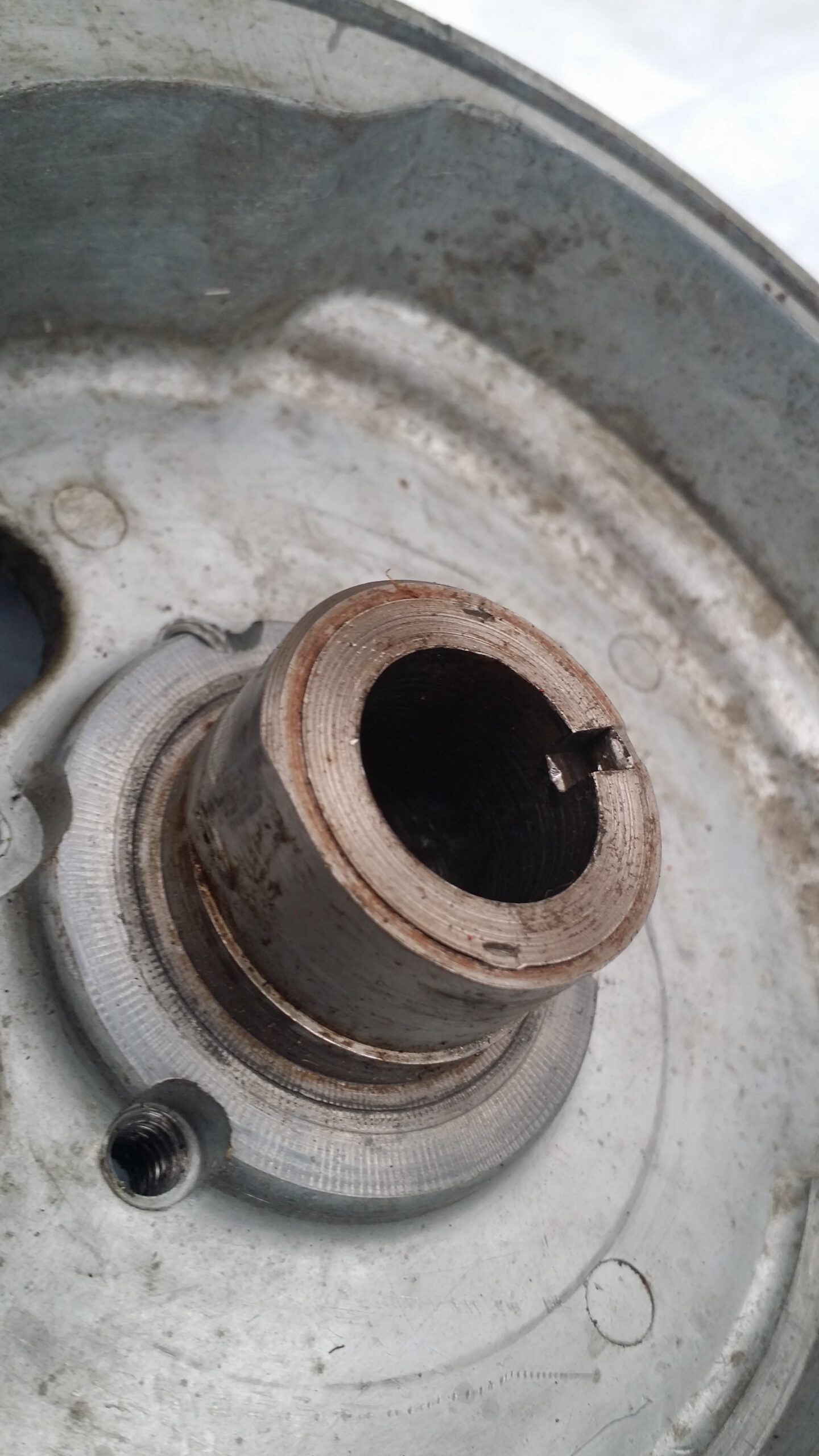

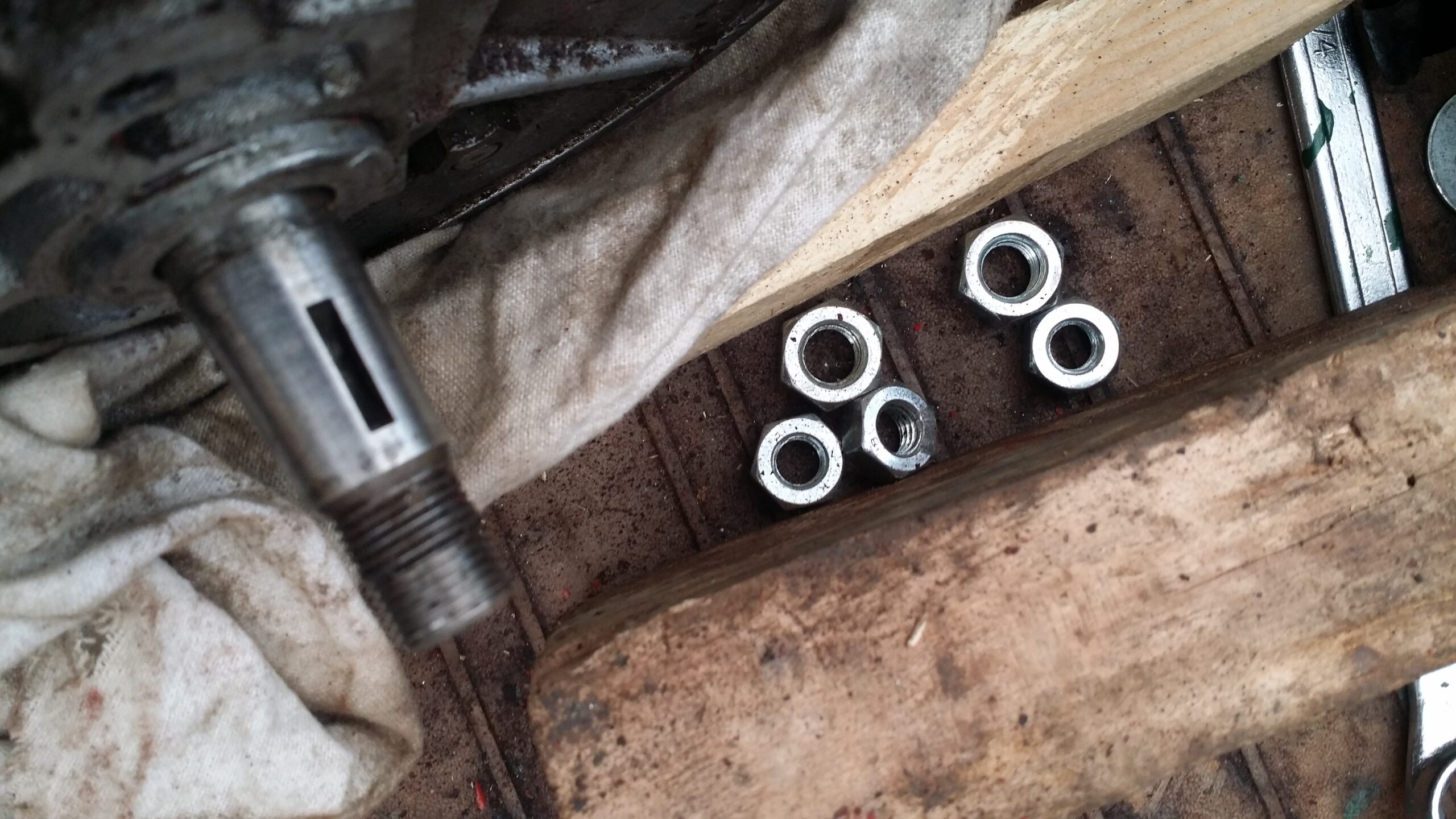

    Hi I have removed the wipac flywheel on a jap 16H 2 stroke engine to gain access to the points and coil. when the flywheel came off I noticed that there was no woodruff key in the shaft and then spent the next hour searching the floor (promising myself that I would keep it clear and clean in the future) for the presumed lost key that was never found.On further inspection I have noticed that there is only a small indication groove in the flywheel and no way for a key to pass. I know that the key on B&S engines are alloy and only for location prior to the tightening of the wheel to the shaft taper. I can only presume that a key on the landmasters 16H is not fitted and the flywheel is aligned by eye.Is there any one who has knowledge of this component who may be able to advise on the flywheel fitting? Unfortunately I do not have an engine manual only an engine parts list which show a woodruff key.I have another 150 but it has a B&S fitted. I will post a couple of photos later.
    Many thanks Len

    Attached a couple of photos of the flywheel and the shaft

    A 16h definately should have a woodruff key.

    The flywheel type looks similar to the Villiers ones with a cam on the flywheel boss. Villiers engines don’t have a key but rely on the taper to keep them in the correct position. Basically, if you put the flywheel onto the crankshaft and tighten it up on the taper it will produce a spark when you spin it; the knack is to put the flywheel in the right place so that the spark occurs at TDC or just before (BTDC).
    To achieve this it is best to remove the cylinder head, then rotate the engine in the direction that it runs. For an engine of this size you should stop the rotation when the piston is 1/4″ from the top of the bore before it reaches TDC. Do not turn the crankshaft, and if you can lock it in position so that it doesn’t turn even better.
    Next you will fit the flywheel loosely on the crankshaft, fitting the flywheel nut to prevent it falling off. Do not tighten it to the crankshaft yet. The flywheel can then be rotated around the crankshaft and the points gap observed. Rotate the flywheel in the direction that the engine runs, watch the points close, keep rotating the flywheel slowly until the points gap starts to open. This is when the spark will occur. Without moving the relative positions of the crankshaft and flywheel you should now tighten the flywheel nut to lock the tapers together.
    The engine should now be timed.

    Your flywheel and crank clearly show that a key should be fitted , get yourself a snug fitting key and you do not have to faff around with the timing as described , it will be spot on with the keyed method , it’s the whole idea of having a key in the first place.

    The key will have to be machined (filed) to a boot shape as the keyway on the flywheel is only about 3/16 deep I will post a few photos when completed I have another 16h that has never been used it is a bit older than the one I am working on at the moment.it may have a differant magneto and set up I will see, just don’t want to open it up whilst the workshop is so full

    Get a selection of imperial woodruff keys ……..job sorted.
