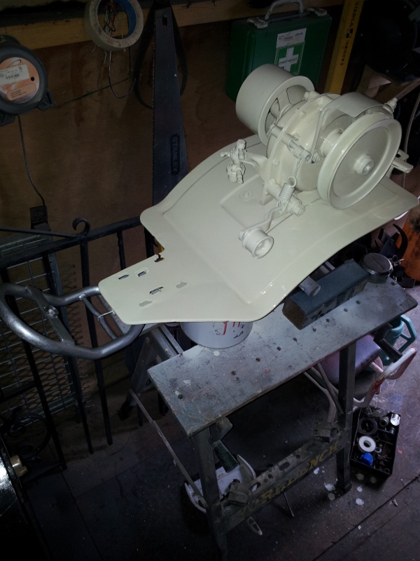

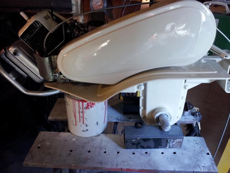

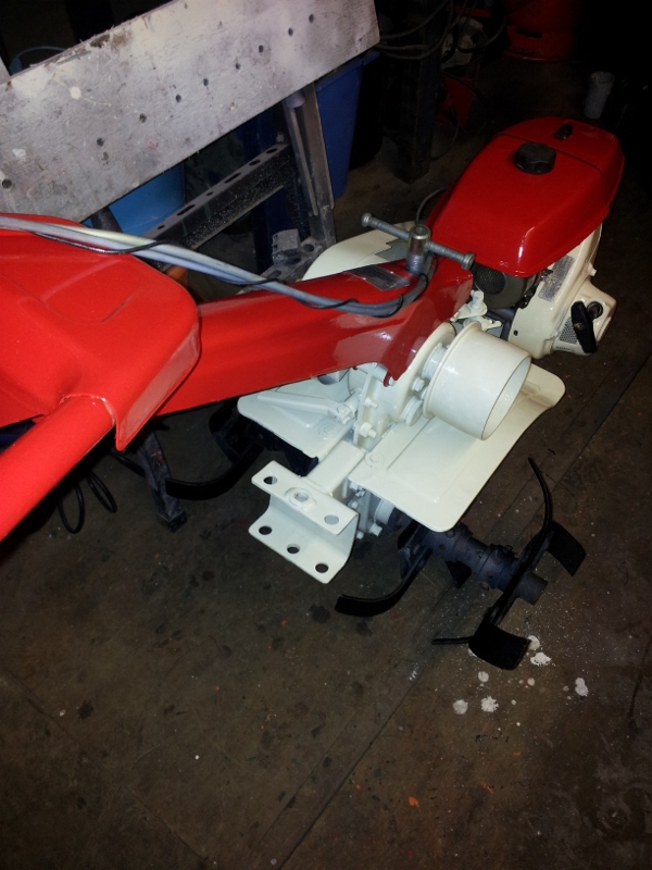

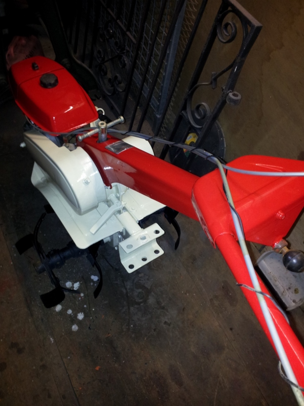

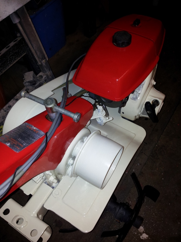

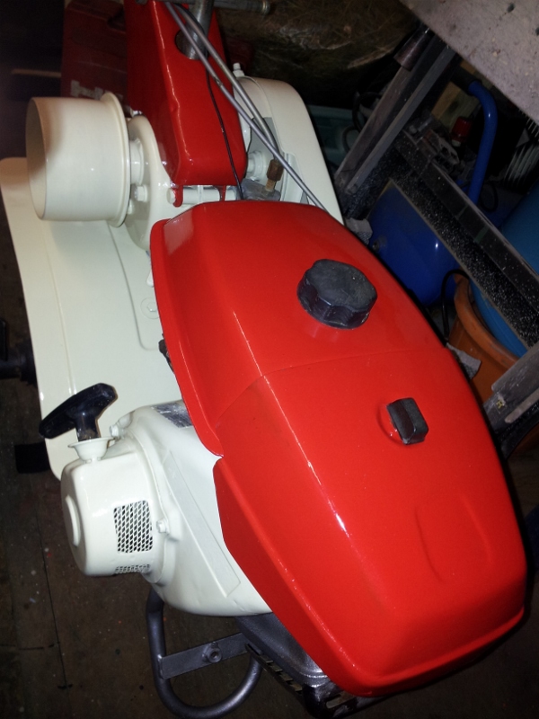

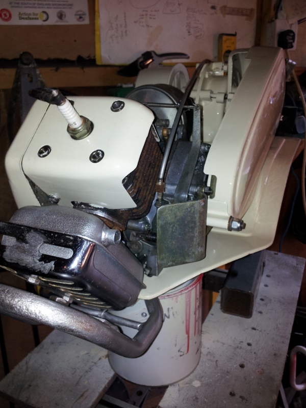

    Not finished yet but I am starting slowly reassembling.
    #6243
    Went for car MOT today and I was slightly unaware what the man would find as its my first one with the new car. as look would have it the car passed PHEW panic over for twelve months. Back to thread. More bits added, and some filled and first coated,so overall had a good Saturday.

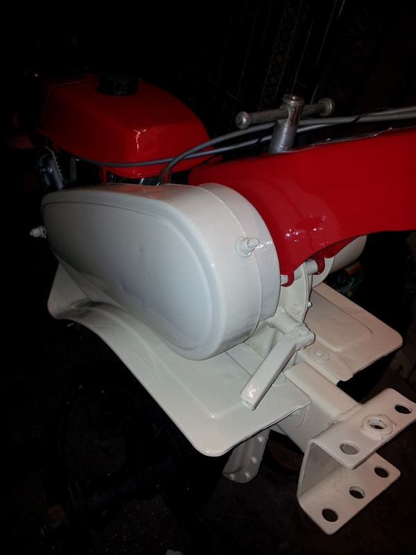

    Might as well come clean before someone notices it. on the belt guard I have missed a ding,drat. sometimes you cannot see them until the paint goes on. A graphic actually covers where the ding is so will hide it from view,once I get them ordered.

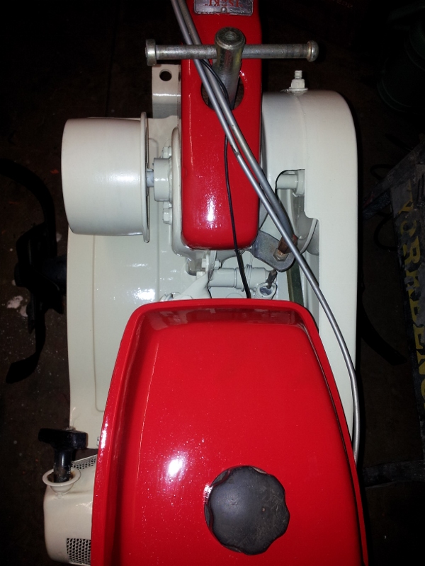

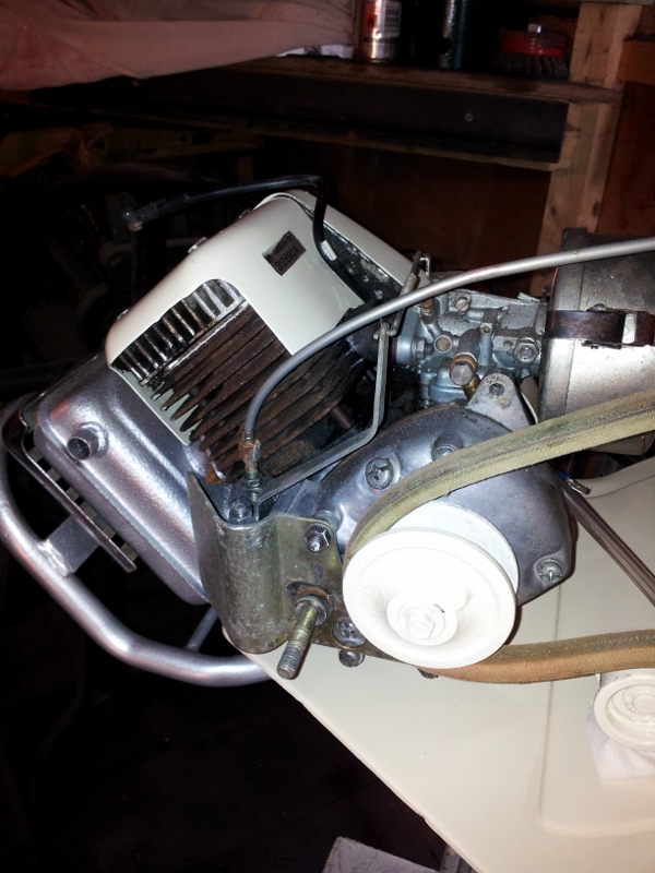

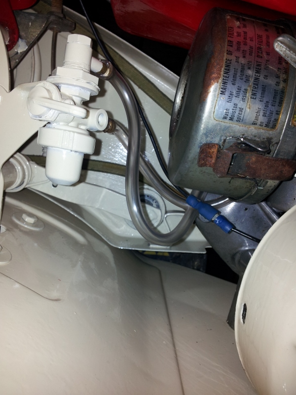

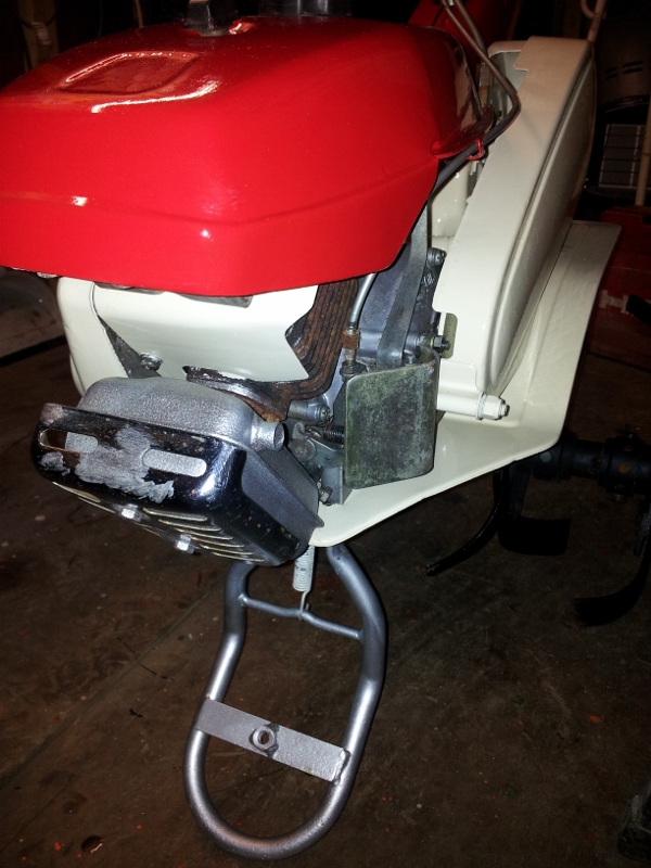

    Making good progress now with the rebuild,and have taken some photos for the record. did have problem with a rusty inside of the tank but have put gravel in and given a lot of shakes,also washed out many times and I think its okay for the moment. One of the pictures shows the fuel bowl and fuel lines. I have made the one from the tank slightly special. I have made the pipe similar to a sink P trap and any rust will because its heavier than petrol will settle in the trap.also with the fuel line clear I can see when it needs draining. WIZZARD EHH !

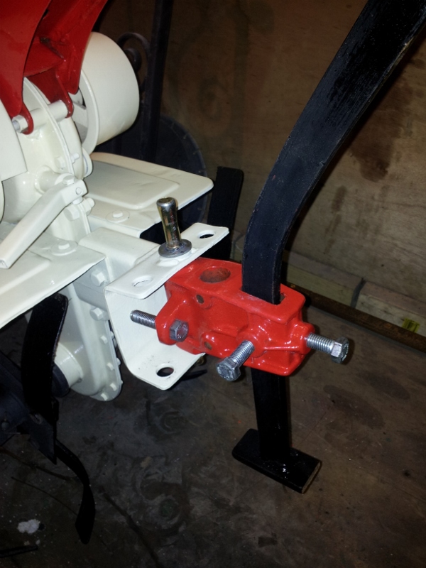

    Have been lucky at work this week because we are putting up a huge shed size 100 meters by 80 meters,and of course I am on the beg for anything I can use for restos. for example all sizes of new nuts,bolts and washers and steel flat bar of all sizes. I don’t feel bad about being on the tap because it saves me some cash……..Have now finished the rear depth leg and is sporting some new bolts. also this week have been given 2 rear wheels and tyres from a scrap ride on mower and am in the process of making some transport wheels for this also.

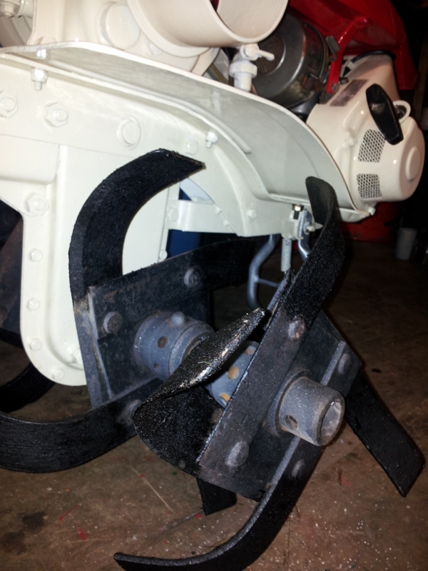

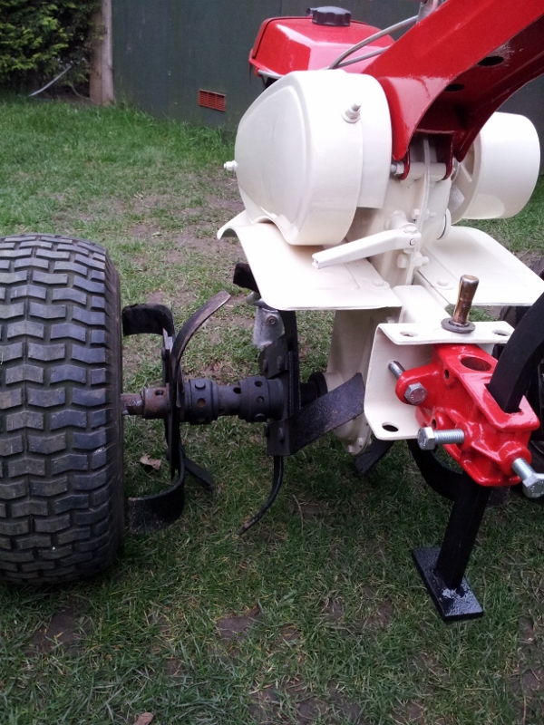

    One final touch before decals and that’s the home made transport wheels. have given this some thought as some rotovators rely on the operator to push them to the garden and if your aging that could tire you out before even fighting with the machine in work mode. So take the lot with you and let the machine pull you along ,makes good sense to me. The rotars are about one and a half inches off the ground when wheels attached,so no damage to pavements as you travel along to the allotment
