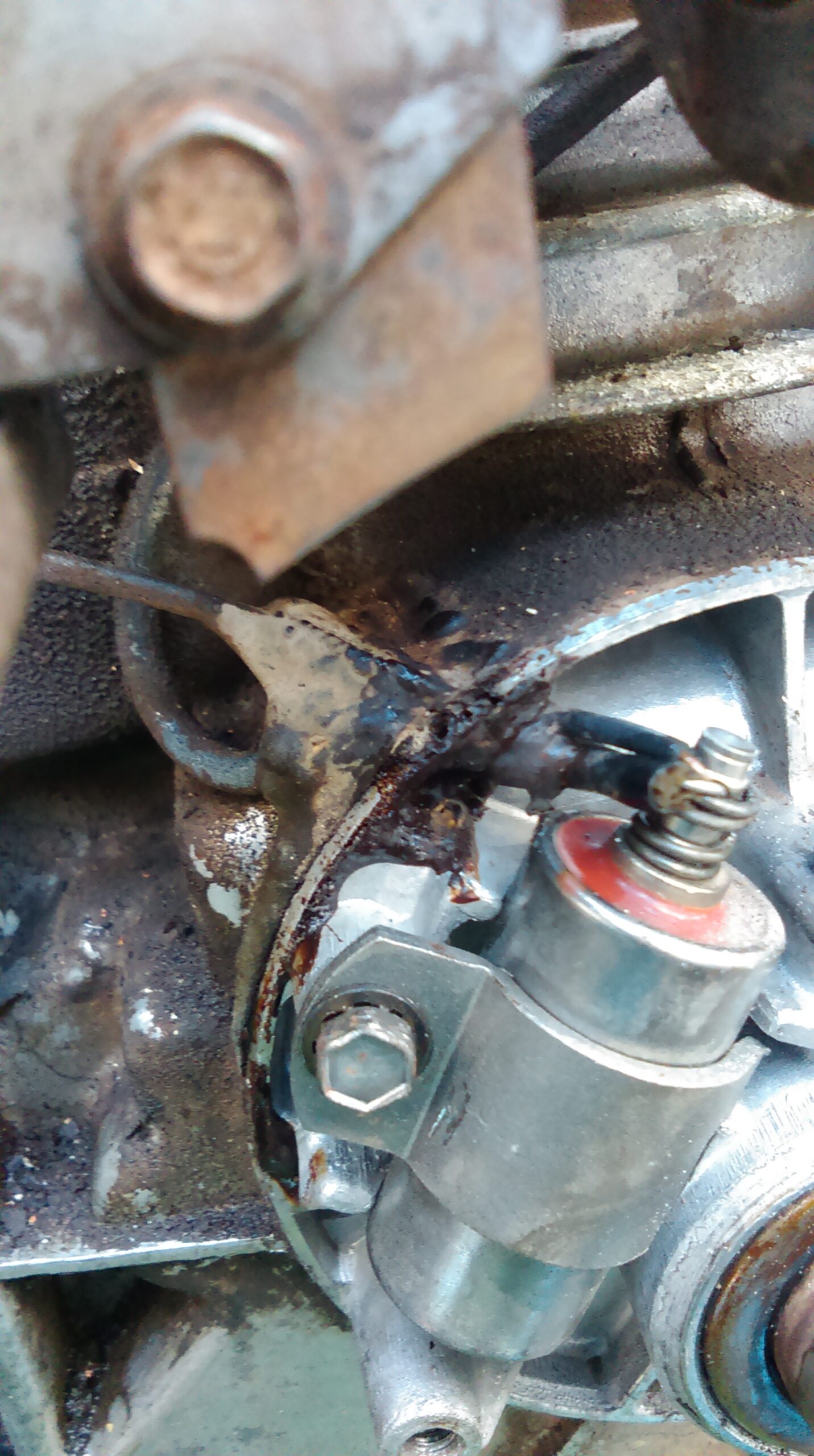

June 8, 2015 at 1:38 pm #13355
vhgmcbuddyMemberBefore I wasted £15 on points and condenser I tested the coil from the end of the spark plug lead to the metal body and got a reading of 2.70 ohm. If I test the lead that comes from the coil to the condenser it gives a reading then drops down to 0.00, So should I be testing for continuity instead.
