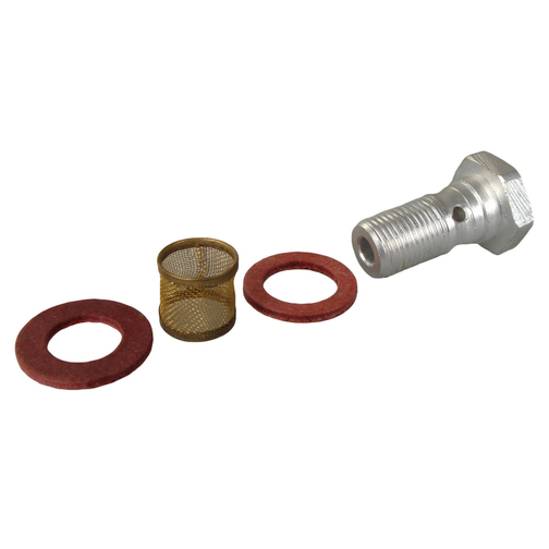

    There should be a filter gauze in the banjo connecting fuel line to carburettor, see photo for example which I found by doing a search using google.

    Hi Charlie, Thanks for the reply. I’d seen there should be a gauze filter in the banjo but it was missing. Probably lost somewhere along the line by the previous owner(s) over the last 59 years and just been run without it.
    Remarkably, no grot present but I thought I’d replace with an original but I can’t find one on-line (Mr Google failed on this occasion) so thought the next best option was an in-line one to prevent grot getting anywhere near the carb while I try sourcing the proper part. So still asking and still looking for something suitable for a gravity feed. Cheers, Mick

    Charlies pic is not the gauze filter for the S10 carb , it has a much smaller one , try Paul Childs at Meetens , he should be able to sort the correct one for you.

    Hi Andy, Thanks for the reply & advice. Will try Meetens. Cheers, Mick
