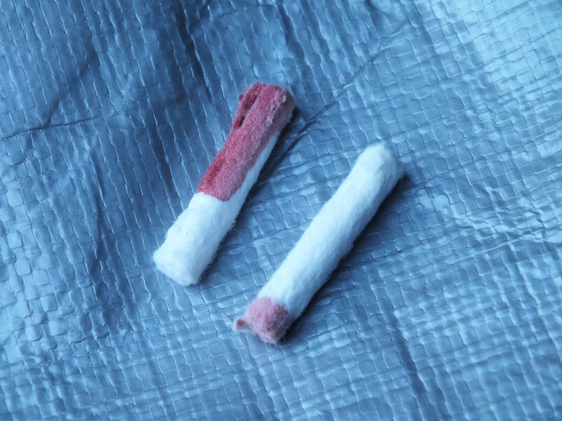

    While using my MG40 at the start of the year I had to resort to using some of the igniters that I got with the tractor to get the engine started in the cold.
    Does anyone know of a source for igniters suitable for a Sachs 600L diesel?
    See attached pic for what I’m talking about.
    Many thanks, Rob.

    Brought my last 2 tins from Chester Hudson
    I will take a pic of the tin later so you can see

    Thanks Chris, photo of tin would be good. I’m referring to them as igniters, is this the correct term?
