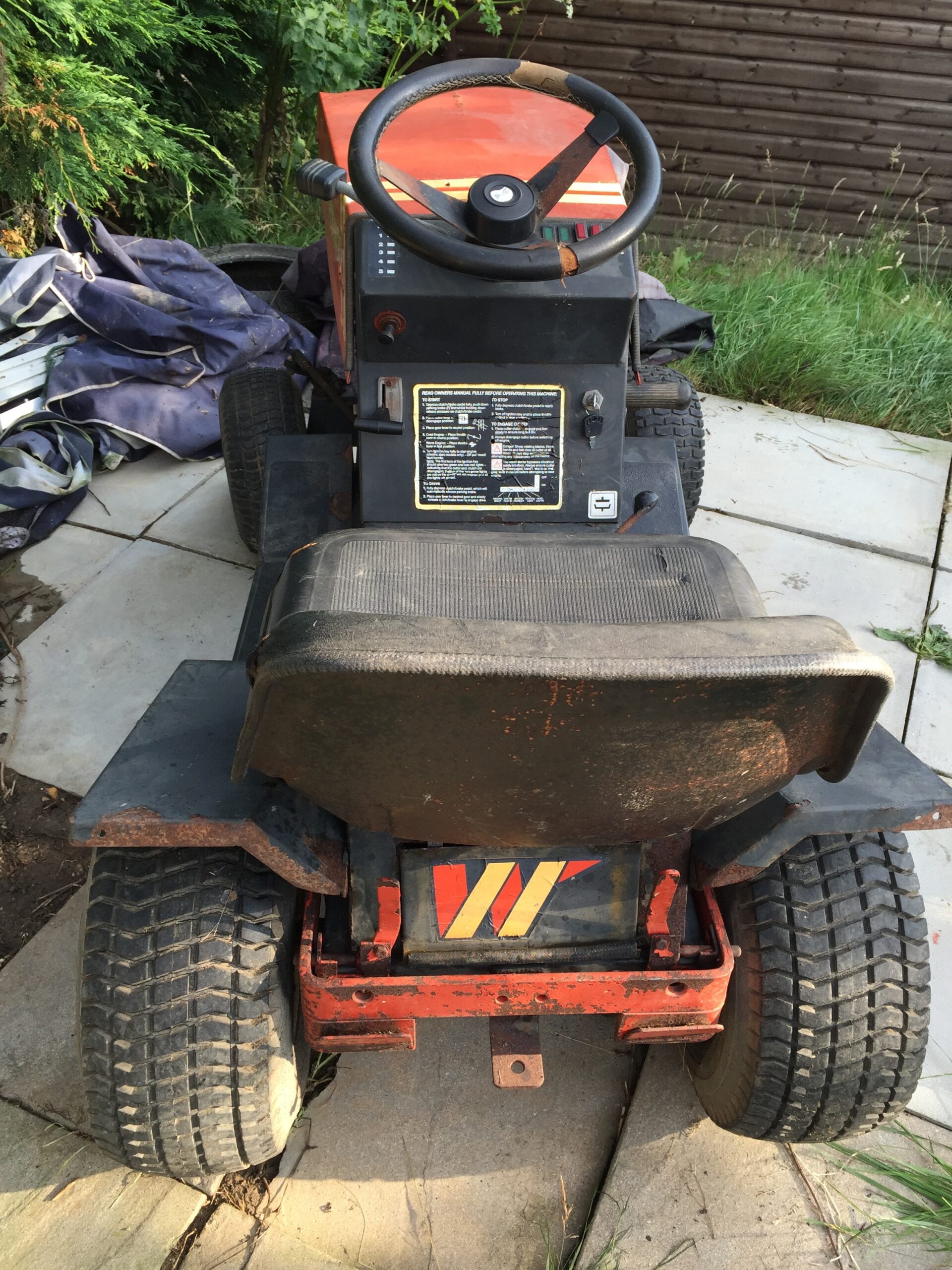

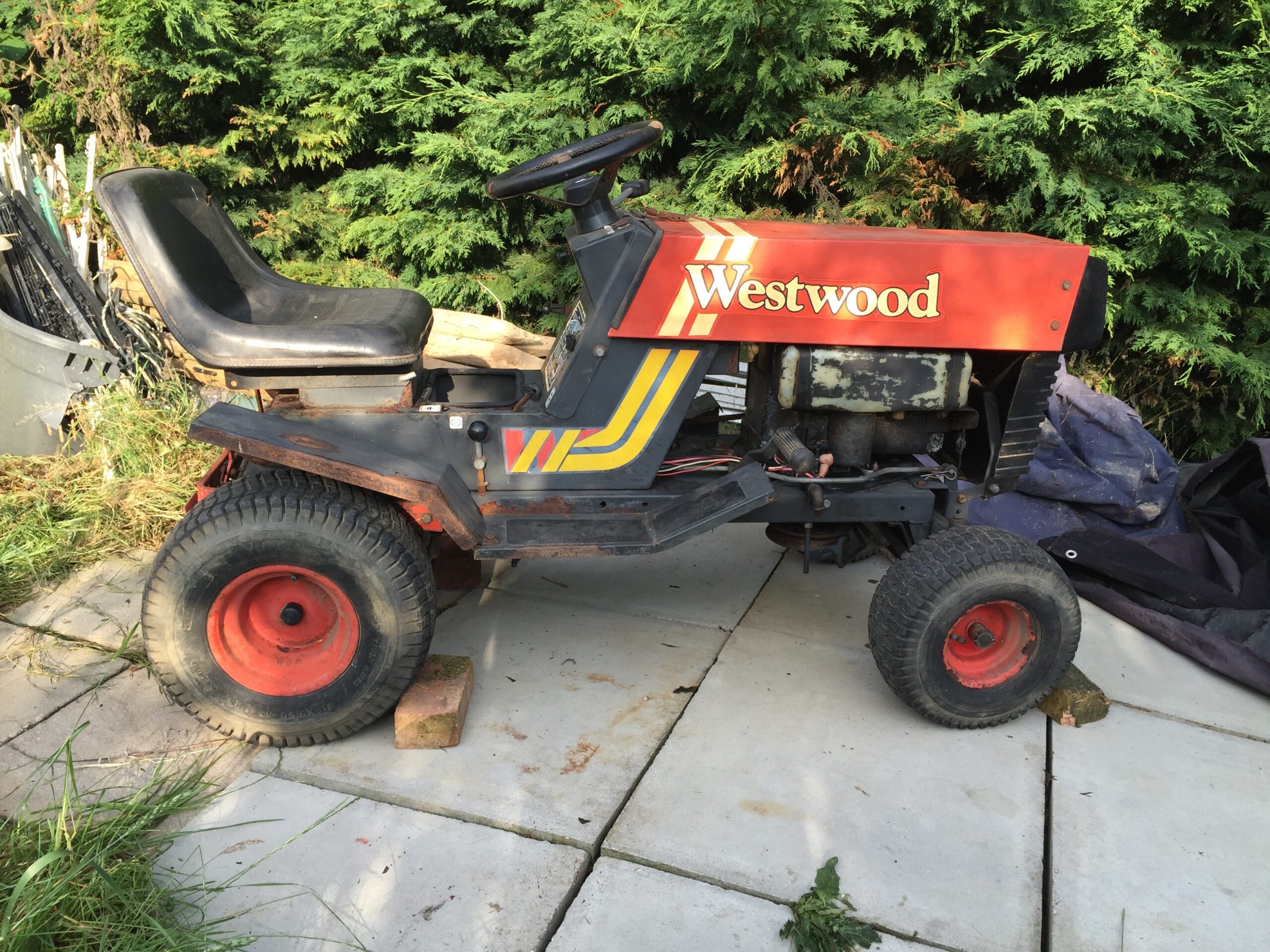

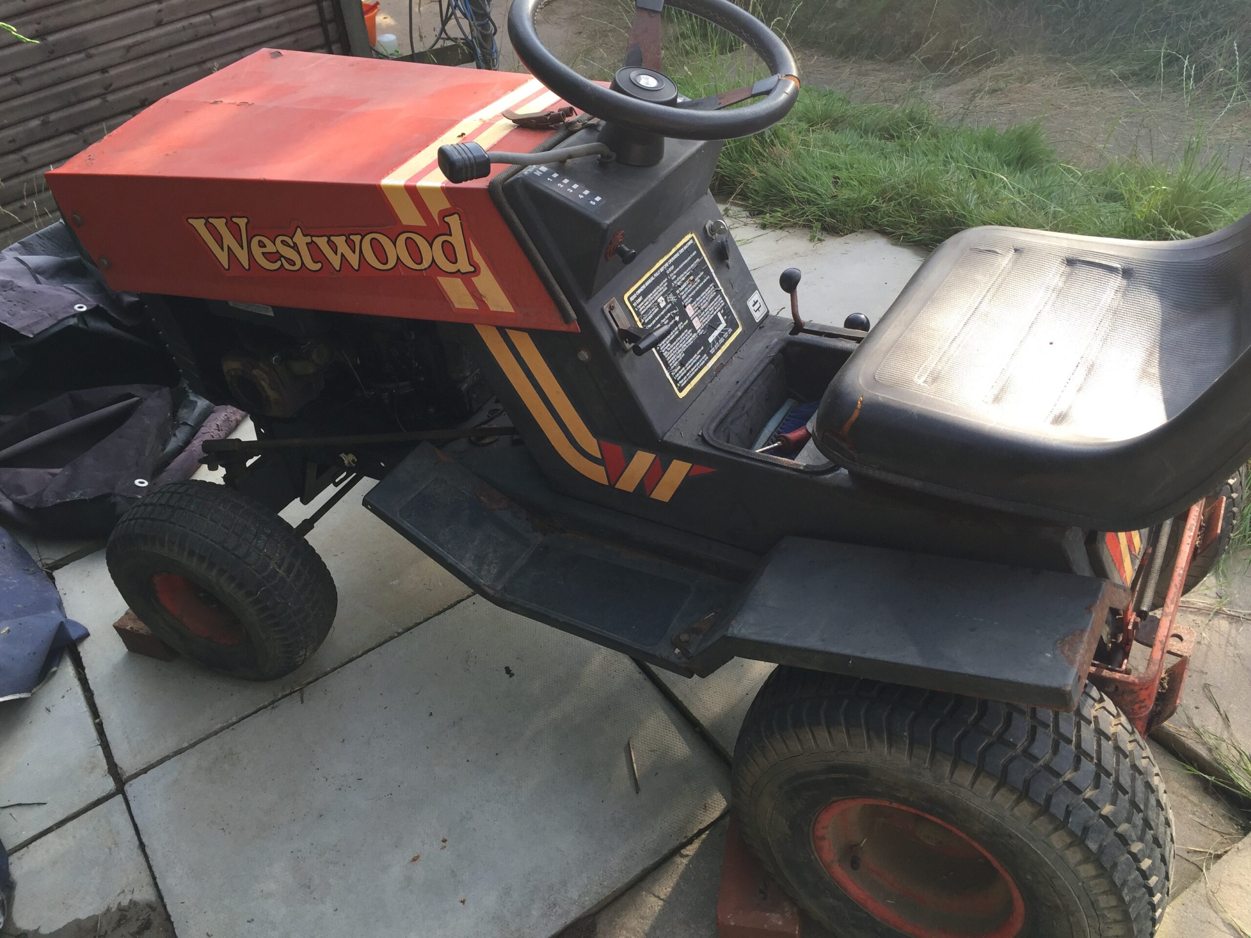

    Just got my hands on the following and want to start a restoration job.
    Can one of the members please help me identify the following Westwood ride on.Unfortunately most of the Model Identifying stickers have fallen off over time
    I believe it to be a Westwood Gazelle W11? (steering wheel – don’t know if its original says Gazelle) or a S1100, but as this has been ” maintained by robbing parts from others” it could be anything.I s the power take off flap at the back unique? The engine is a B&S 11HP 400cc, Model 253707,Type 0168 01, Code 84081411. Hood and side stickers look original
    Lastly could anybody recommend a good sand blaster/ powder coater in Kent, UK. for body parts and wheels

    Hello,
    That looks a good project to be doing, I once rebuilt a Westwood many years back. Most parts should be easily available. Tyres are standard size and available online, I think I have seen Westwood stickers for sale online as well.
    I’ve done a bit of searching and had a look through the Westwood brochures that I have and think that your machine might be a W11 as you suggest but decals do hint at a T series.
    The steering wheel looks original – they can be a devil to remove. I also recall that rear wheel hubs are hard to remove too once they’ve siezed on!
    Engine dates it to 1984, from the info I have Westwood appear to have started manufacturing this style of tractor in the early 1980’s.

    Really appreciate the assistance, now i can start part hunting. Latest updates…
    Got the engine to run today and discovered after an engine flush that the crank shaft oil seal (£3.50) is leaking like crazy.. so a complete engine removal and replacement (4 hours work). I’ve disassembled and reassembled the brake today also.
    There are few places in North Kent that do Soda Blasting, I’ll let you know how things turn out.
    Planning on using Bonda antirust primer paint-on and then High fill Anti rust primer on top with a Black satin colour coat. Recon this will will be my cheaper alternative to powder coat of the arches (which will run me about £150), for the same process except powder coat vs black paint. After all she (Kids christened her “mini mo”) is nothing to enter any competitions.

    Made further progress today in ID’ing the ride on mower, recon i have a T1200 chassis with a swapped out motor. Reason being is its the only 1983/1984 part list that has the forward raking deck adjuster on the front.
