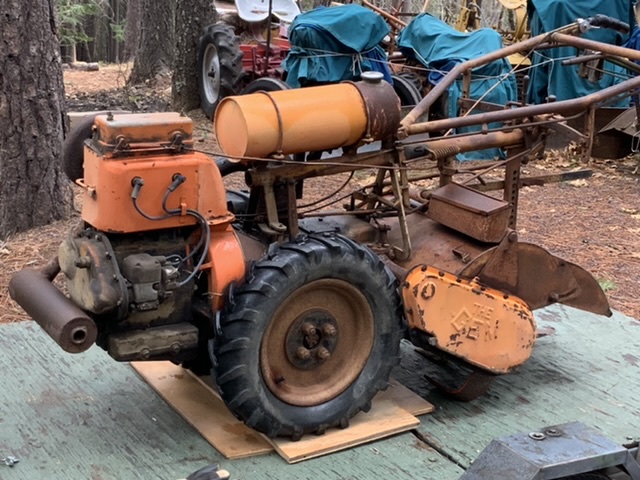

    Hello from California-
    Where I recently found this 1951 Rotavator with a Howard 360 engine. From my research, the rotavator serial G20524 makes this a 1951 model. However, from what I’ve read it seems the 360 engine was not produced until the 1960s at some point. So, is it safe to say that this engine could not have been a factory installed unit, but must have been fitted later? Or, were 360 engines in production as early as 1951?
    Thanks
    Jeff G

    earliest references I have for the Howard Inline Twin engine is 1951,
    first in ‘The Engineer’
    “This engine has been built by Rotary Hoes, Ltd.”
    [The Engineer. (England) Dec 14, 1951 p763]
    next it is reported in the Howard mag:
    “The new Series IV Model ‘Gem’, shown by Rotary Hoes for the first time at the 1951 Smithfield Show, offers
    growers greater power and wider cultivation.
    Although new to the home market, limited supplies of this model were sent during 1951 to Greece and
    South Africa. … … The ‘Gem’ IV is powered by an engine of Rotary Hoes’ own design which develops
    9.8 b.h.p. at 2,000 r.p.m. the maximum governed speed. The engine is an air-cooled twin-cylinder 4-stroke
    with 3in. bore and 3 1⁄2 in. stroke and a capacity of 810 c.c.”
    [Rotavator Pictorial, March 1952]
    sorry i cant find this issue in my scanned docs, (another gunna-do job) it is the first one, i also have the second, then a big gap up to 1956. anybody have any more they can share?
    my first reference to the 360 version is 1960, as per Brian Bells book, does anybody have Howard docs for earlier date? so yes your 1951 Gem has a later replacement engine, anybodies guess what motor it had originally, the Gem was available as both Series III and Series IV for several years. as well as the standard JAP 600 single, in the USA they also had Wisconsin singles and twins.
