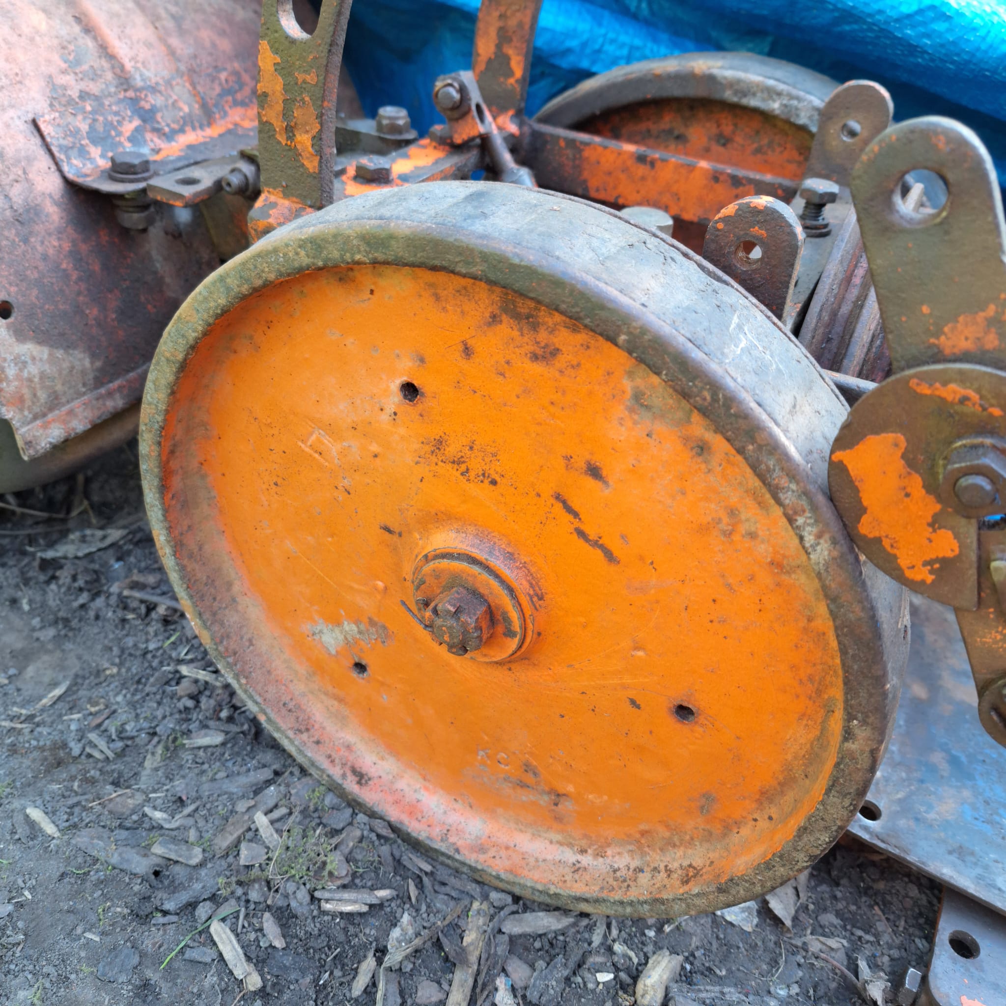

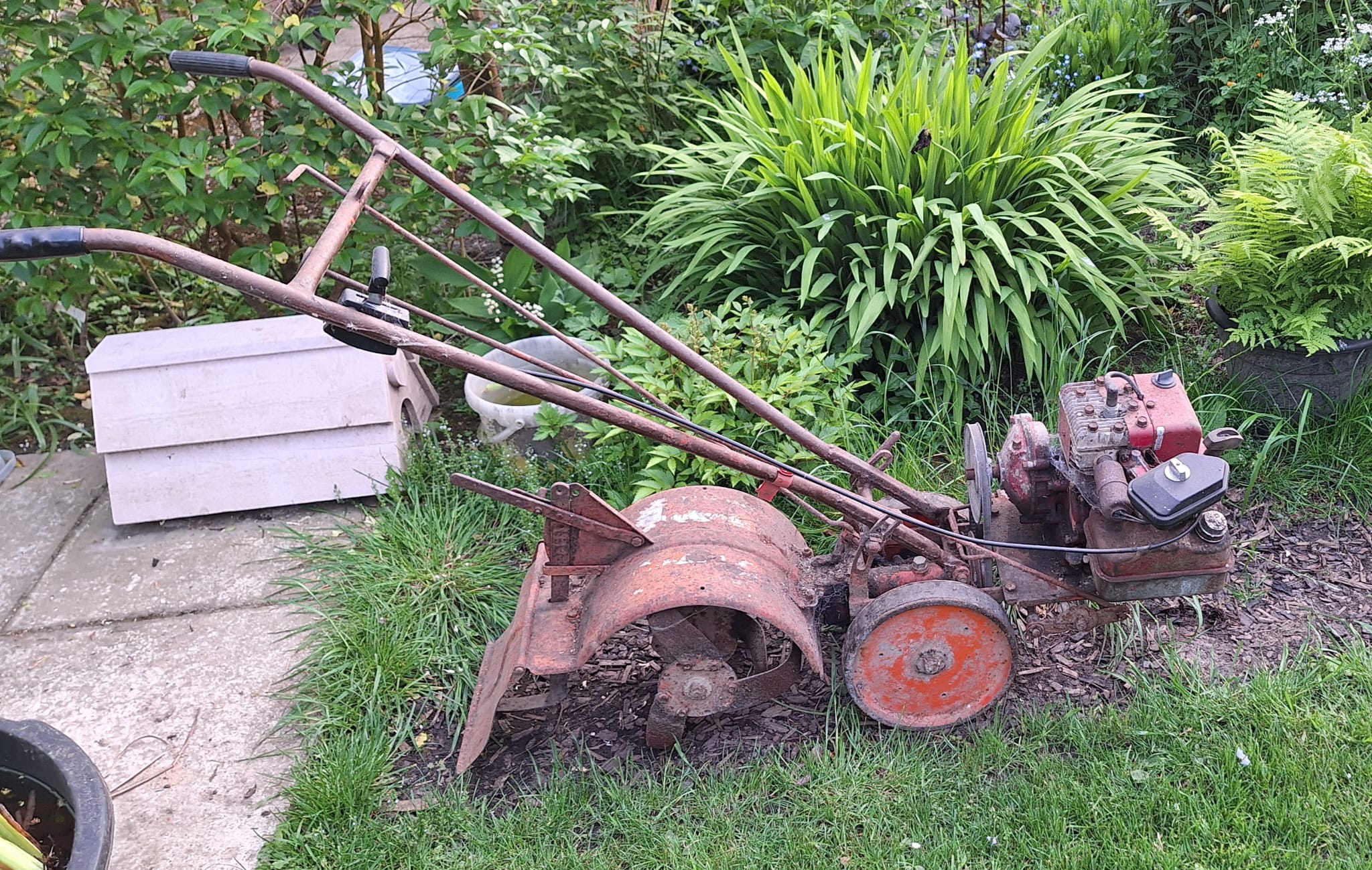

ParticipantHi All,
I’ve been given an old Howard 200 with a Briggs and Stratton 3hp engine.
I’m working on getting the engine running at the moment. The rotavator itself is a little rusty here and there but overall looks in OK shape.
The tyres seem to be worn completely flat though, I wondered if anyone can advise on where I can find replacements and if there’s a knack to replacing them?

May 13, 2025 at 7:08 am #43733andyfrost
ParticipantI run and use a couple of 200s , they’re great little machines , albeit mine are the later version with the heavy duty chunkier tyres , yours is the early version , and tyres were a problem. My only suggestion is , as others have done is to glue heavy duty cambelt material to your existing wheels , original new ones are not available.
One thing I must point out , your engine is not really a suitable replacement for the original in that it has a reduction box fitted , and hence the gearing will be totally wrong.Andy.

May 19, 2025 at 1:15 pm #43741lurch
ParticipantThanks for the reply @andyfrost, would you know if it’s possible to swap the wheels out for later wheels?
If not, I think I’ll have to take a look at the cambelt approach. Thanks.

May 19, 2025 at 4:01 pm #43742andyfrost
ParticipantThe later type wheels will not fit , hence I suggested the cambelt approach, Those little Briggs engines are very reliable and easy to work on , first thing is sort the spark out , and move on to the carb , give it a thorough clean ,along with the tank, and most importantly fit a new GENUINE diaphragm. Any problems , then report back.

May 20, 2025 at 3:22 pm #43749andyfrost
ParticipantThat sounds like a good result , the new diaphragm should cure the issues you mention , above all , be sure to run it on E5 fuel , E10 will ruin the diaphragm in very little time.
The reduction box I mentioned on your engine “MAY” be OK , I see from the pics that it has a fairly large pulley on it , so depending on what the box ratio is it could well work…….the only way is to get it up and running and try.Andy.
