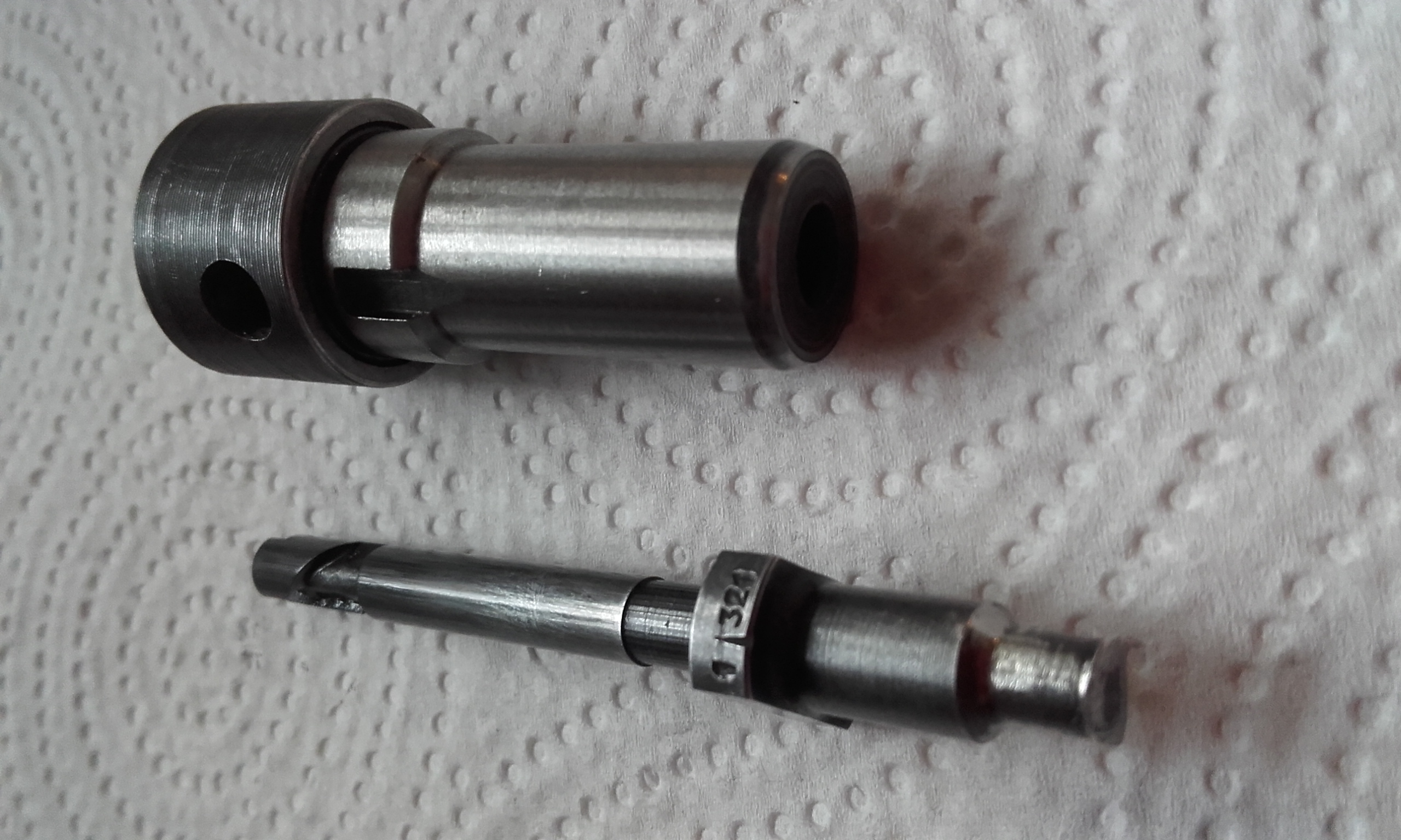

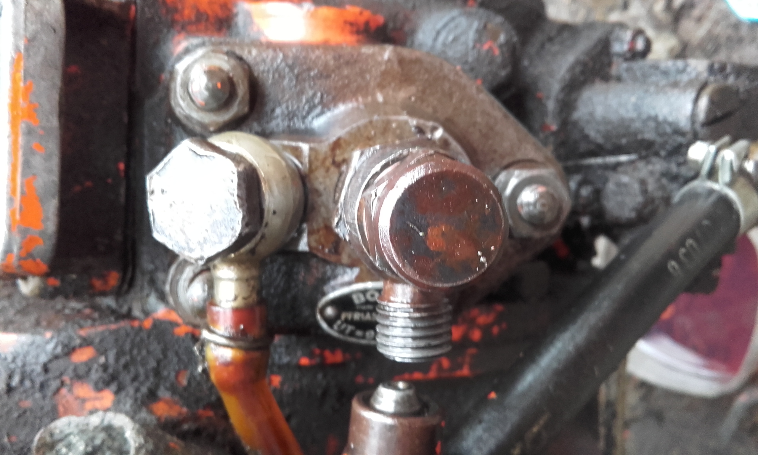

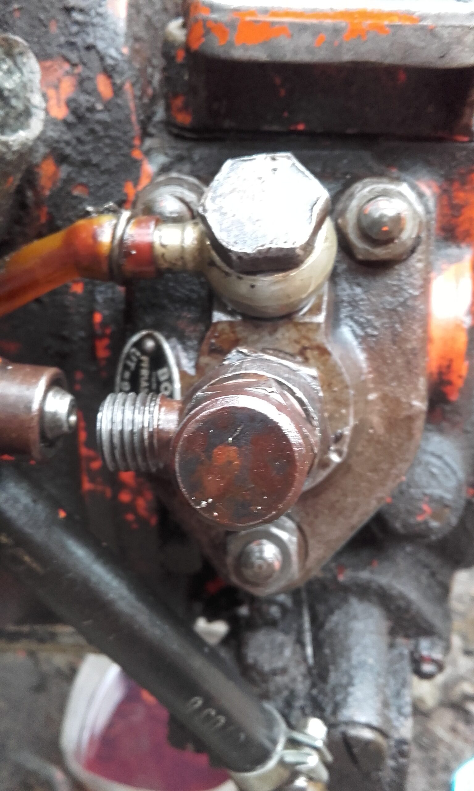

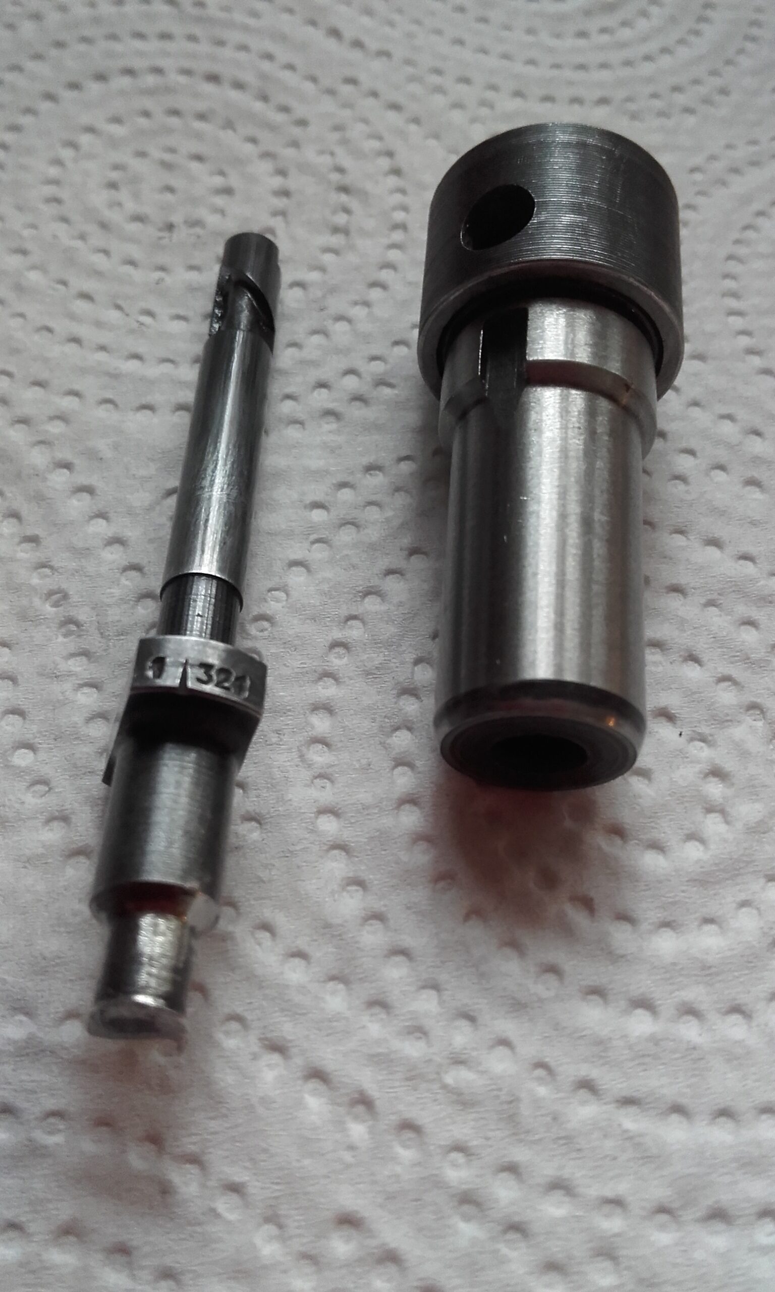

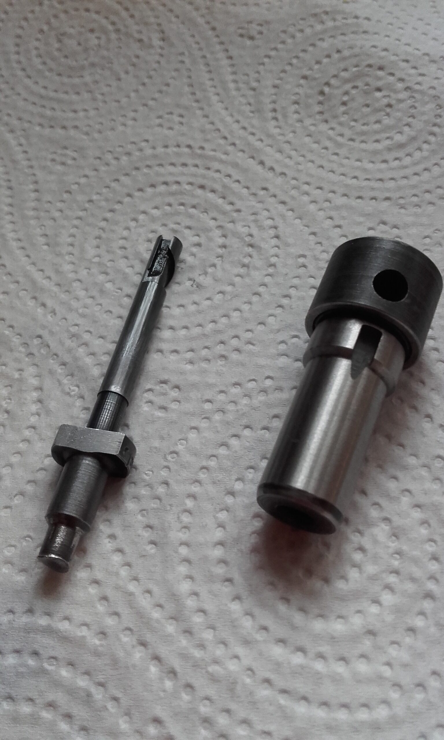

    I have a Gem with a Sachs 2 stroke Diesel Water cooled engine it is fitted with a BOSCH PFR type Diesel pump, when I last posted about this a fantastic member actually had a spare pump and agreed to sell it to me, to cut a long story short the pump did not get to me and so I am still searching. I have since taken my pump apart and have found that the PUMP ELEMENT is broken the very bottom tip has detached, I have measured the Element and the size is; Diameter of Element is 5mm, Length is 62mm, The sleeve it fits in is at the top widest part 17.5mm Diameter, Length is 42mm, and at the narrowest part is 12mm Diameter. I have included a couple of pics to show more what I need. Any help would be very welcome thank you.
