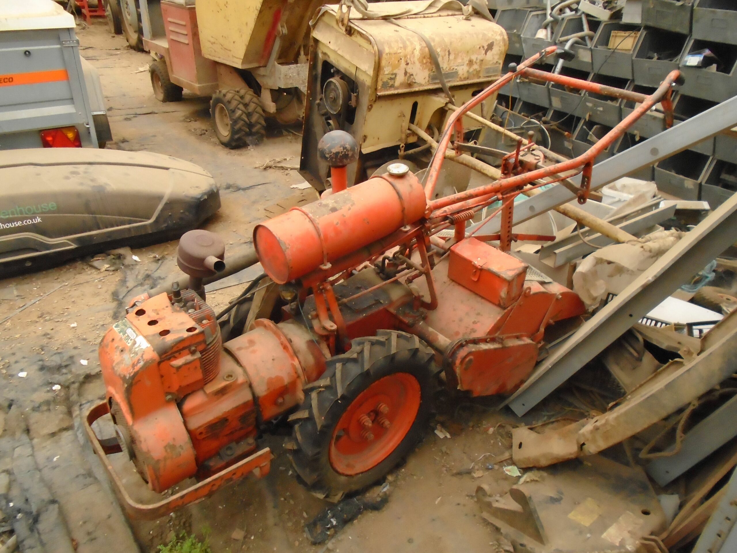

Have got a Zenith 24T2 carb with an adjustable jet on the Jap 5 on my Trusty. Replaced the original Jap carb with the Zenith and it was that that I made up the new linkage for. The Zenith was removed from a Trusty that was left outside for decades. Put a service kit on it from Villiersparts, that included a new throttle spindle. The old one had a big flat on the linkage side, so air could be sucked into the carb. The new spindle then made a huge difference at tickover and throttle pickup, which is so important on a Trusty. But sometimes it will start by the third swing of the starting handle, others not even after twenty on full choke. It appears it is not getting enough fuel to start it from the main jet to the orifice in the ventri, with the chamber not being clean and smooth, preventing the petrol from being sucked through it with a single swing of the handle. Luckily a Trusty can be started with a strap, so I can get it to go. But re-built it last year, so it has full compression, getting a bit long in the tooth to keep having to turn in over with the strap. When I find someone with an ultrasonic cleaner, will take both the Walbro and Zenith carbs for a clean.
Have attached the pictures. One way or another I know I can get the fuel system sorted out quite easily. Have a feeling it may be the petrol tap only delivering a fast drip, in turn making the original diaphragm on the fuel pump let air bypass it, delivering frothy petrol to the carb. That could be the real cause of the problem. But having the carb ultrasonicaly cleaned will not hurt either. Will be very interested to see the results to both carbs. Have you ever taken a clutch apart and if so, what did you find.

ParticipantHi Graham
From the latest photos, I would say that the wheels are on the wrong sides as the “V’s” on the treads should be facing forwards not backwards.Regards

sidevalve5ParticipantHi John,
The tread direction was what was on the machine when I collect it. The tyres have been fitted, but have never touched soil. They were deflated and the righthand one ‘set’ over towards the gearbox. When pumped up there was a bump on the inner wall, so it rubbed against the gearbox. It was a devil to move the machine. When I got it back I deflated the tyre, pulled the area of the distortion back, held it there and put some wind in. It wetn pop, so I need a new inner tube.
Have always understood that rotovator tyre tread direction is reversed to that of a tractor to prevent the machine being pushed forwards quicker than it should be by the action of the rotors. Be interested to hear what the general opinion is.

May 3, 2024 at 3:15 pm #42195
charlieKeymasterRe tread direction, I have always thought the same as Graeme, V forward for traction, V backward to reduce tendency of rotavator to push machine forwards.
May 4, 2024 at 10:51 am #42197

May 21, 2024 at 6:57 pm #42288kevm
ParticipantTyres should be pointing forward same as a tractor, if you hit a big stone the rotor will jump up but it won’t push the machine forward – it’s too heavy.
