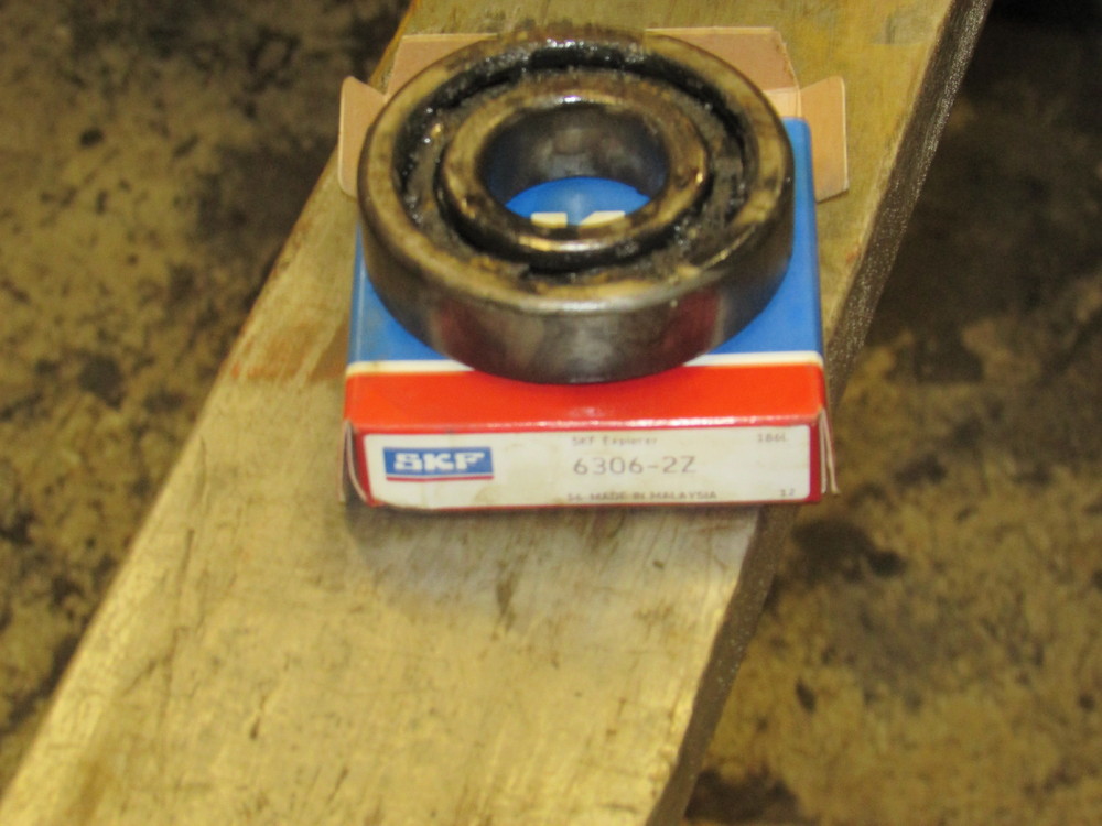

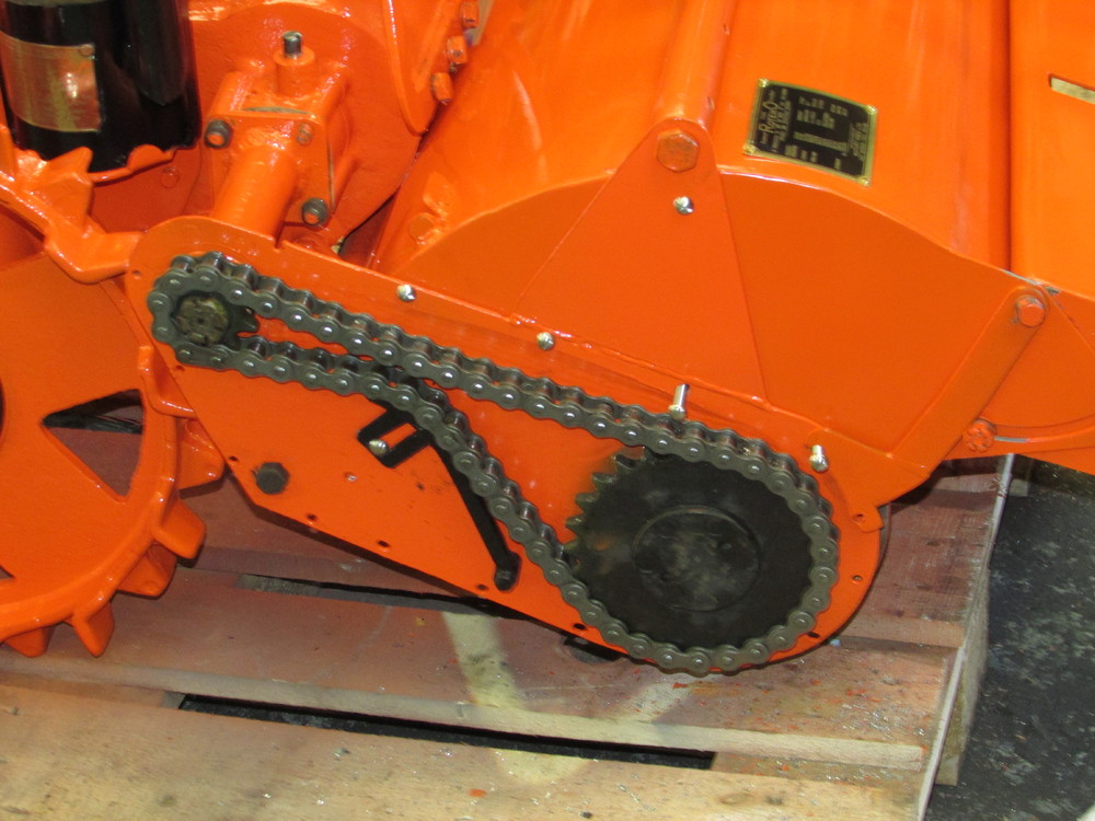

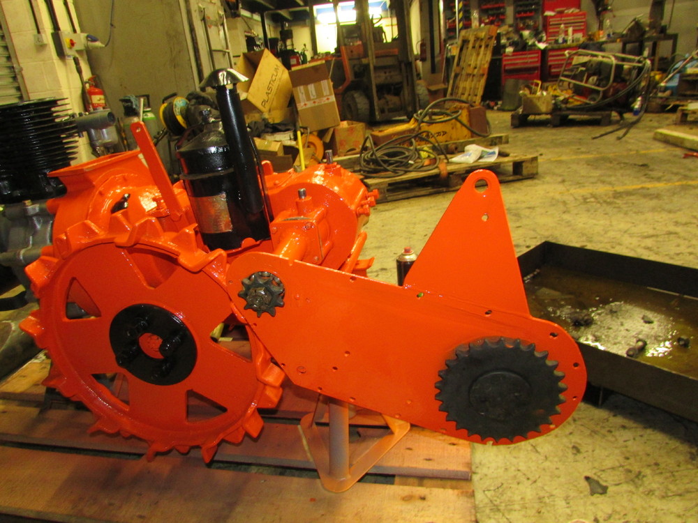

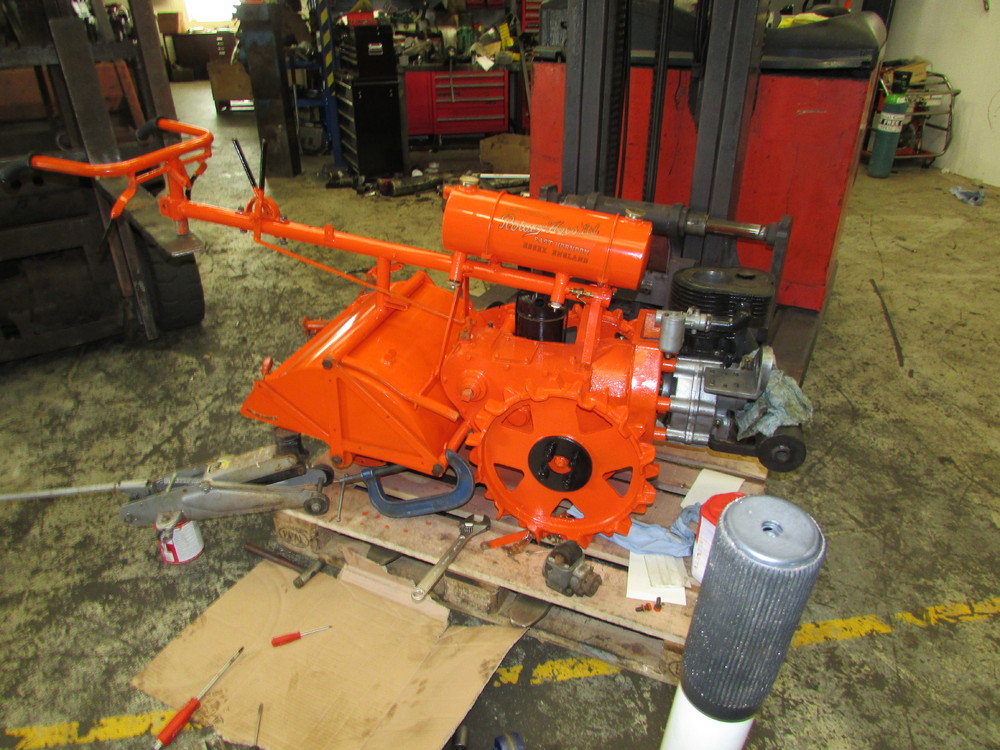

    I trial fitted the rotor chain backing plate to make sure everything still lined up. Then set about changing the bearings. The bottom one took over 2 hours to extract with a lot of banging and swearing! Even our 75 tonne press wouldn’t touch it, however it was a common metric one so pleasantly cost only a few pounds.

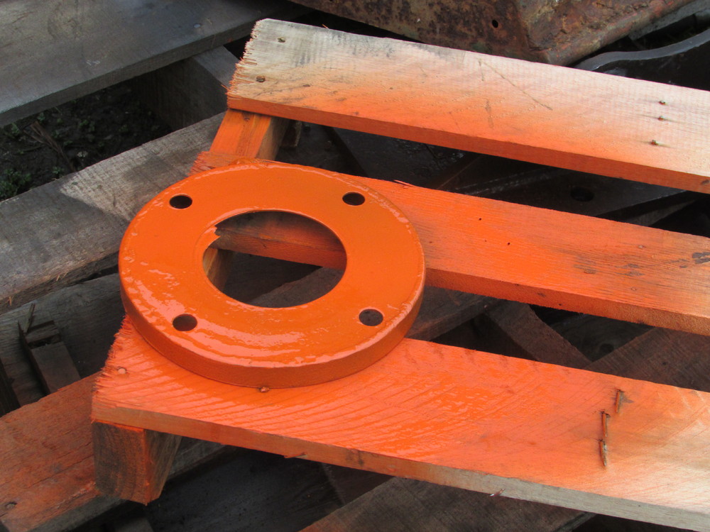

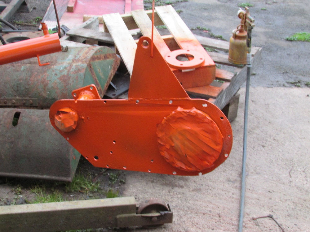

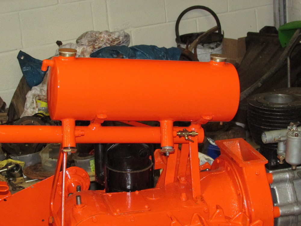

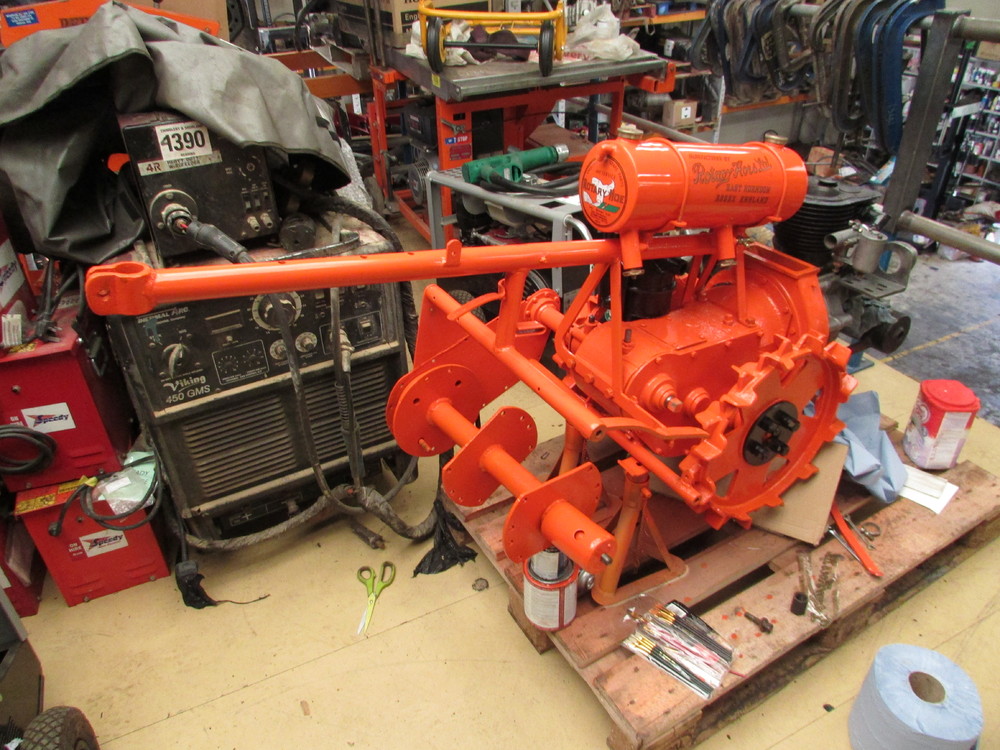

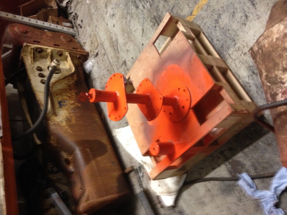

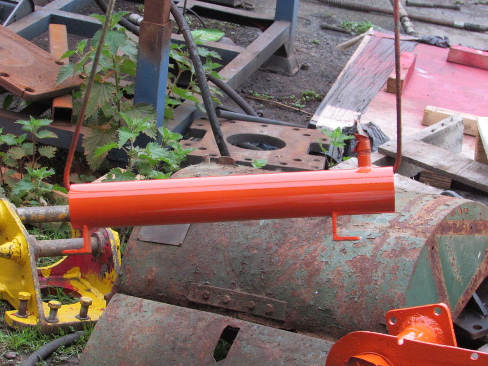

    After painting the oil filter housing and rotor shaft clutch plate,the handles and tank were dry enough to refit.
    #21714

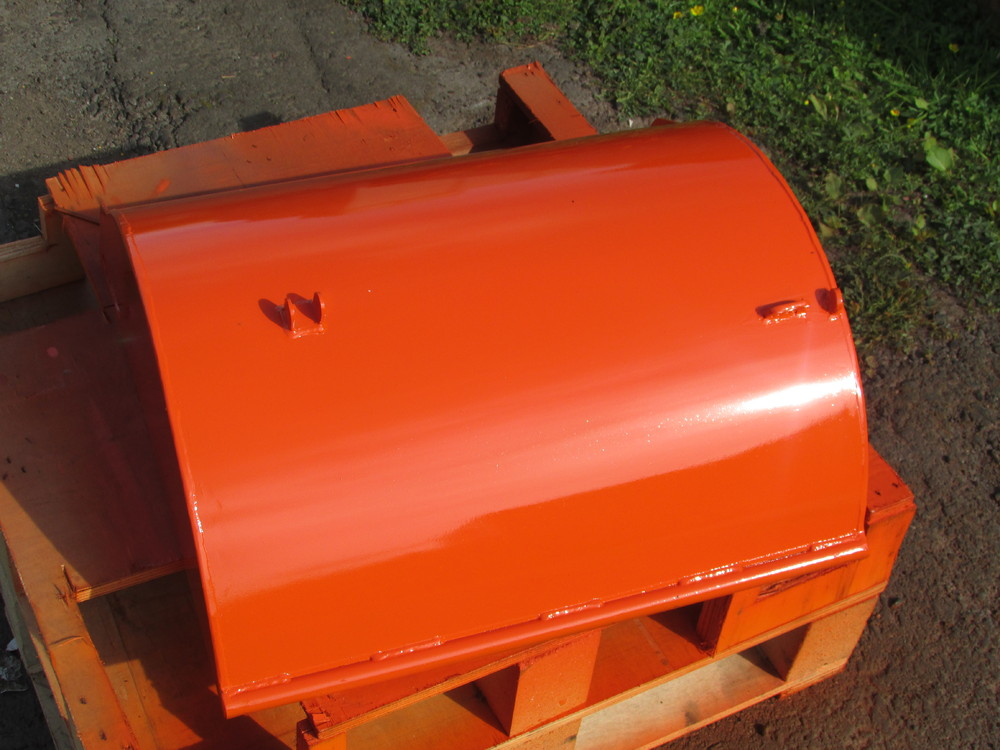

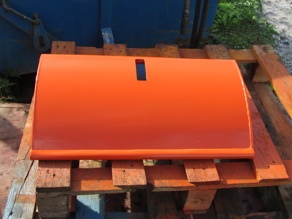

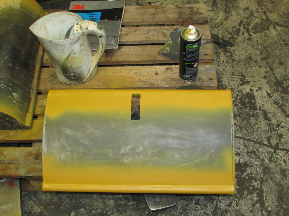

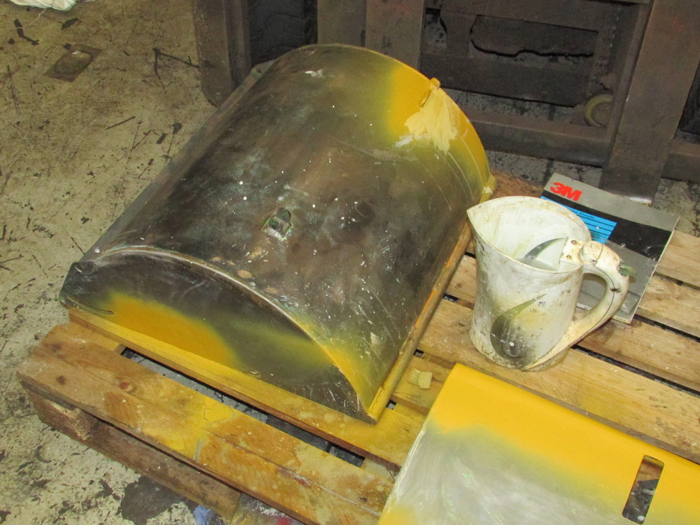

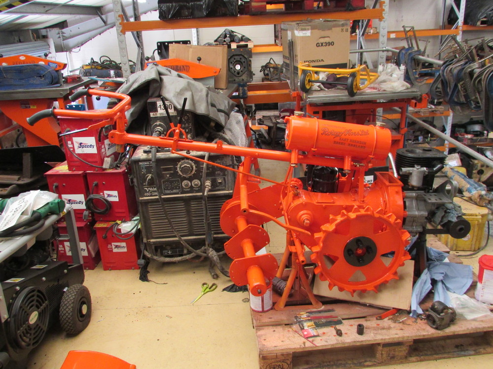

    Several years ago I purchased a new set of rotor covers off standen engineering. The price was quite eye watering, however because the covers on this machine were definatley past it, I decided to use them on it. They needed a lot of modifying to match the older type with metal being let in, seems welded up etc then smoothed off with filler.
    #21725

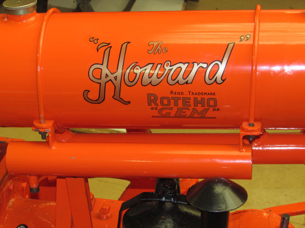

    I then recieved a very nice package in the post off Titch from Machinery Decals. They really lift the appearance of the gem.

    Several years ago I managed to buy a batch of N.O.S oil filters for gems so one was duly fitted.
    #21733

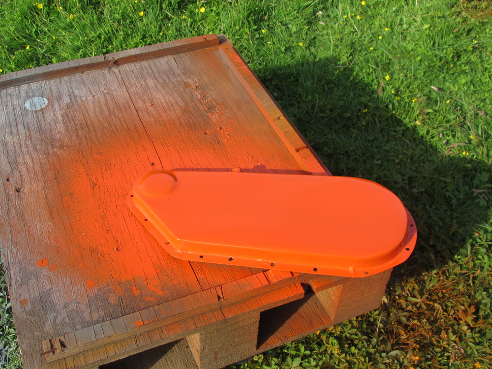

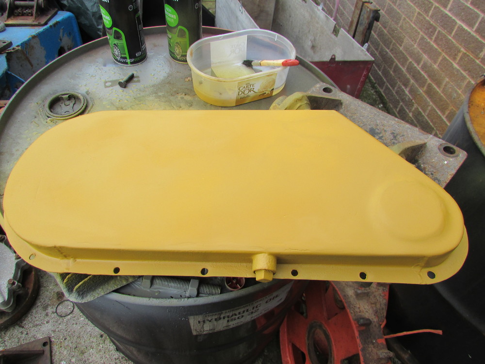

    One of the items missing from this gem was the chain cover, early ones were plain with no adjuster cut out. They are like hens teeth, however I luckily had one in my store but it was quite battered and corroded. It took about a weeks worth of work to straighten.
    #21735

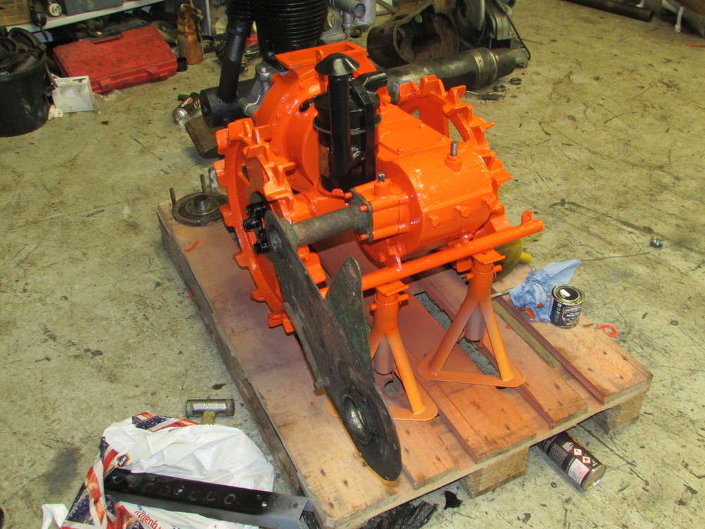

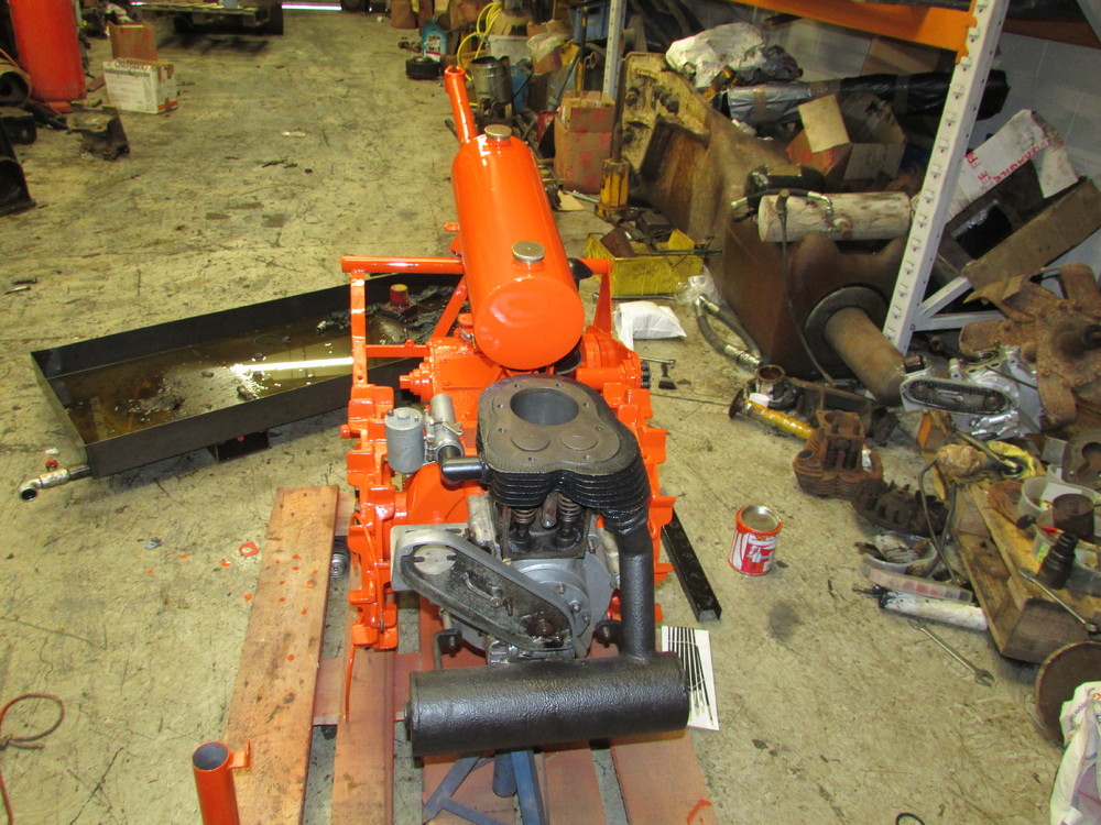

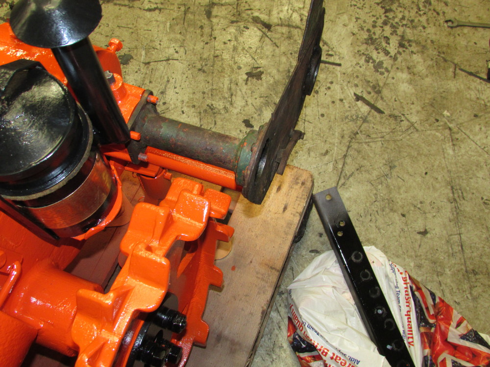

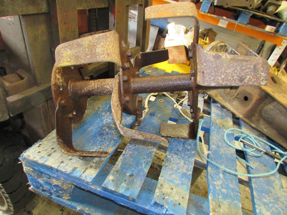

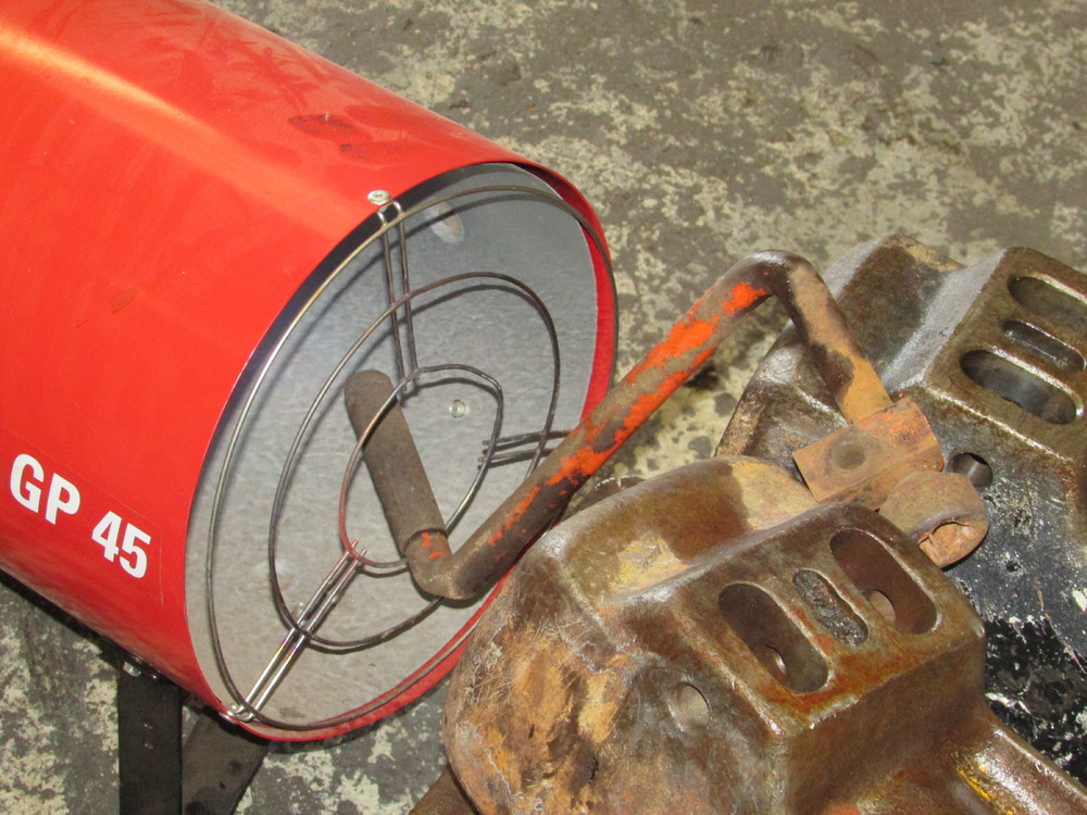

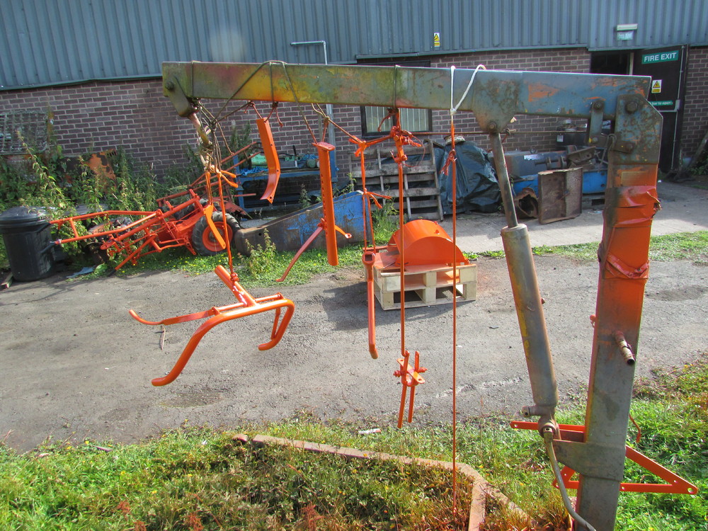

    The starting handle rotating sleeve was sized as usual so this was got very hot. After prepping a few items I then sprayed most the loose parts. I also gave the rotor covers a rub down and another blow over as I wasn’t happy with the finish I’d got before.
    #21742

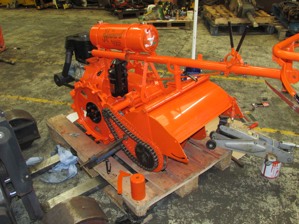

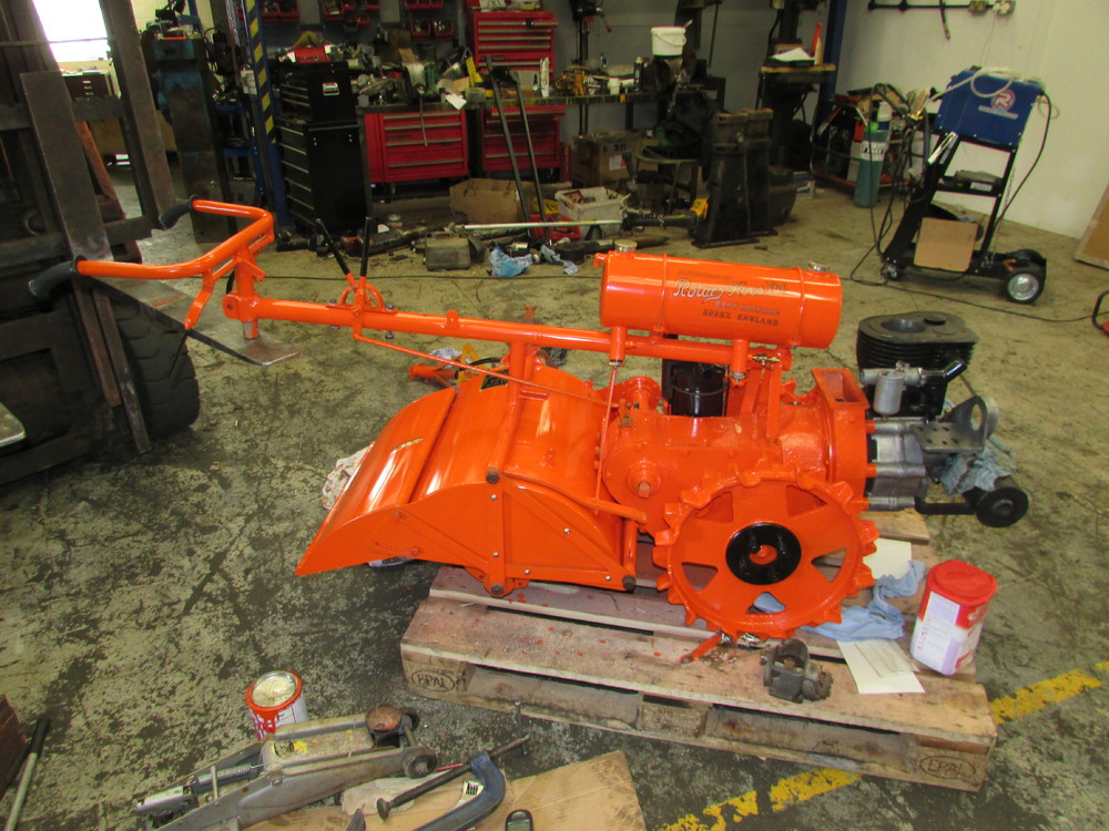

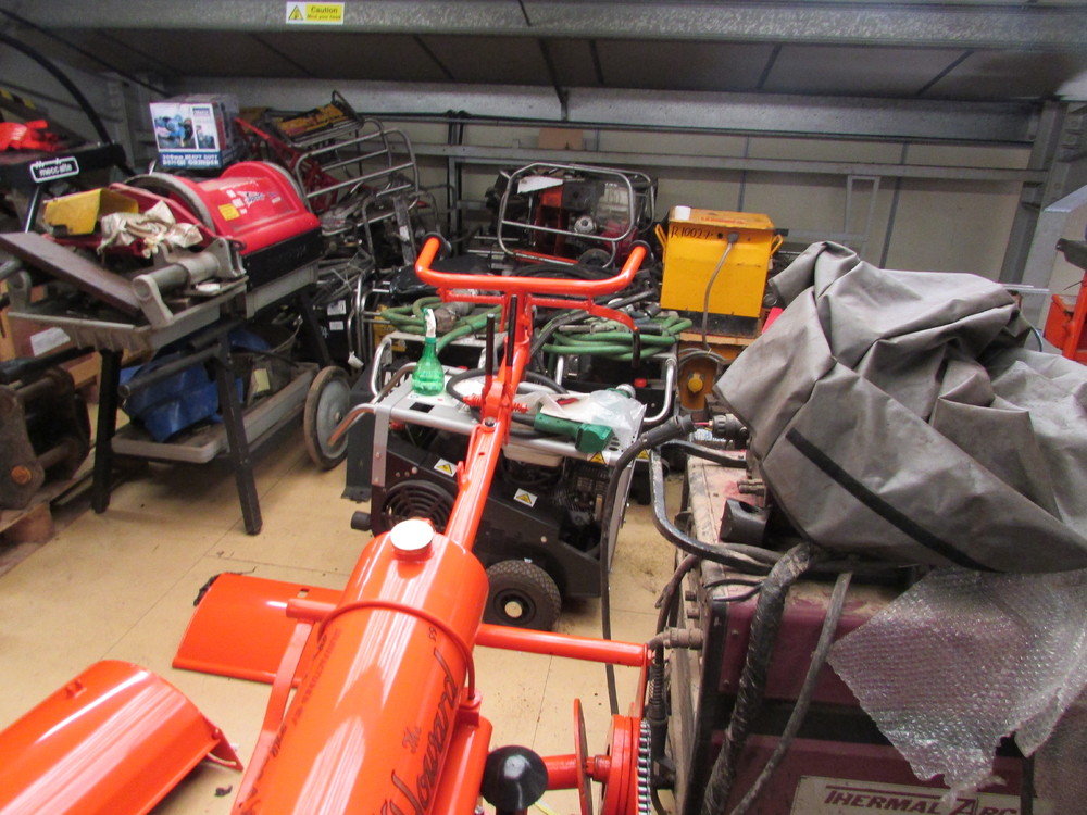

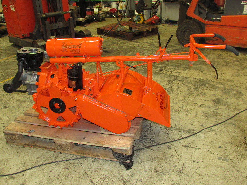

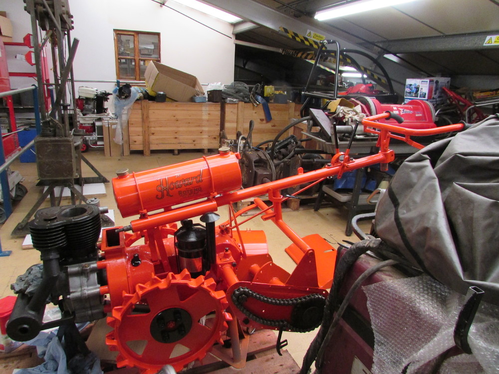

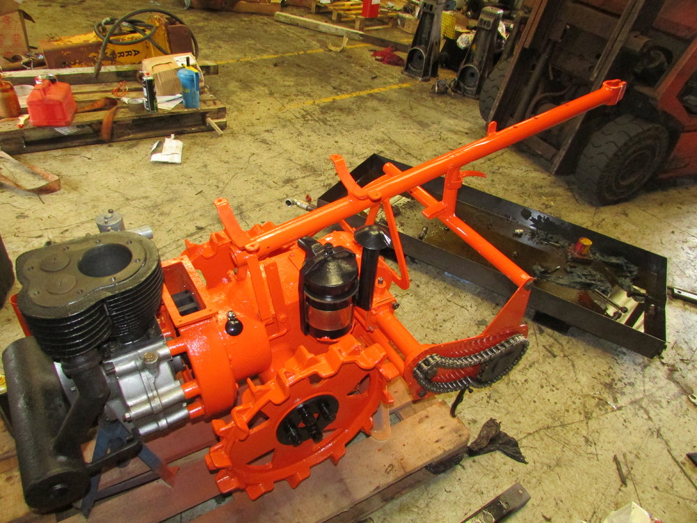

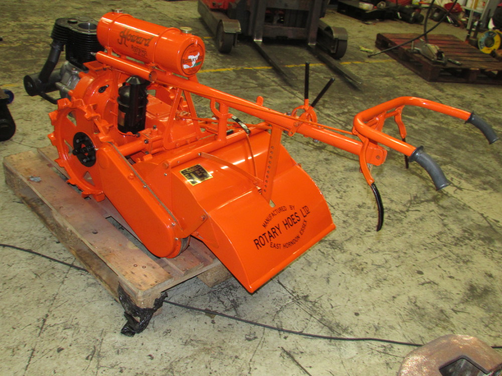

    After the paint had set for a few days I started to build the old girl back up. After connecting up the handles and gear rods I’m pleased to report that all gears seem to select properly. I also highlighted some black bits and fitted the closest match I could find to the original grips.
    #21747

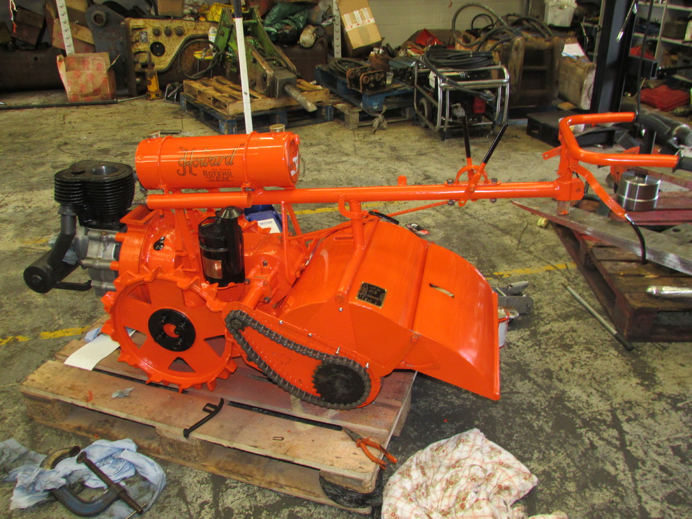

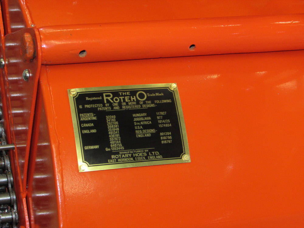

    It took about 3 hours to get the rear rotor covers to line up. Some of this was caused by poor manufacturing process which is a little disappointing considering how much they cost and some of it was caused by trying to fit them to a machine they weren’t designed to fit. I also fitted a new decal and a new brass plate that I’d had made.
