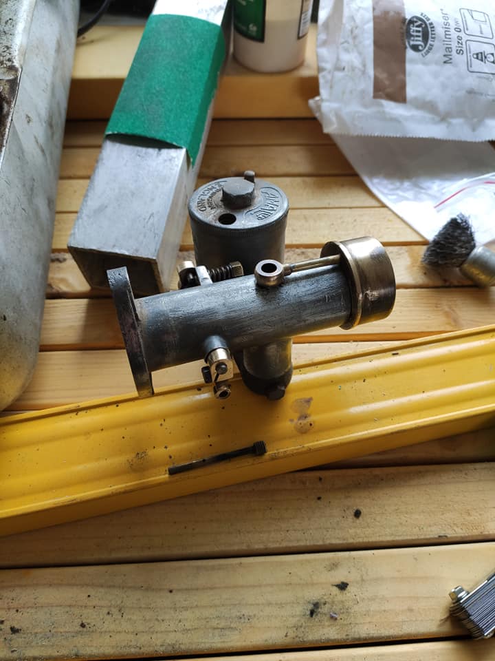

    #34067
    Hi I’ve been searching for parts for my carb I believe 226/016 and have came up with nothing, ive had to clean up the carb best I can and find washers and make gaskets to fit. I’m waiting on some Solid silicone ‘Tube’ the correct diameter for the needle gland and I’ll drill a hole through the centre to suit.
