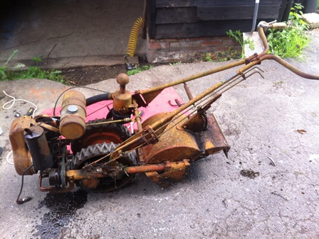

    Hi all. Just acquired a Bantam which I think has a Villiers 25C on it.
    I’ve discovered your lovely site as a result – it doesn’t run of course 🙂
    So far, I’ve discovered no spark, and the piston rings are no good.
    So 2 questions I hope you may be able to help with:
    1, how do I ensure I’ve got the right engine. Theres no numbers I can see
    2, where can I get new rings
    3, how do I get the flywheel off to gain access to the magneto – the head of the bolt in the started pulley is knackered. Is this left or right handed?

    Also, isn’t the 25C a fours stroke motor?? Mine is a 2 stroke so I still need to confirm the motor type. I cannot see any identification numbers on it.

    As above, I’m still not convinced I’ve correctly identified the engine type. Is the 25C a four stroke? Mines a 2.
    Can anyone tell from the original pic I posted?
    Cheers,
    Jim
    #7848
    Jim , yes it’s a 25C (twostroke).
