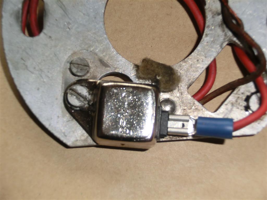

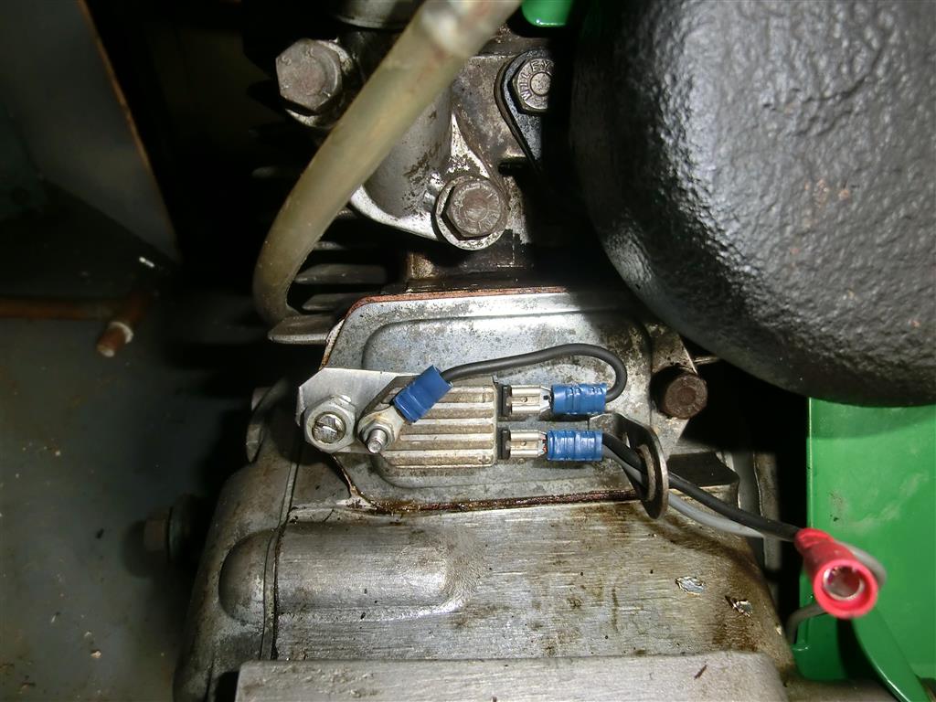

    There is a thing that looks a bit like the attached (from “my old machine”) bolted to the aluminium casting that fits behing the cast iron flywheel-blower-fan. Yes, I think it has got electronic ignition. This device has a vertical pattern on it, unlike the chevrons of the attached picture, but is otherwise similar.

    The ignition trigger unit that you illustrate is what is often marketed in the UK as a Nova, and it’s fine for your Kohler. I happen to prefer the Meco as it’s smaller and easier to hide within a flywheel magneto.
    Assuming that your Kohler’s coil has two small diameter wires in addition to the HT lead, one will usually be the low tension lead that normally runs across the back of the engine to the points and the other may be an earth/ground. If it only has one small diameter wire, it is the low tension wire which should be attached to one terminal of the trigger unit. I don’t think that it is polarity sensitive, so its other terminal is grounded. If it doesn’t work, swap them over. I have, in the past, found that the insulation on the low tension wire cracked, and shorted out where it runs across the back of the block under its securing clip.
    The trigger unit replaces both the points and the condenser, so there should be just one low tension wire from the coil to the unit – unless there is also a handle-bar mounted kill switch, which will have a connection to the low tension / module wire and a ground. If your machine has a kill switch, I would check all its wiring for shorts to ground / earth – or disconnect it – remembering that you will need to short the plug out to stop it!!

    I took a picture of the electronic ignition module that’s fitted. It’s similar, as said before, to the chevroned article pictured above. I guess they all work the same way. I have ordered a replacement just in case for the princely sum of £12 (as I also have another ‘350″ which has points ignition). Could not find a “Meco”.
    The coil is as described above. Two LT connections, one earthed, one HT lead. The non-earthed LT wire goes through the pictured ignition module to earth. No kill switch. I will have to fit one, ‘cos it’s hard to stop the thing (when actually running) apart from by shorting the HT lead to earth.
