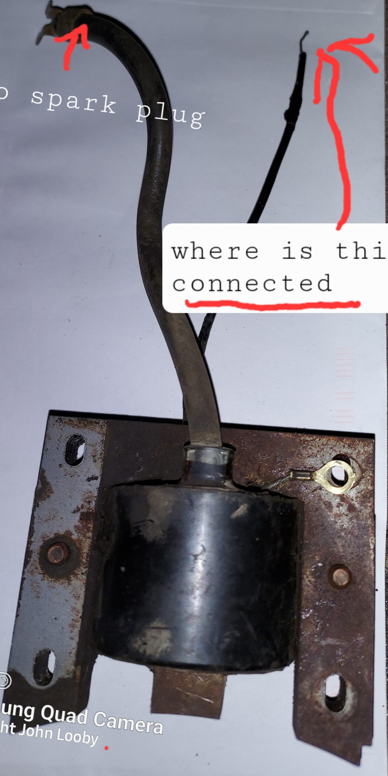

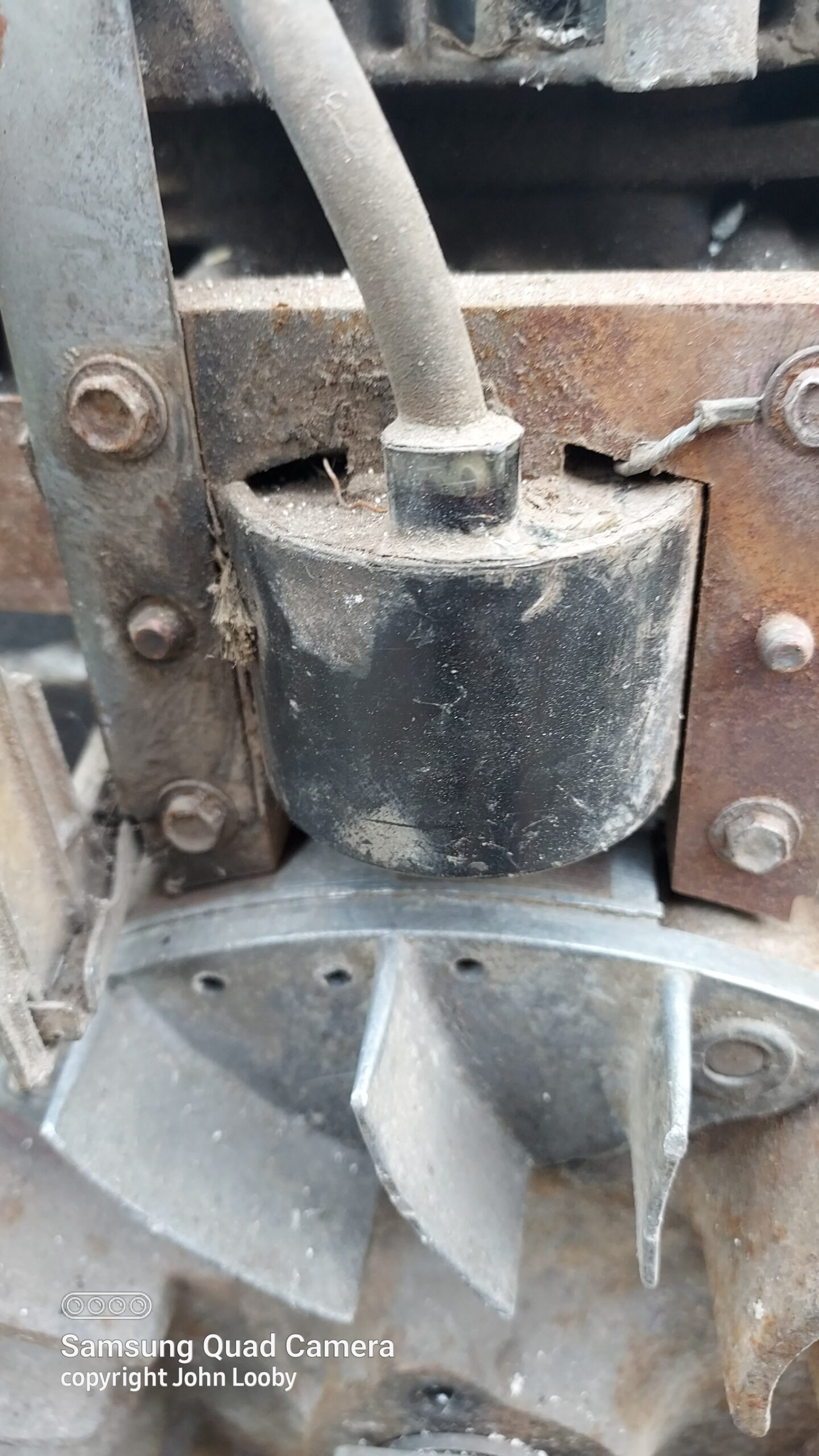

    aquila787
    Hi Andy
    I attach a couple of pictures of the magneto. I can’t seem to find it anywhere. The ones available have 2 legs whereas this one has 3.
    Do you mean ……just replace the coil.
    When I removed the magneto the thin wire came free very easily. Where should it be attached?
    Is there a wiring diagram available?
    #39346
    aquila787
    I’m guessing that wire should be connected to the engine body to form a circuit.
    Maybe that’s why I don’t have a spark if it was a bad connection or not even connected at all.
    John
    #39347
    The wire you’ve highlighted goes to the points ,(in this instance directly onto the end of the condenser) the other uninsulated wire is Earth. Try wiring it up correctly , make sure your points are clean and set , and see if you have a spark.
    A modern replacement magnetron coil should be available , which will eliminate the need for points and condenser.
