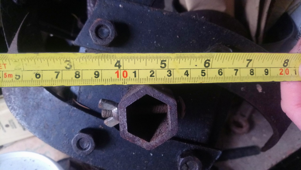

I have a set of wide drum rotors, a set of narrow drum rotors for a Honda 610, I think they would fit on your hex bar.March 9, 2021 at 6:15 pm #36751

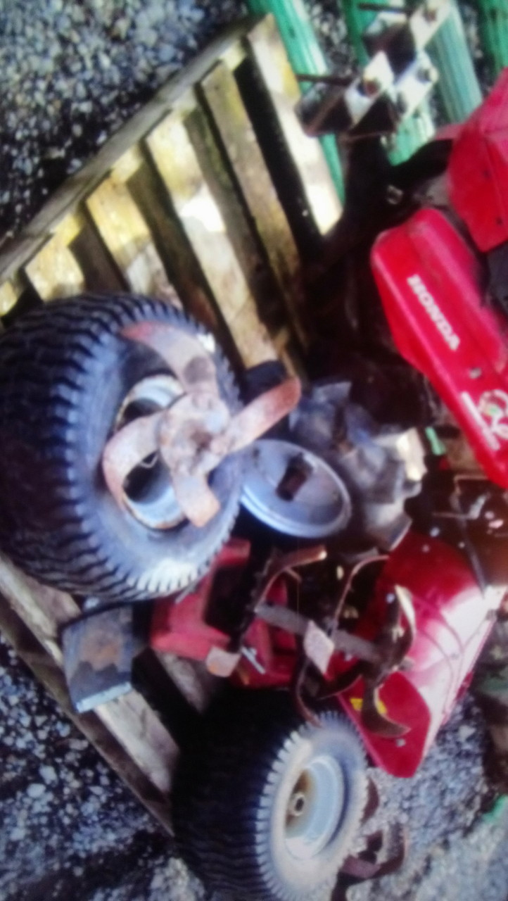

kmacaoidhParticipantThanks for reaching replying to my call for help and information Hortiman. I’m not sure if I have made it as clear as I could, what I’m really looking for? The rotor drums you mention are for rotavating I take it? I have a set of them. It’s more a set of wheels that would fit on that sane hex bar, as you call it, to drive the machine from place to place that I’m looking for? I’m also toying with the idea, that with the pneumatic wheels I could also pull some small tools on the toolbar? This might not work, but the wheels would definitely be a help going across ground from shed to garden/field. The truth is I don’t use it much for actual rotavating, so I’m trying to give it a new lease of life… and if not maybe move it on, as I have a small Goldoni walking tractor to do the rotavating. But all your thoughts a suggestions welcome. Thanks
March 9, 2021 at 8:47 pm #36752
hortimanParticipantIf you can’t find genuine Honda wheels, maybe Merrytiller ones could be modified to fit, they could be more plentiful.

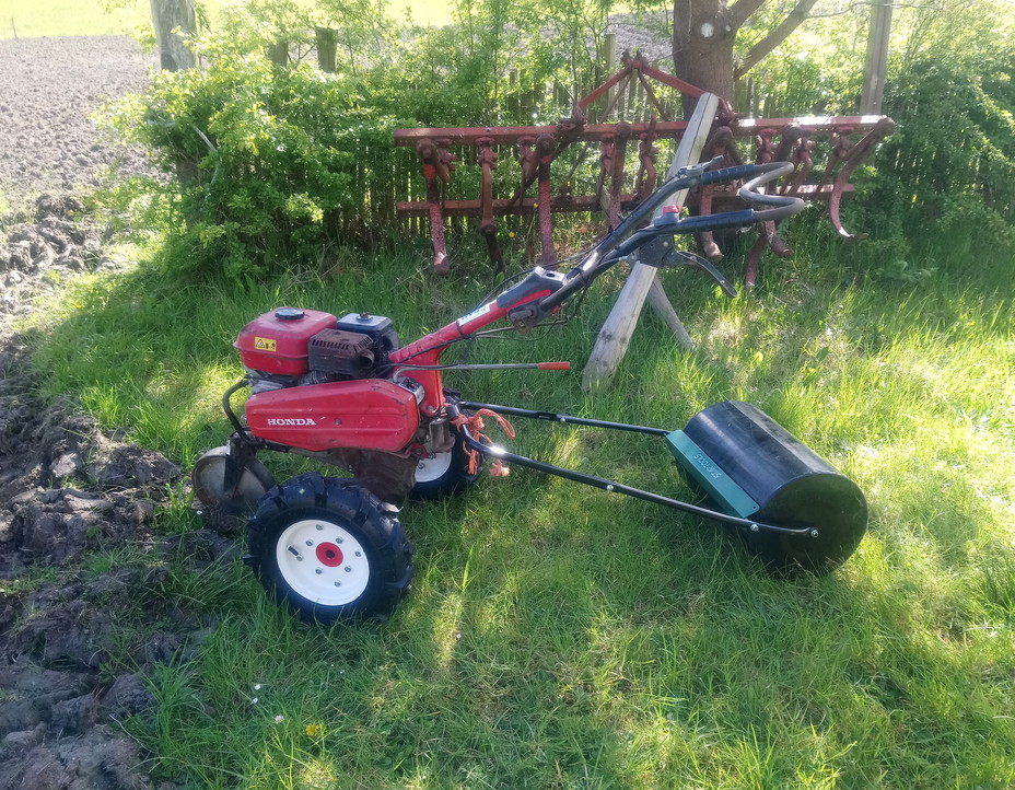

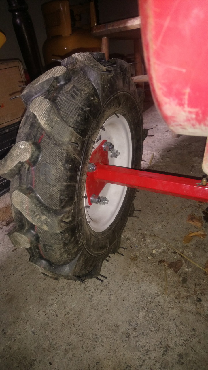

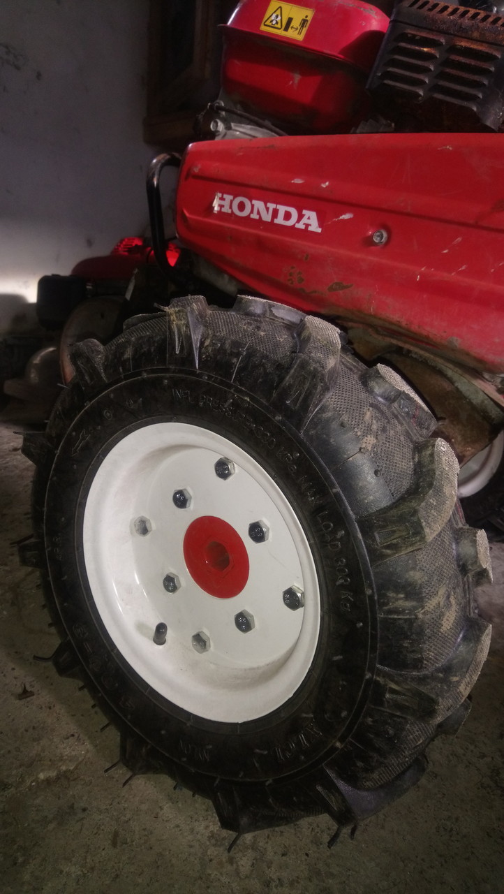

kmacaoidhParticipantIt took a while, but, finally got a set of wheels and hexagonal bar axles for my Honda rotavator. Got them from Spain! And all things considered they were as reasonably prices, including shipping, as common or garden wheelbarrow ones down the local hardware store!
I hadn’t been using this rotavator that much recently, a two wheel tractor version getting most of the work, but these wheels have given the Honda a new lease of life! Had it out today, with a small roller to roll in some oats I’d sown. A lot better than pulling/pushing, even a small roller like this!
So, being nice and light compared to other tractors the little Honda may be seeing a lot more service in the months and years ahead!?May 1, 2021 at 8:03 pm #37111

kmacaoidhParticipantAnd yes, the drawbar on the roller needs to be modified! But the weather was good and the job in hand needed to be done today. Even the smallest of maintenance jobs like that can scupper a full days work at times? Fixing it on the fly is the farming way. Not the right way. And if there were dangers attached, not the way at all.

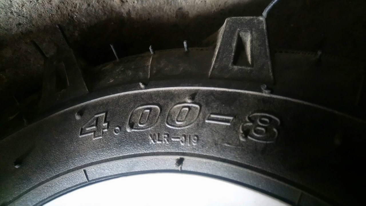

ParticipantI’m in the same position as you , I’m looking for a pair of wheels for a vintage Honda rotavator that I’m now restoring. The problem I’ve encountered so far is the size appears to be limited to 300-9 , which I can’t find with tractor grip………unless any of you good gents know otherwise.

kmacaoidhParticipantI had difficulty finding wheels for my Honda, as ive said Andy, but it was the hexagonal extension axle that posed the biggest obstacle. Then i found the axles, the wheels followed on the same website shop, on a certain auction site!
My wheels are 4.00 x 8, and these were the only size that this shop carried, but they happened to be exactly what i needed.
They did have lots of other bits and pieces that were Honda compatible it seemed at a glance? I got a central hexagonal shaft fitting as well.
Its a Spanish site, but if you search for CONJUNTO BUJES L 24 CM, HEXAGONO 23 X 26 MM, ATAQUE RUEDAS CHINO 75.4 DISTANCIA and follow on to there other items for sale, who knows, might find what your looking for?

ParticipantI’m lucky enough to have the hexagon extensions that I bought years ago , and a pair of the wheel centres that fit over them , so it may well be a matter of finding a suitable pair of wheels to bolt my centres in.
I have a feeling Kubota hexagon is the same size , which gives another option.Andy.
