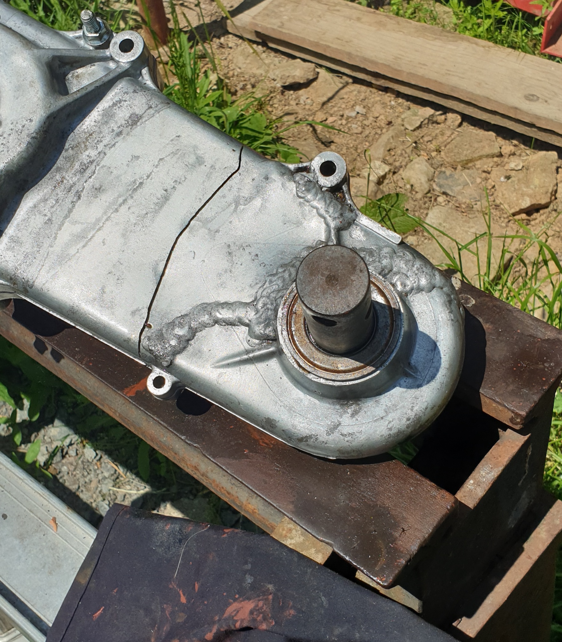

    #40854
    arbe
    Hope this helps.
    • This reply was modified 3 years, 5 months ago by arbe.

    #40860
    arbe
    This is damage that has been caused be trying to get the teeth to bite into the space where the gearbox is trying to push through earth in the center. However as Charlie pointed out maybe we are trying to get too deep. We will have to first repair the gearbox so that oil does not leak out. A new one is far too expensive over 400 dollars. We do have a Howard as well but yet to get the engine up and running.
