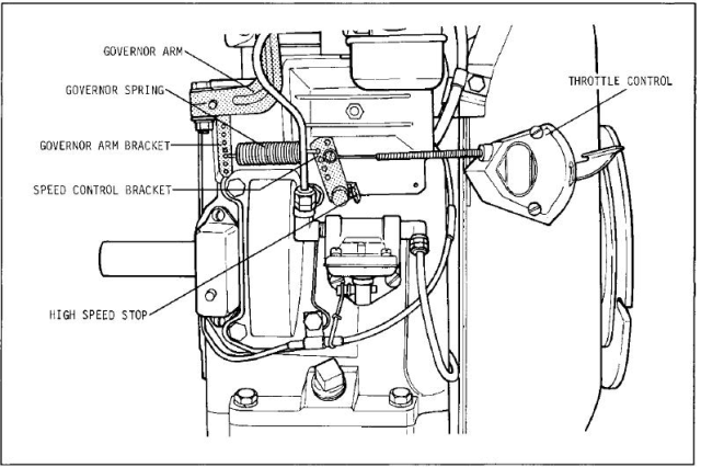

    Can anyone help with a picture of the way the governor linkages are connected on the gem fitted with a kohler engines, I bought it in bits, could do with a picture of the way it all fits together and a picture of of where the throttle cable fits

    Hi. Sent a manual to your email address, Hope it helps.
    #13140
    I also found this diagram save with my manuals.
