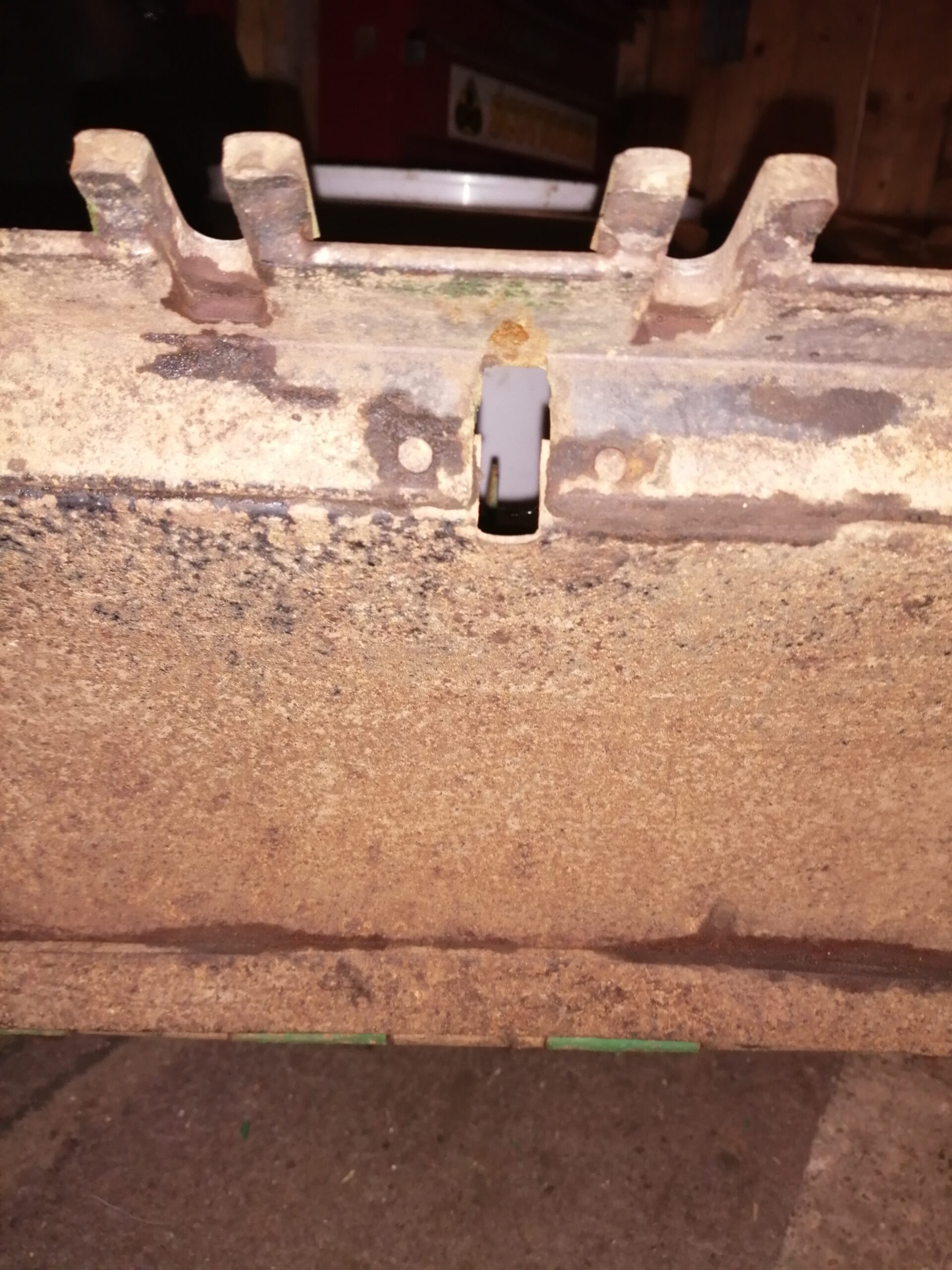

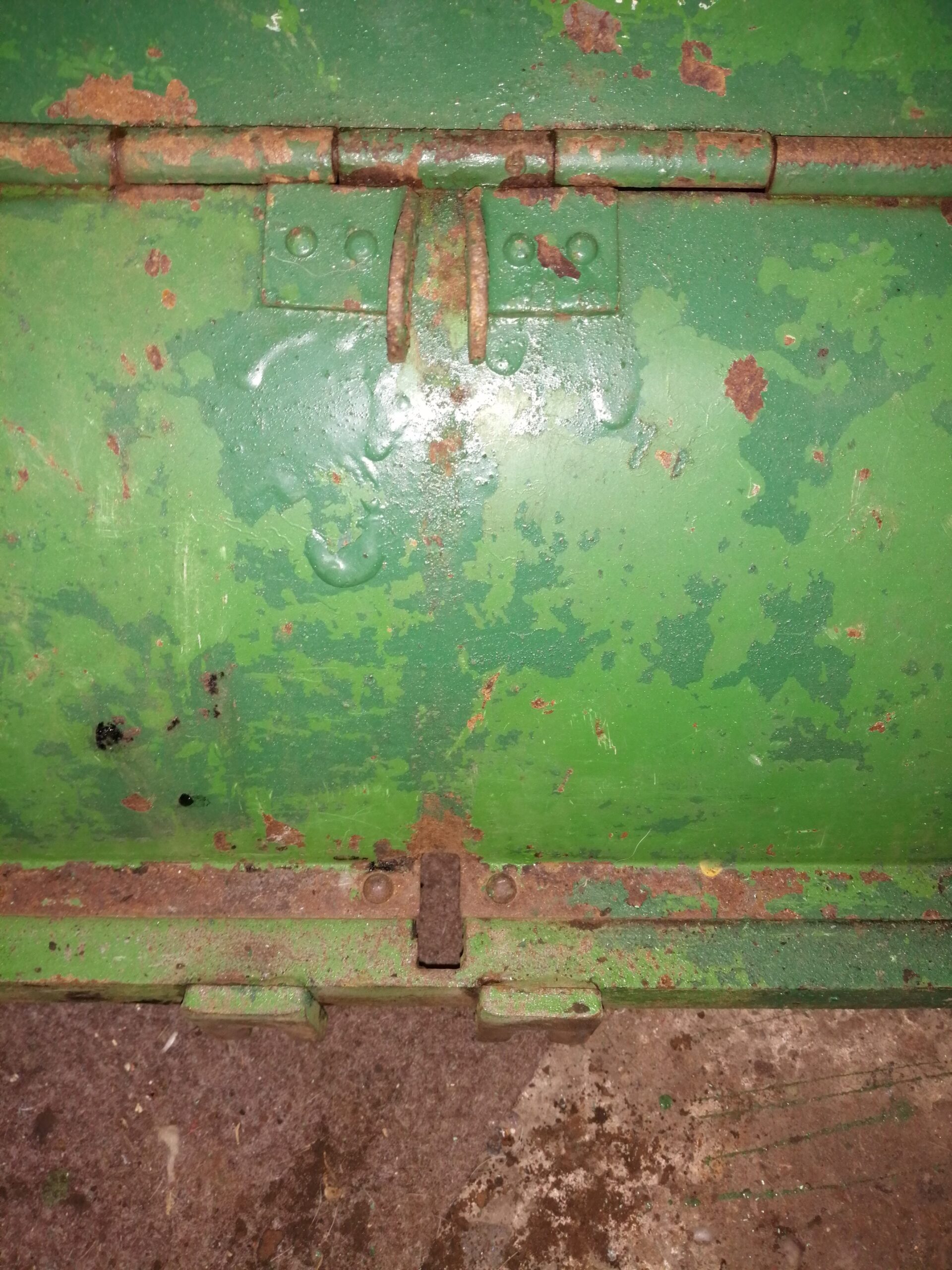

    Does anyone have a picture of how the height adjustment bar fits on the back of the tiller unit, mine is missing, I have included a few pictures of mine

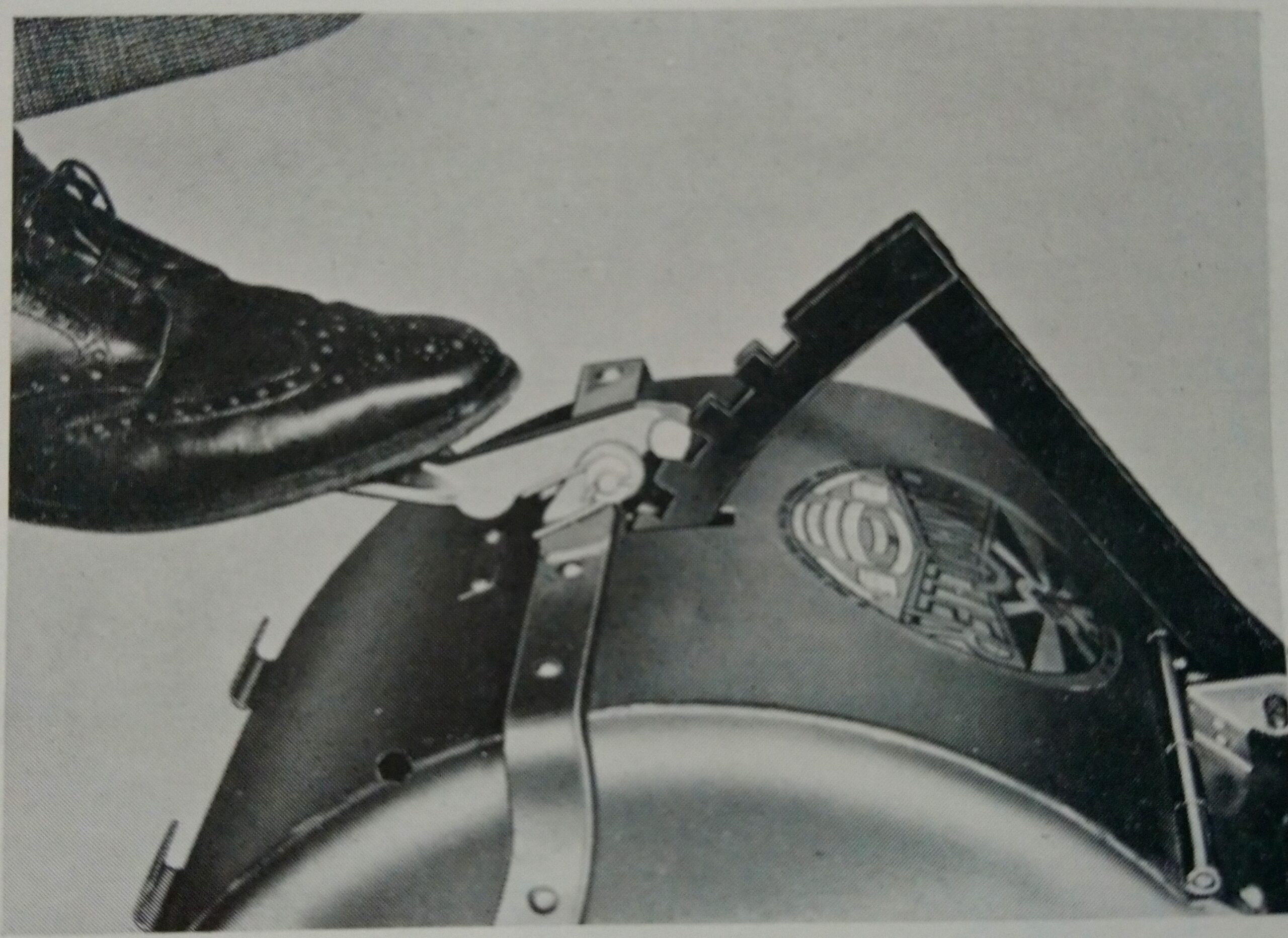

    The depth bar is made up of several components, the bar, a locking pin, the operating pedal and a spring. From your photos I can see the bar and pin are missing. I have copied the illustration from the owners manual which shows how the depth adjuster fits. Please let me know if you require further information or assistance, I have manuals and parts lists for most Monro Tiller machines.

    Thanks Charlie, I’m trying to get the missing parts but looks like I will have to fabricate them, that’s why I wanted some good pics of them to copy, I will pm you with my email address mate for a copy of the parts list cheers
